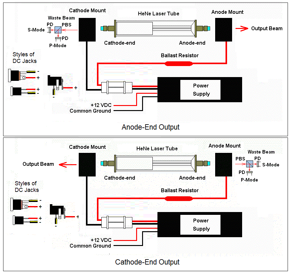

This is detailed info on assembling the Melles Griot 05-LPM-847
power supply brick with ballast resistor(s)
and tube mounting brackets.  The diagrams below shows
the general arrangement.  It is critical that the polarity be correct.
The diagrams also show the polarizing beam sampler that
would be required for the stabilized laser kits (or for other
experiments).
Note that these power supplies have an Alden connector for the tube; A mating
connector will be provided with the tube mounting brackets.
Wiring the power supply
- Attach the thin red wire to the positive of the wall adapter.  Attach
 the black wires to the negative of the
 wall adapter.  DOUBLE CHECK THE WIRING.  REVERSE POLARITY WILL BLOW
 THE HENE LASER POWER SUPPLY OR DAMAGE IT SUCH THAT THERE IS NO OUTPUT
 CURRENT REGULATION - WHICH WILL DAMAGE THE TUBE.  AND MAY BLOW THE
 WALL ADAPTER AS WELL.
 - A screw terminal to barrel adapter is usually
 included to make this wiring painless.
 If not, or you would rather hard-wire it, cut off the barrel connector on
 the DC adapter
 cord and connect directly to the wires of the brick
 Refer to the diagram above for the terminals on the DC jack depending on
 the style that you have.  DOUBLE CHECK POLARITY WITH A MULTIMETER BEFORE
 ATTEMPTING TO POWER THE BRICK AND TUBE!!!!
CAUTION: ALL INPUT WIRING MUST BE SECURED USING SOLDER, WIRE NUTS, OR
A SUITABLE CONNECTOR.  DO NOT JUST WRAP THE WIRES TOGETHER.  INTERMITTENT
CONNECTIONS BLOW STUFF.

Wiring using the brackets:
- If the output is from the cathode-end of the tube,
 there should be a hole in the cathode-end bracket so
 the photons can escape. ;-)  If not, it is possible to swap the two brackets
 or drill a hole.  But the bracket with the red wire MUST have the anode-end
 of the tube.

 - CAREFULLY lay the tube ends on the mounting brackets paying particular
 attention to polarity: The positive has the fat red wire and receives the
 anode (glass)-end of the tube; The negative has the fat black and receives the
 cathode (aluminum can)-end of the tube.  Make sure the anode-end bracket isn't
 too cockeyed to permit the beam from getting out of the hole. :) Make sure the
 tip-off (exhaust tube) at the cathode end clears the structure of the
 bracket.
