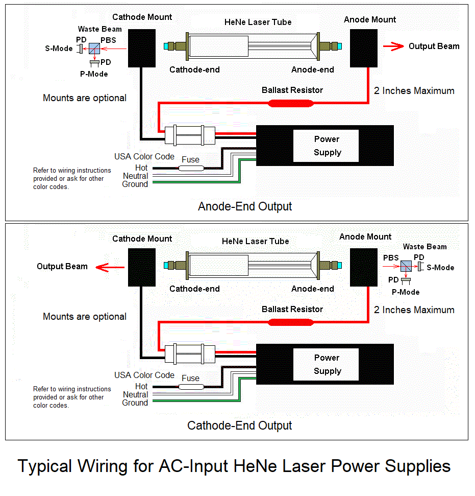

with the high power HeNe laser kits including stabilized.  The
diagrams below show
the general arrangement.  It is critical that the polarity be correct.
The diagrams also show the polarizing beam sampler that
would be required for the stabilized laser kits (or for other
experiments).

Wiring the power supply
- Determine what color code is used for the AC wiring of the brick in the kit.
 This is critical!  I will generally provide this information via email or
 an eBay message.  There is some info at
 Sample Color Coding of AC Input Power
 Supply Bricks that covers most types/manufacturers.  If not included
 there and it's not obvious, please
 contact me before doing something you may regret.
 - An appropriate fuse should be included in the HOT wire to the power supply.
 This is most often a 1 amp medium or normal blow fuse.  It can be permanently
 attached as the fuse should only blow if something bad happens inside the
 power supply.  A suitable fuse will be included with the kit, probably already
 attached and insulated.
CAUTION: ALL INPUT WIRING MUST BE SECURED USING SOLDER, WIRE NUTS, OR
A SUITABLE CONNECTOR.  DO NOT JUST WRAP THE WIRES TOGETHER.  INTERMITTENT
CONNECTIONS BLOW STUFF.

Wiring using the brackets:
- If the output is from the cathode-end of the tube (as it is in most cases),
 there should be hole already drilled in the cathode-end bracket so
 the photons can escape. ;-)  If not, it is possible to swap the two brackets
 or drill a hole.  But the bracket with the red wire and ballast resistor MUST
 have the anode-end of the tube.
 - Remove the adjustable attenuator plate (if present) from the original
 anode-end mounting bracket (if present) by unscrewing the hex-head screw.
 This plate can be used for other purposes like as a beam sampler.
 - Attach the anode and cathode mounting brackets to a secure surface
 spaced to permit the tube to just fit between them.  For testing this
 step can be postponed.  Depending on how the tube will be used, one or
 both brackets may be trimmed to free up space between them.
 - Flip open the covers on the mounting brackets by pulling back on the
 locking tabs.
 - CAREFULLY lay the tube ends on the mounting brackets paying particular
 attention to polarity: The positive has the fat red wire and receives the
 anode (glass)-end of the tube; The negative has the fat black and receives the
 cathode (aluminum can)-end of the tube.  Make sure the anode-end bracket isn't
 too cockeyed to permit the beam from getting out of the hole. :) Make sure the
 tip-off (exhaust tube) at the cathode end clears the structure of the
 bracket.
 CAUTION: THE TUBE MAY APPEAR TO WORK WITH REVERSE POLARITY
 BUT WILL PROBABLY BE RUINED IN A FEW MINUTES.  Gently press the covers
 in place so they click and are secure.
 Take care to avoid stressing the fat red wires to the ballast resistor.
 If either breaks off, it may be necessary to replace the ballast resistor.
