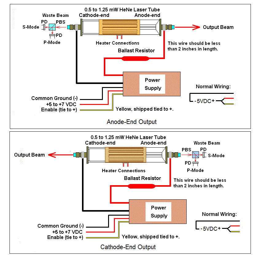

This is detailed info on assembling the copper-covered HeNe laser power supply
bricks with ballast resistor that have been provided with the stabilized laser
kits.  There are two types of HeNe laser tubes which
differ in which end produces the output beam and which end produces the "waste"
beam which may be used for the stabilization feedback.  The diagrams below
show the general arrangement for both.  Note that the wiring must be identical:
Copper-Covered HeNe Laser Power Supply Brick Wiring Diagrams

Attach the thin red and yellow wires (tied together) to the positive of
the wall adapter.  Attach the short black wire to the negative of the
wall adapter.  DOUBLE CHECK THE WIRING.  REVERSE POLARITY WILL BLOW
THE HENE LASER POWER SUPPLY OR DAMAGE IT SUCH THAT THERE IS NO OUTPUT
CURRENT REGULATION - WHICH WILL DAMAGE THE TUBE.  AND MAY BLOW THE
WALL ADAPTER AS WELL.

Installing the tube
- Examine the mirrors of the laser tube to determine the end for the main
 beam.  In the past, most of these were from the anode-end but it can come
 from either end depending on the specific tube.  There will be an AR coating
 on the output-end mirror which appears blue-ish in reflected light.
 - Solder a short piece of high voltage wire to the 91K ohm ballast resistor
 and solder a tube clip to the wire.  This wire should not be more than
 1-2 inches in length.
 - Solder an extension to the remaining thin black wire so it will reach
 the cathode-end of the tube and solder a tube clip to it.
 - GENTLY press the tube clips onto their respective ends of the tube.
 DOUBLE CHECK THAT THEY GO TO THE CORRECT ENDS: THE ONE WITH FAT RED WIRE
 AND BALLAST RESISTOR MUST GO TO THE ANODE (GLASS) END OF THE TUBE!
With everything connected, power the wall adapter.  The tube should light
within a couple seconds.  If it does not, go back and double check everything!
