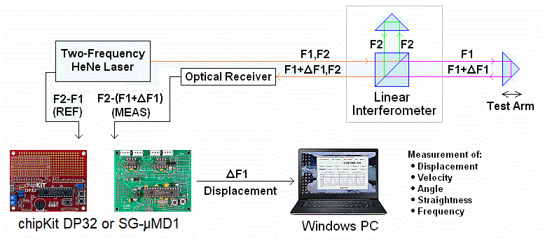

The technique here is based on what's known as "heterodyne interferometry" which utilizes a two-frequency HeNe laser and special optics to precisely measure changes in distance (called "displacement") down to the nanometer scale. Other types of measurements including those for angle and straightness can be performed with appropriate interferometer optics.
In a nutshell, the two-frequency laser sends out a pair of superimposed beams that differ in optical frequency by a relatively constant amount (called REF), one polarized horizontally and the other polarized vertically. REF is typically in the low MHz range which provides a convenient "carrier" for signal processing. Optics separate the two beams, sending one to a (generally) fixed reflector, and the other to some tool or device whose position needs to be measured precisely. Both beams then return to an optical receiver where another difference frequency (called MEAS) is generated. With no movement, REF and MEAS have the same frequency and the phase relationship between the two beams is constant. But if the tool or whatever moves, the frequency and thus phase relationship between REF and MEAS will change due to doppler shift. With the simplest interferometer optics, a phase change of 360 degrees represents a position change of 1/2 wavelength of the light from the laser, approximately 632.8 nm for the HeNe lasers most often used. The precise wavelength for these lasers is specified to 6 decimal places (e.g., 632.991372 nm for the HP/Agilent 5517B) with a wavelength accuracy of 0.1 ppm over the life of the laser.
Using the two-frequency approach rather than a basic Michelson or similar interferometer, among other things makes these systems more immune to misalignment by eliminating issues of fringe counting and direction, and fringe contrast, and they are less susceptible to changes in signal level as the laser ages, dust settles on the optics, or alignment changes.
The diagrams below show the organization of a single axis system using µMD1 or µMD2 for the processing and measurement display. Both provide capabilities similar to those of an HP-5508A Measurement Display - and a lot more. For 2 or 3 axes, the interferometer optics, remote (Test Arm) reflector, and optical receiver would be replicated, along with 1 or 2 non-polarizing beam-splitters to divide the output of the laser.

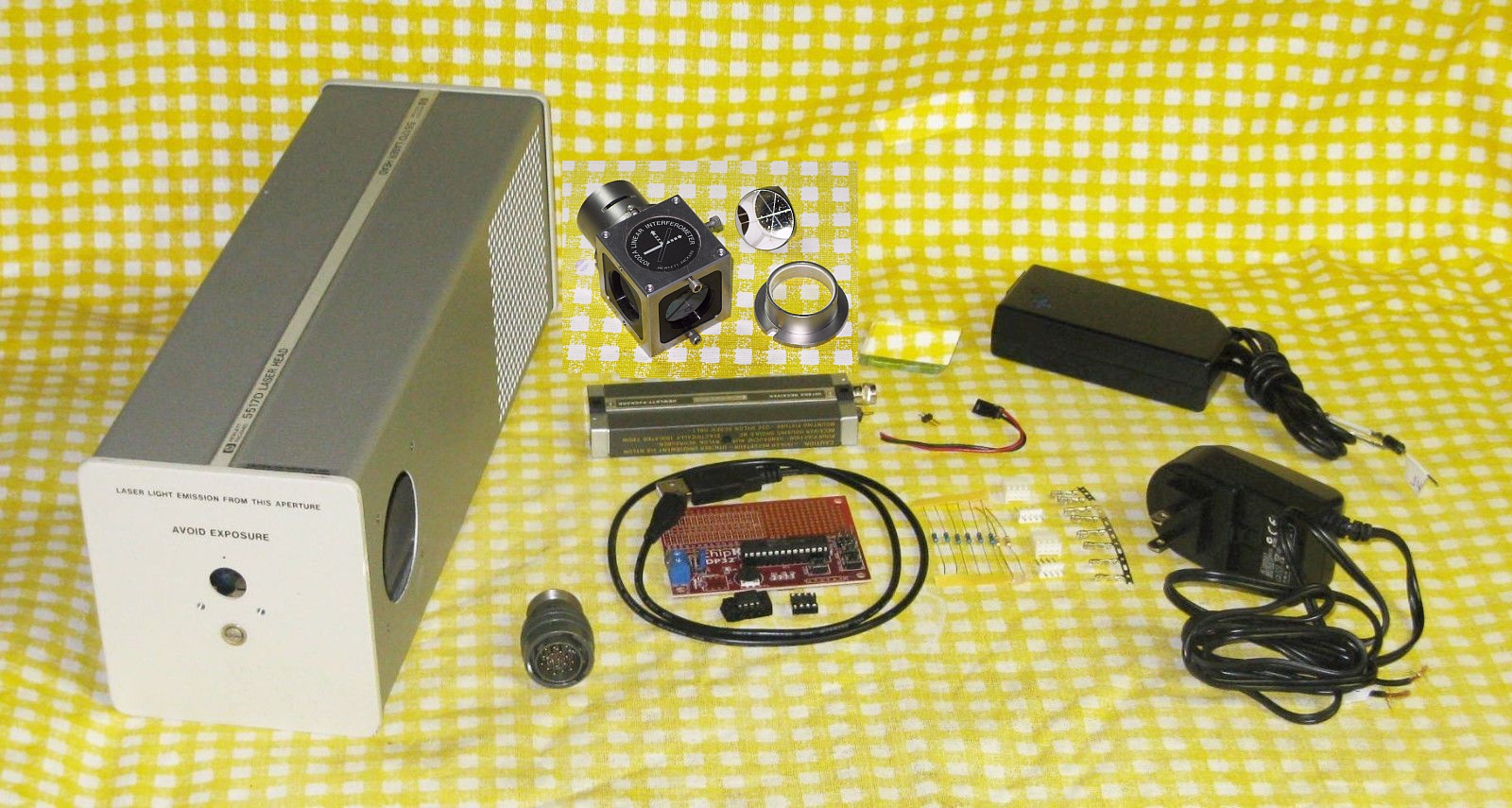

The photo below shows the typical parts included in a single axis system using a 5517 laser:
There is also a lower cost option which substitutes a generic Cube-Corner (CC) for one of the 10703A CCs of the PMI. as well as a more basic option with a 10702A cube, 10703A CC, and generic CC for implemenation of a linear interferometer ONLY.
Except for the unmounted generic CC, these components may be from Hewlett Packard/Agilent/Keysight, Excel, or Zygo. They are all physically and functionally equivalent.

Photo of Typical Parts for Single Axis System using 5517 Laser (Left) and 5501B Laser (Right) with Original µMD1
The interferometers shown are the 10702/6A PBS with 10703A CC, 10722A QWP, and generic CC
