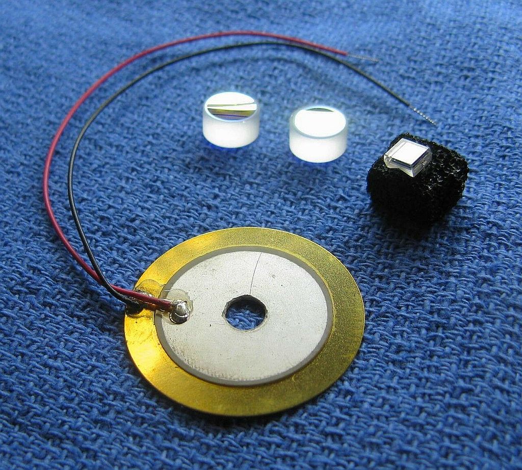

The typical parts are shown below:
The kit includes the following:
The parameters of the new mirrors are similar to those of the classic Spectra-Physics 470-03 SFPI head.
If in doubt about which version you have, the easiest way to tell them apart is by the color of their reflection of white light: The older mirrors are deep yellow while the new mirrors are silver with a slight bronze tint.

The attachment of the leads to the PZT disk is rather fragile, especially the one soldered to the metallic coated area which is only loosely bonded to the PZT material itself. So it would be a good idea to coat only the immediate area of the solder blobs with some 5 minute Epoxy to minimize stress, and then to add a strain relief when installed in the SFPI assembly.
