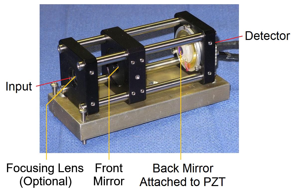

The general optical layout for a spherical cavity SFPI is shown below:
The standard HENESFPI2-1 kit includes:

HENESFPI2 additional parts:
Note: For SFPI kits with longer RoC mirrors, the rod length will differ and no focusing lens will be included.
Dual polarization option:
For simulataneously monitoring the orthogonally polarized longitudinal modes of a random polarized HeNe or other similar laser, this adds an additional photodiode with sockets for both, a polarizing beam-splitter cube (PBSC), and small custom PCB. The PBSC splits the beam to the two photodiodes. The PDs are wired independently and sent to separate channels of your scope, preferably via twisted pairs. The polarization axes of your laser will then need to be aligned with the SFPI "head". Since there may be some crosstalk due to 100s or 1000s of reflections messing with the polarization, a proper preamp is desirable. This would include cross-channel compensation. Details are provided in: Dual Polarization Detectors for Scanning Fabry-Perot Interferometer.

The PZT/rear mirror assembly and Perf. board can be attached to the cage plate with 5 minute Epoxy, which is soft enough that it can be removed and replaced if the need should arise.
Using a narrow file, create a notch wide and deep enough on one surface of the mounting ring for the PZT leads to pass through between the ring and mounting plate.
Use 5 Minute Epoxy to attach the PZT disk to the aluminum spacer ring around its perimeter. The active (coated) side of the PZT disk should be facing up.
The back cavity mirror must be glued to the PZT.
Gently clean the active (top surface) of the PZT disk with alcohol before attaching anything to it.
Carefully remove the mirror from its protective lens tissue. Locate the thinnest part and put a mark on the side with a pencil. The correct angle can usually be obtained by placing a tiny piece of standard Avery™ sticky label under it near its edge on the thin side. :) (Very scientific, huh?) A 1x5 mm piece of label will suffice.
Center the mirror on the PZT disk. While holding it in position with the flat side of a toothpick across the top or (less desirable) a clean cotton swab, apply the tiniest amount 5 minute Epoxy in 3 locations around its perimeter. Just enough to secure it. Once the Epoxy sets up, additional adhesive can be added to increase the strength, but there really isn't much stress on this thing and too much adhesive may restrict the motion of the PZT. Double check that the mirror hasn't shifted position and adjust as needed before the Epoxy sets up.
Set this assembly aside covered so the mirror doesn't collect dust or fingerprints.
