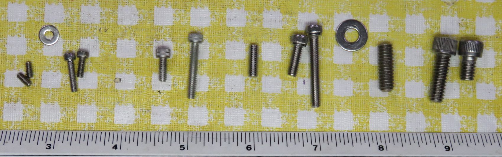

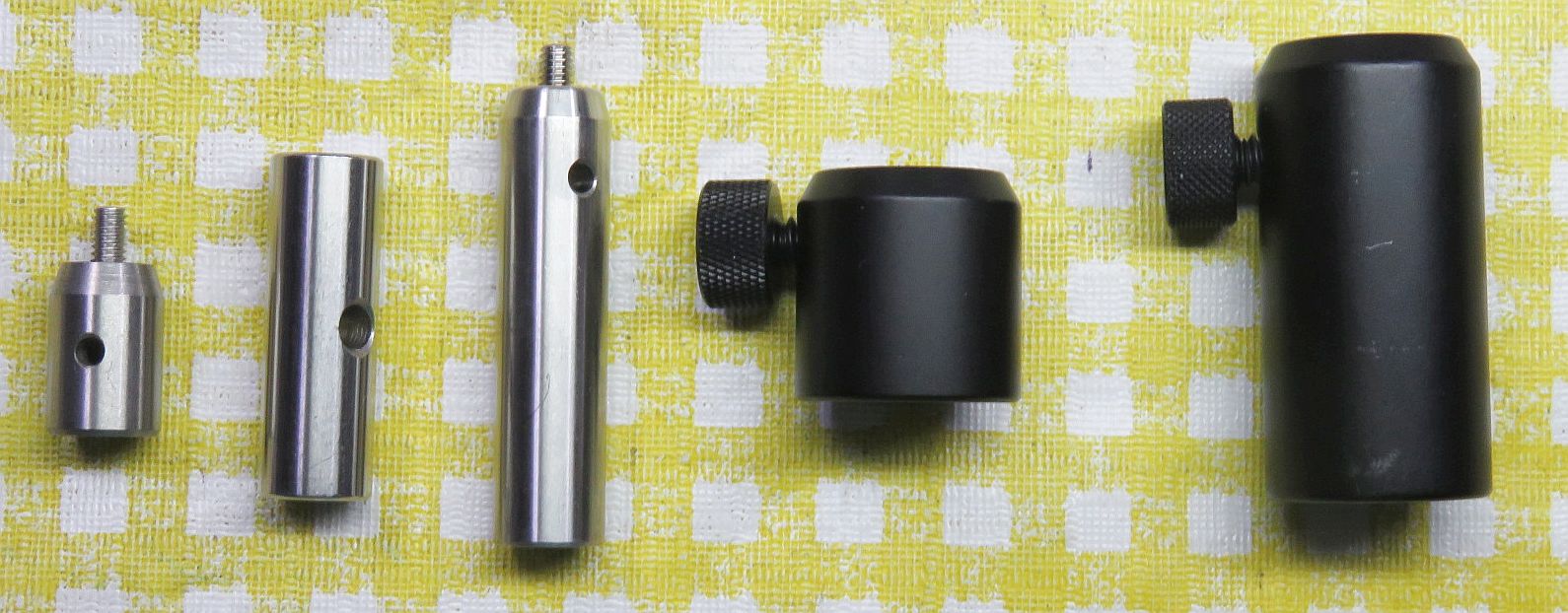

Note: M3 caphead screws are similar in diameter but will NOT fit 4-40 threaded holes and vice-versa. Don't force either!

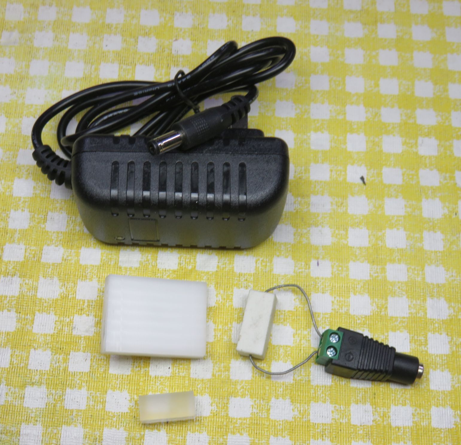

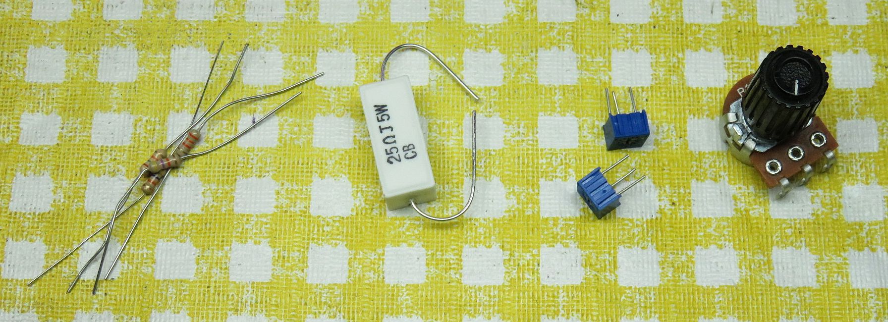

The ones used mostly here will look similar to the top example with the 4 band code and are rated at 1/4 watt with a body around 1/4 inch long. Their leads may be trimmed to conveniently fit the solderless breadboard (or PCB if used).
