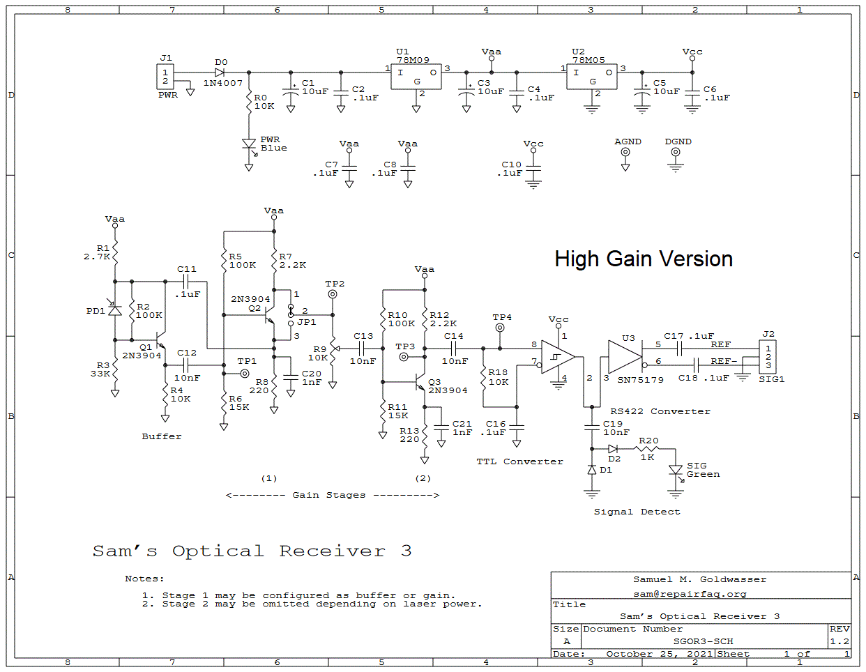

High Gain Version: Jumper the upper two pins of JP1.  Installation
 in a shielded case may be required to avoid interference from other sources.

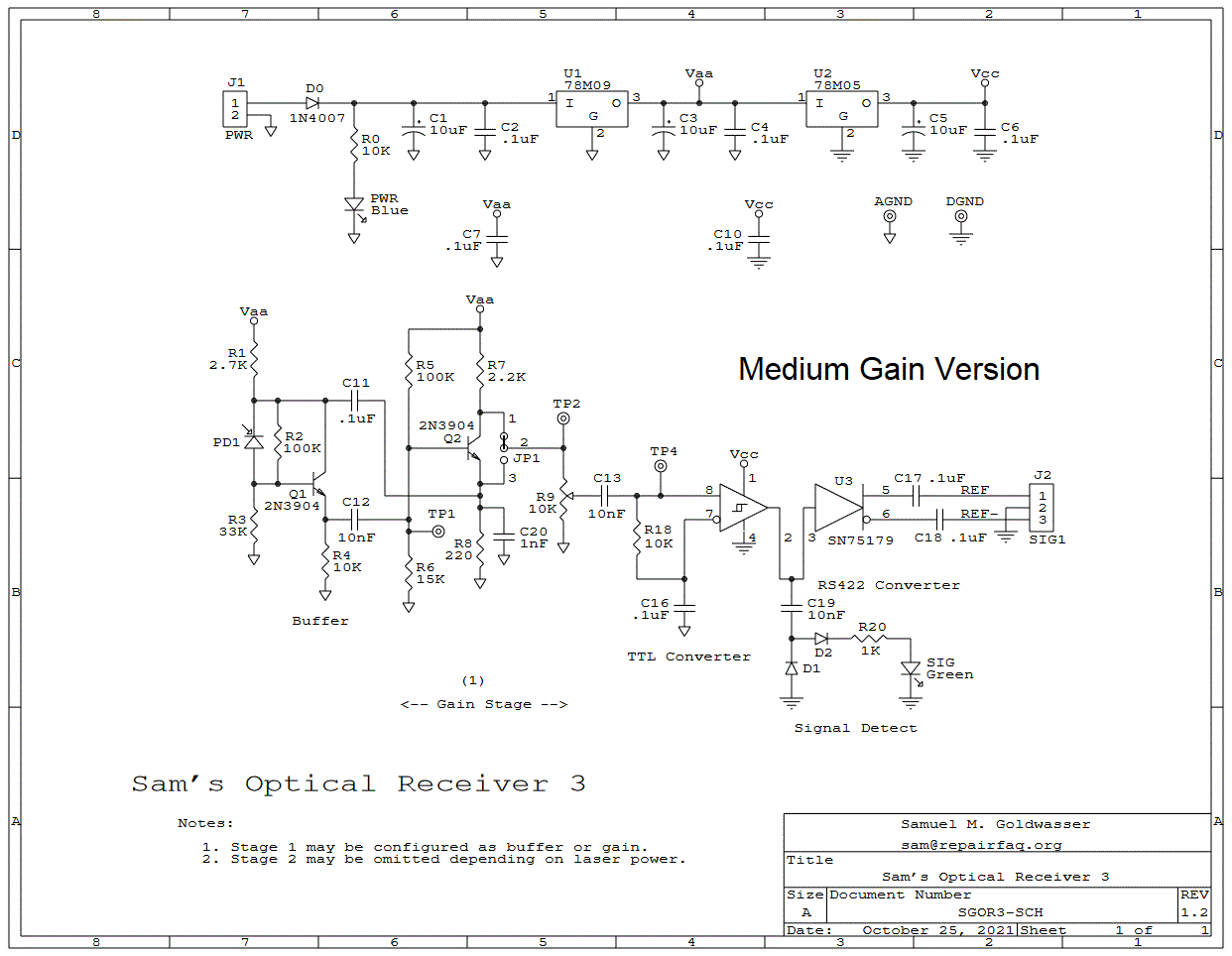

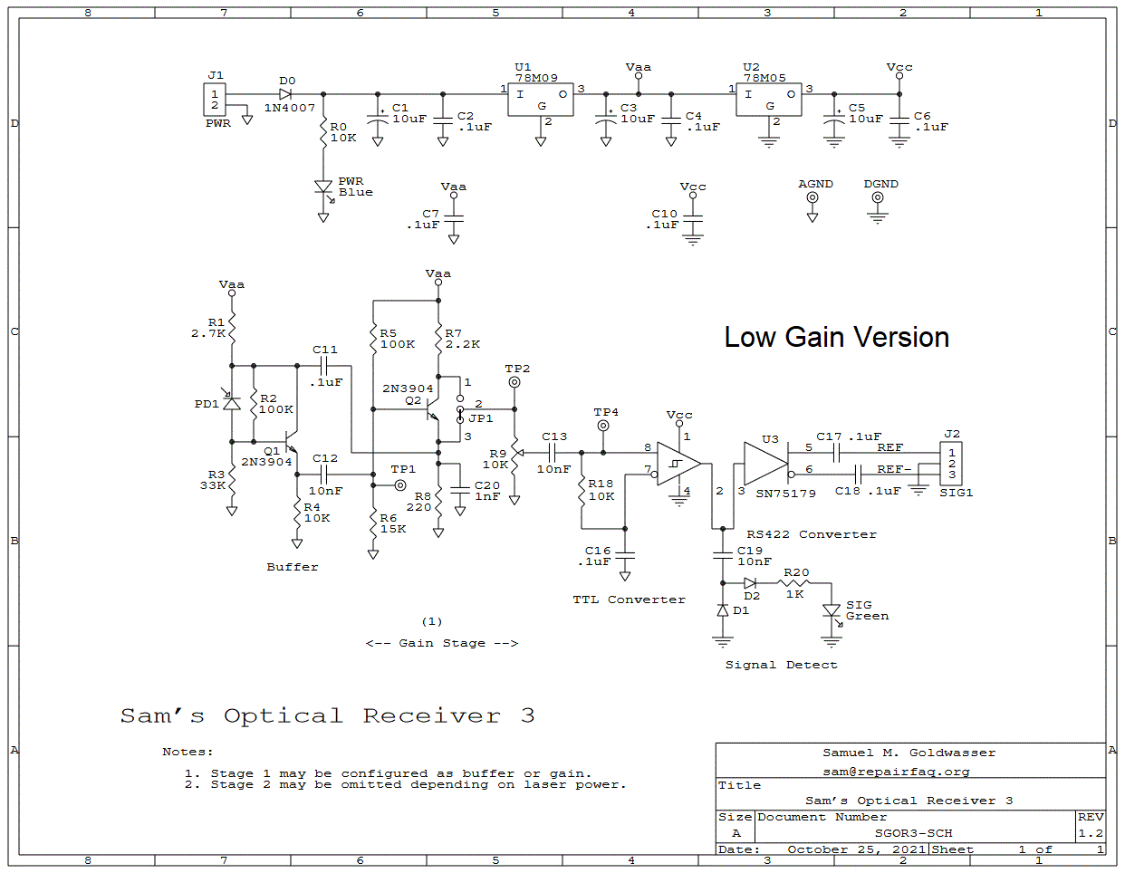

 This is the same as the default schematic except for the
 jumper.  It can also be set up similar to the medium gain version by
 jumpering the lower pins of JP1.

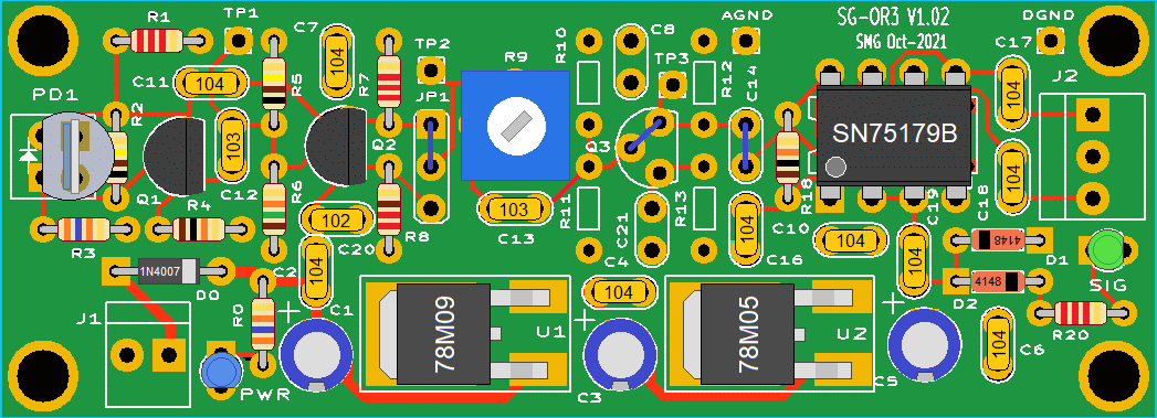

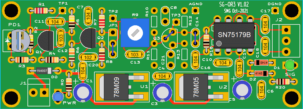

 OR3: High Gain Schematic
OR3 High Gain Component Locations
