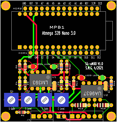

Unfortunately, due to a minor error, parts are not labeled on the
silkscreen for V1.00, so the schematic and SG-µMD2 PCB layout diagram
will need to be used to identify parts placement.

Schematic for the SG-µMD2 Version 1.0
The schematic for both the RS422 and Quad-Sin-Cos (analog) versions
may be found at: SG-µMD0
Version 1.0 Schematic.
Printing out the schematic and having it available for reference while installing the parts on the solderless breadboard.

Common Parts
Reference Description Comments ------------------------------------------------------------------------------- MPB1 Atmega 328P Nano 3.0 Nano soldered to header PCB1 SG-µMD0 V1.0 PCB Custom PCB SKT1 30 pin 0.6" DIP socket For Nano (PCB version only)
Quad-Sin-Cos Analog Version Parts List
   PCB2      Quad Decoder V1.0  PCB       For mounting PDs and beam-splitter
    C1       Capacitor  0.1 µF            U1 5 V bypass
   LED1      3 mm red LED                 Threshold Sin, A
   LED2      3 mm green LED               Threshold Cos, B
    R1       Trip-pot, 100K, 1/4W         Sin (Channel A) Sensitivity
    R2       Trim-pot, 10K                Sin (Channel A) Threshold
    R3       Resistor, 100K, 1/4W         Sin (Channel A) trim-pot isolation
    R4       Resistor, 470K, 1/4W         Sin (Channel A) hysteresis
    R5       Resistor, 2-3K, 1/4W         Red LED current limitin
    R6       Resistor, 1K, 1/8W           Channel A pullup
    R7       Trip-pot, 100K, 1/4W         Cos (Channel B) Sensitivity
    R8       Trim-pot, 10K                Cos (Channel B) Threshold
    R9       Resistor, 100K, 1/4W         Cos (Channel B) trim-pot isolation
   R10       Resistor, 470K, 1/4W         Cos (Channel B ) hysteresis
   R11       Resistor, 30-50K, 1/4W       Green LED current limiting
   R12       Resistor, 1K, 1/8W           Channel B pullup
   PCB2      Quad Decoder PCB             PDs and bias network (optional)
   PD1       Silicon photodiode           Sin (Channel A) of Quad-A-B detector
   PD2       Silicon photodiode           Cos (Channel B) of Quad-A-B detector
   SKT2      8 pin 0.3" DIP socket        For LM393
   STB1      4 pole screw terminal block  Photodiode bias and inputs
    U1       IC, LM393, 8 pin DIP         Sin/Cos thresholding
