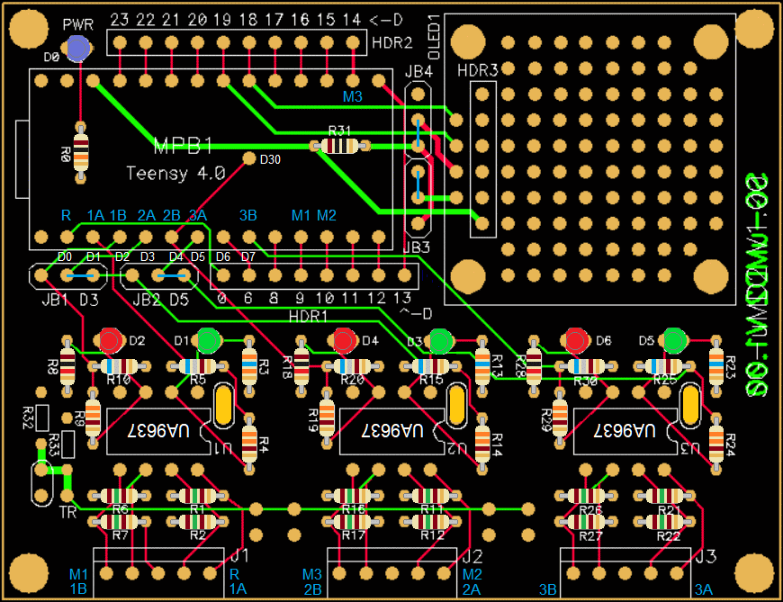

Assembly using the SG-µMD2 Board
The current PCB version is V1.00, which is shown below. Clicking on these will bring up higher resolution versions in a single separate tab or window depending on your browser settings:
SG-µMD2 V1.00 PCB Layout Diagram (Left), SG-µMD2 V1.22 PCB Layout Diagram (Center), and Three Axis Populated V1.00 PCB with OLED Display (Right)
(JB1 and JB2 Jumpered for Normal Operation; JB3 and JB4 Jumpered for OLED GND on the Left and VCC on the Right)
V1.22 and V1.23 are virtually identical. Kits are currently shipping with the V1.23 PCB.

Wiring the Cables
For differential RS422-type signals, it's usually not necessary to run the return to the board even if there is no common ground connection between the board and their source. The terminating resistors will provide the ground reference. In fact, under some conditions where everything is tied together with a common ground, the return connections could add noise due to a ground loop. The line receivers only care about the difference between the voltage levels for each signal pair as long as the absolute voltage levels are within their common mode and absolute voltage specifications. For cables of a few feet or less, it's almost certain that no connections are required for the Returns. But for long runs, shielded cable or twisted pairs may be desirable. This won't apply to most hobbyist/experimenter applications. :) There has to be a common Ground somewhere though, usually via the power supply.
For single-ended signals like TTL, there are locations on the µMD2 PCB for a voltage divider to set a threshold reference. Check the schematics. A trace with runs from there across the board with pads near each axis so it's easy to wire it to the unused UA9637 inputs. For TTL, the threshold should be set at around 1.4 V. For analog 0-1 V signals, set it at 0.5 V. If they aren't all the same, some creativity will be required. :)
Using the 5 pole screw terminal blocks, attaching cables is a cinch. Each of the pairs of outer two pins is the signal and its complement. The center pin is GND. Strip the wires to about 3/16" or 4 mm and insert so that no bare wire is exposed, tighten the screw. If connectors are preferred, 5 pin Molex/AMP headers can be installed in place of the terminal blocks (not included in the kits but readily available). For other connector types, adapters can be easily constructed. Or 2 pin connectors can be substituted if desired.
