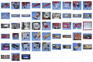

Scientifica & Cook HeNe Lasers
Web Album: 48 Photos
Description of the Web Album photos for Scientifica & Cook HeNe laser head
and power supply #1:
- System1_Overall1: This shows the dramatic ;-) laser head and power
supply connected by the high voltage and filament / return cables, along with
the line cord.
- System1_Back1: The back panels showing the connectors and
strange black interlock plug and AC line input. The key-lock switch requires
a strange round key, availability unknown.
- System1_Front1: The laser head has a black output bezel with
beam shutter; the power supply has a boring blank aluminum panel.
- Head1_Top_Overall1: Right-side view showing the laser safety label.
- Head1_Top_Overall2: Left-side view showing the "Scientifica &
Cook Gas Laser" label.
- Head1_Back1,2: Back end of laser head showing high voltage connector
(left) and return / filament connector (right). These are similar to
LEMO™ connectors. The blank aluminum plate can be removed to access
the waste beam.
- Head1_Front1,2: Front end of laser head showing the black bezel
and shutter knob. There is nothing contained in the bezel and it's not
clear if it has any real purpose.
- Head1_Interior1-3: These show the resonator and two-Brewster
tube with the covers removed. The large ballast resistor (33k ohms)
and fat red HV wire go to the anode at the left; The two fat blue wires
are terminated in female socket pins that attach to the filament. There
are 2 separate filaments, so should one burn out, the other can be swapped in.
There are five IR-suppression magnets glued directly to the tube bore.
- Head1_HR_End1: This is the HR-end of the resonator with the cover
plate flipped down but still attached by the HV and filament / return wires.
- Head1_HR_Mirror_Mount1: The mirror is secured inside the
mirror mount using a lock ring. The 3 screws are for alignment.
- Head1_Back_Brewster1: The Brewster window is protected by
a thin plastic cover secured with an O-ring.
- Head1_Back_Third1: Close-up of the back third of the resonator.
- Head1_Middle_Third1: Close-up of the middle third of the resonator.
- Head1_Front_Third1: Close-up of the front third of the resonator.
- Head1_Tube_SN1: Tube serial number label stuck to tube.
- Head1_Filaments1: Closeup of the 2 filaments. These appear to be
pristine. Too bad about the tube. ;-(
- Head1_Front_Brewster1: The Brewster window is protected by
- Head1_OC_Mirror_Mount1: This is similar to the one in the back for
the HR.
- Head1_OC_End1: This is the output-end of the laser.
- Head1_Aperture_Warning1: There is no indication of the
maximum possible power from this laser. But based on the
dimensions of the tube and rating of the power supply, it could be
5 mW or more.
- Head1_Laser_Label1: Ealing SCIENTIFICA GAS LASER label on the
left side of the laser near the back..
- Head1_Safety_Label1: DANGER label on the right side of the laser
near the back. The maximum power stamped on the label is 6 mW and the
laser had a Class IIIB designation.
- Head1_Nameplate1: This is on the bottom at the back. The
manufacturing date is 17-May-1977 and the head serial number is 556-5.
That could translate to the 556 laser build in May (5), though I
rather doubt these things were ever that popular. ;-)
- PS1_with_Cover1,2: This is the power supply that
went with laser head #1. The physical construction is basically similar
to that of the head but shorter. And note the convenient carrying handle. ;-)
- PS1_Back1,2: This shows the HV connector with a single large female
socket, the return / filament connector with its 2 female sockets, the
strange black interlock plug (assumed to be just a jumper), the Power indicator
lamp, the also strange 115 V input socket, fuse, and circular key-lock
switch.
- PS1_Side1,2: Views of the interior of power supply #1 showing
the massive multi-tapped transformer at the left, bridge rectifier and
ballast resistors next to it, followed by the 6-stage starting multiplier in
parallel with 3 HV diodes to isolate it from the main output.
- PS1_Top_and_Bottom_PCBs1: The PCB on the bottom has 10 filter
capacitors along with equalizing resistors for the main HV output.
- PS1_Transformer_Taps1: The transformer can be jumpered to select
1, 1.4, 1.8, or 2.5 kV nominally at 115 VAC input but that can then be
fine-tuned by changing to one of the 10V taps on the input.
- PS1_Nameplate1: This has SCIENTIFICA & COOK ELECTRONICS LTD and
the same SN: 556-5.
- PS1_Powering_Modern_HeNe_Laser_Tube1: This is a modern Melles Griot
05-LHR-082 HeNe laser tube. It is multi-spatial mode (MM) rated at
14 mW. The supply happily runs it tapped as shown over a voltage range
of at least 110-125 VAC resulting a tube current of approximately 5.0-6.5 mA.
At 6.5 mA it would produce more than 14 mW being brand new.
power supply #2. There is no telling where the laser head is now, probably
a land-fill:
- PS2_with_Cover1-3: This is the power supply that
went with laser head #2 (missing in action). This shows the HV connector
(smaller than the one on PS #1) which like a modern laser has its own
return. Then there is the same strange black interlock plug
(assumed to be just a jumper), the Power indicator lamp, the
also strange 115 V input socket, fuse, and straight key-lock
switch with two (2) keys.
- PS2_Side1-3 and PS3_Top_PCB1: Views of the interior of power supply
#2 showing the massive multi-tapped transformer at the left (with protective
plastic sheet in the first photo), two-transistor regulator with adjustment
trim-pot (range from 6 mA to below 5 mA), a 4-stage voltage multiplier
in parallel with HV 3 diodes to isolate it from the main output.
- PS2_Top_and_Bottom_PCBs1: The PCB on the bottom has the
bridge rectifier and 10 filter capacitors along with equalizing
- PS2_Transformer_Taps1: The transformer can be jumpered to select
900?, 1.4, 2.0, or 2.5 kV nominally at 115 VAC input but that can then be
fine-tuned by changing to one of the low voltage taps on the input.
With the taps selected as shown, this will regulate at 6.0 mA over an
input voltage range of at least 110-125 VAC
- PS2_Nameplate1: This has SCIENTIFICA & COOK ELECTRONICS LTD and
SN: 749.
