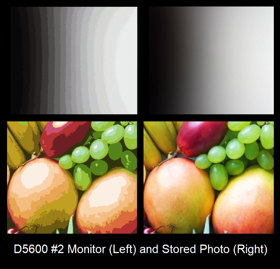

    A D5600 was actually the first DSLR I acquired after deciding to get back into more serious photography. Or at least *studying* more serious camera gear! My previous serious cameras were the Nikon F with the Photomic FTN finder and the Nikkormat. Go date those! ;-)
    To restore D5600 #2 to full functionality, the plan was to swap its back (including the LCD) with the one from D5600 #5.
    D5600 Back Housing Removal and LCD Flex Cable Replacement
    My intention had been to just swap the entire Back Housing along with the LCD, not to replace the LCD panel itself. But based on the more extensive disassembly required - particularly the need to remove and replace a rubber pad and grip (or at least peel them off of the heavy duty adhesive securing them) - the adage "if if ain't totally broke, don't try to totally fix it." ;-) In the case of D5600s #2 and #5, not much would be gained. So for now at least that will await a certifiably dead D5600 (but with a good screen) to cannibalize.

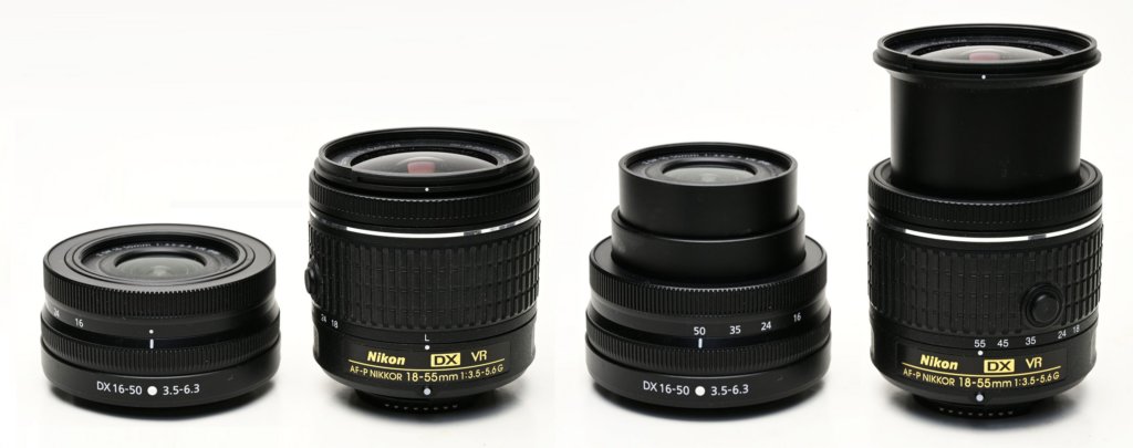

    AF-P lenses use a miniature stepper motor with "P" supposedly standing for "Pulse", since pulses drive the two phases of its windings. Manual focus is also "fly-by-wire" in that the focus ring is linked to what is essentially a rotary encoder that sends pulses (two phases in quadrature) to the focus motor but is not mechanically connected to it. (Unfortunately, this means that if the electronic focus is inoperative for any reason, there is no manual focus backup.) AF-P lenses were introduced around 2016 but are NOT compatible with older Nikon DSLRs. They are partially compatible with some like the D5200 if the latest firmware is installed. Check the on-line Nikon compatibility chart for your camera(s) or just ask Google AI. Exactly why this incompatibility should exist is not known, as it would appear from a design standpoint to have been possible to make the AF-P lenses backward compatible.
    There are only 3 types of AF-P DX zoom lenses (and probably always will be only 3 since there is no effort going into new designs for F-mount gear): the AF-P DX 18-55mm f/1:3.3-5.6G "kit" lens (VR and non-VR versions), the AF-P DX 10-20mm f/1:4.5-5.6G VR wide angle lens, and the AF-P DX 70-300mm f/1:4.5-6.3G telephoto lens (VR and non-VR versions). There is also an AF-P FX 70-300mm f/4.5-5.6E ED VR full frame telephoto. Nikon Z-series lenses use similar stepper motor technology for focus but don't call it out explicitly.
    The AF-P DX lenses were all designed around the same time, probably by the same design team, so they share many similarities. These include the general construction of the front and back sections and the lack of any shims or spacers for fine tuning. The front Lens Cluster is 3-fold symmetric; the back one goes in only one way, though the mounting holes may be large enough that some small amount of lateral adjustment is possible for ultimate optical perfection. The FX version is somewhat different as it has a metal Bayonet Mount and fully electronic aperture control with no physical lever (similar to that of Z lenses). Comments are pending the dissection of a sample.

    Nikon AF-P Nikkor VR Zoom Lenses is a comparison of the 4 versions set at minimum length - thus 18 for the 10-20mm and L for the 18-55mm. The non-VR DX 18-55mm and DX 70-300mm appear identical except for the lack of the gold "VR" on the label.

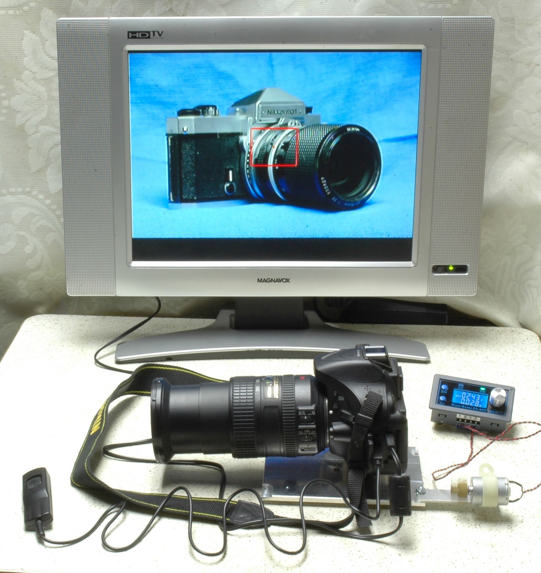

    In principle, a test setup with a camera in Live Mode aimed at a test chart feeding a video display could be used to fine tune the shim thicknesses. For the 1st Lens Cluster, this would be straightforward on lenses where it could be loosened slightly but not removed so that test shims could be inserted behind it. However, there would still be challenges depending on the video quality as the focus error for miniscule tilt will be down in the weeds. It may require making test shots with the aperture wide open and displaying them at full resolution. And your mileage may vary. ;-)

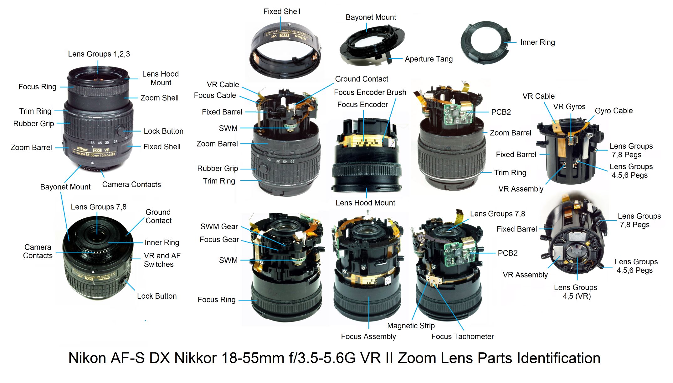

    Nikon AF-S DX Nikkor 18-55mm f/3.5-5.6G ED Zoom Lens
    There is a repair manual on-line for this lens. Search for "Nikon AF-S DX Nikkor 18-55mm f3.5-5.6 ED Lens Service Manual" (without the quotes). It's the second hit using Google. This manual may be slightly more detailed than the later ones, though some of the steps need more context to make sense. ;(
    The ED may be the first of the AF-S DX 18-55mm zoom lenses and not much is known about it other than what is in the repair manual showing significant differences compared to even the ED II version. That version appears to be closer to the AF-S VR lens, below.
    The AF-S DX ED has fewer lens elements, uses a magnetic instead of an optical tachometer for autofocus, and the construction is more complex and somewhat clunkier.
    I acquired one but since it is in good condition post cosmetically and functionally, it will be for external inspection only, not for dissection. There are no current plans to investigate this lens in greater detail unless someone would like to donate a sacrificial specimen for analysis. The asking prices on eBay are above may curiosity quotient for a lens to take apart and likely never put back together so it functions. ;-) Appropriate chants and incantations will be issued to the gods of dead camera lenses upon request but it will not likely survive the experience. :( ;-)
    See the Nikon AF-S DX Nikkor 18-55mm f/3.5-5.6G ED Zoom Lens Dissection Web Album. There is no dissection yet but it shows some stock photos, the optical architecture, how the lens groups move with zoom, an engineering diagram of the lens derived from one in the repair manual, and photos of the exterior in various poses. Most of these photos were taken with either a Nikkor 18-55mm ED II lens or the repaired 18-55mm ED lens - ID #2.

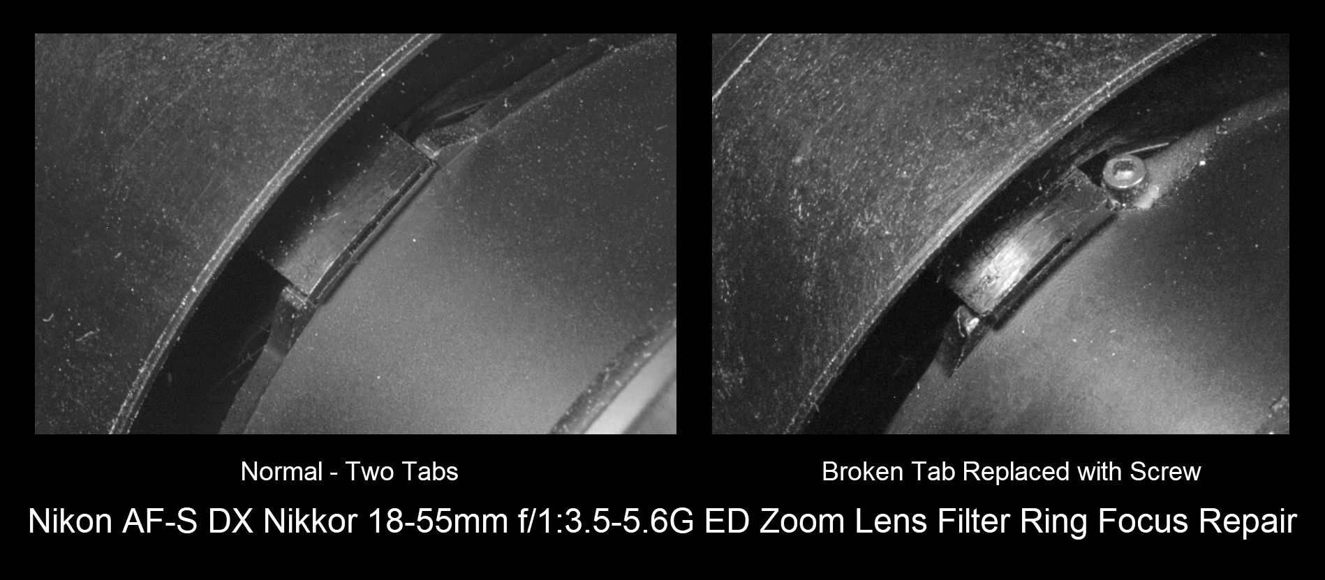

    Repairing Broken Focus Tabs on Nikon AF-S DX Nikkor 18-55mm f/3.5-5.6G ED Zoom Lens
    Neither focus mode worked on this lens (ID #2), zoom was erratic, and if zoomed out with focus at the closeup-end (also extended), the Filter Ring was very loose and would have fallen off if the Trim Ring wasn't preventing that. At first I thought the problem might be similar to the one described in the section: Repairing Loose Front on Nikon AF-S DX Nikkor 18-55mm f/3.5-5.6G VR Zoom Lens.
    Autofocus on this lens as well as the AF-S VR (and probably the AF-S ED II), and other lenses use the SWM to rotate a plastic ring with two prongs (tips of a fork) that slip into slots in the Filter Ring, which serves to adjust focus by moving in and out via internal helical grooves. On this sample of the AF-S ED lens, two of the raised bits of plastic that are the stops on one side of the slots were sheared off. While they aren't that large, it still isn't clear how this could happen. Possibly a gorilla attempted to change focus using the Filter Ring while in autofocus mode. Or perhaps there was a control problem resulting in the fork bashing against one end repeatedly. However, testing after the repair (below) did not indicate any such issue.
    The broken protrusions are only about 1/16" on a side. But a replacement can be long since there is nothing in the way around the periphery of the Filter Ring. However, gluing plastic is always dicey so I opted to install a pair of 0-80 x 1/16" cap head screws in place of the broken-off plastic bits.
    Since the repair manual is fairly detailed for this lens, it may come in handy here to clarify the disassembly/reassembly process.
    1. Remove the Rubber Grip by carefully lifting one edge and then pulling it off incrementally around its periphery.
    2. Peel off the strip of polyester tape securing the Trim Ring to the Zoom Barrel. It may be possible to re-use this but don't count on it.
    3. Set the AF A/M switch to "M" and rotate the Focus Ring clockwise to the fully extended position. Set the AF A/M switch to "A" so it stays there.
    4. Set zoom to the 55mm position.
    5. Slide the Trim Ring away from the body of the lens so it rests against the Filter Mount at the front.
    6. Check the position of the two tips of the plastic "fork" that engage the outside of the Filter Ring. With these zoom and focus settings, they should be barely on the Filter Ring (<1/8th inch). In the case of this failure, they may be at almost any location and the Filter Ring can be removed now if it doesn't just fall out on its own.
      Nikon AF-S DX Nikkor 18-55mm 1:3.5-5.6G ED Zoom Lens Filter Ring Focus Repair shows the normal appearance and after the repair. Sorry, I forgot to take a pic of the original condition. :( ;-)
      If they are correctly engaged, the problem is elsewhere.

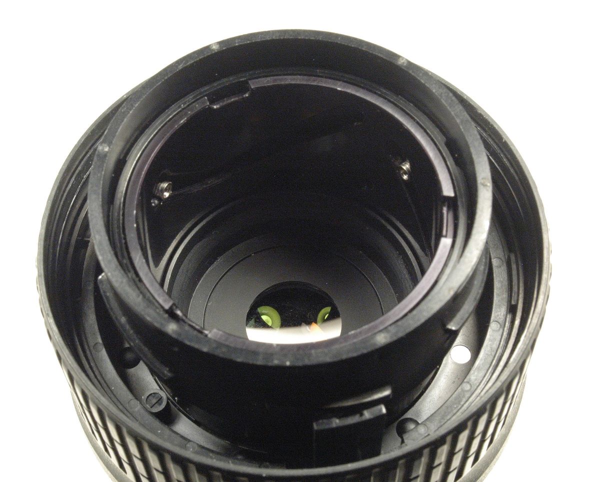

    7. The Trim Ring can be removed from the Filter Ring by carefully squeezing the Filter Ring at the slot positions so they clear the inside of the Trim Ring. But again, this is not necessary.
    8. Inspect the slots in the Filter Ring for the missing protrusions. Two or more of them will likely be sheared off. If only one was broken, the lens would probably still work.
    9. (Optional) Before doing the repair itself, it is possible to somewhat check the autofocus electronics are functional even without the Filter Ring (with the front lens groups) installed. Depending on zoom position, the lens will create a fairly sharp image at extreme closeup - an inch or two from the front of the Zoom Barrel - what's left of the lens. So with the lens mounted on a camera and the Focus Switch set to A, determine the approximate distance where the image appears sharp in the viewfinder and position the camera there. While pressing the shutter button half-way to enable autofocus, move the camera back and forth around that position and observe the operation of the Focus Fork: It should rotate back and forth as well. If it does nothing or consistently slams to one end, then there is something else wrong and that may have been what caused the physical failure in the first place.
    10. Drill a 3/64" hole (which is the correct size for an 0-80 machine screw) in the area where the missing bit would be so that the edge of the screw head will be positioned where the edge of the plastic protrusion was.
    11. Since the plastic is soft, tapping the 0-80 holes may not be needed and in fact using the screws to make tap their own threads may be more secure. In leu of an 0-80 screw, an extra camera or lens screw of appropriate size may be used.
    12. Install the 0-80 x 1/16" screws just snug. Don't over-tighten or there is a risk of stripping the threads.
    13. This step is only necessary if the Trim Ring was removed entirely from the Filter ring: Slip the Trim Ring onto the Filter ring by squeezing it slightly at the area of the slots. Do not secure it. Take care not to dislodge the padded strip on the inner surface of the Trim Ring. If a portion needs to be reattached, it and the surface of the ring should be cleaned with degreaser to remove residual oil and/or grease. If the dangling piece is short, just cutting it off will suffice.
    14. With the zoom and focus still in the extended position, install the Filter Ring so the fork engages the repaired slots. The tips of the fork should just engage them. On the AF-S ED lens (unlike the AF-S VR lens), the Filter Ring can go in at many orientations; only one is correct and the Filter Ring should slip in with no resistance at all. The repair manual shows a reference line on the Filter Ring that should be near a triangular mark on the Helicoid (inner) Ring when they engage correctly. The triangle is easy to spot but the line is just barely visible at the edge of the Filter Ring. And even when found, it is still a bit of hit-or-miss to get the engagement correct. Once engaged, it may make snapping into position easier if focus is set to M and the Focus Fork is rotated slightly counterclockwise so the Filter Ring is recessed a bit when they engage. Depending on which bits of plastic were broken and thus where the screws are located, it may be necessary carefully spread the fork apart to do this. Focus will only work from end-to-end with the correct alignment. It may be worth adding your own reference marks if future repairs are required.
    15. Testing can now be performed both off and on camera.
      CAUTION: Do the testing over a padded surface in case the orientation of the Filter ring is not correct as it may pop off during auto or manual focusing and fall out. That has happened to me a couple of times fortunately resulting in only minor cosmetic damage but it could have been much worse. ;-(
    16. First check that the Filter Ring does not fall off even at the extremes of zoom with focus set to M.
    17. Install the lens on a compatible camera. All functions should work so exercise zoom with auto and manual focus and take some photos and inspect them carefully for sharpness. If focus lock cannot be achieved over the full range of zoom and distance or anywhere, the orientation is incorrect. Recheck it!
    18. Once this test had been confirmed, add a dab of Epoxy to secure each screw. This is best done with the Filter Ring again removed from the lens (Uh!) so as not to get adhesive on the Focus Fork tines or elsewhere. To add some strength, the Epoxy can be extended around the periphery of the ring away from the slots, but not much toward the front. And take care it doesn't dribble where it shouldn't. :( ;-) Confirm that the tines of the Focus Fork will fit in the slots and trim any excess adhesive as required. For reference, the slots are around 9 mm across.
    19. Once the adhesive has set, use an air bulb and/or camel's hair brush to dust out the inside of the lens and Filter Ring, and particularly the exposed lens elements. Then reinstall the Filter Ring as before and reconfirm it is oriented correctly as before!
    20. The remaining steps are the reverse of the disassembly. If the polyester tape cannot be reused, Kapton electrical insulating tape or even thin plastic packing tape should be satisfactory since the Trim Ring is mostly cosmetic, doesn't serve any critical function, and is under minimal stress. Clean the area where the tape goes both on the Zoom Barrel and Trim Ring before replacing it.
    There was some free play when this lens was reassembled because the 0-80 screws weren't quite positioned perfectly. Can you believe that? Geez, they are at least as large a grain of rice. ;-) Also, the heads of the only suitable screws available were ridged, not smooth and after 10,000 years of continuous shooting that could conceivably result in excessive wear of the Focus Fork tines. Of course as a practical matter, neither would likely make the slightest difference in anything including the longevity of the Universe, but being somewhat OCD about such things, a layer of Epoxy was added around the screw heads to to smooth and fatten them up a bit. ;-)
    After around the fiftieth time removing and replacing the Filter Ring, it becomes almost trivial. ;-)
    A hard whack to the front of this (and other similar) lenses can fracture one or more of the plastic rollers that guide the front portion of the lens including the Focus Ring and Focus Barrel. The symptoms will be that the front of the lens is very loose but the lens may be somewhat functional, though with erratic autofocus and the quality of the pictures taken with it will be hit or miss. The seller of the lens used for this repair described the issue as "front impact damage", which is accurate.
    The parts are shown in: Nikon AF-S DX Nikkor 18-55mm f/3.5-5.6G VR Zoom Lens Focus/Zoom Guide. The stud with the rollers is secured through the Fixed Barrel of the lens with the screw on the left with the offending roller missing as will likely be the case with this failure. Both are present next to it, and only a roller on the right. I'm calling them "rollers" though it's not clear if they are intended to actually rotate or just slide within the focus and zoom tracks. When fractured, it's likely that some pieces will break free and float around in the lens interior or perhaps fall out through the back.
    This is among the simplest lens repairs not even requiring any precision tools. That is, assuming replacements for the broken plastic pieces are available - most likely only from a sacrificial AF-S 18-55mm VR lens or other similar small lens (though that is probably not very likely given Nikon's tendency to reinvent everything with each new model). In principle, it is possible to fabricate replacements but they probably won't be found on eBay or anywhere else at affordable prices or at all. Also note that there are 2 sizes of these roller thingies on the same shafts in this lens - the larger ones control movement of the Inner Barrel with Lens Groups 4-8 while the smaller size (relevant here) is for Focus. They are not interchangeable. The smaller size is the one needed here unless both are broken. But the procedure for replacing the larger ones may be considerably more involved as they will be captive by the Focus Barrel and likely requires much more extensive and tricky disassembly.
    The broken pieces are at the front of the lens and the disassembly is relatively low risk. For some of this, the repair manual (above) provides help with photographs, but it goes much deeper than needed for this repair, and getting carried away removing stuff can ruin your entire day. It is also NOT even necessary to remove the lens cap, which should be left in place to protect the front glass.
    1. Remove the Rubber Grip by carefully lifting the front edge and pulling it off. If the rubber is healthy, it will not become deformed. But on really old lenses the rubber may be somewhat dead and flabby and may not recover its original dimensions, at least not quickly.
    2. Remove the strip of polyester tape securing the Trim Ring to the Zoom Barrel. It may be possible to re-use this but don't count on it.
    3. Remove the Trim Ring.
    4. Set the AF A/M switch to "M" and rotate the Focus Ring clockwise to the fully extended position. Set the AF A/M switch to "A" so it stays there.
    5. Set zoom to the 55mm position.
    6. Check the position of the two tips of the plastic "fork" that engage the outside of the Filter Ring. They should be barely on the Filter Ring (<1/8th inch). It should then be possible to CAREFULLY spread them apart just enough so the Focus Ring can be rotated further clockwise and removed. If they are any further forward, confirm that the Filter Ring is at the fully extended (closeup) position (fully clockwise) and zoom is at 55mm. Otherwise there is a risk of them breaking when spread apart.
    7. Set zoom to the 18mm position to retract the inner lens groups and make the trouble areas accessible inside the Fixed Barrel, which is part of the main structure of the lens.
      Nikon AF-S DX Nikkor 18-55mm f/3.5-5.6G VR Zoom Lens Missing Guide Rollers shows a view inside the Zoom Barrel where 2 of the rollers are missing from the ridged studs.
    8. There may be some bits of the broken plastic rollers still on the ridged metal post(s) or bouncing around inside the lens. Shake them out and try to account for all the pieces. But it's possible some or all have escaped out the back.
    9. Using a pair of tweezers, gently slip the replacement roller(s) over the ridged metal post(s). They should be flush with the Focus Barrel inner surface.
    10. Once all the rollers are in place, immediately replace the Focus Ring by slipping it into the helical grooves and rotating it counterclockwise. It should only go in at the correct orientation and move without resistance until it snaps in place. At that point, "Nikon" on the model decal should be near the top of the lens. If it doesn't move easily, one or more of the rollers may be poking out, some roller fragments may still be present, or it's at the wrong (120 degree) orientation - don't force it. Or something else is damaged. Once confirmed, it would be worth adding your own reference marks to identify the correct orientation of the filter ring if future repairs are required.
    11. Check the stability of the focus ring. It should not wobble noticeably. Test that focus and zoom move smoothly and can be adjusted normally over their entire range.
    12. The lens can be mounted on a camera at this point to confirm that it is happy. Test it a all settings of zoom and focus. If focus cannot be achieved close and far at one or the other end of zoom or anywhere, the orientation is probably incorrect. Recheck it!
      CAUTION: Do the initial testing over a padded surface in case the orientation of the Filter ring is not correct as it may pop off during autofocusing and fall out. That has happened a couple of times fortunately resulting in only minor cosmetic damage but it could be much worse. ;-(
    13. The remaining steps are the reverse of the disassembly. If the polyester tape cannot be reused, Kapton electrical insulating tape or even thin plastic packing tape should be satisfactory since the Trim Ring is mostly cosmetic ane doesn't serve any critical function, and is under little stress. Clean the area where the tape goes both on the Zoom Barrel and Trim Ring before replacing it. Take care not to dislodge the padded strip on the inner surface of the Trim Ring which helps to keep out dust. If a portion needs to be reattached, it and the surface of the ring should be cleaned with degreaser to remove residual oil and/or grease.
    One mystery with the lens (ID #3) used for this description is that there were no signs of broken roller bits inside and the lens does not appear to have been opened previously. So they may still be inside somewhere waiting to cause havoc or fell out the back. There was a fair amount of dust inside which says something about the lack of decent seals on these things. ;( ;-)

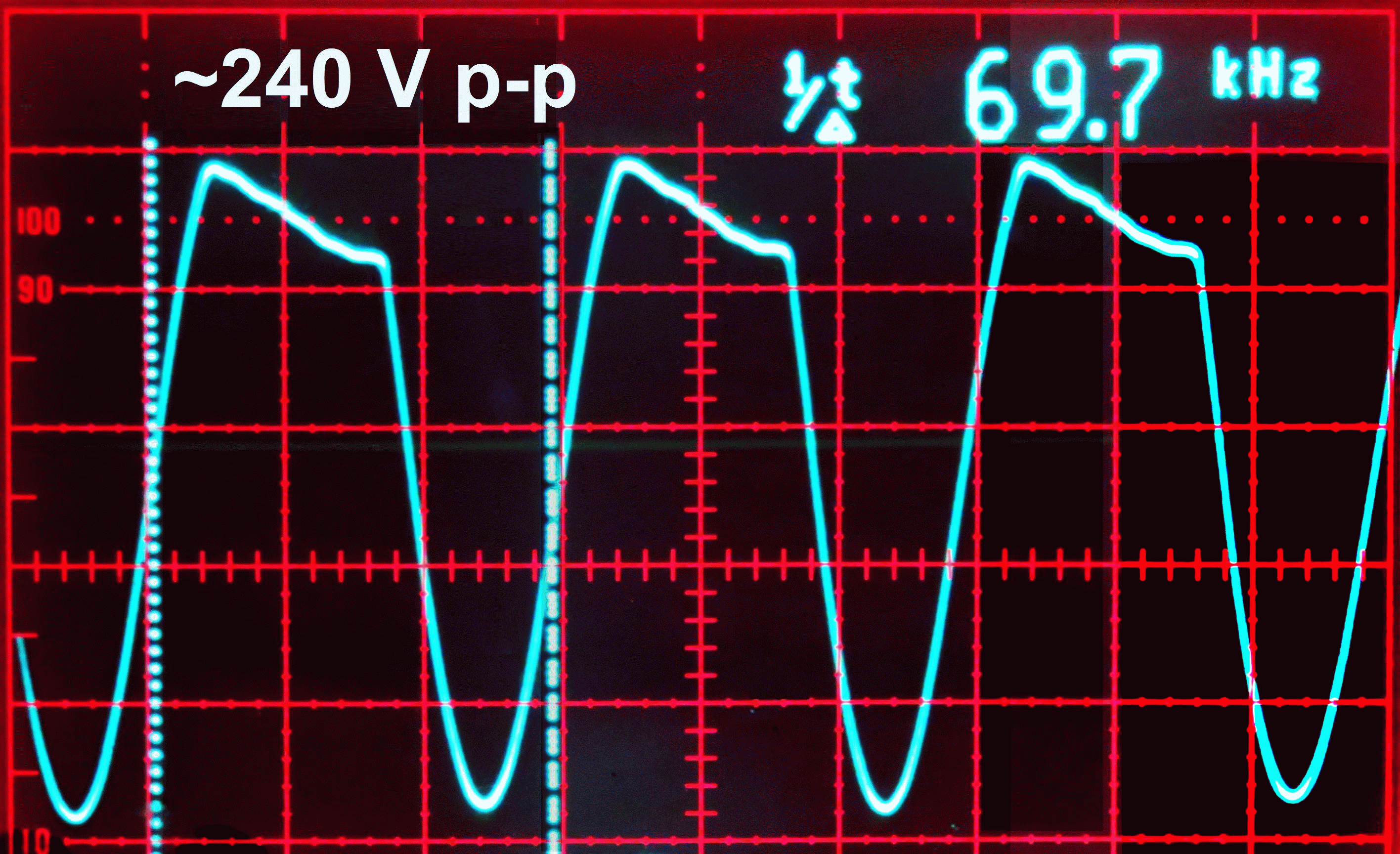

    While searching for another one to dissect, measurements of the SWM frequency provided a clue as to the design changes. A 6 turn sense coil was placed under the lens, which as before was determined to be the optimal location for a strong signal, probably in close proximity to the ferrite HV transformer(s). Rather than 77 kHz as in the original AF-S lens, the frequency for the AF-S II is around 290 kHz (!!) which was originally assumed to indicate a much smaller motor (though this turns out not to be the case, more below).
    When the focus ring is moving, the pulse width may be up to around 700 ns. But there is still a detectable very stable ~100 ns spike at the same frequency with similar amplitude for several seconds after the camera has beeped indicating that optimal focus has been achieved, not only while the focus ring is moving. So it is likely from the same source and not just pickup from the logic, perhaps a sort of dither to minimize stiction in the mechanism between focus operations.
    But it turns out that the SWM itself appears to be physically identical in both lenses. And the gear reduction is also similar. Then I thought perhaps the higher frequency was selected to be able to smaller magnetic components, but this also turns out not to be the case. So my conclusion now is that the higher frequency may have been selected primarily because it permits faster focusing or because of complaints from local bats. ;-)
    The physical size reduction of the VR II lens is thus accomplished by mostly clever packaging. ;-)

    Parts Naming
    (Some or most of these may not agree with how Nikon sees it as no internal diagrams or parts lists are available.)
    And should anyone actually read this before the warranty on the Universe expires and has specific questions or requests, I may be contacted via the Sci.Electronics.Repair FAQ Email Links Page.

    Autofocus only Works Over Limited Range on Nikon AF-S DX Nikkor 18-55mm f/3.5-5.6G VR II Zoom Lens
    The following most likely applies to other AF-S lenses and in part to others. A Web search will turn up cases of generally similar autofocus problems. For example: Focus Hunting Problem in AF-S Nikkor 24-70mm 1:2.8 G ED Zoom Lens and Nikon Lens repair: Broken Autofocus on a AF Nikkor 28-70mm Zoom Lens. These both involved a dirty or damaged encoder to be the cause, similar to my conclusions (below) based on the symptoms prior to internal examination of this lens and before finding these videos. Problems like this do tend to have simple causes.
    This lens (Nikon AF-S DX Nikkor 18-55mm f/3.5-5.6G VR II ID #4) works perfectly in all respects from its closest focus to around 2 feet. It will go back and forth between those distances all day without issues. But beyond there, it will never move the focus ring to get closer, and at some point it will jam against the end-stop beyond infinity.
    This is a works in progress but here are some observations:
    My current hypothesis is that the encoder that reads focus position is either not working correctly or has perhaps become disconnected. So the lens's microbrain is getting confused, poor thing. ;( ;-) Among other things it's not being programmed to provide the necessary torque to focus in from near infinity, and it's overshooting infinity, hitting the end-stop and getting really stuck there. Monitoring of the SWM waveform appears to show that it is trying but almost certainly attempting to rotate the focus ring in the wrong direction. With the high gear ratio, it should have no problem backing away. The only way to unstick it if jammed is to flip the A/M switch back and forth. However, even if not jammed, it will still not focus in from more than around 3 feet to infinity. It will focus reliably from the closest spec'd distance to around 2 feet, though it may overshoot dramatically but doesn't jam. All these lenses sometimes overshoot especially if there little detail in the focus zone.
    Since there is a definite boundary beyond where it screws up, this would appear to rule out an SWM or gear train problem. The SWM rotor and all gears except the one on the focus ring itself go through multiple revolutions over the focus range. The rotor of the SWM itself goes through ~2.75 revolutions for each revolution of the focus ring drive gear and that goes through nearly 2 complete revolutions to move the focus ring from end-to-end.
    So this is probably a control problem. The only inputs to the microbrain are the tachometer (a magnetic strip with read head) and the focus encoder (which senses the absolute position of the focus ring). It's possible the magnetic pattern the tachometer uses has been partially erased, but the most likely cause is the focus encoder: Nikon AF-S DX Nikkor 18-55mm f/3.5-5.6G VR II Zoom Lens Focus Encoder Coding with the bits color coded and labeled with the binary value at each position. More on these encoders can be found in the section: Nikon AF-S DX Nikkor 18-55mm f/3.5-5.6G VR Zoom Lens. But interestingly, the focus encoder in the Nikon AF-S DX Nikkor 18-70mm f/3.5-4.5G ED IF Zoom Lens also has 4 conductive strips and 6 bits, but the coding differs, which really doesn't make any sense unless each new Nikon designer is required to change something as a test. ;-)
    If you're not totally confused, you weren't paying attention. ;-) But to reiterate: It is most likely that the focus encoder is either feeding bad readings to the microcomputer or they are being misinterpreted.
    No doubt disassembly of this lens will be required at some point, to satisfy my curiosity if nothing else. Hopefully the problem will be something obvious like a damaged focus encoder brush, loose connector, or some dirt or soda residue on the encoder strip. ;-) However, based on the dissections (See above), this requires fairly significant surgery, so it may be postponed until Major Medical insurance coverage is available. ;-(
    Repairing Broken SWM Gear Shaft in Nikon AF-S DX Nikkor 18-55mm f/3.5-5.6G VR II Zoom Lens
    This is the gear between the SWM itself and the Focus Gear that engages the drive gear on the Focus Ring. The shaft is part of the Fixed Barrel and thus made of the same plastic as the structure. While it isn't likely to break during normal use, it can get stressed when going inside to repair something else, particularly during the removal or replacement of the Fixed Shell.
    If it fractured at its base, the original shaft can be reused but if it fractured in the middle, a substitute shaft will be required which can be made of metal. Note that the original shaft is NOT a constant diameter but is thinner at the top. It is not known whether this is essential if a replacement shaft is used. It probably allows for a larger tolerance in the positioning of the metal fork of the Autofocus A/M switch.
    Either way, a hole will need to be drilled perfectly centered and square in the Fixed Barrel so that a replacement shaft can be installed. The diameter at the base is approximately 0.045 inches but this should be confirmed. Ideally it will be a press-fit without requiring adhesive.
    1. Refer to the instructions in the section: Nikon AF-S DX Nikkor 18-55mm f/3.5-5.6G VR II Zoom Lens Disassembly and follow them to the step where the Fixed Shell is removed along with the SWM and Focus Gears.
    2. Arrange for any protruding cables to be well away from the area of the SWM Gear shaft.
    3. Using a drill press and 0.040" bit, very carefully drill a hole to a depth of around 3/32".
    4. Test to see if the broken or replacement shaft will fit the hole. If close, it can be widened with the tip of a needle file or a slightly larger drill bit. But avoid going oversize.
    5. Once the replacement shaft just barely fits in the hole, it can be gently pressed into place. Using a bit of non-softening plastic adhesive may be worthwhile.
    6. Check the fit and then following the reassembly instructions.
    A Tail of Two Nikon AF-S DX Nikkor 18-55mm f/3.5-5.6G VR II Zoom Lenses
    These were purchased as "For Parts or Not Working" on eBay and are IDs #9 and #10, above. ID #9 would attempt to focus with some hunting but usually would give up. Sometimes it signaled focus lock but even then it would often not be anywhere near the correct focus. VR appeared to work. ID #10 was not recognized by the camera at all.
    So the plan was to see what would happen if the main PCB from ID #9 was swapped into ID #10. Accessing the main PCBs in these lenses is relatively straightforward. The only annoyances are (1) there is a soldered ground wire and (2) the flex-cable for the gyros is nestled under the PCB and a bit of a pain to get at. But other than those, it's just screws and flex-cables. The transplant was performed without incident. Autofocus appeared to work flawlessly but there was a horizontal "jump" to one side and back in the image in the viewfinder when the camera was powered on indicating an issue with VR. In fact VR appears to be dead after the jump. This probably means it is unable to initialize. It may be that the horizontal gyro is defective or that the aforementioned cable wasn't installed properly (though I rather doubt that). In the end, it was decided to simply unplug the flex-cable for the VR actuator and live with no VR on this lens. That's probably a fair trade. It's also not known how closely matched VR is to the specific lens, so even it VR did work, it might not be optimal. Another observation for lens ID #10 was that one of the metal shims between the plastic ring and lens body was corroded indicating possible water damager, though everything else including the optics appear pristine.
    I was expecting that a swap of the PCB from ID #10 into ID #9 would result in a lens that is not recognized.
    But before then I decided to check for continuity from the camera contact strip to the PCB and discovered that there was an open circuit to the contact at one end. Indeed, the flex-cable is tearing where it passes the edge of the PCB. So I figured I would swap it with a flex-cable from the VR II lens in the dissection which was thought to also have a dead PCB. But that flex-cable, too, is torn. So this must be a common problem. Whether it is caused by rough handling during disassembly or reassembly, or a design flaw is not known. Now I need at least 2 good flex cables for the 18-55mm VR II lens. ;-)
    Replacing Torn Camera Contacts Ribbon Cable in Nikon AF-S DX Nikkor 18-55mm f/3.5-5.6G VR II Zoom Lens
    This was first done on AF-S 18-55mm VRII lens #11, which originally had a very cockeyed front zoom barrel. That was corrected with some rather un-gentle persuasion and mechanically. The lens appears fine with perhaps just a bit of stiffness over a portion of the zoom range, though probably nothing beyond normal sample-to-sample variation. But the lens was not recognized by the camera. At that point I was sorry I didn't check it before correcting the mechanical issue suspecting that perhaps the "repair" was at fault. However, upon initial interior inspection, it was found that the Camera Contacts Flex Cable was torn cleanly in half. This may have been caused by the previous owner's attempts to repair it though - it could not have been by the trauma or its remedy.
    A crack or even clean break at the crook of the elbow of this ribbon cable appears to be relatively common with these lenses. So common in fact that replacement cables are readily available on eBay, even in two-packs.
    With a bit of care, replacement is straightforward. It is among the simplest of the "in-lens" repairs:
    1. Remove the two screws securing the Camera Contacts Assembly.
      Remove the three screws securing the Trim Ring and take it off.
    2. Set zoom to the 55 mm position. This retracts the rear lens assembly forward so it is out of the way.
    3. If the cable is totally torn, the Camera Contacts Assembly can be removed. And there is no practical way to repair a slightly torn cable even if just a single conductor is severed, so feel free to complete the tear. ;-) However, keeping whatever is left of the cable intact will provide a feel for minimizing stress on it during reassembly.
    4. Remove the three screws securing the Bayonet Mount Ring to the body of the lens. Lift it straight out along with the metal and plastic spacers. Keep them together so their relative orientation won't be lost. Note location of the spring ground contact pin poking up from the main lens assembly and where it goes in the Bayonet Mount Ring and spacers.
    5. Carefully pull off the three small ribbon cables. There are convenient holes in the tabs that may be used. Avoid scratching anything underneath.
    6. Remove the two screws securing the Main PCB.
    7. Lift the Main PCB with the long ribbon cable so it detaches from the socket inside the lens. This may be easier than attempting to pull it off side-ways.
    8. Carefully flip the Main PCB over without detaching the soldered ground wire.
    9. Pull off the remains of the Camera Contacts Ribbon Cable tab. There may be some adhesive to keep the middle portion from moving around.
    To prepare the replacement:
    1. The mating portion of the Camera Contacts Ribbon Cable Assembly has a series of eight gold-plated pads held against the actual metal contacts with a metal locking strip.
    2. With the Camera Contacts facing down, slide the metal strip off to release the ribbon cable. If this is done carefully, the metal contacts won't fly all over the place.
    3. Remove the remains of the old ribbon cable from the locking strip.
    4. Peel off the paper protecting the adhesive over the new ribbon cable and then stick on the locking strip taking care that it is in the same orientation and position.
    5. Slide the locking strip with cable back under the tabs securing it.
    Reassembly of the lens is now just the reverse of disassembly. Zoom should remain set to 55 mm. Take particular care not to stress the flex cable during the process. Or else you'll be doing this all over again. :( ;-)
    Nikon AF-P DX Nikkor 18-55mm f/3.5-5.6G VR Zoom Lens
    I have not found a repair manual or even an exploded diagram for this lens or any other AF-P lens. If anyone has one, please contact me via the Sci.Electronics.Repair FAQ Email Links Page.
    Nikon AF-P DX Nikkor 18-55mm f/3.5-5.6G VR Zoom Lens Description
    The following applies directly to the Nikon AF-P DX Nikkor 18-55mm f/3.5-5.6G VR Zoom Lens and mostly to the non-VR version as well. If fact, the only way to casually tell the difference is the lack of a "VR" on the body.
    This AF-P lens is optically very similar to the AF-S versions, above, but with one additional lens element. However, it uses the Nikon so-called "Pulse" technology (thus the "P" in AF-P) for autofocus instead of the "Silent Wave Motor" (SWM, or S in AF-S). Pulse autofocus is based on a stepper motor and does indeed appear to be quieter than silent. ;-) While SWM uses a piezo motor driven at an ultrasonic frequency (above human hearing) which in itself should be very quiet, the motor's rotating surface plate in contact with the actual PZT element, associated gear train, and other rotating parts makes detectable noise.
    So AF-P lenses return to motor technology with magnets and coils. ;-) As noted above, the "P" is supposed to stand for "Pulse", which kind of applies. They are claimed to be even quieter than AF-S lenses and that is probably true. The manufacturing cost is also much lower. ;-) And there have been comments on various forums about AF-S autofocus reliability, which is quite credible given their complexity and opportunities for contamination to get to the motor. And that they run on several hundred volts! So perhaps a little of both. Replacing the piezo motor with a stepper motor also allows the AF-P lens to be more compact since the motor itself is less bulky and the high voltage drive components and gear train are eliminated.
    However, AF-P lenses are not compatible with the D5100 or D3200 (or earlier) cameras that are happy with AF-S lenses. Others like the D5200 may need a firmware upgrade (but that is a free download). And since there is no VR switch on the AF-P lens, VR is always enabled on these cameras since there is no electrical contact in the camera body to control it. (The AF-P version has 8 contacts compared to 7 on the AF-S.) But this incompatibility is almost certainly due to a business decision for planned obsolescence. There would not appear to be any reason why an AF-P lens could not have been designed to look like an AF-S lens as far the the autofocus commands are concerned. Or at worst, with a way of selecting the mode via a switch
    The AF-P 18-55mm lens is also significantly narrower than the AF-S VR lens and very slightly narrower than the AF-S VR II lens which could be in part due to the more compact drive setup. The piezo motor has a relatively large diameter (almost 1/2 inch) and the gear train also takes up space. For smaller lenses like these, the only option is to increase its overall diameter. The stepper motor with its direct worm drive can greatly reduce the required space.

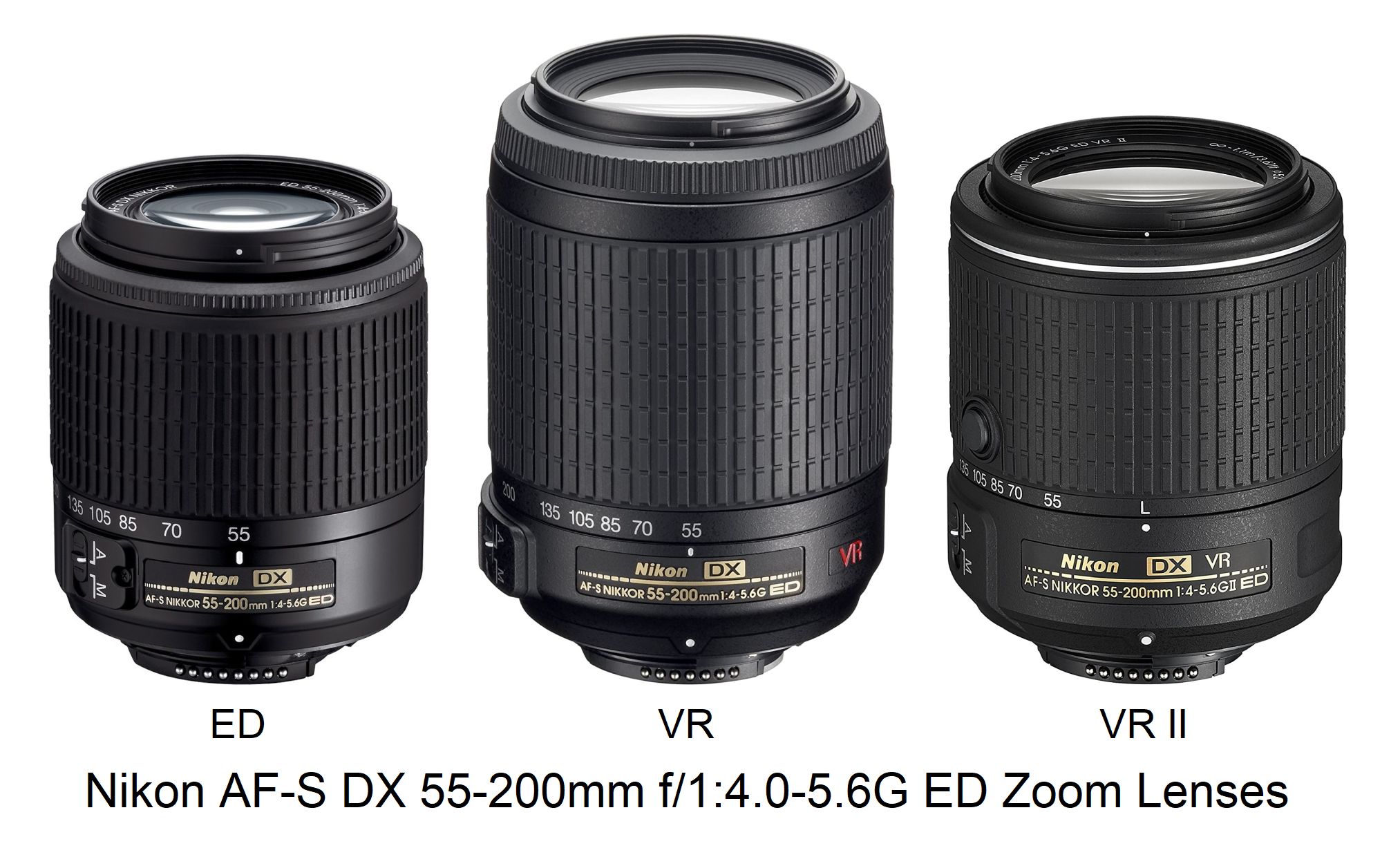

    Comparison of Nikon AF-S DX 55-200mm Zoom Lenses
    These are a popular 2nd lens after the kit lens as they cover the long telephoto range from 55 to 200 mm (equivalent to approximately 83-300 mm for the full frame FX format). Given the weight of the 18-300 mm lenses, carrying around this pair makes a lot more sense unless one needs to instantly switch from wide angle to telephoto (or would like to go into arm wrestling). The 18-200 mm lenses are HEAVY. But one deficiency with 55-200mm lenses is that the closest focus distance is not so close - 0.95 to 1.1 meters depending on the specific version.
                Gener-   (1)     Auto-   Focus     Focus       Manual       Year
       Model    ation   Optics   Focus  Encoder  Tachometer    Focus     Introduced
     AF-S ED      1   2C/9G/13E   SWM     Yes     Magnetic   Mechanical   2005?
     AF-S VR     1.5  2C/11G/15E  SWM     Yes     Magnetic   Mechanical   2007?
     AF-S VR II   2   2C/9G/13E   SWM     Yes     Magnetic   Mechanical   2007?
    1. E: Lens Elements; G: Lens Groups; C: Lens Clusters. Lens Elements are individual optics which may be glass, Extremely low Dispersion (ED) glass, or plastic, and may be normal (spherical) or aspheric. Lens Groups may be a single Lens Element or a glued combination like an achromat. Lens Clusters are my terminalogy for the sets of Lens Groups that move when changing the zoom setting. There will also be a focus group which will be part of one of the lens clusters and moves with respect to it. See the specific lens architecture diagrams in the lens dissection Web Albums for details. A Web search for the specific model lens may also turn up more on the optical design.
    2. It is interesting that the VR II may be more similar to the ED than the VR, although it is not yet known if the actual lens elements are the same.
    A montage showing stock photos of all known versions of the 55-200mm lenses as of 2022 may be seen at: Nikon AF-S DX 55-200mm f/4.0-5.6 Zoom Lenses. These are from Nikon lens product or review pages (copyright © Nikon Corporation) scaled so the relative sizes are close to correct. What's remarkable is how much larger the VR version is compared to the others. And then with the VRII it seems they decided "never mind". ;-)
    More to come.

    Nikon AF-S DX 55-200mm f/4.0-5.6G VR Zoom Lens
    I have not found a repair manual or even an exploded diagram for this lens. It is quite different than the original ED version or the VR II succesor in external construction and possibly optical architecture. If anyone has one for this lens, please contact me via the Sci.Electronics.Repair FAQ Email Links Page.
    I have four samples of this lens:
    Nikon AF-S DX Nikkor 55-200mm f/4.0-5.6G VR Zoom Lens Description
    The 55-200mm VR lens is the largest and heaviest of the three which makes it much less desirable than the VR II version. It uses the typical SWM but with a fully enclosed gear train and a drive frequency of around 70 kHz based on measurements using a sense coil and scope.
    Nikon AF-S DX Nikkor 55-200mm f/4.0-5.6G VR Zoom Lens Disassembly
    This is only partial at present down to the level of exposing the SWM and PCBs.
    1. Remove the single screw securing the Switch Panel, swing it out revealing the interior of the Switch Bay, Unplug the flex cable by flipping up the locking level or by holding the connector with a pair of tweezers and pulling it out.
    2. Unsolder the thin grounding wire from the pad. Alternatively, cut the wire leaving enough at either end to strip solder during reassembly. Only if you do not have any way to solder should you consider unscrewing the grounding contact assembly from the Bayonet Mount which will be exposed when the Bayonet Mount is removed. It's almost impossible to get this back together without more hands than are standard equipment.
    3. Remove the 3 screws securing the Inner Ring and remove it.
    4. Remove the 2 screws securing the Camera Contact strip and gently push it toward the center of the lens so it is loose.
    5. Remove the 3 screws securing the Bayonet Mount. Lift it up and disengage the Aperture Tang from the prong on the iris diaphragm. Unlike most other lenses, this does not slip in place - the prong should bd lifted as far from the lens as it will go and then it should disengage. but it may be necessary to gently push the iris prong toward the center of the lens with a thin tool. This may require zoom to be set away from the 55 mm position.
    6. Add a small dab of 5 Minute Epoxy or something similar to the ground contact where the wire is soldered. Otherwise there's a good chance it will break off with even modest handling.
    7. There are anywhere from 1 to 4 or more shims under the Bayonet Mount. Label them as to orientation and top/bottom. If more there is more than one, also label their position in the stack though it really shouldn't matter. So arrange them with the thickest one on the back (top) which will make it easier to set them in place during reassembly. Sticking them together with adhesive in a way that doesn't change the overall thickness would also greatly simplify the fiddlyness of reassembly where more than one shim is present. A single wrap of thin Kapton tape away from any of the screw holes may be satisfactory. FWIW, ID #1 had a single thick shim while ID #2 had 4 - two thick and two thin. My guess is that a combination of binary thicknesses (i.e., 1, 2, 4, 8 units) of shims is selected during final testing to fine tune the optical location of the lens with respect to the camera body. Or something. ;-)
    8. Remove the Fixed Shell.
    At this point, everything that is simple to get at on the back of the lens is exposed.
    1. Remove the Rubber Grip by carefully lifting it along one edge and working it free of the Zoom Barrel.
    2. If it is desired to inspect the Zoom Encoder, peel off the tape securing the black cover sheet. It can be replaced with Kapton tape.
    More to come.
    Nikon AF-S DX Nikkor 55-200mm f/4.0-5.6G VR Zoom Lens Reassembly
    To use the lens on a camera without the Fixed Shell to inspect its innards or probe signals like the SWM drive, simply leave the Fixed Shell off during reassembly. The lens won't be quite as robust without it and high voltage (~240 VAC) will be present on some components and solder pads when focusing, but with care it should be perfectly satisfactory for testing at least. CAUTION: This stunt appears to be acceptable for the 55-200mm VR lens but may not be for some others where the closeup and/or telephoto zoom limits depend on stops on the interior of the Fixed Shell. For those, bad things may happen if rotated beyond them! ;-(
    Reassemble in reverse order. The most fiddly part of reassembly (after making sure the shipm stay in place) is probably reattaching the ground wire. If soldering back to the pad on the flex cable, cover the edges of the Switch Bay with Kapton tape or something similar to protect the plastic from accidental contact with the soldering iron tip. The wire was cut, stip the ends and solder them together, finally insulating with Kapton tape, plastic electrical tape, or a glob of 5 minute Epoxy. Coming someday.
    Nikon AF-S DX Nikkor 55-200mm f/4.0-5.6G VR Zoom Lens Dissection
    The start of a dissection is available at Nikon AF-S DX Nikkor 55-200mm f/4.0-5.6G VR Zoom Lens Dissection Web Album. So far it goes only as far as was required to repair ID #2 and described in the disassembly steps, above.
    More coming soon.
    Nikon AF-S DX 55-200mm f/4.0-5.6G VR II Zoom Lens
    I have not found a repair manual or even an exploded diagram for this lens. It appears more similar to the original ED version than the VR predecessor in external construction and possibly optical architecture, but with VR and the Lock button added. If anyone has one for this lens, please contact me via the Sci.Electronics.Repair FAQ Email Links Page.
    This is a rather nice relatively compact lightweight lens. It looks somewhat like an AF-S DX 18-55mm VR II lens on steroids and only very slightly larger than the 55-200mm ED version, both of which are shorter than the VR version.
    Since neither of these is really broken, the search is on for a third speciment for dissection and to repair ID #2.
    Nikon AF-S DX Nikkor 55-200mm f/4.0-5.6G VR II Zoom Lens Photos and Description
    The 55-200mm VR II lens is the most compact of the three which makes it much more desirable than the VR version. It uses the typical SWM and gear train but with a drive frequency of around 290 kHz based on measurements using a sense coil and scope. It also has the dither pulses continue for a few seconds after focusing like some of the other AF-S lenses.
    The start of a dissection is available at Nikon AF-S DX Nikkor 55-200mm f/4.0-5.6G VR II Zoom Lens Dissection Web Album. But only stock photos, dimensions, a partial optical architecture diagram, and external photos.
    More coming soon.

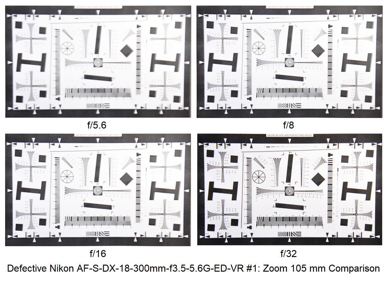

    The first sample of the f/3.5-5.6 version I purchased for study and possible dissection is really well used: The gold lettering is totally gone, the plastic underneath is even worn, and most of the exposed plastic surfaces have a shiny appearance. It largely works but takes truly lousy pictures. :( ;-) That's what I expected as the description stated: "the image quality is not sharp". That is totally accurate but perhaps an understatement! In fact, a pinhole camera would take better pictures. Yet there are no obvious mechanical problems - zoom and manual focus are smooth and consistent. Nothing rattles and it shows no sign of serious trauma except for some small chips on the edge of the filter ring. But the focus, zoom, and filter rings appear to be well aligned with only the typical small amount of free play that these lenses tend to have. Autofocus is fairly reliable except perhaps when zoom is near 18 mm. This may be a clue, though manual focus works over the entire range. VR works well as confirmed on my VR Test Rig. But the image quality is totally dreadful at large apertures and even when stopped down to f/32, there is serious fuzziness and color fringing over a large part of the frame especially when zoomed way in (300 mm). This suggests that a lens element or lens group may have come loose and is sitting at an angle, though the interior looks pristine with no visual evidence of misalignment or wondering elements. All the visible optical surfaces are clean without any evidence of fungus, dust, deterioration of the AR coatings, or other unsightly blemishes. The behavior can only really be attributed to misalignment of one or more elements. The label on the front is dented in one location and rotated almost 180 degrees from the normal orientation with "Nikon" at the top, so someone has probably at least removed the label and perhaps the 1st Lens Group to look inside and at the very least, they didn't pay attention to the label when it was reattached. It has no keying so that doesn't imply anything about much of anything. I can't tell if the 1st Lens Group was removed for any reason but there is a mark on it that lines up with the white dot on the Filter Ring so it's probably installed correctly. Such major abberations wouldn't even seem likely from simply being misoriented in any case. But if an asymmetric shim was out of place, that would not be obvious. I have seen at least one instance on another lens where there was only a partial shim ring. The inside looks pristine. And if any parts were left out ;) or installed incorrectly, it almost certainly would not work as well as it does, even if that isn't saying much. ;-)
    I also have a near-mint 18-300mm f/3.5-5.6 lens. But based on a quick visual inspection, it appears physically identical when viewing the inside front and back, zoomed in and out. But almost any random shot taken with it is far superior to anything the defective lens is capable of even when stopped way down.
    So I decided to see of changing the orientation of the 1st Lens Group or the location of any shims would make a significant difference.
    My conclusion is that the cause of the poor performance has nothing to do with fine alignment of the 1st Lens Group. It's so bad that those things are buried in the weeds. So back to square one.....
    Here is a montage of shots taken of a test chart at around 105 mm and f/5.6, 8, 16, and 32): Defective Nikon AF-S-DX-18-300mm-f3.5-5.6G-ED-VR #1: Zoom 105 mm Comparison. Zoom of 105 mm was selected simply because the chart filled the frame. (70 mm would be closer to the mean between 18 and 300 mm.) But it's no better anywhere else.
    Next, a HeNe laser beam was passed through the lens as on-axis from the input side aligned so that it passes centered through the stopped-down aperture. The beam has a near-perfect Gaussian profile with negligible scatter. The objective was to both look for the character of the reflections from the internal lens elements, and for any degradation of the quality of the Gaussian beam on a screen placed after the lens.
    On the good lens, there are a multitude of reflections but they are very weak as would be expected from high quality anti-reflection coated surfaces and can be totally superimposed in the reflection. On the bad lens, there also a multitude of reflections but 1 or 2 cannot be superimposed on the others. Exactly where they are coming from is unknown but is probably from an element before the aperture. The reflected spot is very small suggesting it is near the front of the lens but that can be confusing due to the combination of positive and negative lens elements. At first there was a bright off-axis spot which I got excited about. But that turned out to be a red herring: It was from the cheap non-AR-coated UV filter on that lens but not the other. The bad lens shows a bit of interference fringes on the transmitted beam while the good lens does not. These tests were done at a zoom setting of 18 mm. I'm not sure I'm determined enough to repeat them at 300 mm without a more stable fully adjustable test setup. ;-)
    So the 18-300 mm question is: Having eliminated 1st Lens Group alignment from consideration, what is the most likely part to fail from a minor traumatic event like whacking the filter ring or just from wear and tear? If the VR armature or its lens popped off the suspension or got stuck to one side, VR would not work at all. But VR works great. If any other lens group came off its tracks, there would be obvious problems with zoom or focus. Only if a lens element or elements) came unglued within their housing(s) could there be optical problems but no mechanical problems. If anyone actually reads this stuff ;-) and has a similar experience, knows the answer, or even has a wild guess, please contact me via the Sci.Electronics.Repair FAQ Email Links Page. For now, I'm not intending to go any further inside.
    Of note is that even perfect specimens of the 18-300mm f/3.5-5.6 lens have significant distortion and chromatic aberration of varying degrees over various portions of the zoom and focus range. Achieving decent performance over a greater than 16:1 zoom range is challening. But modern DSLRs digitally process the images to largely correct both geometric distortion and color fringing using lens-specific data stored in memory (part of the camera firmeware). So the end-user may never see most of these. unless they are obsessive-compulsive and search for defects like that. It may be surprising how mediocre its performance really is when viewing the raw image data. And this lens has 19 lens elements. That's 38 anti-reflection-coated surfaces the light must traverse, which will have some effect on general sharpness, flare, etc. (But none of that can be corrected in-camera.)
    Being slightly disappointed with the performance, I even contacted Nikon via their Website with the serial number to see if they would tell me anything about that specific lens but of course that was hopeless. Their reply was that they don't have any information and suggested that I send it in for service. ;( ;-)
    And a trivial triviality common to both (and I assume to all of these): The zoom marking for 200 mm seems to correspond more to somewhere between 225 and 250 mm, NOT 200 mm based on the image size compared to the 300 mm position. I've not seen any mention of that in the reviews of this lens or on Nikon lens forums.
    How far it goes will depend on when - if ever - the cause of the lousy pictures can be found. My guess is a lens group that has been knocked out of position, or perhaps the VR Lens Group even though VR appears to work well. If one of the springs in the VR assembly popped off, VR might still appear to work.

    And a note: This is the only lens I've come across so far where parts like the Filter Ring and Front Lens Cluster can be removed and replaced without peeling off and distressing any labels (or at least not by much!). Both the outer label with the printing and the inner one that only serves as a bezel can be left in place. Use a grippy rubber "tool" like a piece of bicycle inner tube or something sticky like masking tape to grab the area of the outer label at two diametrically opposite locations near the edge and rotate it counter-clockwise. That's it for the Front Lens Cluster: The entire thing simply unscrews!. Then the Filter Ring can be taken off by removing 4 screws. (There are three notches in the mounting ring for the Front Lens Cluster, hidden by the inner blank label. Those no doubt would be used by Nikon.) It's possible that there is supposed to be some type of adhesive or thread locker to prevent the Front Lens Cluster (in particular) from loosening on its own, but there was no evidence of any on the 2 lenses that were disassembled. When tight, the "NIKKOR 10-20mm VR" on the label should line up with the top (index mark) of the lens. However, this may not be true if swapping parts between lenses particularly if the Spacer thickness differs, since that label would be the last thing to be added after final assembly. Thus there may be one or more Spacers behind the Front Lens Cluster thickness-coded by color or material. These should stay with the specific Front Lens Cluster. That collection of 4 lens elements - two that are highly curved - may differ by a fraction of 1 mm in effective focal length from one sample to the next and the Spacers compensate for that. It's also a good idea to mark the Spacers as they are removed as to orientation and top/bottom since they can go back multiple ways but only one will allow the Filter Ring mounting screws to pass through and reach their holes. If the Spacers aren't the correct thickness, near or far focus (at the very least) may not be achievable.
    And in the "Well, that's interesting department": With the Front Lens Cluster removed entirely, optimal focus is just beyond the Filter Ring and it will take closeup photos. Approximately 1.5 and 0.75 inches fill the width of the DX frame with Zoom at 10mm and 20mm, respectively. At 10mm, there is a fair amount of pincushion distortion but at 20mm distortion is minimal. And any decent photo editing program should be capable of compensating. ;-)

    As an example of a common much larger lens, see the diagrams in Nikon AF-S DX Nikkor 18-200mm f/3.5-5.6G VR Zoom Lens showing Lens Group Positions at 18 and 200 mm. Lens Group 3 and the VR assembly move together, but those and all the others move relative to one-another and relative to the lens structure attached to the Nikon F mount.
    Even on a brand new lens, there is detectable roughness and varying resistance over some parts of the zoom range. Over time, the lens will be exposed to dust, moisture, and contamination either from normal use or from being tossed in a storage bag, it gets worse as there are no real seals. And plastic is subject to wear. The good news is that for the most part, none of this makes any real difference in picture taking performance. That is, until the thing seizes up completely or falls apart. :( ;-)
    But if the lens is dropped or whacked, parts like those pegs can get broken off or may dig into the tracks with varying degrees of damage. In minor cases, the roughness will just become worse but with enough trauma, major functions will stop working. When considering the purchase of a used lens, carefully check autofocus, manual focus, and vibration reduction, as well as for correct operation of the aperture at all zoom settings. Don't accept a lens where manual focus doesn't work reliably even with a discount (as I once did) because the seller said no one ever uses it. While that may be partially true, unreliable manual focus can be a symptom of more major problems. One thing that is often broken on used lenses though is the Lock button if there is one, used to secure the lens in a compact state for storage. The internal lip that the button engages is made of plastic and users often attempt to twist the Zoom Barrel without realizing it's locked, so that lip gets damaged and the button non longer works properly. That alone is probably not sufficient reason for rejecting a lens - but perhaps it may be leverage to negotiate a discount! While Lock may not work or work well, the end-stops for the Zoom Barrel should not be affected. But this should be confirmed as bad things may happen on some lenses if the Zoom Barrel is rotated beyond the normal range.

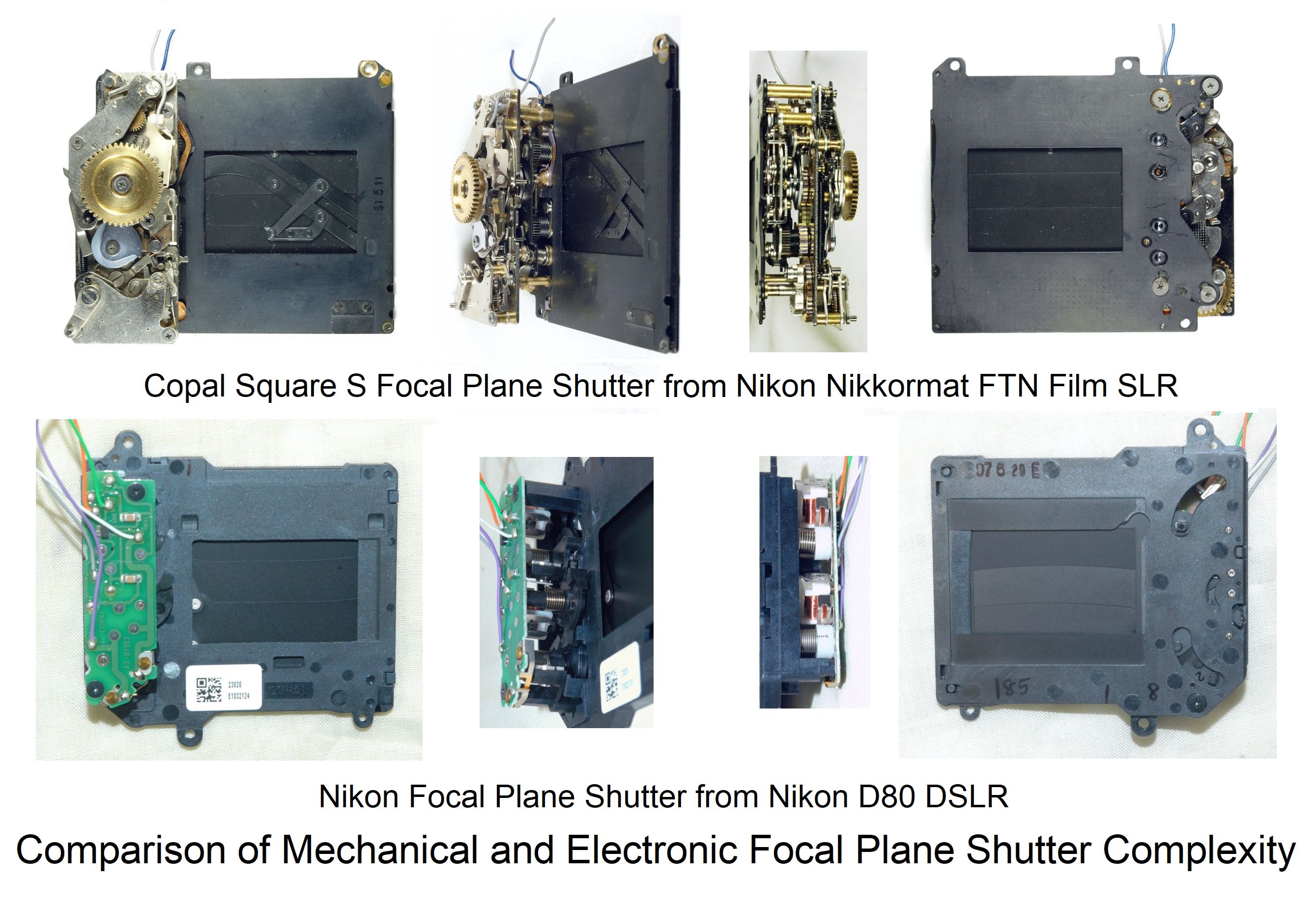

    Mechanical versus Electronic Shutter Complexity
    For all except camera geek types, this is probably just in the "that's interesting department". ;-) Mechanically-controlled shutters - both leaf and focal plane type - are designed along the lines of precision time-pieces with springs, gears, cogs, escapements, and levers that open and close the leaves or blinds. But whereas clocks are supposed to run at a fixed rate, shutters typically have 10 or more speeds. Electronically-controlled shutters use a pair of solenoids to determine the timing based on signals from a microcontroller. As an example, see: Comparison of Mechanical and Electronics Focal Plane Shutter Complexity. The Copal Square S shutter on the top is from a Nikon Nikkormat FTN 35 mm film SLR; the one on the bottom is from an older Nikon D80 DSLR. (The photos have been scaled so that they are approximately the same size independent of the FX and DX formats.) To fine tune the mechanical shutter requires the adjustment of the torque provided by some springs, the position of specific parts, and even the selection of slightly different parts based on actual timing measurements. And even then, the actual shutter speeds may only be accurate or repeatable to within ±10% on a good day. For the electronic shutter, it is just firmware code which could be optimized automatically after assembly. ;-) Shutters in other DLSRs where control of the sensor itself is NOT used to determine exposure at any speed would be similar. For those cameras where the sensor is used as the high speed shutter like the D70, they would be even simpler. In principle, there should be no need for any mechanical shutter in a DSLR or mirrorless camera but for practical reasons, this is rarely - of ever - the case. But point-and-shoot cameras generally do NOT have a mechanical shutter of any kind.
    Copal Square S Focal Plane Shutter
    The original Nikon F used a horizontally-moving focal plane shutter with fabric curtains. The fastest flash sync was 1/60th of a second. The Nikkormat FT/N use a vertically-moving Copal Square S focal plane shutter with metal "Venetian Blind" panels with 3 slats each. It can flash sync at down to 125th of a second. The Copal Square S shutter is an example of the state-of-the art in mechanical shutter design. It is described as a workhorse which really doesn't break, though as with any mechanical system, may require cleaning and lubrication after a half century or so. However, it is common to find these dating from the 1970s or earlier in perfect operating condition. At first glance, the mechanism might appear to be too complex to have ever been designed by humans. Think of a mechanical pocket watch with 11 speeds. But it evolved from or in parallel with leaf shutters that have similar timing requirements.
    See the Web Album at: Copal Square S Focal Plane Shutter Mechanism. (The Web Album photos are scaled to fit within 1024x768 pixels but the full size originals have the name under the thumbnail with a ".jpg" added.) The first 4 photos are of a beat up Nikkormat FTN in various stages of disassembly starting with most of the pieces of the lens mount in place to revealing the Copal Square S shutter in situ. These are followed by closeups of another similar shutter. The primary difference between them is the use of a less expensive Nylon gear for the speed select compared to the highly polished brass one, and some slotted head screws in place of Philips head screws. Since there is no real stress on that gear, cheaper is just fine, thank you. ;-) My black dot on the white gear lines up with the post for the 1 second setting. In the interest of full disclosure, I have swapped the gear and screws to make the separate shutter mechanism more photogenic. And in the interest of expediency, the screws that secure the body parts have been left off. ;-)
    Two manuals relating to Copal Square S Shutter repair are known to be available on the Web and hard copies may be purchased on eBay and elsewhere. Both Copal Square S Shutter Repair Manual and Copal Square S Shutter Repair Guide are interesting reads, but they may not enable you to be able to do much in the way of repair. The first one does have a 75 (!!) step procedure with diagrams for assembling a shutter. ;-) Aside from the intricate nature of these mechanisms, special jigs and instruments are required for some of the procedures. However, cleaning and lubrication of specific parts may be possible. This will involve the use of solvents like alcohol or naptha along with an ultrasonic cleaner if available, followed by lubricating specific bearing points and surfaces ONLY with the tiniest speck of special oil or grease as appropriate. A shotgun approach of simply sprayng it with degreaser and adding oil anywhere that looks appropriate will likely result in a nice paperweight. DO NOT even think about allowing WD40 or anything similar near a precision mechanical device like this! ;( ;-) A Web search will turn up suitable procedures but take them all with a grain of sand.
    Control of the shutter bears similarity to that of mechanical leaf shutters, but it needs to determine the timing of the pair of blinds rather than opening and closing a set of leaves. For the Copal Square S There are three (3) regimes of timing:
    And as a matter of interest, operation of the shutter in a fully mechanical SLR and specifically the Nikkormat is as follows:
    1. The film advance lever cocks the shutter via a rack gear at the bottom of the camera, cocks the mirror mechanism via a lever linked to the rack gear, and advances the shot counter.
    2. Pressing the shutter button triggers the mirror to flip up.
    3. When the mirror reaches the fully up position, it triggers the actual shutter to open.
    4. Once the shutter has closed, the mirror returns to the down position.
    For the "B" setting, everything is the same except that a tab on the shutter linkage prevents the shutter from closing until the button is released. The actual shutter speed is probably forced to 1/1000th second so closing would not be delayed no matter how quickly the button is released. The Nikkormat doesn't have a "T" setting, but for that operation would be similar but there would be a simple escapement that would require the button to be pressed a second time to close the shutter.
