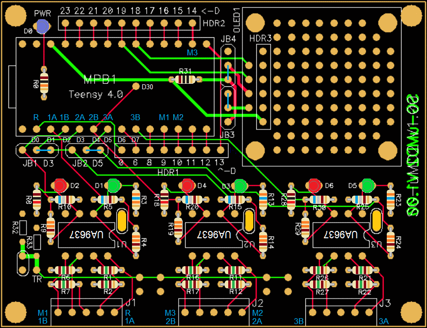

SG-µMD2 PCB Layout Version 1.0
Refer to the SG-µMD2 board layout below. Clicking on these will bring up higher resolution versions in a single separate tab or window depending on your browser settings:
SG-µMD2 V1.0 PCB Layout Diagrams for V1.0 and V1.2 Schematics (Left) and Minimal Single Axis PCB and Three Axis Populated PCB with OLED Display (Right)
(JB1 and JB2 Jumpered for Homodyne Mode; JB3 and JB4 Jumpered for OLED GND on the Left and VCC on the Right)
(All kits going forward will have red and green LEDs for the A and B signals; the original prototype was all boring green. Please pay attention to the values for the current limiting resistors as they differ by more than an order of magnitude for the red and green LEDs to equalize their perceived brightness. Where the signal LEDs are all green, the R3,R8,R13,R18,R23,R28 will be 10K ohms.)
In addition to the resistor color codes and component references, the layout diagram also shows the signal locations for homodyne and heterodyne on the Teensy. Sorry about the silkscreen component references being missing on the actual PCB; this will have to do.
The populated PCB shows all components required for a three axis system with the OLED display. The terminating resistors (near the screw terminal blocks) have not been installed since their value may depend on the specific configuration, and can often be left out. Five pin headers may be substituted for the screw terminal blocks if desired. The signal LEDs shown are all green in the photo, sorry. :)

  2. ( ) Install R0 (10K ohms) under where the Teensy socket will go.
  3. ( ) Install R31 (10 ohms) under where the Teensy socket will go.
  4. ( ) Trim the large socket if necessary so it has two rows of 14 pins. This is for MPB1, the Teensy 4.0 PCB.
  5. ( ) Carefully insert it in the PCB confirming no bent pins. Rather than flipping a coin :), orient it so the large cutout faces the USB to the left. Then solder two corners and confirm it seats flat, then solder the other pins. Inspect for solder bridges and unsoldered pins.
  6. ( ) Install the 8 pin sockets for U1 (single axis) and U2,U3 (three axes). Note orientation - the cutout goes to the right as viewed in the layout diagram. Solder and inspect for solder bridges and unsoldered pins.
  7. ( ) Install C1 (0.1 µF, single axis) and C2,C3 (three axes). C1,C2,C3 are the oval outlines to right of U1,U2,U3 respectively.
  8. ( ) Install R4,R9 (330 ohms, single axis) and R14,R19,R24,R29 (three axes).
  9. ( ) Install R5,R10 (680 ohms, single axis) and R15,R20,R25,R30 (three axes).
  10. ( ) Install D0 (3 mm blue LED). The anode is the longer lead and goes to the right as viewed in the layout diagram. The flat is the cathode and goes to the left. Cut the leads about 1/10" from the body if the LED can't be inserted to sit flush on the PCB. Take care not to overheat or stress the leads on the LED when soldering. Be as quick as possible.
  11. ( ) Optional signal LEDs:
    • ( ) Install R3 (36K ohms, single axis) and R13,R23 (three axes).
    • ( ) Install R8 (1K ohms, single axis) and R18,R28 (three axes).
    • ( ) Install D1 (3 mm green LED, single axis) and D3,D5 (three axes).
    • ( ) Install D2 (3 mm red LED, single axis) and D4,D6 (three axes).
  12. ( ) Install J1 (screw terminal block, single axis) and J2,J3 (three axes). Make sure the entrance holes for the wires face away from the PCB! Solder the center pin and confirm they are flat on the PCB, the solder the others. Check for solder bridges and unsoldered pins.
  13. ( ) Install jumper wires (cut resistor leads) at JB1 and JB2 as shown in blue on the layout diagram. This selects the Homodyne signals.
  14. ( ) Carefully inspect for unsoldered pins, solder bridges and other blemishes. Correct as needed. THIS IS ESSENTIAL! It would be bad form to blow the brain due to an errant blob of solder. :(

    R5     Resistor  680 ohm, 1/8 W   1A/REF 5V->3.3 V level shift
    R6     Resistor  150 ohm, 1/8 W   IN2 termination
    R7     Resistor  150 ohm, 1/8 W   ~IN2 termination
    R8+    Resistor  10K ohm, 1/8 W   1B/MEAS1 LED current limiting
    R9     Resistor  330 ohm, 1/8 W   1B/MEAS1 5V->3.3 V level shift
    R10    Resistor  680 ohm, 1/8 W   1B/MEAS1 5V->3.3 V level shift
    R11*   Resistor  150 ohm, 1/8 W   IN3 termination
    R12*   Resistor  150 ohm, 1/8 W   ~IN3 termination
    R13*+  Resistor  10K ohm, 1/8 W   2A/MEAS2 LED current limiting
    R14*   Resistor  330 ohm, 1/8 W   2A/MEAS2 5V->3.3 V level shift
    R15*   Resistor  680 ohm, 1/8 W   2A/MEAS2 5V->3.3 V level shift
    R16*   Resistor  150 ohm, 1/8 W   IN4 termination
    R17*   Resistor  150 ohm, 1/8 W   ~IN4 termination
    R18*+  Resistor  10K ohm, 1/8 W   2B/MEAS3 LED current limiting
    R19*   Resistor  330 ohm, 1/8 W   2B/MEAS3 5V->3.3 V level shift
    R20*   Resistor  680 ohm, 1/8 W   2B/MEAS3 5V->3.3 V level shift
    R21*   Resistor  150 ohm, 1/8 W   IN5 termination
    R22*   Resistor  150 ohm, 1/8 W   ~IN5 termination
    R23*+  Resistor  10K ohm, 1/8 W   3A LED current limiting
    R24*   Resistor  330 ohm, 1/8 W   3A 5V->3.3 V level shift
    R25*   Resistor  680 ohm, 1/8 W   3A 5V->3.3 V level shift
    R26*   Resistor  150 ohm, 1/8 W   IN6 termination
    R27*   Resistor  150 ohm, 1/8 W   ~IN6 termination
    R28*+  Resistor  10K ohm, 1/8 W   3B LED current limiting
    R29*   Resistor  330 ohm, 1/8 W   3B 5V->3.3 V level shift
    R30*   Resistor  680 ohm, 1/8 W   3B 5V->3.3 V level shift
    R31    Resistor  10 ohm, 1/8 W    V3.3 protect
   SKT14   Socket    14 pin SIP       Socket for Teensy 4.0
   SKT8    Socket    8 pin, 300 mil   Socket for IN1/2/REF/MEAS1 line receiver
   SKT8*   Socket    8 pin, 300 mil   Socket for IN3/4/MEAS2/3 line receiver
   SKT8*   Socket    8 pin, 300 mil   Socket for IN5/6 line receiver
  SKT40+   Socket    40 pin, SIP      Socket strip for HDR1,HDR2,JP6
    U1     IC       UA9637 or UA9639  REF/MEAS1 line receiver
    U2*    IC       UA9637 or UA9639  MEAS2/MEAS3 line receiver
    U3*    IC       UA9637 or UA9639  MEAS2/MEAS3 line receiver
"*" denotes parts that can be omitted for a sigle axis system. "+" denotes parts that are not required for µMD2.
  1. The only LEDs that is really desirable is Power, D0. And that is blue. The line receiver signal LEDs may be either super bright white or green, my choice. And even with the 10K ohm series resistors limiting current to less than 0.3 mA, they may still be annoyingly bright. ;-) Feel free to substitute LEDs having your preferred decorator colors, modifying the values of the current limiting resistors as needed to equilize brightness.
  2. The 0.1 µF bypass caps do not have reference designators but they are next to pin 1 of U1, U2, and U3.
-- end V1.03a --
