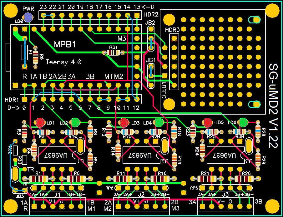

Changes from V1.00: The input connectors have switched from 5 to 6 pin to
provide a +5 V source for encoder hardware, connections for the heterodyne
signals have been added, the jumper blocks for the OLED have been moved
slightly apart to prevent the inadvertant connection of +5 V to GND. ;-(

SG-µMD2 V1.22 PCB Layout Diagrams with 100 & 150 Ohm Terminators (Left), Minimal Single Axis V1.00 PCB, and Three Axis Populated V1.00 PCB with OLED Display (Right)
(JB1 and JB2 Jumpered on Layout Diagrams for OLED GND on the Left and VCC on the Right)
(All kits going forward will have red and green LEDs for the A and B signals; the original prototype was all boring green. Please pay attention to the values for the current limiting resistors as they differ by more than an order of magnitude for the red and green LEDs to equalize their perceived brightness. Where the signal LEDs are all green, the R3,R8,R13,R18,R23,R28 will be 10K ohms.)
In addition to the resistor color codes and component references, the layout diagram also shows the signal locations for homodyne and heterodyne on the Teensy.
The populated PCB shows all components required for a three axis system with the OLED display. The terminating resistors (near the screw terminal blocks) have not been installed since their value may depend on the specific configuration, and can often be left out. Five pin headers may be substituted for the screw terminal blocks if desired. The signal LEDs shown are all green in the photo, sorry. :) (These show the V1.00 PCB, updated versions will be forthcoming.)
SG-µMD2 V1.22 PCB Layout Diagrams with Jumpers (Blue); 100 Ohm Terminators (Left) and 150 Ohm Terminators (Right)
The parts list below assumes populating the SG-µMD2 for 3 homodyne axes with the OLED display. So for a single axis system, some parts in this list may not be present and/or there is no need to install those associated with channels 2 and 3 and/or for the OLED. Note that a 3-axis heterodyne system requires the same peripheral parts as a 2-axis homodyne system.
IMPORTANT: The color of the OLED display (if present) may be yellow/blue (yellow for first two lines of text with blue for the remaining 6 lines), all blue, or all white. In addition and more importantly, they may differ slightly in their pinout and mounting hole type/location as follows (viewed with the pins at the top):
There may be other variations. The kits will generally have the Type 1 yellow/blue OLEDs.

RP2 Resistor pack, 5x 150 ohm IN3/IN4 Termination
RP3 Resistor pack, 5x 150 ohm IN5/IN6 Termination
SKT1 Socket 14 pin SIP Socket for Teensy 4.0
SKT2 Socket 14 pin SIP Socket for Teensy 4.0
SKT2 Socket 8 pin, 300 mil Socket for IN1/2/REF/MEAS1 line receiver
SKT3* Socket 8 pin, 300 mil Socket for IN3/4/MEAS2/3 line receiver
SKT4* Socket 8 pin, 300 mil Socket for IN5/6 line receiver
SKT5+ Socket 40 pin, SIP Socket strip for terminating resistors
U1 IC UA9637 or UA9639 REF/MEAS1 line receiver
U2* IC UA9637 or UA9639 MEAS2/MEAS3 line receiver
U3* IC UA9637 or UA9639 MEAS2/MEAS3 line receiver
