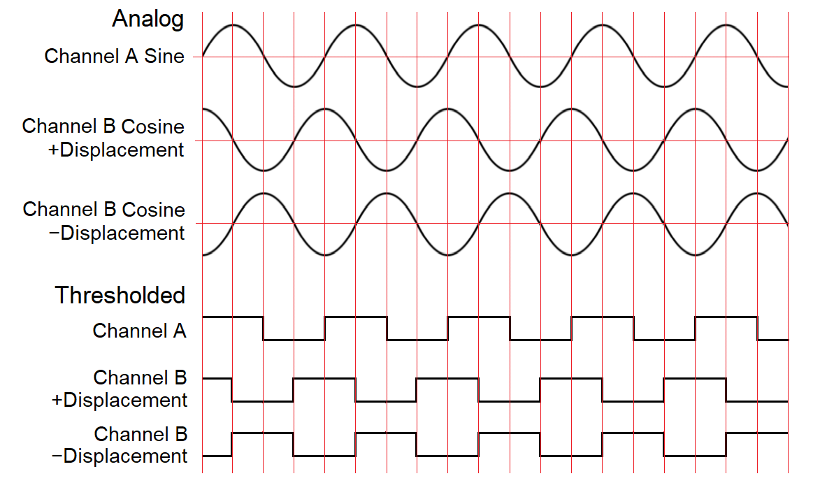

Rotary Encoder Digital Signals as a Function of Orientation
This shows a rotary optical encoder which uses a pair of LEDs and photodiodes physically offset by 90 degrees to generate Quad-Sin-Cos analog signals which are then thresholded to yield Quad-A-B digital signals. The specific type of sequence is called a "Gray" code (not based on color but attibutable to someone named Frank Gray) and has the property that any possible allowable change in value is a change in only a single bit. This eliminates the ambiguity with sensors using the normal binary order where two bits can change at not quite the same time.

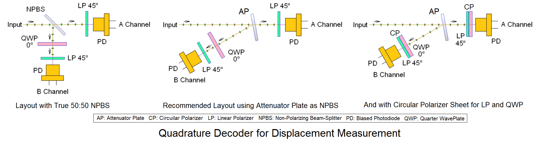

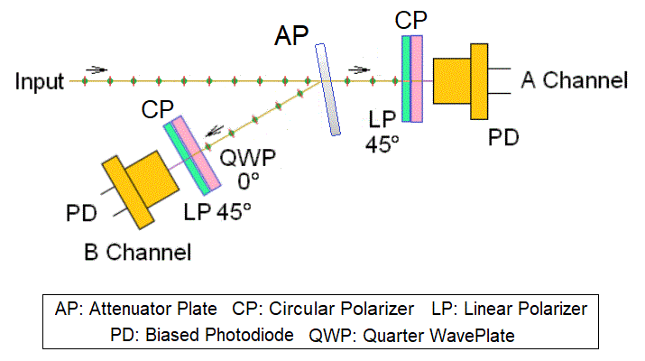

An interferometer with angled paths for the two interfering beams produces fringes similar to the pattern of an optical encoder so a quad detector could be built with offset photodiodes and this has been done in some ring laser gyros as well as stabilized HeNe lasers. However, more commonly, the 90 degree phase shift is done optically using a single combined beam as shown below. The Quarter WavePlate introduces a 90 degree phase shift. If resulting Quad-Sin-Cos analog signals are thresholded and converted to digital form, the result would be a Quad-A-B format.
This shows variations on one of several common implementations for a Quad-Sin-Cos decoder that provides Sine and Cosine outputs for use in a displacement measuring system. This is among the simplest. In most instances, the photodiodes would be reverse biased to provide a linear response. Commercial systems will generally have a third "Intensity" channel to compensate for variations in detected power due to the laser aging, changes in alignment, and contamination over time. The Intensity channel can be implemented electronically or optically with a non-polarizing beam-splitter at the input and additional photodiode.
The purpose of the angled arrangement is to minimize the difference between the amplitudes of the two polarizations. Otherwise, with 45 degrees being close to the Brewster angle (around 57 degrees), one will be much larger than the other. Even so-called 50:50 beam-splitters may be subject to this, so using the angled arrangement for either one may be beneficial. There is an Attenuator Plate (AP) in these kit, which simplifies construction. Using the AP also permits the relative amplitudes of the Channel A and B signals to be mostly balanced without electronic adjustments.
The signal outputs from the biased photodiodes will be analog and close to sinusoidal. The relative phase shift betweem the A and B channels will be determined by the construction of the encoder or interferometer and the direction of motion. The graphic belows shows the specific case of a displacement measuring interferometer:
The photo shows the typical optical parts and photodiodes. The basic detector using a single photodiode like the DET110 can generate a signal corresponding to light and dark fringes, but cannot provide direction information, essential for using an interferometer in metrology applications. The Quad-Sin-Cos decoder provides a pair of outputs that are 90 degrees offset from each-other in position, similar to the outputs of a rotary or linear encoder:

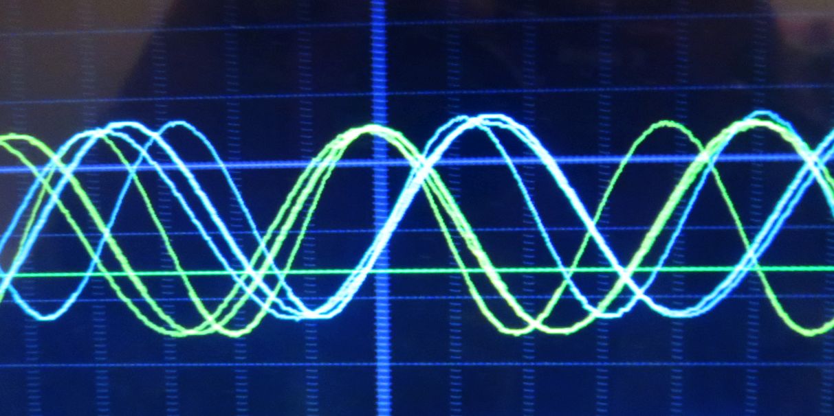

The ugly scope screen shots below shows behavior which is close to perfect:

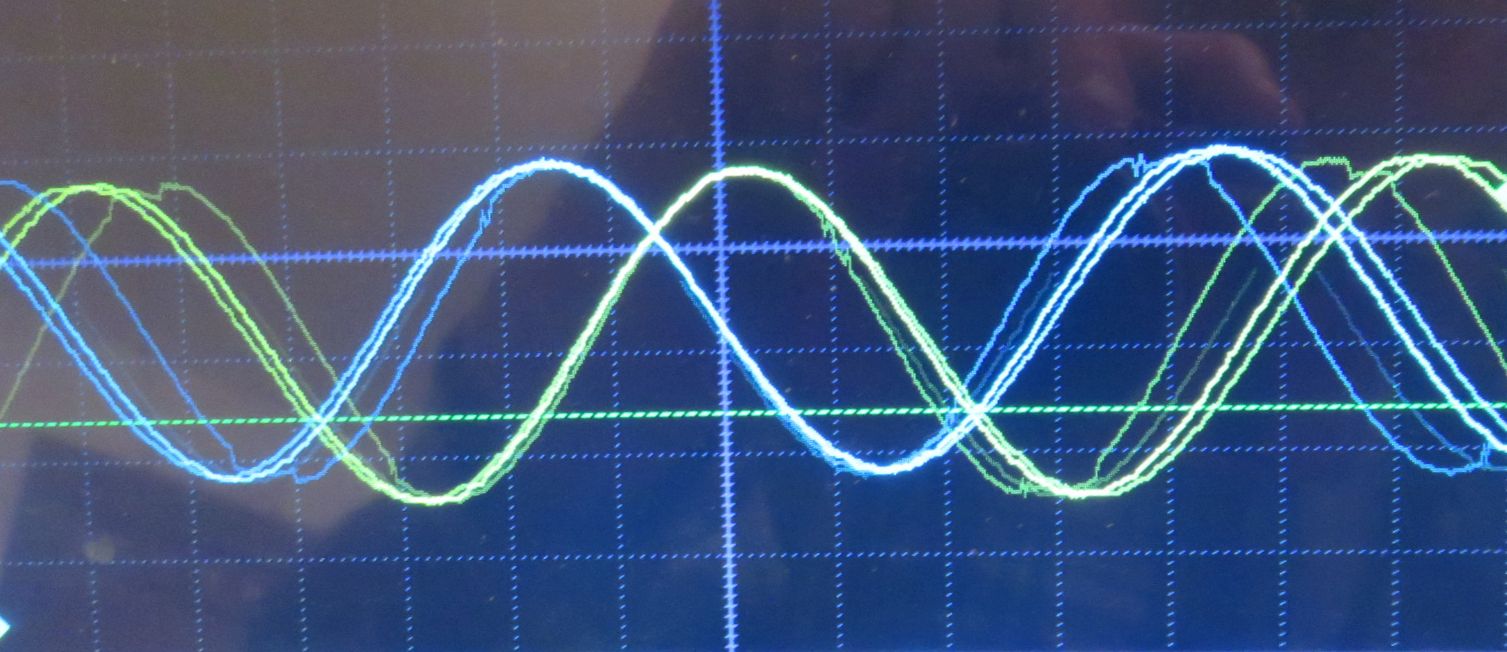

Channel A and B Signals with Positive (Left) and Negative (Right) Displacement
Capturing a decent photo while twiddling the micrometer screw is quite challenging. ;-) But the conclusions are clear: This simple Quad decoder does its job well with a phase shift of close to ±90 degrees. If the Arm 2 mirror or retro-reflector were on an electronically controlled positioner like a loudspeaker voice coil or linear motor driven with a ramp, the waveforms would be textbook quality. ;-) With only a small stretch of the imagination, it can be seen that the screenshots agree with the expected behavior based on the diagrams, above. OK, perhaps not such a small stretch. ;-)
A prototype was constructed, appropriately enough, on a prototyping board :), and then the simple PCB was made so that mounting of the photodiodes and other electrical components would be simplified. There is nothing to really secure the AP/BS but that could be done with double-sided tape. Later the version using a small solderless breadboard was built and that version is the default for these kits since it does not require any soldering.
The mounting scheme doesn't need to be fancy or pretty but should hold the pieces securely while maintaining alignment. This can use bits of tape and Epoxy or other adhesive. The CPs (QWP/LP and LP) are expendible so feel free to chop them up if necessary to fit. :)
The photos above show various possibilities not involving a 3-D printer :), including a minimal custom PCB, but some soldering is required for that. The simplest approach is to use a small Solderless BreadBoard (SBB) which has a double sided sticky pad on the bottom which enables it to be attached to a standard optical post or other support.

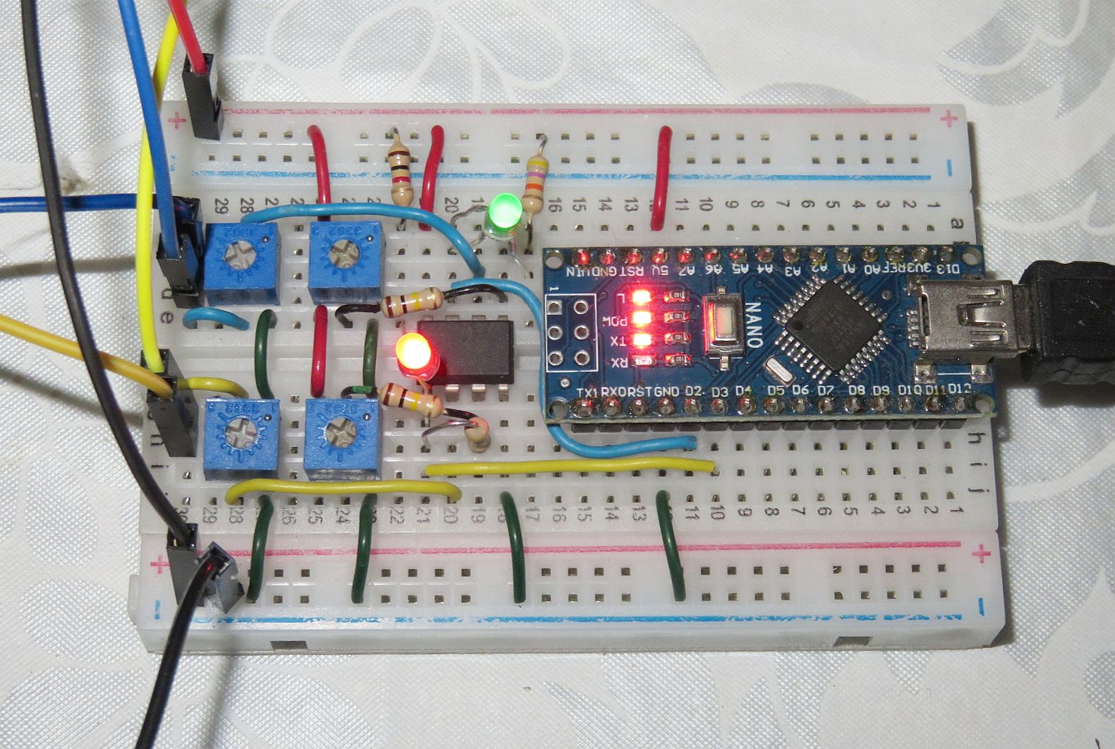

Quad-Sin-Cos Interface to Atmega 328P Nano 3.0/µMD0 Schematic (Left), on Solderless Breadboard (Center), using Custom PCB (Right)
If using the Solderless BreadBoard (SBB), Parts placement is not at all critical but making it "nice" will help especially if problems are found. Standard Arduino-style male-male jumper wires can be used where necessary, but should be replaced eventually with suitable lengths of #22-#24 AWG solid wires. DO NOT force larger wires or stranded wires into the holes as the spring contacts may be damaged, leading to unreliable connections.
And for the uninitiated, there are two types of busses on the 400 tie point (and other larger) SBBs. A pair of busses all the way across the top and bottom are generally used for power and/or ground connections though there is no law about that. The remainder are 25 pairs of vertical busses with 5 tie points each.

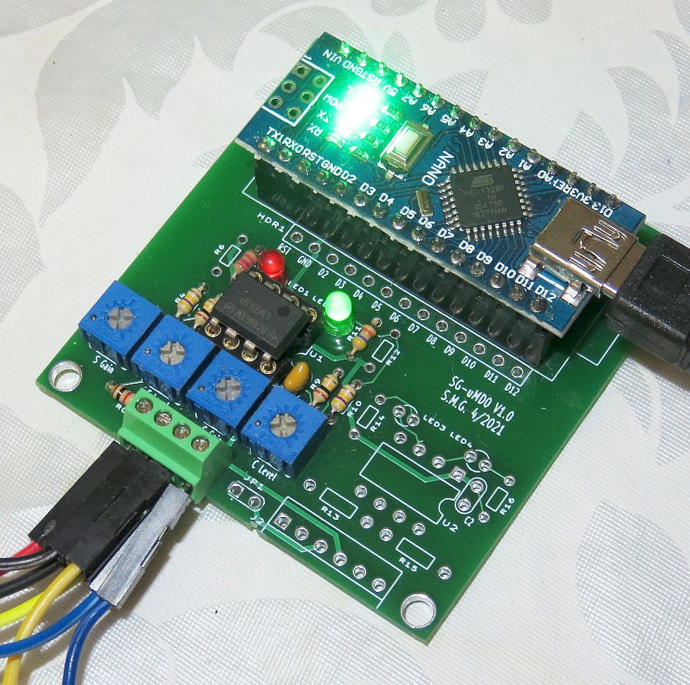

If using the SG-uMD0 PCB, go to Assembly Instructions for the SG-µMD0 - RS422 and Analog Inputs.

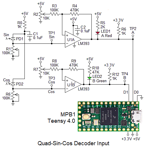

And here is a version to interface directly to the Teensy used in µMD2:
Note the 3.3 V source from the Teensy for the output pullups. This is critical to the health of the Teensy. Higher voltage (i.e., 5 V) may damage it.

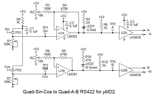

And finally here is a version to generate RS422 for use with SG-µMD2 or other compatible device:
Additional parts for RS422 Output:
These would be needed to drive the RS422 inputs of µMD2 in the normal way. Alternatively, the components for the threshold can be installed on µMD2 so that the inputs can be single-ended. Information is in the Assembly Instructions for the SG-µMD2 Version 1.22 PCB. The only disadvantage of this approach is that to use µMD2 later with RS422 inputs may require removing the threshold connection to the input pin(s).
Prt# Description Comments ----------------------------------------------------------------------- U2 UA9638, 8 pin DIP Dual RS422 line driver C3 0.1 µF capacitor Power supply bypass for U2

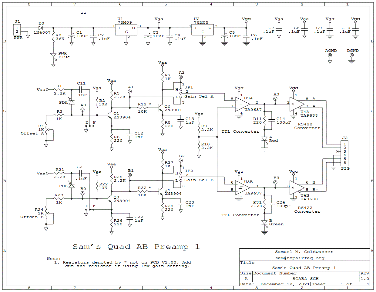

The second is a circuit for which I am contemplating designing a PCB but it may not happen for awhile.
It's a combination of a dual trans-impedance pre-amp, gain stage, threshold to convert to Sin-A-B, and RS422 line drivers.
The third will be a simple PCB that accepts the two optical inputs and outputs RS422. So it should be a straightforward solution not requiring high speed op-amps. Its bandwidth is greater than 3 MHz with an optical power below 25 µW.
