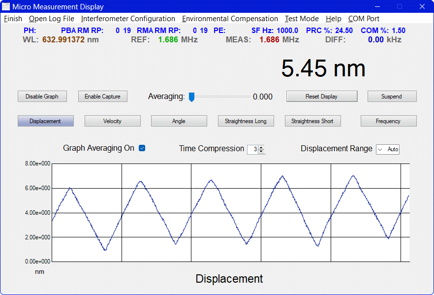

  3. Measurement display: Once the laser and optics are assembled, the µMD2 Micro Measurement Display implemented using a Teensy 4.0 Arm Cortex-based microprocessor and Windows PC can be added to read out and plot the displacement, velocity, angle, or straightness, as well as to save the raw data to a file for subsequent processing using an application like Excel or Matlab. For displacement, the usable accuracy has been demonstrated to be a few nm with a resolution (or easily detectable changes) better than 0.1 nm. For context, 0.1 nm is approximately the diameter of a hydrogen atom minding its own business.

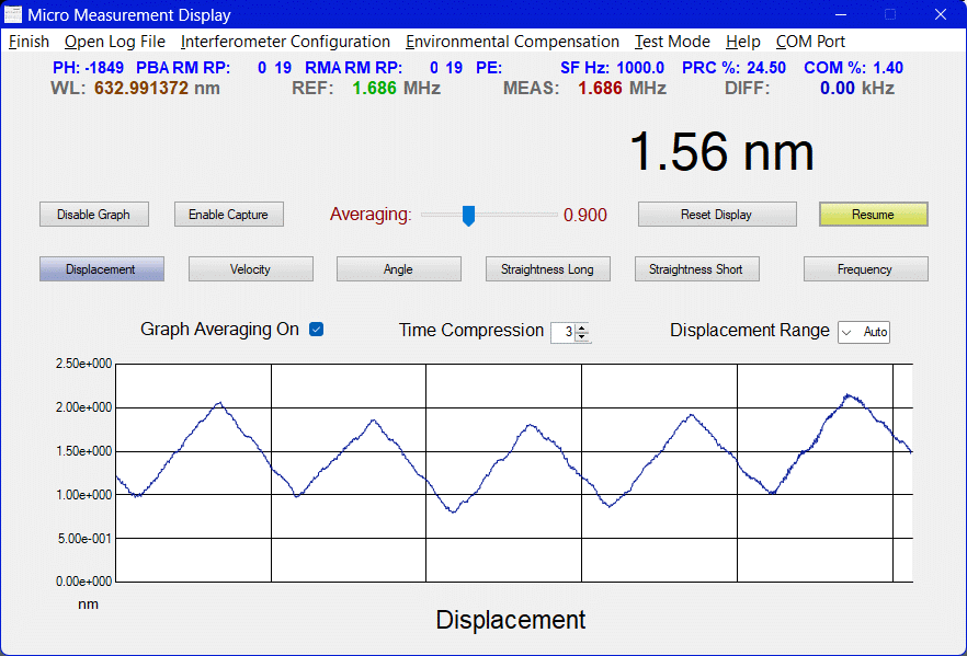

And note that if using the µMD2 display, the native resolution (before any averaging or interpolation) doubles (or halves depending on your point of view!) again for free to approximately 158 nm with a corresponding similar improvement for all the other interferometer configurations as well.

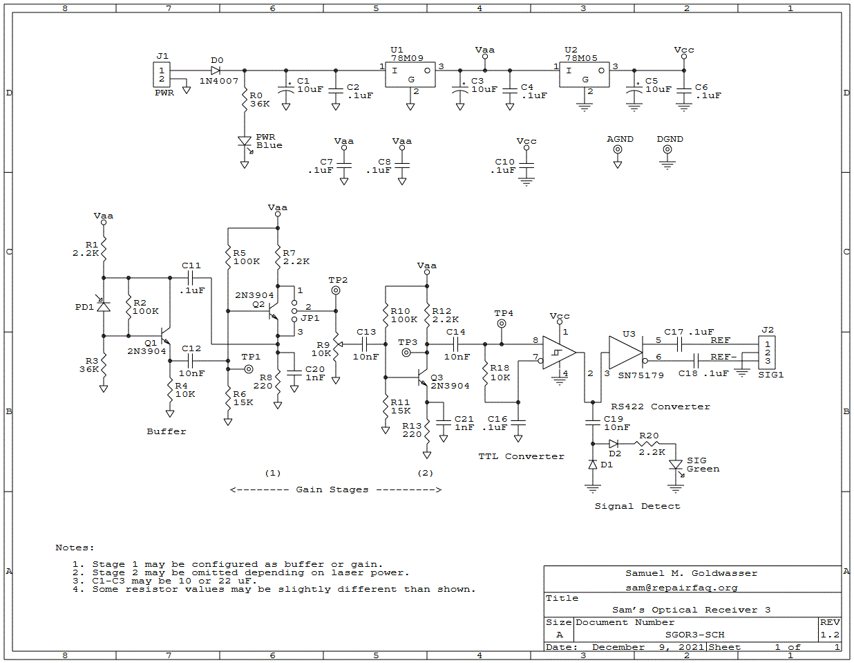

The REF signal must be derived from the actual output of the laser. A simplified optical receiver is shown below:
Schematic of Simple Optical Receiver with Performance Similar to that of HP 10780
Using the waste beam can be a challenge due to its low power which is a somewhat random variable depending on the leakage through the high reflector mirror. It may be 25 µW or less and the polarizer will reduce it even further. The circuit above has performance similar to that of the HP 10780A but can be constructed entirely from readily available inexpensive off-the-shelf parts. It should work for the waste beam as well as the measurement beam from the interferometer. Surface mount components are not even required, though a 4 layer PCB does provide better performance (mainly noise immunity) than construction on a "Perf" board. The use of a "Solderless Breadboard is definitely NOT recommended. And for really low power signals, shielding may be required. Alternatively, a genuine 10780 (almost any version) can be used. Cost-wise, 10780s used to be really inexpensive on eBay though in 2025, they are running around $100. A pair of them could be used initially (REF and MEAS) and then a DIY circuit could be substituted later for each in the interest of purity. :)
Where there is no waste beam or it is too weak, the beam sampler in the output would be required.
Also of note is that the residual asymmetry in the laser tube will affect the orthogonality of the F1/F2 polarized components. There is a specific orientation of the tube with respect to the X and Y axes to optimize this. Determining it is a simple matter of using an arbitrary orientation for the tube and incrementally adjusting the angle of the QWP, and at each orientation locating the angle at which the beat signal using a linear polarizer is minimized. The tube and QWP should then be oriented at 45 degrees with respect to that angle. Since the construction of the tubes used in HP/Agilent/Keysight lasers requires them to be in a fixed orientation inside the housing, a Half WavePlate (HWP) has always been present after the QWP to rotate the F1/F2 components to line up with the X/Y axes.

The µMD2 Graphical User Interface (GUI) runs on PC or laptop under Windows™ (XP/Vista/7/10/11 or later) via a USB interface. Raw measurement data from the SG-µMD2 board can also be input directly to something like Excel™ or Matlab™, or a user-developed analysis application. The screenshots below show the displacement of a mirror on a PZT driven by a triangle waveform from a function generator. The p-p amplitude for the plots from left to right are around 300 nm, 40 nm, 5 nm and 1 nm, respectively.

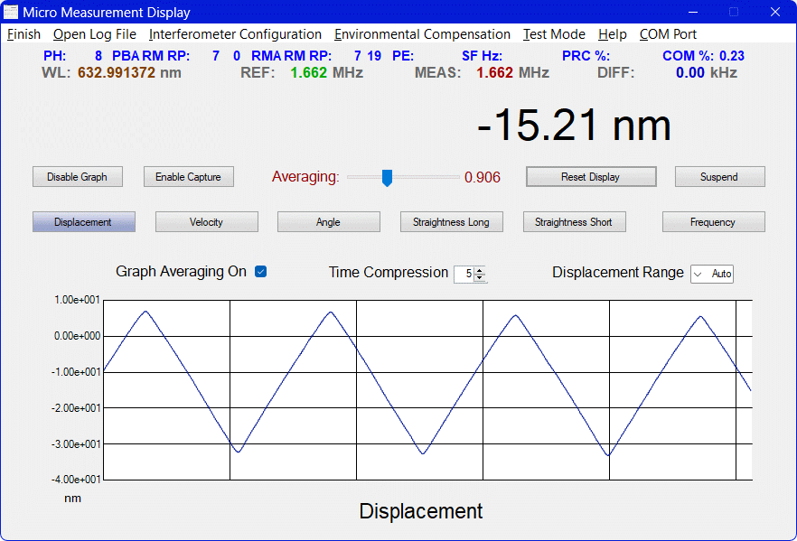

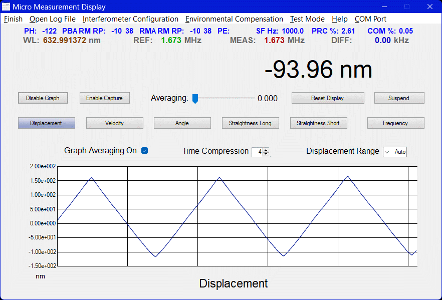

Firmware V261.30 Screenshots with Interpolation Enabled for Motion with Peak-to-Peak Amplitudes of Approximately 300 nm, 40 nm, 5 nm, and 1 nm
No, these displays are NOT of the electrical signal but the actual displacement measured using the interferometer and µMD2!
Some "wandering" up and down of the average displacement up to a few nm with a period of a few seconds is present at the highest resolutions. I had always assumed that this was due to the relative sampling of the REF and MEAS edges with respect to the 600 MHz CPU clock. The entire system is synchronous, so at some point that sampling comes into play. Similar behavior was present with µMD1 interpolation as well (though it may have been worse). However, I recently came across a scientific paper that discusses similar artifacts associated with interaction of the F1 and F2 components of the Zeeman laser itself. This should not be present with a laser that uses an AOM to create the F1/F2 components through up and down conversion of a single frequency optical carrier. But the only lasers I have using an AOM are the Zygo 7701/2s and their 20 MHz split frequency is too high to do useful interpolation with the current firmware. And they probably wouldn't do what is needed anyhow. And these effects may not even be relevant anyhow. However, swapping my modified Melles Griot 05-STP-910 for a genuine HP/Agilent/Keysight 5517 laser may be instructive. The µMD Tech Support Department was never able to locate the cause of that either, despite the billions of nanoseconds devoted to it. ;-) But there are also thermal effects and vibration. It is almost impossible to really measure these nm-scale changes without outside disturbances dominating. In fact, to record these data, a PZT (piezo-beeper element) with the remote mirror attached to it had to be secured directly to the HSPMI. And even then any vibration like tapping the table or even walking nearby still shows up in the display.
The most precise level is implemented using Phase Interpolation. This algorithm in effect "looks" at the waveforms of REF and MEAS averaged over many cycles and computes their relative phase. It turns out that that is the simple part. What is more challenging is linking the computed phase to the integer part of the displacement (DISP) based on the difference between the REF and MEAS counters. This is not trivial even if done in an FPGA or low level digital hardware, and even more so with a set of counters running independently of the firmware code execution. In essence, a change in DISP should be accompanied by a large change in Phase. For example, if DISP increments by 1, the Phase MUST decrease by close to 360 degrees so the interpolated value is continuous across the boundary. But due to the aforementioned uncertainly, that will often not take place. Without correction, the result will be spikes in the displacement up to a a wavelength in amplitude depending on the interferometer resolution.

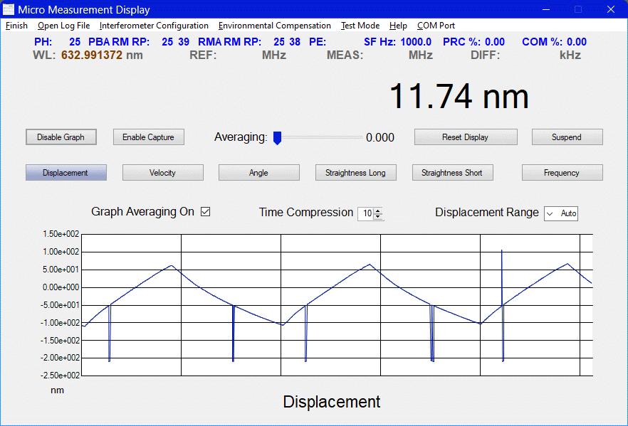

Appearance of the Displacement Data with Boundary Correction Disabled
And the actual data is much more messy than this as there will usually be multiple glitches both positive and negative, but the µMD GUI plotting routine subsamples.

OR3 Optical Receiver:
Refer to the Optical Receiver (OR3) Assembly and Operation Manual.
