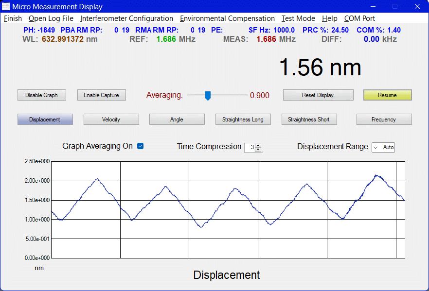

Phase-based interpolation in the µMD2 firmware increases the end-point
resolution to well below 1 nm.
However, for stationary or slowly varying displacement (order of less than one
wavelength per second), the use of a large value for the moving average
in the GUI should result in a similar improvement in resolution as the
sampling can be set up to be essentially random.

Phase interpolation implemented in firmware (V261.28 or above) provides
sub-nm end-point resolution. For an amplitude of 300 nm, the frequency
response is over 20 Hz. This means that the displacement will settle in
to the correct value with sub-nm accuracy within a small fraction of a
second. Super-sampling in firmware should be available soon to provide
resolution for larger displacements of a few nm or better. However, your
mileage may vary as even being able to provide a stable enough setup to
be able to make sense of such small changes is a challenge. Interpolation
currently only works for lasers with a split frequency of less than
around 8 MHz (which excludes Zygo lasers except the 7705) but we're
working on that. ;-)
An adjustable weighted average to smooth data may be applied to the readout
and graph.
Even without interolation, for stationary or slowly varying displacement,
sampling can be set up to be essentially random. To take advantage of this,
the and "#define Interpolation" and "#define REF_Sync" must be commented out
in the firmware (V2.61 or above). Without doing this, sampling syncs
with REF and displacement will tend to be in increments of 1/2, 1/4, or 1/8
wavelength depending on the interferometer optics.

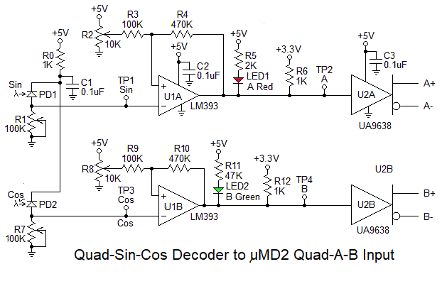

Since the external interface to the Teensy is very simple, a version of
µMD2 can be put together on a solderless breadboard (or prototyping
board). While this may not run at the maximum speed supported
by the Teensy, it would be a quick way of getting something working.
Some typical basic interface circuits for the homodyne version
are shown below:
CAUTION: Teensy pins are NOT 5V tolerant - they will be unhappy if a 5 V signal is connected to them directly. Thus any signal that may go higher than 3.3 V should NEVER be connected to them, even for an instant. Bad things may happen. In the case of the Quad-Sin-Cos decoder, the LEDs provide enough voltage drop so the input to the Teensy will not be greater than 3.3 V since the outputs of the LM393 are open collector. For the Quad-A-B input, the resistor voltage dividers reduce the output of the UA9637 under 3.3 V (exactly as on the SG-µMD2 PCB.
The LM393 is an 8 pin DIP so it, along with the Nano and other parts, will easily fit on the typical 250 column 2-1/4 x 3-1/4 inch solderless breadboard with room to spare. For the Quad-Sin-Cos Decoder version, the photodiodes can be somewhat remote connected with twisted pairs. The 1M ohm positive feedback resistor adds a small amount of hysteresis to filter out fuzzy noise on the signals which appears to be capable of inducing oscllation and totally messing up the displacement due to bogus excessive slew rate. Or something. :) For the Quad-A-B Differential version (RS422), the input cables can be long and also be twisted with a single 100 ohm resistor between the two inputs for termination, but there needs to be a common ground connection somewhere. While the UA9637 is essentially a voltage comparator with built-in hysteresis, it CANNOT be used with photodiode inputs because its bias current is too high. The difference in resistor values for the red and green LEDs balances their brightnesses, mostly. Of course, the LEDs aren't *really* essential. ;-)
Tne value of 100K for the photodiode load resistors has been selected as suitable for the typical ~1 mW SLM laser to result in the signal going from near 0 to around 3 V. It's not necessary to have them be adjustable since the threshold settings are adjustable. But you can if you wish, and of course change their value to reflect the real world situation of your laser power and losses in the Quad decoder. If the source is differential analog (typically each 1 V p-p), the signals can go directly to the comparator inputs dispensing with the load resistors and trim-pot.
For these simple setups, a solderless breadboard with 25 columns should be adequate. The Nano with soldered pins can plug in at the right side with the USB connector facing out, and the LM393 and associated components can be placed next to it. Those connections that cannot be made with component leads should use pieces of #22-24 AWG solid wire.
The diagram on the far right converts from the photodiode signals to the differential signals required by the SG-µMD2 PCB. It assumes the default wiring in the assembly instructions. With a bit more work, the differential line drivers (U2) can be eliminated by going directly into the A+ and B+ inputs of SG-µMD2 with the signals on TPA and TPB, and the the A- and B- inputs biased at around 1.5 V by wiring up the on-board reference network and without the 150 ohm or 100 ohm termination.
The "cables" for the photodiodes can simply be twisted pairs. Keep them short but a foot or so should be fine. If the source is something else like a commercial optical detector or signals from a self-contained laser/interferometer, a different type of termination than the load resistors may be needed.
For more information on the Quad decoder and interface, see Construction Guidelines for Basic Quadrature-Sin-Cos Decoder and Quad-A-B Interface Kits. Some of it is redundant but there are more detailed instructions on mounting the optical parts and the actual circuits and wiring. Ignore the specifics for µMD0. ;-)
