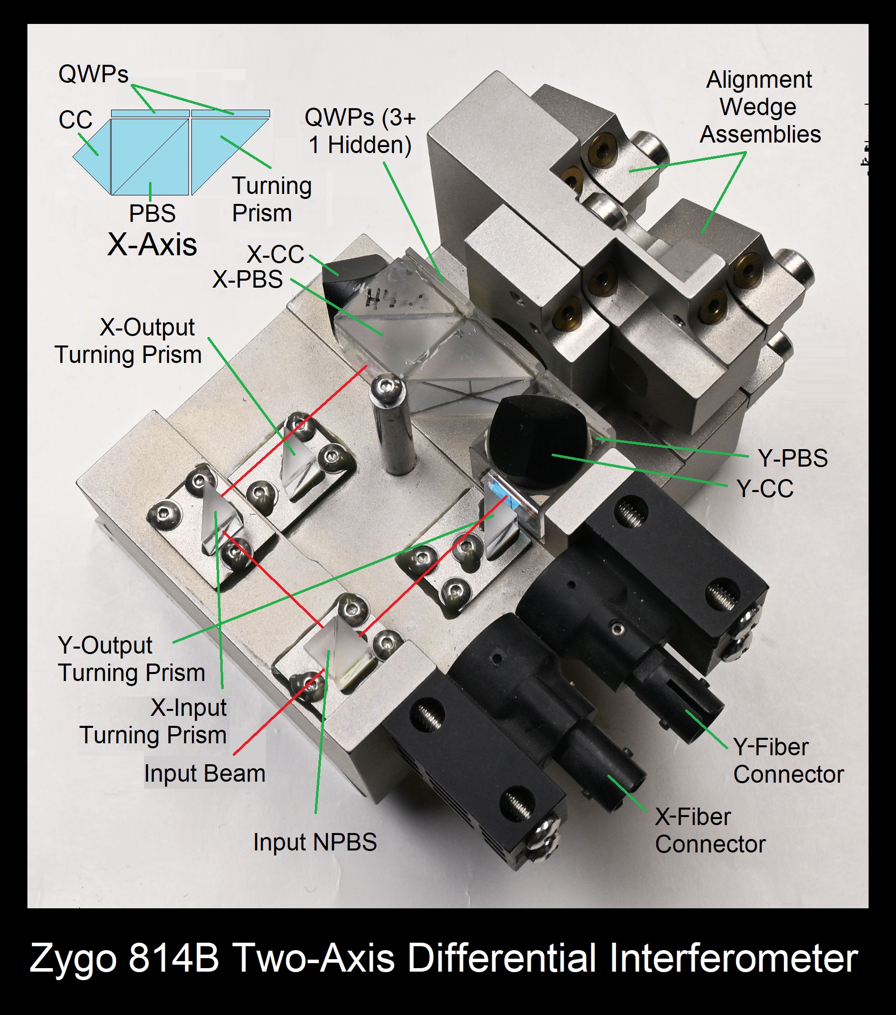

A diagram of the Zygo implementation is shown in
Zygo Differential Plane Mirror Interferometer
(DPMI). The Polarization Shear Plate (PSP) splits the F1/F2 beam into
a pair of parallel beams separate by about 9 mm. This is equivalent to
a Polarizing Beam Splitter (PBS) and 45 degree mirror or prism. The Half-Wave
Plates (HWPs) rotate the polarization axis of one of these beams to be
the same as the other. The remaining components - Polarizing Beam Splitter
cube, Retro-Reflector (RR), and Quarter-Wave Plate (QWP) handle each of these
beams in the same manner as the measurement (MEAS) beam in the Plane Mirror
Interferometer (PMI) described above. Each of the beams pass through the PMI
and gets reflected by either the Reference Mirror (RM), or the Target or Tool
Mirror (TM). But due to the QWP, the polarization axis is rotated 90 degrees
on the way back, so it reflects off the diagonal of the PBS down to the RR
and back up reflecting once again off the PBS to the TM. Finally, due to a
second polarization rotation of 90 degrees, it passes through the PBS cube
back to the PSP where the beams are combined in reverse, and then out to the
Optical Receiver (OR) typically via a fiber-optic cable. In short, the
purpose of all this complexity is to split the F1/F2 components apart so
that their path lengths can change independently and then combine them back
into a single beam.

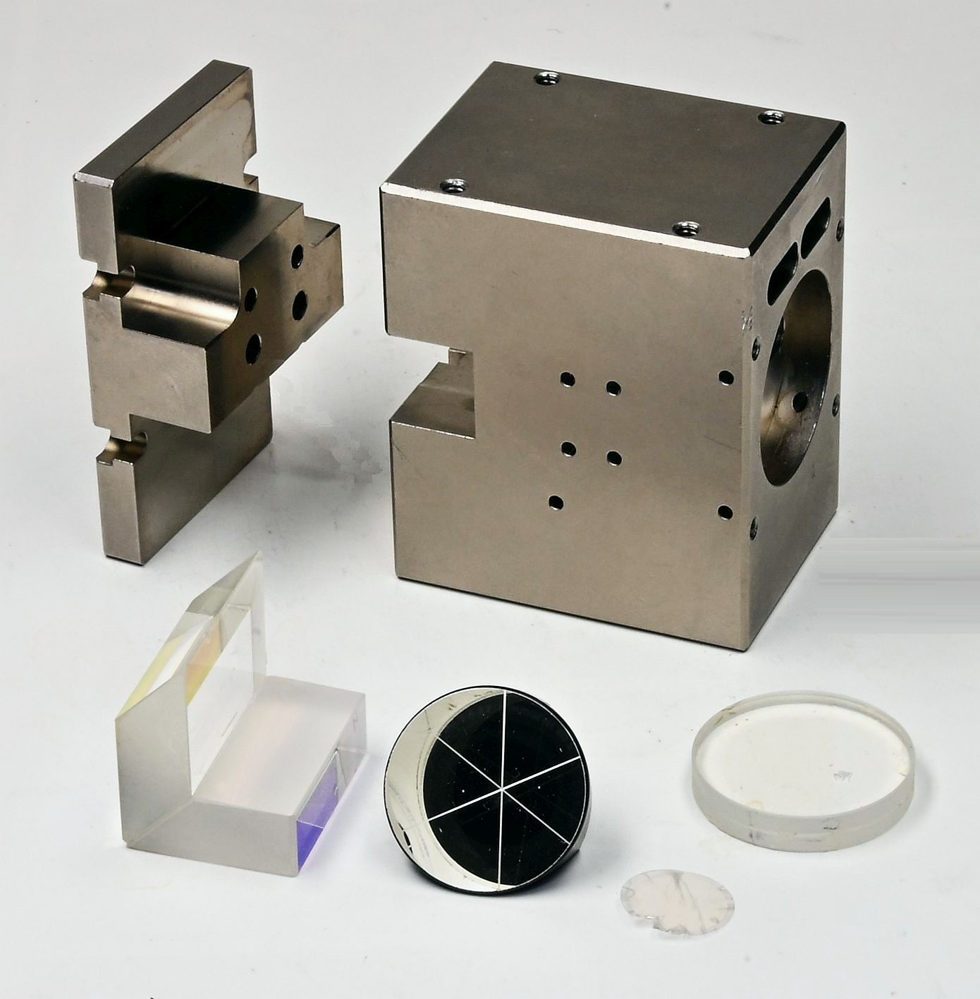

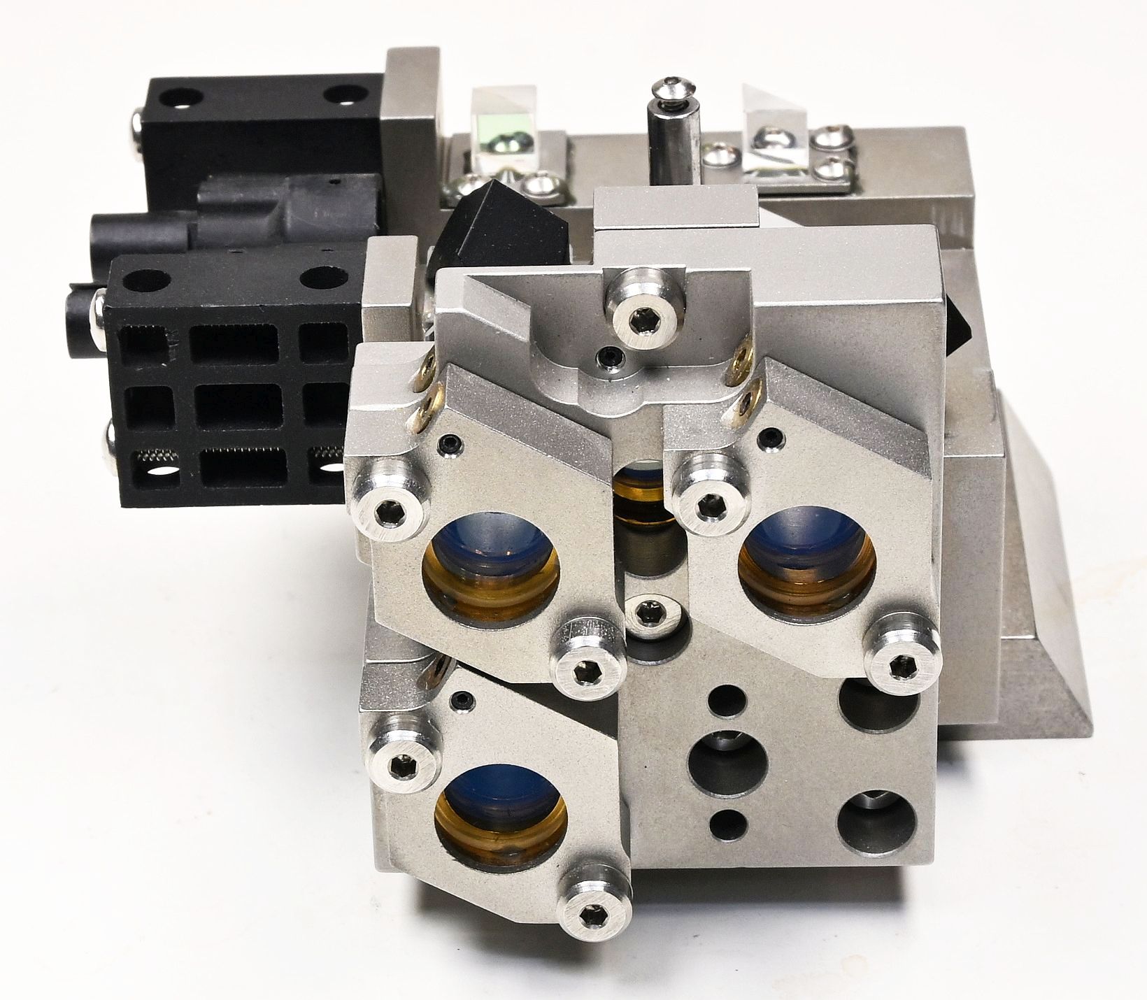

After almost completely disassembling a damaged 10719A, the optical arrangement
much easier to visualize. It consists of a pair of prism where one diagonal
edge is joined to form a polarizing beam splitter. The reflected beam
goes downward to a 1 inch cube corner hidden in the base. Four (4) 1/2"
standard HP/Agilent mica QWPs are glued to the casing behind the
elongated holes. What looks like an optical window in front of the
MEAS beams is just that, an optical window in front of the MEAS beams. ;-)
This is presumably to improve thermal stability by equalizing the path
lengths in the glass. See: Major Components of
HP/Agilent 10719A Single Axis Differential Interferometer. From
left to right, they are:
This unit was dissected because it was behaving differently depending on
whether the left or right aperture was used as the input. They are supposed
to be equivalent. But in one case all four beams were present but only
three in the other. The cause appears to be that someone must have been
inside this before me and managed to lose one of the QWPs. They probably
attempted to clean it by poking something in through the elongated apertures
and one popped off and was lost. The other (in the photo) was damaged. Oops.
CAUTION: So to restate this, it may be tempting to try to clean the optics
behind the windows but they are fragile mica QWPs just glued to the housing with
nothing backing them. So not only will they likely be damaged, but there
is a good chance they will pop off entirely.
And the small unmarked holes in the housing are for injecting RTV to secure
the PBS prism assembly and CC.
The input is a free space beam; the circular object sitting next to the
metal block appears to be a mirror to aid in alignment. Bot outputs are
fiber-coupled using ST connectors.
When I found this I thought it was going to be something really
cool. But in essence, it's just a pair of HSPMIs in series with REF
and MEAS swapped between them so the direction polarity is flipped.
The first one acts as a normal HSPMI for displacement. The second one
does the same with but with the opposite polarity, displacement is
canceled and only anglular changes will be detected.
There are basically two sets of identical HSPMI beam paths inside. The
top one in the diagram is for displacement. Part of the beam exiting
goes to optical receiver for displacement and the rest
is split off and re-enters the PBS but has been rotated 90 degrees
by a Half WavePlate (HWP) so the functions of the REF and MEAS beams
are swapped. Rather than any angular motion cancelling out, it adds.
That's it! Except that the packaging IS really cool - a 2-3/8x2-1/8x5/8 inch
milled stainless steel block with everything glued together inside. Repair
is probably not an option!
This could also be used as a displacement/differential interferometer,
The Angle output would be the difference in position of a pair of
planar mirrors that move with respect to each-other without changing
orientation. Essentially it would measure Displacement 1 and Displacement 2-1.
I wonder how many $thousands this was or would have been. ;-)
More to come.

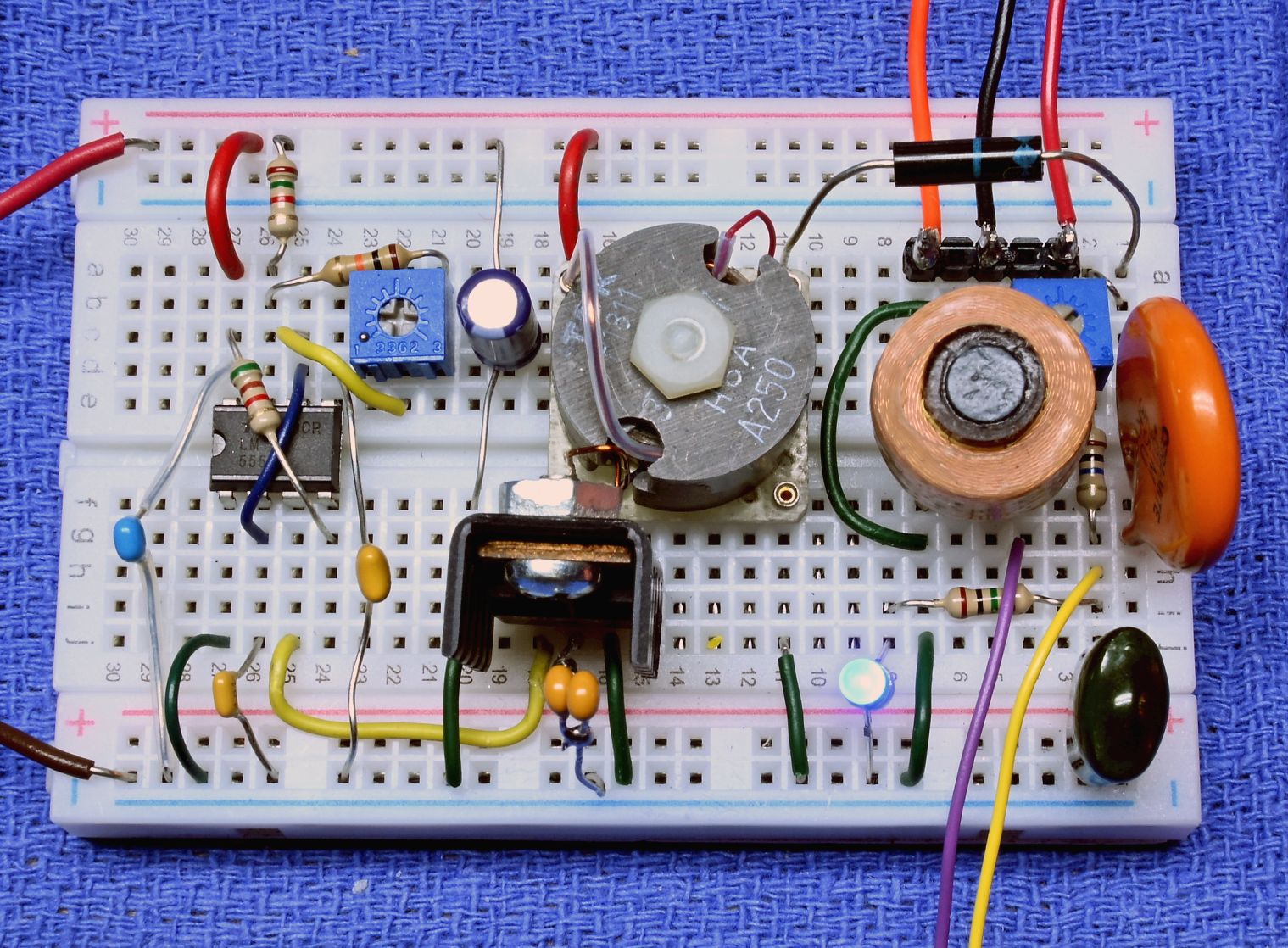

Not content to permit one of these lasers to rest wherever it pleases,
I've built a simple network to introduce a small offset into the
error signal driving the laser tube heater power amp to fine tune
the optical frequency. The circuit consists of a pair of 1K ohm
resistors feeding 4.7 V zener diodes from +15 VDC (TP8) and -15 VDC
(TP10) to ground (TP1). (These testpoints
represent convenient locations to attach the circuit.)
The regulated +/-4.7 VDC are probably not really needed but won't hurt.
A 25 turn 25K ohm pot connects between +/-4.7 VDC with its wiper
feeding a "gain control resistor", whose other end is the offset output.
The "Power Amp" test jumper on the Control PCB was removed and replaced with
a connector having a 2K ohm resistor to partially isolate the driving op-amp
(test header Pins 1 and 2, assuming pin 1 is on the left), and the offest
is introduced to pin 4 (which is shorted to pin 2 on the PCB). With a
33K ohm gain control resistor, one turn of the pot changes the optical
frequency by about 1 MHz, providing a range of more than +/-10 MHz. A
positive offset reduces the optical frequency on the 5517 laser. (It
would probably be the opposite for the 5501B.)

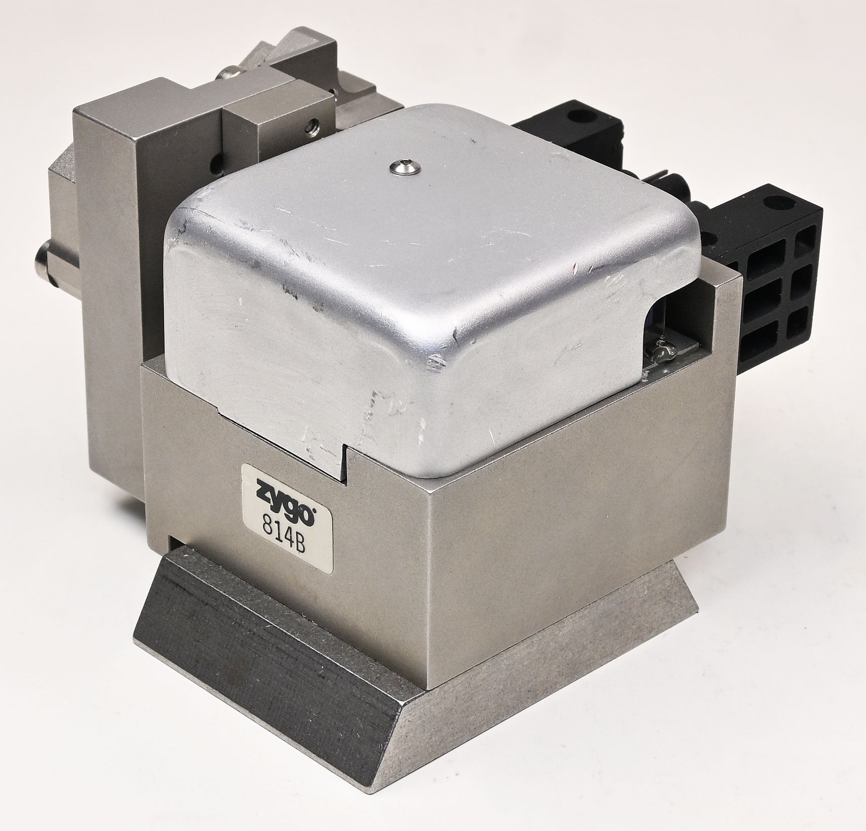

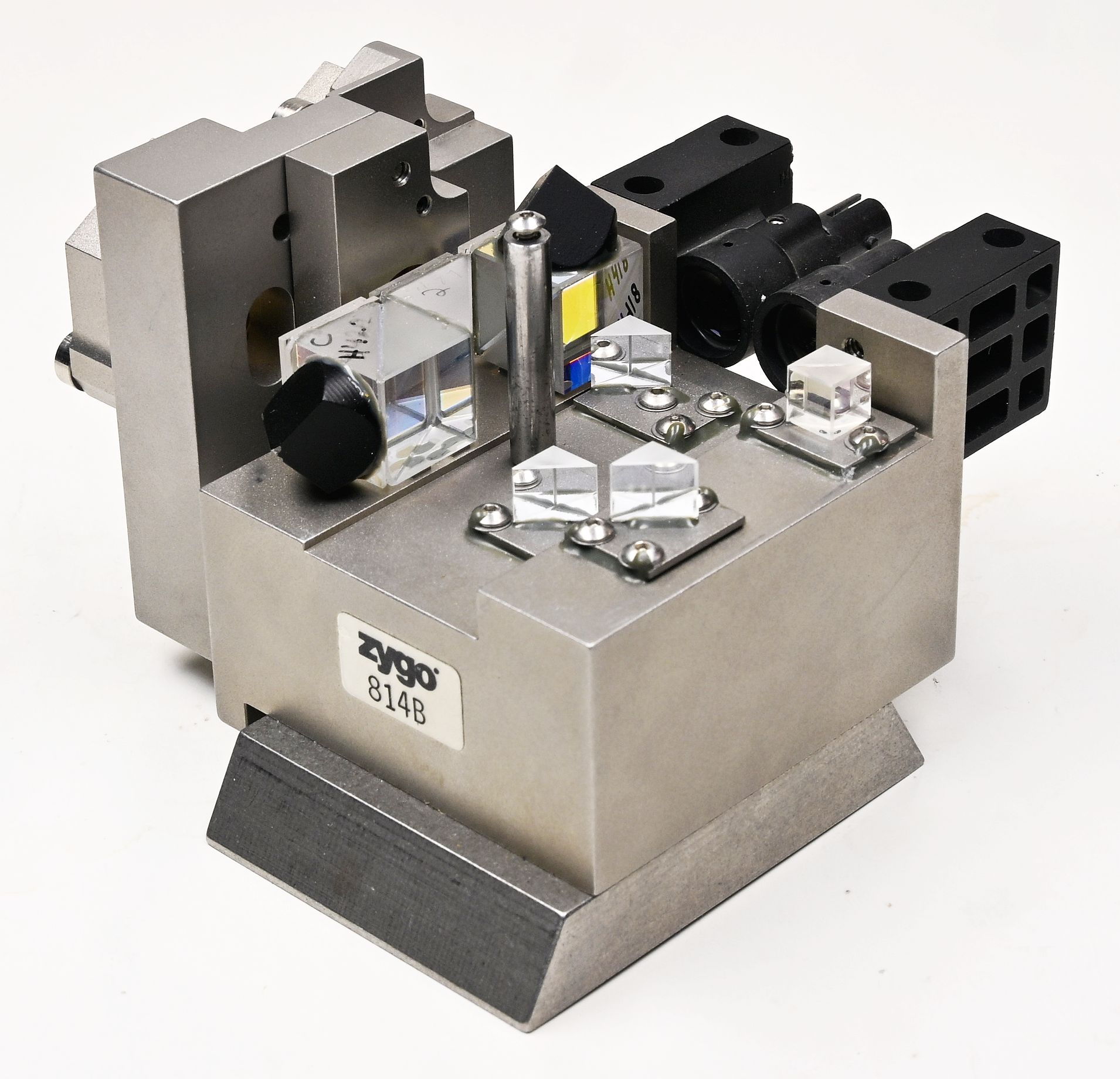

The actual displacement is measured using free-space beams. This thing
apparently operates at a wavelength around 1,300 nm as the OZ Optics
fiber connectors all have designations for 1,300 nm, strange. Strange
because there are no common low cost laser sources which are both single
longitudinal mode and optical frequency accurate around 1,300 nm. The
most likely might be a DFB diode but once stabilized, the cost would
be similar or higher than a similar HeNe laser. And resolution
at 1,300 nm all other factors being equal will be about half of
that at 633 nm. And, no, it's not just the fiber connectors.
It definitely doesn't work correctly with a 633 nm HeNe.
The manufacturer is unknown - scraped off before the seller acquired
these. But it's likely not many of these were ever
made as the serial number of one I have is "6". Not even 106 or 1006,
just 6. ;-) So perhaps it wasn't entirely successful. :( :)
Here are some photos of a typical unit (courtesy of Mike Read):
Also visible is a brass gas compression fitting that would appear to serve no
purpose since the top plate does not have an O-ring, the window on the far
side for the free-space beams is not sealed at all, nor are any of the holes
for the fiber-coupled beams. So perhaps this was never actually completed.
By using a 633 nm (red) fiber-coupled HeNe, it was possible to confirm the
beam paths for the two possible inputs:
But with no access to a polarized 1,300 nm laser, any polarization coatings
do not do anything meaningful. :( 633 nm is probably about the worst
wavelength to use to determine anything about reflective coatings or
polarization behavior, being close to 1/2 of 1,300 nm.
So, while these beam paths are fairly
certain, exactly how the unwanted beam paths are suppressed - if the are - is
not known. For example, what is the purpose of the diagonal
inside the input prism? The reflection from there hits the wall of the case
for both the L and H inputs. Perhaps it acts as a polarizing beam-splitter and
guarantees that the unwanted polarization does not get any further. ;-)
But there shouldn't be any unwanted polarization from the
polarization-maintaining fiber.
And the block under the cube corner is suspected to be a Quarter WavePlate
(QWP) but that cannot be confirmed either.
However, at this point my thought is that this was a failed experiment whose
design is fundamentally flawed. There are several reasons for this but the
biggest one is that the use of a PM fiber for the input and non-PM fiber for
the output as implemented does not permit displacement information to be
determined regardless of whether a Single Frequency (SF) or Two Frequency
(TF) laser is used. Both of these require the polarization state of the
merged beam to be fixed and orthogonal. With an SF laser, a "quadrature
decoder" produces electrical sin and cos signals that are 90 degrees from
each other. With a TF laser, the beat signal between the two orthogonal
polarized components is used, but this requires maintaining the polarization
state until the detector also. A non-PM fiber will not do either. Further,
as noted above, there is no real TF laser option at around 1,300 nm.
Another curiosity is the apparent requirement for two lasers (or at least two
laser inputs) to the interferometer blocks. Normally, a single laser is used
and split to feed each axis. Doing that internally would make a lot more
sense compared to requiring a fiber splitter, two expensive fibers, and two
expensive PM fiber couplers.
Functionally, this is a two-axis differential interferometer where the
horizontal (X) axis has a baseline of 1/2 inch and the vertical (Y) axis has a baseline
of 1 inch. For very small deviations, it may also function as a two-axis
angular interferometer. But to use cube corners to achieve a wider angular range,
additional QWPs could be added to effectively cancel out the internal QWPs.
(This would be simpler and lower risk than removing them.) Then
it would then be equivalent to a pair of standard angular interferometers
at right-angles to each-other with short baselines. And since the optical paths
are totally independent except for the input to the NPBS, the two axes do not
need to be used for the same type of measurement. So displacement, differential,
and angle can be mixed.
This is very solidly constructed entirely of stainless steel
with the principal optics all secured with adhesive
to a single massive baseplate. The wedges are on a separate massive plate that can be
detached. They can be rotated to tweak alignment with worm gear-driven screws.
Despite its small size (approximately 3-1/2 x 3-1/2 x 2-1/4 inches),
this thing weighs almost 3 pounds.

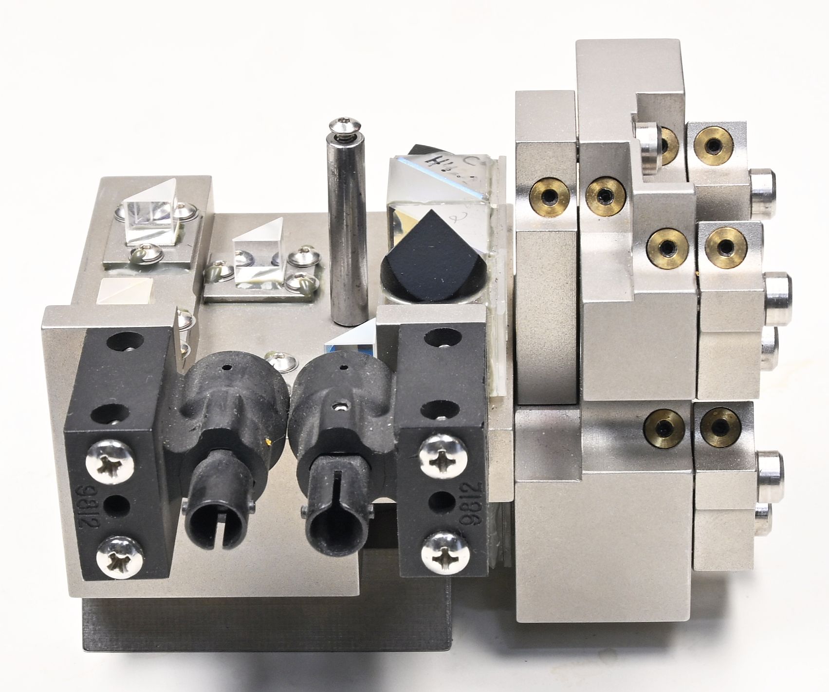

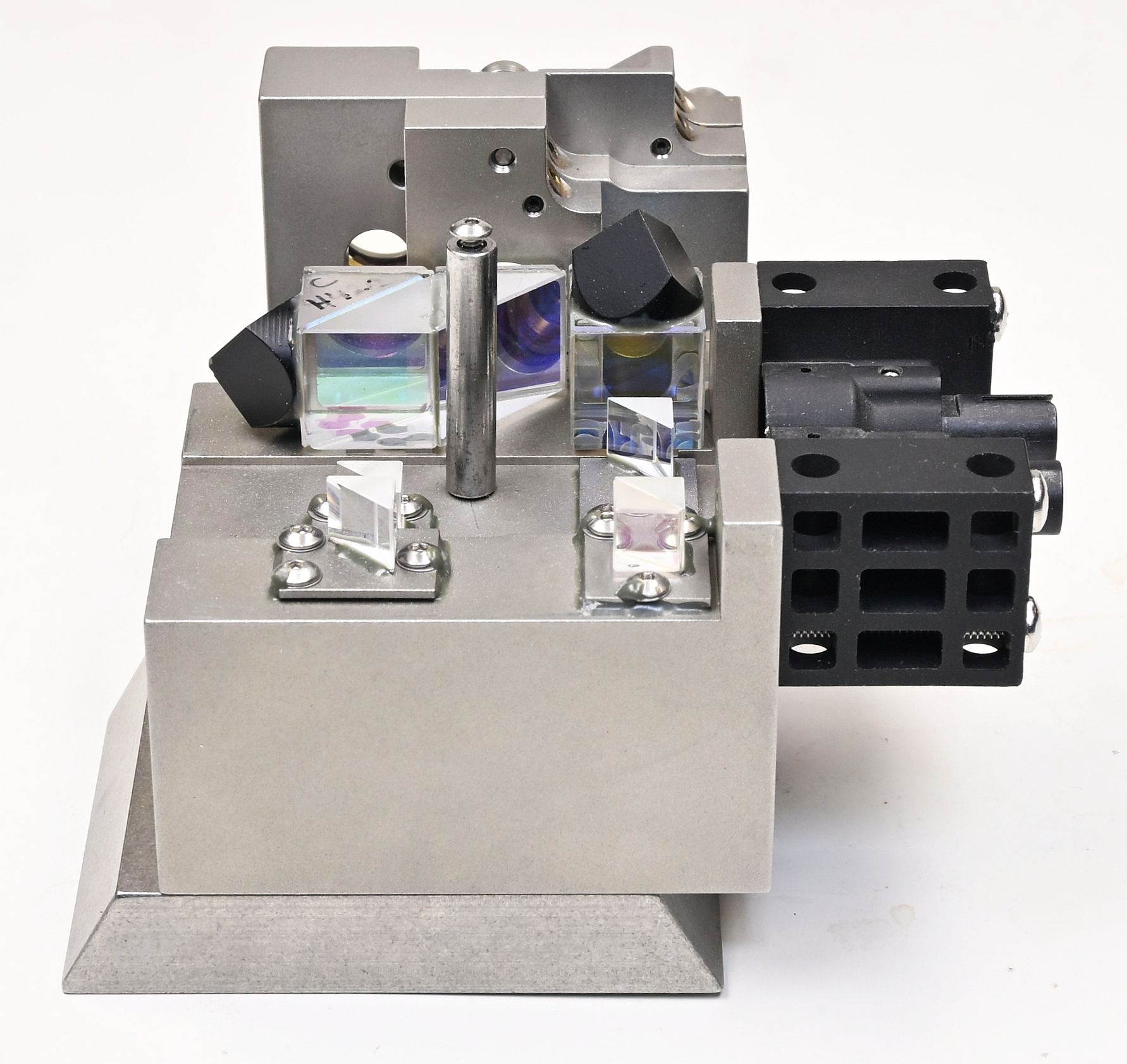

The basic beam paths have been confirmed by setting it up with a linear polarized HeNe
and plane mirror on a tip-tilt mount. Here are some photos:

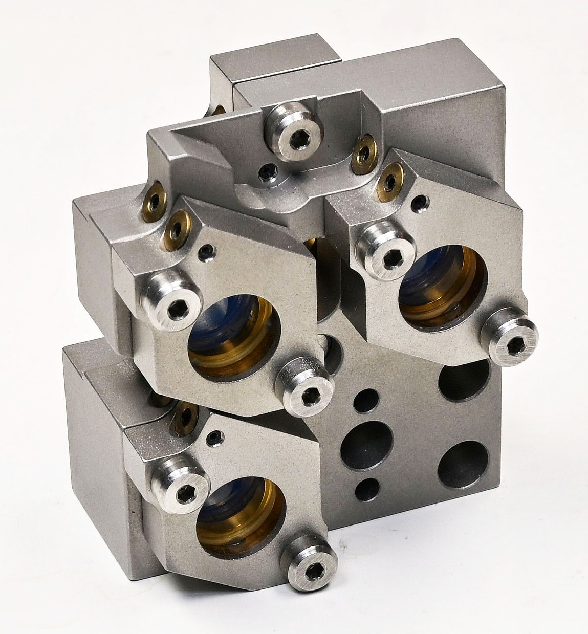

Those wedges are the key to everything, alignment-wise. One would think that the
interferometer block would have been pre-aligned at the factory so that at least
under certain conditions like a single planar mirror orthogonal to the optical center
line, the alignment would be at least close. Unfortunately, at least for this
smaple, that was far from true. It was so far off that the return
beams did not even hit the edge of the output apertures (fiber connectors).
The wedges need to be used to dial it in using a procedure along the lines of the following:
Once there is "First Light" from the fiber connectors even if it's off the side or
mostly cut off, it's literally just a couple of more work
minutes to optimize alignment resulting in clearly defined fringes displayed on a white
card behind the fiber connector, and then possibly a single circular fringe depending
on the beam profile. Really. ;-) Further fine tune alignment so the beams out of the fiber
connectors go straight back. Or better yet, if a Zygo fiber is available, peak
the power coupled into it. If the 8124B is to be used with free-space optical receivers,
remove the fiber connectors and confirm that the beams go straight back.
But as noted, it's critical to lock down the setup before adjusting anything or else it
will be a fight against unexpected movement.
