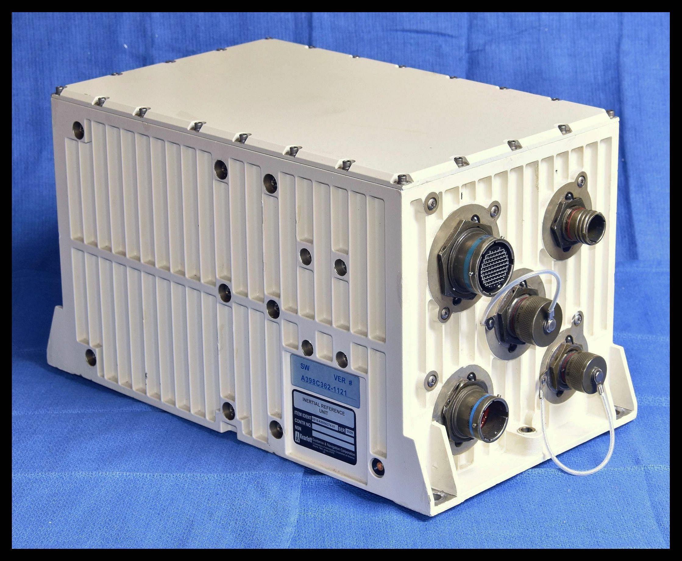

Kearfott Inertial Reference Unit K600A374-01
This is a complete system, probably intended for "Sea Navigation" - e.g., in
submarines, larger UAVs, and the like that have degrees of freedom similar to
those of an aircraft. But for ships, only 2 of the 3 axes would be useful,
except perhaps in a tsunami and/or after sinking. ;-) Exactly
what the difference is compared to "Land Nav" systems is probably more
in the interfaces and other capabilities than the specific hardware
and functions. The primary physical diffference appears to be of
the paint color in the Kearfott brochures: Land Navs are black;
Sea Navs are biege. I suppose that black doesn't show dust and
dirt like a light color would. ;-)

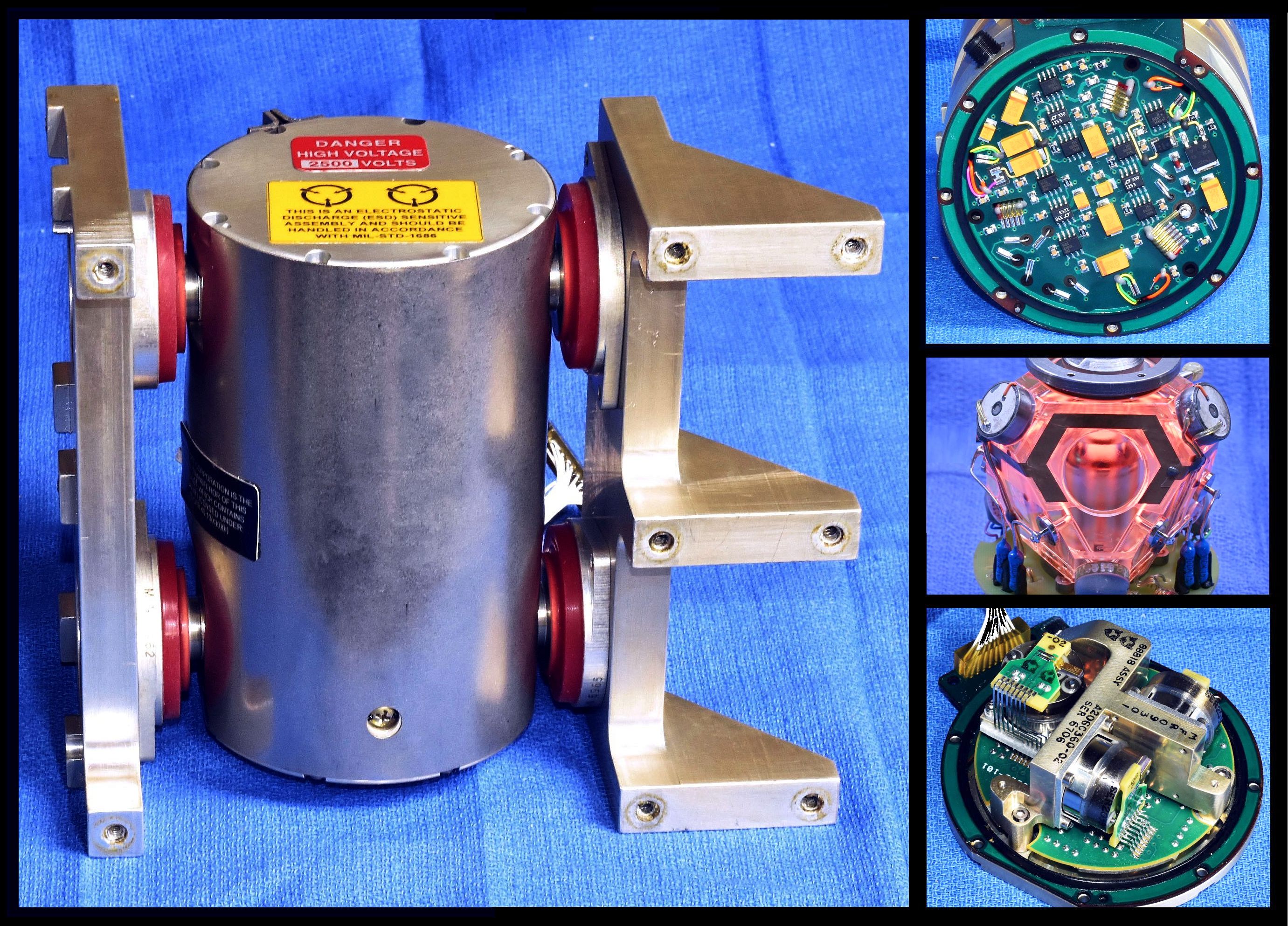

Kearfott IRU from left to right: Exterior, Interior Labeled,
Inertial Sensor Assembly Platform "ISAP" and its Major Components
(MRLG PCB, MRLG Block, and Accelerometers), MRLG Block Labeled, MRLG Block Larger than Life

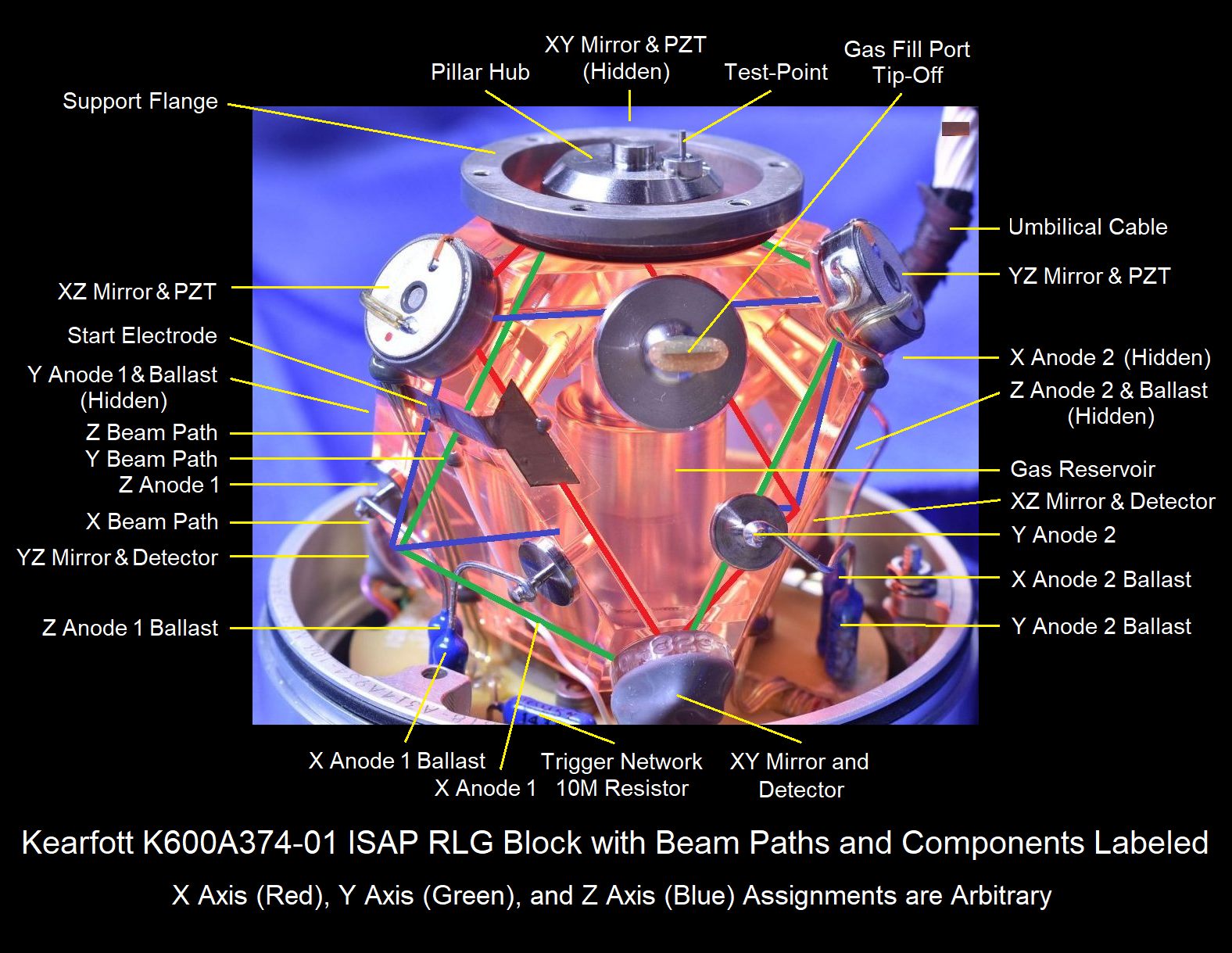

The Ring Laser Gyros (RLGs) in this IRU are interesting because all three axes
are fabricated in a very compact monolithic block of special low expansion glass
or ceramic, henceforth referred to as the "MRLG Block" or just "RLG Block".
(The accelerometers are totally separate.) At present not
much else is known about the overall IRU other than that the RLGs do light
up, at least briefly when power is applied. The rectangular portion of the IRU case is
10-15/16" (L) x 6-7/8" (W) x 7" (H). Including the extensions
at the ends with the mounting holes and connectors, the length
increases to 12-1/2 inches. Its weight is around 14 pounds.
For reference relating to what follows, the dimensions of the MRLG
block itself - the 'heart' - are less than 2-1/2" across x 2-1/2" tall and it
weighs under 8 ounces. For much more information on this IMU, go to
Sam's Laser FAQ: Kearfott K600A374-01 IMU
with Monolithic Block Triple RLG.
Note that most of the photos here and in the Web
Albums below have the MRLG Block inverted compared to how it is mounted
within the cylindrical ISAP housing in the IRU. It's more photogenic
that way and the photons don't care. But for this reason, some of
the terminology like the designation for the "Base" of the ISAP Housing
(which is really at the top) may be a bit confusing. Sorry. ;-)

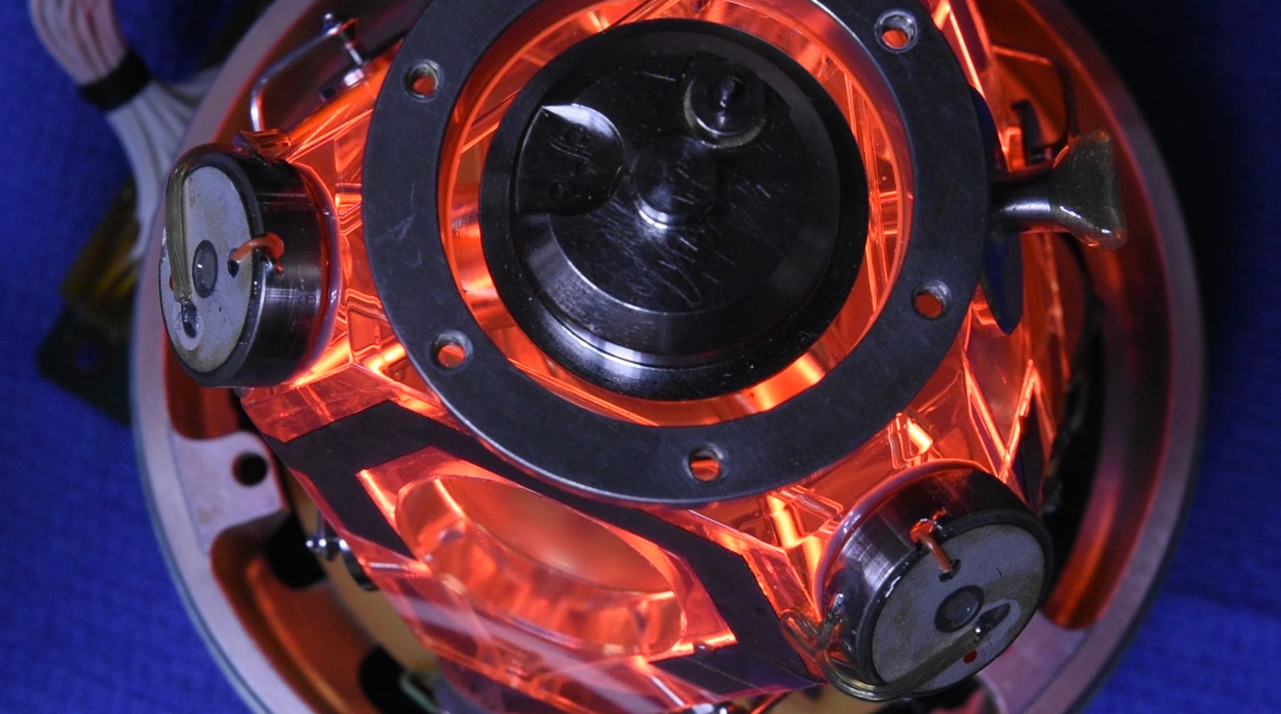

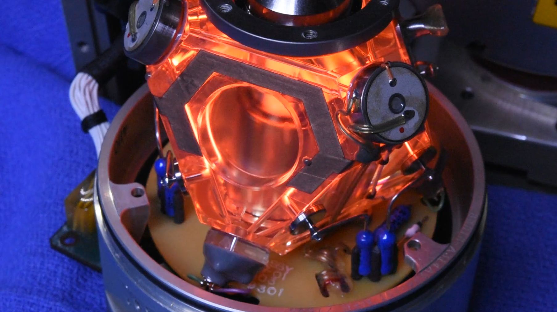

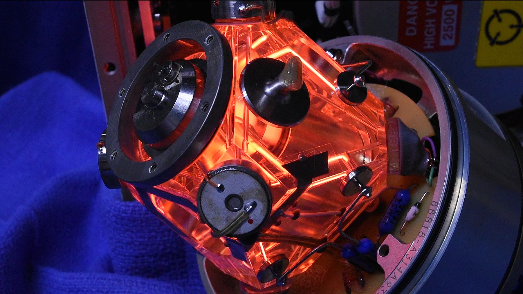

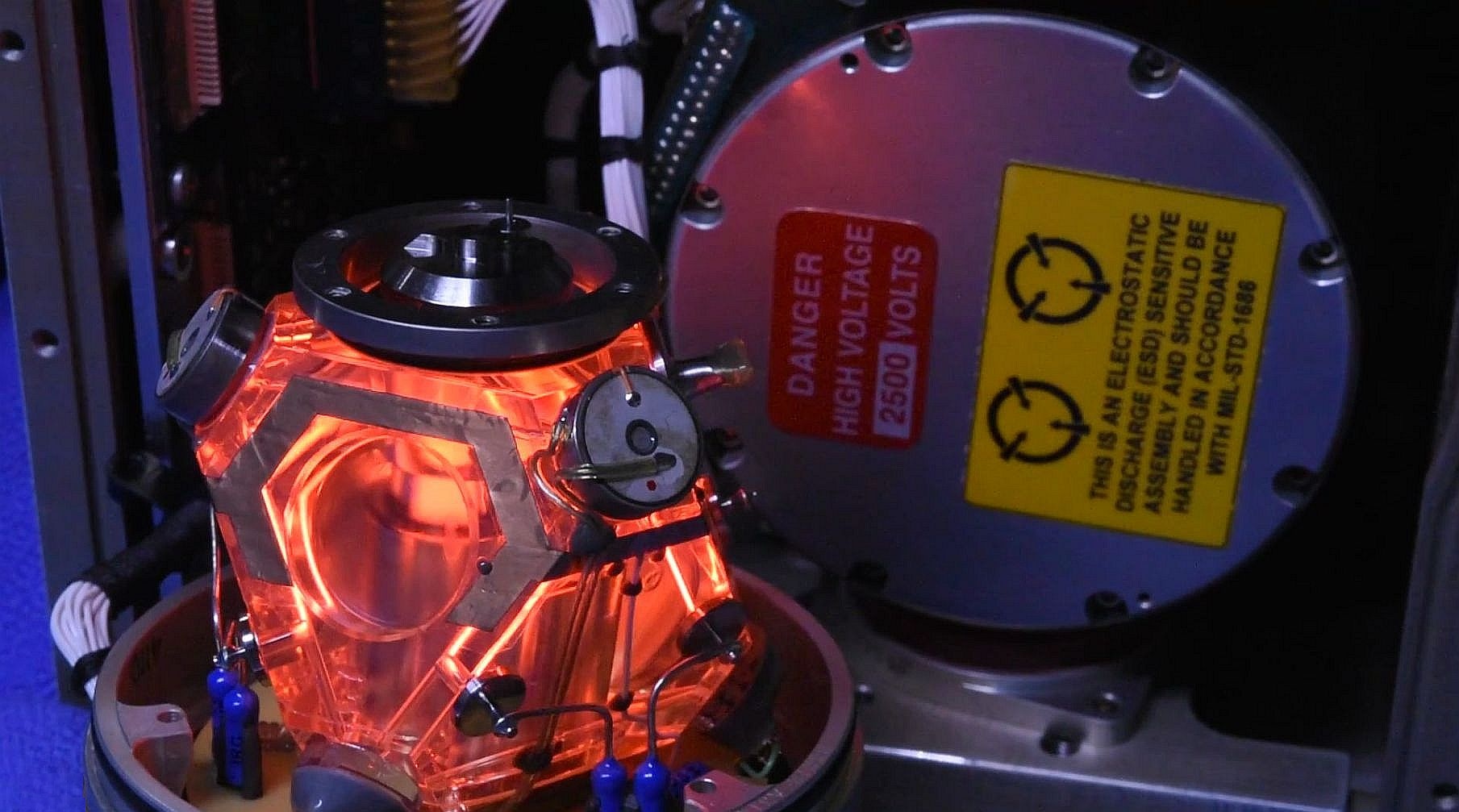

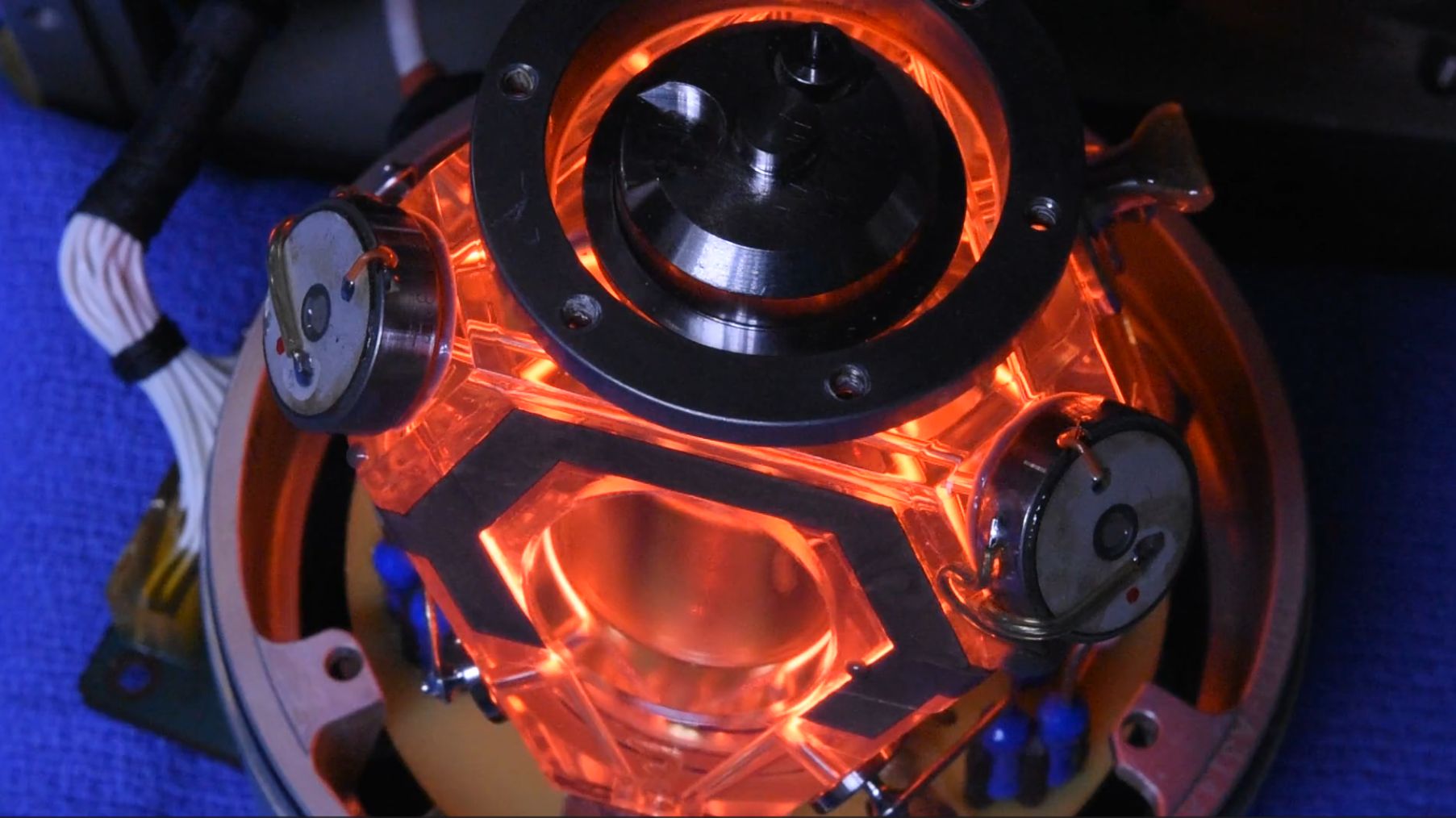

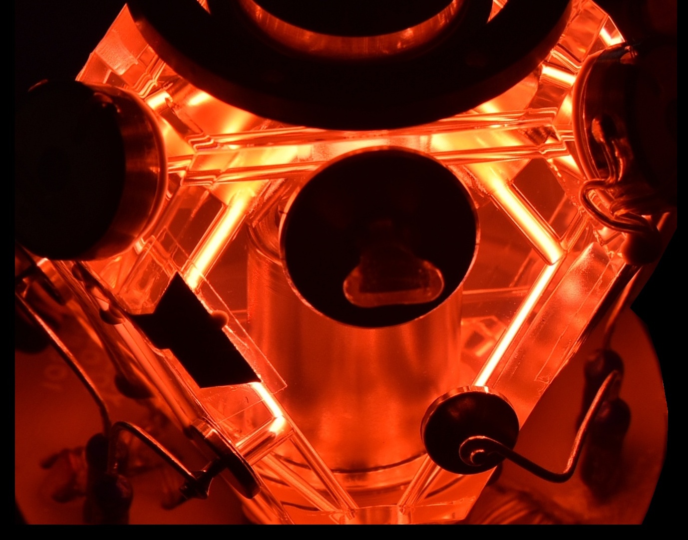

Overall Setup for Powered ISAP RLG Block Photos (left) and Closeups
These videos show the naked RLG Block from IRU #1 tethered to the
power supply and electronics from IRU #2. Minor rearrangement and
camera angle variations similar to the next three are used for all the
powered photos in the first part of the Web Album, below. The right-most photo
has the RLG Block oriented in approximate agreement with the schematic derived
from the Kearfott patent. However, even with the thing in-hand and
powered, it's virtually impossible to figure out the discharge and
beam paths due to the contoured exterior of the block and
distortion of the interior.
The snapping sounds near the beginning and end of the videos are from the outlet
strip power switch - on and off. Around the mid-point of the video, the
RLG Block glows brightly three times in succession accompanied by a
continuous audible whine (likely from the dither PZT). This behavior
is 100 percent repeatable and IRUs #1 and #2 do exactly the same thing,
so it's very likely a feature, not a bug. The assumption is that there
needs to be some handshaking with whatever the IRU is connected to for
it to remain active. The power LED does stay lit but that is the
only remaining sign of life. So these videos get really boring in almost
no time at all.....

- Overall views (Front1, Right1, Front_Right1, Right1, Back_Right1, Back1,
Back_Left1, Left1, Front_Left1): These are virtually identical in
appaerance to the sample on the Kearfott Website in the year 2025 under
"Sea Nav IMUs".
- Connectors1 and Connector1-5: These are the panel with the
five military-style circular connectors and closeups:
- J1 (66 pins): Control / Signal / Information.
- J2 (15 pins): Power input. 28 VDC nominal, 30 W max. 24 VDC OK.
+Vin: Pins A,B; -Vin: Pins M,N. Case GND: Pin P. No other pins used.
- J3 (13 pins): ????
- J4 (22 pins): ????
- J5 (13 pins): ????
(J3 and J5 have the same pin configuration but are keyed differently.)
- Label1: This has both the numbers as described above. This unit
is SER 0009

- ISAP_with_Mounts1: Front, Right Side, Back, Left Side, Top,
Top_Label, Bottom. The upper cable is for the RLG, the lower cable is
for the accelerometers. The +HV socket for the RLG is also visible.

- ISAP_RLG_Block_Not_Powered, Powered, and Dark_Powered: Several
sets of photos from various orientations and distances showing the RLG Block
in room lighting, with the discharge powered, and the same in the dark.
However, being tethered to the HV and RLG cables severely limits options for
creative photo composition. ;-)
The first set of three shots shows the overall setup for taking these photos
with the naked ISAP RLG Block next to its clothed buddy inside the IMU.
Since this IRU is not connected to anything except power, it does not stay
on for more than a few seconds. This is not thought to be a fault since
unit #1 does the same thing. So it's a feature, not a bug. At least
that is the assumption: Its microbrain expects some sort
of hand-shaking or acknowledgement and quits when this does not occur.
Further, the RLG Block is only powered three (3) times for a second or
so and then shuts off until the next power cycle. So the photos of the
RLG Block with the discharge glowing required applying power to the IMU
with the camera already focused and its shutter mode set to "Repeat". ;-)

- ISAP_RLG_Block_with_Beam_Paths_and_Components_Labeled1: Each ring cavity is
color-coded to more clearly show how it is embedded and oriented in the RLG block
along with labels identifying the major components.
Each ring or beam path is a tilted square that surrounds the central pillar. It is
very difficult to visualize the relationships in the actual device in part
due to the distortion caused by the block, perspective when viewing the
actual block in any photo of it, and the (incorrect) assumption
that the ring paths must be close to the outer surfaces. There
may be errors and it has nothing to with AI! ;-)

- ISAP_RLG_Block_First_Light1: After removing
the base, this is the first time any of the discharge paths have been lit
from an external HeNe laser power supply. Electrically, all 6 discharge
paths are in parallel, only isolated by 100K ohm ballast resistors. So if
driven by a constant current power supply like one for a normal (single) HeNe
laser, the first discharge to strike will pull down the voltage
on all the others preventing them from starting. And indeed only a
single discharge path is lit in the photo with a current of around
0.4 mA. In the IRU, the controller applies a pulse via a HV diode
in parallel with a 10M ohm resistor to the metallic strips visible
in most of the RLG photos. So it's like a xenon flashlamp trigger.

- ISAP_RLG_Block+External_Power_Supply1: This
shows the RLG block on an acrylic stand running off a custom stand-alone power
supply constructed on a solderless breadboard. The input is 12 VDC which is
boosted to 600 to 1,200 V by the inverter transformer (center of circuit).
The micro-switch in the lower left discharges a capacitor into the trigger
transformer (right side of circuit).
- ISAP_RLG_Block_External_Power1-6: Closeups of
the RLG block on external power.
- ISAP_RLG_Block+External_Power_Supply2: The
power supply has been transferred to a Perf. board to be more permanent.
