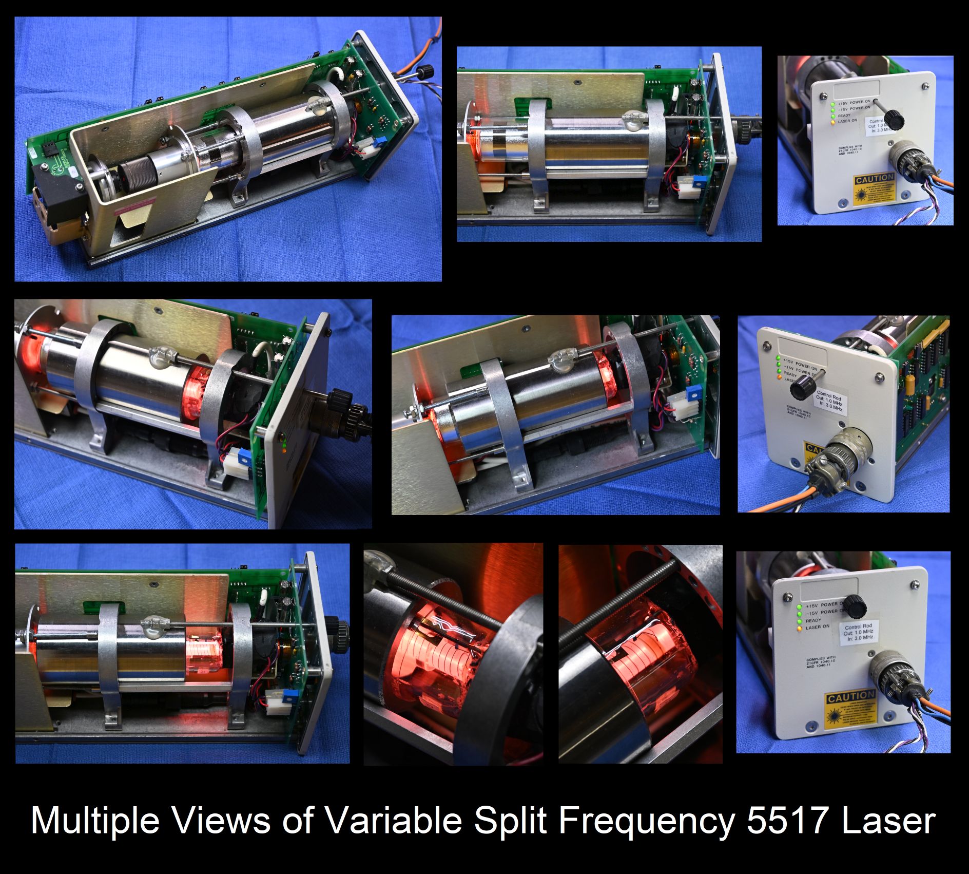

Fixed 1 MHz to 3 MHz Split Frequency Laser
But for these experiments, the solution of choice was to be fully mechanical. My first thought was to insert soft iron shunt strips between the magnet and tube that would shield or bypass a portion of the permanent magnet's field. But some tests with tin can stock showed that it would be difficult to achieve enough of a change (3:1!) to be worthwhile. In addition, this approach would still present a risk of permanent demagnetization.
So the mounts for the tube and magnet were modified to allow the entire magnet to be moved axially with respect to the tube. A naked tube (don't ask!) was selected that had decent output power to use for this purpose. (Removing the bare glass tube from the potted magnet assembly is not something one discusses in polite company and requires several hours, so there are very few of these available. And even fewer that are in usable condition.) I would have liked to have the REF frequency range extend from that of the 5517A, 5501A/B, and N1211A (below 1.5 MHz REF to that of the 5517D (up to 4 MHz REF). But the only bare tube I had available with decent output power was from a 5517C. Sometimes these can be boosted to a 5517D REF with a more powerful magnetic field, but a test showed that not to be possible for this one without the creation of rogue modes. It's not worth the effort to extract a proper 5517D tube so this will have to do for now. The tube assembly frame from a 5517B was modified to permit the Alnico magnet itself to slide over a span of about 2 inches. This required removing and remounting the beam expander on spacers and and the waveplates on the aluminum surround. A 5517 magnet was charged to over 500 gauss and then had a socket for a rod with a handle attached to it with not-melt glue. The rod extends through the Connector PCB and Backplate of the laser. Only a single diode had to be relocated for the bypass. Now, the REF frequency can be easily adjusted from outside the laser. See HP-5517 Laser Modified for Variable REF Frequency and Multiple Views of Variable REF Frequency 5517 Laser. The photos are shooting to the left which violates my normal rule for laser orientation, but that's more photogenic. Live with it. ;-) For maximum REF, the rod pulled all the way out placing the magnet in approximately the normal position with its coverage coincident with the tube's discharge. For lowest REF, it's pushed all the way in so that only about half of the discharge is covered by the magnet. I should label it "Reactor Control Rod". ;-) The magnet field strength had to be reduced slightly to avoid rogue modes at maximum REF, resulting in a usable range of about 1 to 3 MHz. A Scanning Fabry-Perot Interferometer (SFPI) was used to confirm that the laser is pure single mode (no rogue modes) even at maximum REF, though probably just barely. Unfortunately, REF of this 5517C tube could not be boosted into the 5517D range. Since µMD1 has a built in REF frequency readout, setting the laser to any REF within this range is quite trivial. The laser does not usually lose lock in the process, though locking may not be reliable initially at maximum REF.
Note that stock HP/Agilent lasers never use an effective magnetic field as low as is the case here at minimum REF. While the laser appears to work fine and is happy, there could be long term stability issues attempting to do this in a critical application, though I do not know this with certainty. In addition, moving the magnet to adjust REF is not precisely equivalent to varying the magnetic field as the field distribution within the discharge changes and even reverses polarity beyond the end of the magnet. One unexpected result of this is that rather than the output power declining monotonically as the REF frequency increases as it does when the split gain curves are moved further apart, with this setup, the output power is greater by 10 to 15 percent at the minimum and maximum REF frequency than in between. A detailed theoretical analysis of the effect of these conditions on the lasing process is left as a trivial exercise for the reader. In other words, I have only a partial clue but it appears to work well enough in practice. ;-)
General Purpose Variable Split Frequency Test Bed
A couple years after this stunt, I built a jig with a sliding magnet so any bare "Long" HP/Agilent/Keysight glass HeNe laser tube could be installed in my "lab rat" test 5517 laser (or other 5517 or 5501B laser body) to provide a range from the normal position of the magnet (with its edge lined up with the anode-end of the bore discharge) down to a nearly a 0 gauss field (with the magnet way beyond the cathode-end discharge escape holes). See HP-5517 Laser with Full Range Adjustable Magnet for Variable REF Frequency. The "Long" tube is supported at both ends by a drilled out HeNe cylinder end-cap at the rear and some sort of PVC plumbing fitting at the front. A set of waveplates is part of the assembly so it will lock normally if the split modes are cooperative. :) But there is no beam expander since alignment with that would be too finicky - an external beam expander on an adjustable mount is available for that purpose. (Adapters will be required to innstall a "Short" tube but at the present time there are no plans to create them.) This rig enables a range of split frequency (REF) from the "rogue mode limit" at the high-end (if the magnet is sufficiently powerful) down to well below 100 kHz. A fine line can be seen on the far rod where the maximum locked split frequency occurs for this ~500 G magnet. However, the split frequency at that location is not the maximum possible for the tube. More below. There is also a smudged line where the magnet is in the optimal position, which would be way above the rogue mode limit. The 5508A display tracks down to a REF below 100 kHz, but is eventually limited by the frequency response of the laser's internal REF receiver and the MEAS 10780 optical receiver, and possibly a lower limit in the firmware of the 5508A. The raw signals remain clean well below this. Operating at split frequencies less than 100 kHz is possible with HP/Agilent tubes due to their very small mirror asymmetry. Typical barcode scanner tubes would lose the beat frequency well above this range. Of course, the maximum stage slew rate at 100 kHz in the direction that decreases MEAS is vitually nill. :)
However, to obtain the maximum split frequency, the magnetic field must be trimmed so the rogue mode limit occurs just above when the magnet is in the normal (optimal) position relative to the tube - where it lines up with the anode and cathode discharge escape holes. This is because the field distribution from a cylinder magnet is not uniform and in fact reverses polarity beyond the ends of the cylinder as shown in Field Along Central Axis of Ideal Magnet used in HP/Agilent Laser, and more generally for other size magnets in Axial Magnetic Field Distribution On-Axis for Cylindrical Permanent Magnets with Various Length (l) to Diameter (d) Ratios. What this means is that as the magnet is moved away from the optimal position, parts of the bore see the reverse polarity field and thus the split neon gain curves in those regions shift in the opposite direction. When the "positive" and "negative" portions are combined, the net effect is for each of the split gain curves to be wider with a smaller net shift, which reduces the mode pulling responsible for creating the split Zeeman lasing mode. And while waving my arms wildly, strange things happen. :) Specifically, there will be no position of the magnet where the maximum possible split frequency can be obtained in a stable locked manner - not even close. In an extreme case (possibly not with a standard HP/Agilent magnet though), there could be a null point where the two pairs of gain curves are shifted symmetrically and the split frequency goes to 0 Hz even though the tube is in a strong magnetic field. And beyond this point, the loop error term woudl reverse polarity resulting in an inability to lock as a 5517. It would then be necessary to reorient the waveplates or switch from 5517 to 5501B locking.
As a specific example, using the tube from a reasonably healthy 5517A or late model 5501B (which are similar), the maximum split frequency in this rig with a 500 G magnet is limited to around 1.4 MHz with the magnet located at that mark on the mounting rod. Closer in than that, lock is lost due to rogue modes confusing the feedback electronics as the field is increased as the rogue mode limit is exceeded. But if the same magnet has its field reduced to the rogue mode limit - somewhere around 425 G for this tube - locking occurs reliably at a split frequency above 2.2 MHz with the magnet in the optimal position. And it declines smoothly and monotonically as the magnet is moved down the track away from the optimal position, usually without losing lock along the way.

An inexpensive Pulse Width Modulated (PWM) controller drives the magnet nicely. There are may choices on eBay for under $5 with suitable specifications: 3 A maximum at 15 VDC, with PWM from 0 to 100%. Just search for something like "PWM DC Motor Driver". Some have a polarity switch which is handy for the magnet, though it's possible that bad things will happen if it's flipped while running at full power.
An Arduino-based H-bridge driver based on an Atmega 328 Nano 3.0 has been constructed so that the field can be varied continuously from under 100 G to over 500 G using a single knob, with a display in (average) Gauss. :)
Specifications for full range Zeeman magnet coil driver
Line 1: I: ±X.XXA YYY.Y% Line 2: Avg Field: ±ZZZG
It uses a rotary encoder for control with a 2x16 line LCD (HD44780 standard) display for the current and Gauss readouts. The knob specifies a current from around -2.75 to +2.75 A. It is implemented open-loop so scale factors for the current field is stored in the firmware. Eventually, current feedback using a 0.1 ohm sense resistor may be added to maintain the set current closed loop even if the coil resistance changes due to temperature. Essentially, when the encoder knob is turned, the controller would incrementally adjust the current from its previous value based on a moving average of the sensed current. When the knob is stationary, it will maintain the current at its present value by adjusting the PWM. The average field strength will be calculated using the sensed current based on the above data (or more likely simply the slope based on the end-points). However, I rather think adding this is unlikely as it works well enough as-is.
A hybrid "sort of" schematic diagram for the initial version may be found in Bipolar Zeeman Electromagnet Coil Driver V1.0 along with a photo of the setup in Zeeman Electromagnet with Full Range Driver. The Atmega firmware is called "Zeemagnet Driver". :-) This runs totally open-loop using the knob alone to adjust the current. The Atmega 328 Nano 3.0, H-bridge driver PCB, and 2x16 character LCD were each under $2 on eBay. :) The driver PCB has the L298, free-wheeling diodes, and a 78M05, 5 V regulator. (For this setup, it is disabled as recommended where the input voltage is above 15 VDC, and a separate 7805 is used.) The two channels of the L298 are driven in parallel. An optical encoder was used since one was available crying out for attention. ;-) Mechanical encoders are much less expensive but hardware or software debouncing would probably be required. A pot was not deemed suitable since it was desirable for the default current at power-on to be 0 A regardless of knob position. The sense resistor is present but not used just to assure that its voltage drop won't affect operation since the return current of the L298 also passes through it since its in the total return current path from the H-Bridge driver PCB and thus will add a small offset to the logic levels. A small fan was also added blowing air through the L298 heatsink.
This works very well except for one quirk: While the behavior is as expected with a purely resistive load, when driving the coil on magnet, there is a dead zone below a PWM value of around 16 (out of 255) in both polarities. Within this region the current through the coil is essentially zero based on multiple tests. Elsewhere the current changes smoothly as expected and there are no discontinuities. The behavior has been confirmed both by measuring the current directly using a DMM, and by monitoring its effect on the Zeeman split frequency - which is how the anomaly was first detected: Rotating the knob through the dead zone had no effect on the scope display. It was as though the field/frequency was getting stuck over a noticeable range as the knob was rotated, even though the LEDs were changing as expected. :( :) The drive waveforms across the coil and the sense resistor appear perfect. The red/green LEDs monitoring drive voltage do what is expected. But even with external measurements claiming it should be fine, the current remained zero. Switching the PWM frequency from 1 kHz to 31 kHz had little effect (except to make an annoying whine at 1 kHz, present regardless of the setting except exactly 0!). And the ripple at 1 kHz shows up in the scope frequency display. Driving them by pulsing the Enable inputs along with In1 or In2 set sppropriately (rather than tying the Enable high) resulted in peculiar behavior where both the red and green LEDs were both on for any drive level other than 0. In this case, the inductance is probably causing the reverse polarity when the drive pulse is removed. So that's not real useful.
Then I thought I had a revelation that permanent magnet core would be the key to understanding what the heck is going on since the coil is no longer a pure inductor. Although the coil may behave normally with DC drive, the PWM confuses it. The interaction of a coil with a permanent magnet is apparently rather complex with several possible non-linear effects. But exactly what is going on here remains a mystery. The firmware can be modified to compensate based on phenomenological behavior, but it would be nice to understand the underlying cause(s). Unfortunately, the magnet cannot be removed for testing as a pure inductor. And winding a similar coil on a cardboard form using another 3-1/2 pounds of wire is also not a realistic option! :-) However, connecting the driver to the other test coil which has no core (HP-5517C HeNe Laser Tube Installed in Modified Tube Assembly with Electro-Magnet Solenoid) resulted in text-book behavior with no evidence of a dead zone. Even though zero current and zero field produce no real Zeeman effect, there is still enough oscillatory instability in the output of the tube that small changes in the the magnetic field environment can be detected. Each increment of the encoder knob resulted in a noticeable and predictable response even near exactly 0. While the coil is not identical with only around 600 turns, differences in dimensions, and an aluminum cylinder for the coil form (which would result in some eddy current loss), if there had been any dead zone, it should have appeared. Perhaps not. The inductance may have just been to low for it to show up.
But then I recalled that I had an inexpensive PWM driver and tried that. It's only unipolar, but a dead zone should have shown up near the lower end if the issue was with the coil/magnet load. None. Perfect behavior at all levels.
So back to square zero as far as an explanation...... For now (and probably forever), the dead zone has been coded out in the firmware. ;-)
After initial testing, the 2 line 16 character HD44780-based LCD was added. Calibration was then done with respect to the effective magnetic field based on measurements at several values of current. The fixed permanent field offset and a coil-specific (linear) gain provide satisfactory accouracy.
Complete details should you wish to replicate this can be found in Universal Bipolar PWM Driver 1 Assembly Manual.
So it is done. ;-) Actually installing the coil in an HP laser required some physical modifications for it to fit including cutting and moving a portion of the aluminum shroud and the backplate so that it will mate with the shifted control PCB. The result can be seen in Full Range Variable Zeeman Split Frequency Test Setup.
These resulted in a clean waveform with behavior similar to that of HP/Agilent lasers. The measured field on-axis in the center with 7 stacks was around 243 G, similar to a typical 5517A or 5501B. I assume it is roughly lower in proportion to the number of stacks (or split frequency) for the others. These rare earth magnets do not appear to be the strongest available. My Gauss meter maxes out at about 1,450 G so the actual value cannot be determined, only that it is greater than 1,450 G. Depending on the type of rare earth material and how high it was charged, the field strength could be much higher. There's no way to predict the field strength of magnets that are not purchased from a magnet supplier, as is the case with almost anything that's affordable. :( :)

HP-5501A lasers often appear on eBay and although they are likely high mileage and well below spec'd power, there may still be enough life remaining for any reasonable experiments. However, it should be confirmed that there is some output before buying as it's possible for them to have extremely hard-start or no-start tubes, or be too weak to be useful even here. HP-5500Cs also turn up, though less frequently, but they are older and the tubes are even less likely to work well enough for experiments.
The PZT HV power supply runs on 15 VDC. In the original laser, the pinkish wire is -15 VDC and the black wire is ground or 0 VDC. The control input, PZT CON (white wire with a red stripe), is referenced from -15 VDC and has a calibration of 10 V/kV. This input has a rather low impedance (about 1K ohms) so I added a 200 ohm series resistor from the function generator output just for insurance to not load down its output too much. This cuts down the input signal somewhat but it covers the full 1.5 kV range. There is also a monitor signal, PZT MON (white wire with a yellow stripe) that tracks the actual HV output and has a calibration of 1 V/kV referenced to ground. Its impedance is rather high so a Hi-Z meter or scope probe is needed to get an accurate reading. PZT MON may just be a 1:1000 ratio tap on a really high resistance voltage divider from the HV output, which also serves as a safety bleeder.
It's a simple matter to drive PZT CON with a triangle wave from a function generator at a convenient frequency to observe the mode and Zeeman beat frequency behavior in real time without dealing with silly things like heaters and thermal time constants. I haven't attempted to generate a scope display at high speed since I'm not sure how happy the PZT power supply will be with a hundred Hz control signal and I don't have a 4 channel scope anyhow, which would be desirable to view the two Zeeman modes, the PZT voltage via PZT MON, the beat frequency (converted to a voltage), and perhaps the total output power. But running at 5 to 10 seconds per cycle into a PC data acquisition system is fine.
To use the HeNe laser tube with an external magnetic field rather than the axial magnetic field of the HP lasers requires removing it from the existing magnet assembly. None of that is needed or wanted, only the tube. The waveplates were used to convert circular polarized modes to linear modes but the transverse Zeeman laser already produces linear modes. The beam expander just adds an annoyance in terms of requiring the beam to be precisely centered. And, the magnet assembly restricts the orientation of the tube to what it was originally due to the anode connection, but for the transverse Zeeman laser, the linear polarization axes will want to be aligned with X and Y.
It does take a bit of care and effort to gouge out the rubbery filler compound and RTV silicone sealing the tube to the magnet but since there are 3 magnets and they can be removed as gouging progresses, no extraordinary means are required to get at anything. The tube is shown in HP-5501A Laser Tube Removed From Magnet and Output Optics Assembly. It could conveniently be used without the magnets, and could be oriented to align the original polarization axes with the beam sampler. A pair of O-rings centers it inside the magnet when used there. The beam expander was removed since a narrow beam is easier to align with the photodiodes. But the waveplates were retained since they are needed to convert the circular polarized Zeeman modes to linear polarized modes, and align them with the X and Y axes. The bare tube was positioned on a wooden V-block when used without the magnet.
