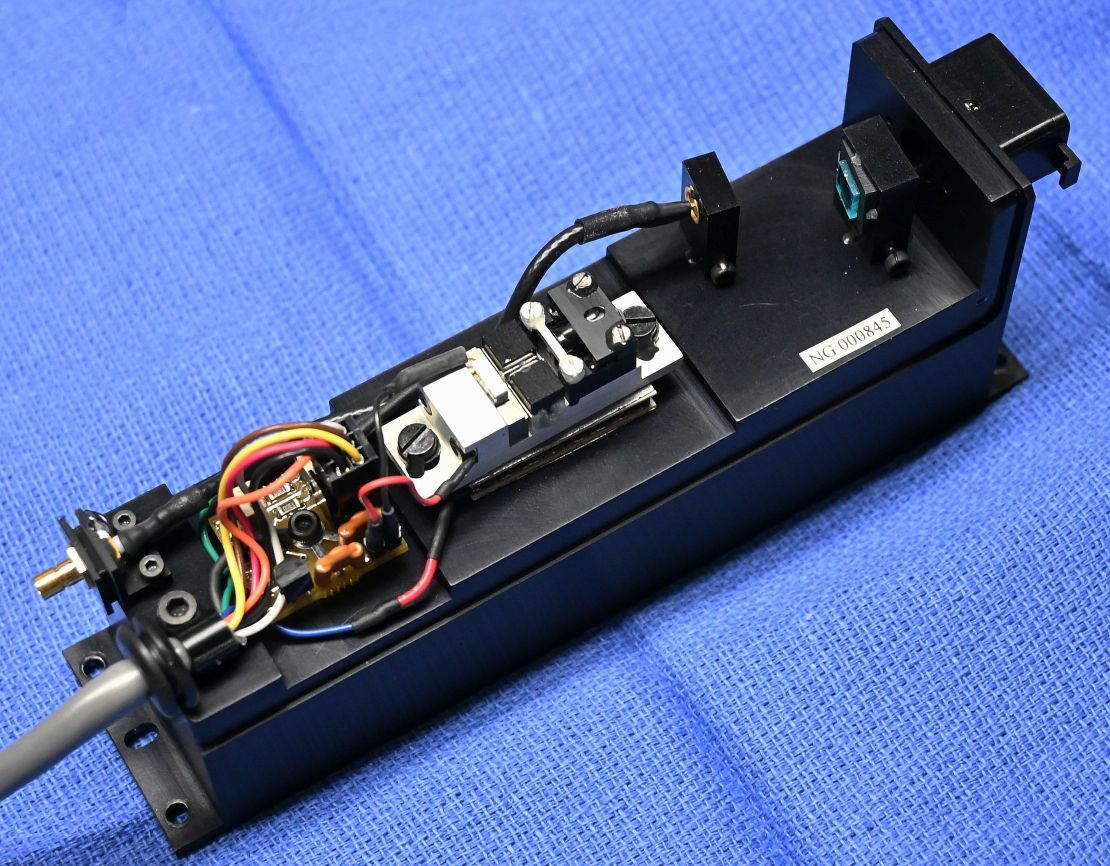

    A Small Nd:YAG Laser - SSY1
    Description and Specifications
    SSY1 is a small Nd:YAG laser head that was used in the rangefinder for the M-1 tank. It includes a flashlamp with external trigger, YAG rod, passive Q-switch, and mirrors, all in a package about 25x25x105 mm (not including mounting feet). See SSY1 Laser Head Assembly for a photo which includes a U.S. Quarter for size comparison. See Major Components of SSY1 Nd:YAG Laser Head for the individual parts. (This photo courtesy of Meredith Instruments. Another SSY1 laser head is shown in SSY1 Laser Head Assembly Zapping. (Photo courtesy of Chad Andersen.) The inset shows the SSY1 firing at a black plastic box without any focusing. The maximum flashlamp energy input from the matching pulse forming network, PFN1, is about 20 J.
    (Note that there is a unit showing up on eBay with labels showing "MILES US ARMY" and "LASER TRANSMITTER ASSY M16A1" that looks like it might contain an SSY1 head. However, this device is used for battle simulations or war games and only has a pulsed 904 nm laser diode.)
    The SSY1 laser head used to be available from Meredith along with a matched pulse forming network (see the section: Pulse Forming Network 1. (Meredith had also been auctioning these and other items on eBay.) SSY1s frequently show up on eBay from various sellers. The going price is in the $100 to $200 range for the laser head. New SSY1s and parts may also be available from Anderson Lasers, Inc. and elsewhere. I constructed a capacitor charger and external trigger circuit. See the section: Sam's AC Line Power Supply for SSY1 (SG-SP1). An alternative design which runs from low voltage DC is described in the section: Sam's Inverter Power Supply for SSY1 (SG-SI1).
    For initial testing, figuring it would be real effort to get it lasing, I used my trusty IR remote control tester for detecting the beam. Big mistake. :( The first shot sent the photodiode off to photodiode heaven (or wherever faithful photodiodes go when they die). Its output just stayed on! I should have used the IR detector card available from Radio Shack (and elsewhere (though that would probably have suffered as well). (For reference, the output is from the end with the red wire. The ends look identical.)
    OK, so go to plan B. :)
    I placed a piece of black coated paper in front of the laser and fired off a few shots. No effect except for a bright blotch of white light from the flashlamp. (Maybe I didn't examine it closely enough.)
    Next, I tried a small lens approximately focused on a piece of black coated paper. To make sure any effect wasn't just due to spill from the flashlamp, these were positioned about a foot from the laser head. Immediate gratification! The moderately focused output beam easily obliterated the black coating on the paper. This was accompanied by a very nice 'snapping' sound and white or yellow incandescent plume when hitting the black coating, and a more muted sound after the black stuff had vaporized. When carefully focused, it will make nice tiny holes in aluminum foil (the incandescent plume is green-blue in this case) and other thin materials, and mini-craters on thicker objects. I've heard of people driving this laser with much higher energies to blasting holes in razor blades (see below). However, it is all too easy to blow up the laser components when doing this - the flashlamp and Q-switch are most susceptible to damage or destruction.
    I don't have any way of actually measuring the energy of the beam but let's just say it is definitely not something to be taken casually, as far as eye safety is concerned! My wild off-the-top-of-the-head guestimate would be at least 10 mJ, probably 20 or 30 mJ, though it may be as high as 50 to 100 mJ. Hopefully, someone will eventually measure the output pulse energy! The Nd:YAG rod is probably capable of much greater energies but that flashlamp doesn't look all that sturdy so I'ms not about to push my luck, at least not yet. :)
    The lasing threshold is about 7.5 J - less than the energy of the electronic flash in a typical pocket camera! This low value is no doubt due to both the cavity and optics design - and the optimal pulse length from the PFN. Thus, using one of those cheap flash units (or just its power supply) directly probably wouldn't work at all as the duration of the flash pulse would be way too long with insufficient peak intensity. (The unit described in the section: Micro Laser Rangefinder Using Disposable Flash Pumped Nd:YAG and OPO is based on a much smaller Nd:YAG rod - about 1/8th the volume.)
    Here are the specifications, as best I can determine:
    Note: The dimensions are from my memory or lack thereof - I haven't measured them since getting SSY1 to lase, corrections welcome.
    WARNING: Despite its small size, this is a Class IV laser. While SSY1 probably won't set anything on fire unless you fire it at an explosive or have a natural gas leak, this laser is quite capable of doing serious damage to vision. Treat it with respect! Cover the HR mirror aperture (I used black electrical tape) since there may be some leakage from there which is invisible and enclose the output beam path so that backscatter can't hit anything of importance (like your eyes).
    Variations in Performance of SSY1s
    Depending on how much use or abuse any given SSY1 has had in a past life, there could indeed be significant differences in output energy for the same input energy. I don't know to what extent this may happen for samples that appear to be in perfect condition but it should be possible to identify obvious problem areas. Inspect the Q-switch dye cell, flashlamp, rod ends, and optics for dust, dirt, discoloration, mottling, and physical damage. If the dye cell appears anything but perfect, it probably should be removed as its condition will only deteriorate with use. Discoloration of the flashlamp will reduce the amount of light to the rod but unless it is very severe, won't prevent the unit from working but will just increase the lasing threshold slightly. Unlike a HeNe laser with its low gain, a spec of dust won't kill lasing but a careful cleaning probably won't hurt. For anything beyond light dusting, use proper laser mirror cleaning procedures to avoid damaging the optics.
    I've now tested 3 of these babies - 2 that appear to be in original condition and another with the Q-switch removed and the AR coating gone from one end of the rod. (I've also used the mirrors from an SSY1 to construct the resonator for another YAG cavity, see the section: Mini YAG Laser using SSY1 Optics and SG-SP1.) The two intact units produce about the same output energy. The other one lases but probably at slightly lower energy. It still smokes black tape (possibly better than the other ones) but won't penetrate aluminum foil. The sound it makes when focused on a target is also softer. However, I don't know to what extent these differences are due to the lack of a Q-switch versus the missing AR coating It's probably a combination of both but the reduced effect on thermally conductive aluminum foil and softer sound would be consistent with the longer, lower peak power pulse produced without a Q-switch. Perhaps at some point in the future, I will swap rods with an original SSY1 to separate out the effects of the missing Q-switch and AR coating.
    CAUTION: Although the capacitor in the PFN that comes with SSY1 is rated for around 35 uF at 900 VDC, running at this energy may destroy the Q-switch dye cell and possibly the AR coating on the YAG rod adjacent to it after not too many shots. Some samples may survive almost indefinitely but others could succumb in less than 100 shots. I would recommend limiting the voltage for repetitive use to 700 or at most 750 VDC.

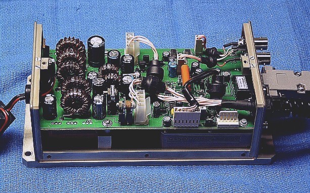

    The Analog Controller is basically a set of regulated switchmode power supplies based on the Linear Technology LTC1149 High Efficiency Synchronous Step-Down Switching Regulator. (The datasheet may be found on the Linear Technology Web Site.) There are about 20 power MOSFETs presumably driven by the 3 or 4 LTC1149s. Efficiency is quite high and heatsinking is minimal - just some close contact with the back plate using those white silicone pads. Nothing seems to run very hot so this is adequate. However, I did repair one controller with a blown MOSFET, possibly due to inadequate pad-case contact.
    While I expected to find some sort of microcontroller or PIC inside to do the control, search, and monitoring functions, there is none as far as I can see, only a pair of GAL16V8D PLDs (Programmable Logic Devices). One of these handles the basic interface and status functions while the other (by process of elimination) must implement the state machine for the control algorithm. It resides on a little circuit board along with a pair of non-volatile Xicor (now Intersil) X9C103 digital pots, presumably to save the power setting and something else, and some glue logic. There are also a number of Texas Instruments chips on this PCB and the main PCB. They are marked "272BC", "27M2BC", or "372C". and are in an 8 pin surface mount package. Their full part numbers are probably TLC272B (op-amp), TLC27M2B (opamp), and TLC372 (comparator), respectively.
    Except for the GAL programming, everything else is standard and replacements are readily available. I don't know if the GALs have had their security bit set but if not, the program could be read out. Even the GAL for the user interface is not a simple combinational circuit though. But the real problem in attempting any sort of repair on this unit would be the packaging. The 4 layer main PCB (3 signal layers and ground) is very densely packed with both through-hole and surface mount parts. The majority of the 20 or so power MOSFETs are soldered to the back of the PCB while some parts on the front are mounted on top of other parts. Large electrolytic capacitors, toroidal inductors, and a power relay cover up all of these and are fastened with RTV silicone. (See the photos via the link above.) Tracing the circuit would be very difficult to impossible but if the future of the Universe depended on it, might be accomplished within one's lifetime, perhaps. :)
    The one subsystem that can be analyzed is the interlock relay (not present on some older versions). It is, to put it mildly, bizarre. :) The relay is from NAIS (now part of Panasonic). A datasheet can be found at SF Polarized Monostable Safety Relay. The specific part is an SF4-DC5V having 8 poles with 4 SPST NO (form A) contacts and 4 SPST NC (form B) contacts. The key feature of this relay is that a failure of a set of contacts remaining welded closed will force certain other contacts to remain open, others to operate normally, and guarantee there can't be short circuits between contacts. Two sets of NO contacts in series are the actual circuit which the relay switches - presumably power to other parts of the controller. If one of these contacts were to be welded closed, operation shouldn't be affected since the other contact will continue to function normally. Power to the relay coil is enabled by a signal to a MOSFET and disabled if the voltage to the switched circuit goes above about 9 VDC. So far not too strange. However, power for the relay coil itself first passes through a series string of *4* sets of NC contacts all in parallel with a series string of *2* sets of NO contacts, and a large electrolytic capacitor across the relay coil maintains power to it during the switching period. In the world of logic, such a set of conditions forms a true, 1, or tautology. :) Only if a contact malfunctions, will this peculiar contact arrangement have any effect. Presumably, the intent in the design was to assure that a malfunction of the relay would be fail-safe and disable the laser. But figuring out exactly what the effect should be is no easy task especially since the datasheet appears to be a poor and incomplete translation from Japanese! Further analysis is left as an exercise for the student. :) And unfortunately, it seems that this relay is itself the likely cause of an intermittent controller.
    Interestingly, it may be possible to listen to the controller and sort of tell what it's doing. Really! Well, at least on some units. Since it is basically a collection of switchmode step-down converters, vibrations at the switching frequency for each converter (which changes based on its output current) may be audible depending on how its particular magnetic components are mounted. Someone pointed out the sound to me asking if it might be a problem. After confirming similar behavior in two different controllers, I replied: "It's a feature, not a bug". :) The sounds are similar to bird calls, though I am at a loss to suggest a particular species. They may be a sort of tweeting or twittering, rising and falling in pitch. Higher pitch means more current to a particular TEC (or possibly the laser diode though I have no confidence of ever having heard any sound directly related to the laser diode). During a part of the search phase, there may be a sawtooth (in pitch) whine with a period of a second or two. This is likely from the TEC driver for KTP temperature. The sound level isn't high - the room has to be perfectly quiet (all fans off) to have a reasonable chance of hearing it at all. And, not all units are equally loud (or soft) in each phase. Some may be totally silent. And, if the DC power source is a switchmode power supply, it may make more noise than the controller. In short, your mileage may vary. A stethoscope should help.

    This 4802 controller is much smaller and lighter than the HYB B. There are 2 stacked PCBs inside. The upper one has the 68HC711 uController chip (socketed PLCC) and user interface connector while the lower one has the drivers for the LD and TECs, and the laser head and RS232 connectors. On the bottom of the lower PCB are 12 power transistors which use the baseplate as a heatsink (via thermal pads). While overall operation is supervised by the uController, there is still a lot of analog circuitry. But there are only two pots and they are on the upper PCB. R168 is for calibration of the monitor photodiode in the laser head and affects both the power output with respect to digital value (in the SLP command, below) as well as the analog power control input. Clockwise decreases the output power (increases PD sensitivity). The function of the other pot, R160, is presently unknown since it doesn't appear to have any effect. But some versions (more or less random) have labeled holes in the cover to get to both pots. So, that second pot must be important for something!

    uGreen Laser Head Construction
    uGreen 4601 Laser Head Construction
    The following also applies to the 4611 and 4711 (and I assume other) lasers. The 4712 is almost identical but has added some sort of active circuit associated with the photodiode (circuit and function unknown). Depending on model and revision, the actual laser resonator with the vanadate, KTP, and OC mirror, may be removable as a unit from what is called the "Laser Cavity Module" below.
    The laser head consists of 3 very small modules mounted on an solid metal frame. Please refer to the photo in JDS Uniphase Model 4601 uGreen SLM Laser Head for parts identification.
    The output optics consist of a beam expander telescope (negative and positive lenses), adjustable to align the beam with the centerline of the laser head. Between the two lenses is an aperture to block the ghost beams that result from the laser cavity design.
    Electrical interconnections between the HD15 connector and the three modules is via a custom ribbon cable assembly which also includes a few discrete components.
    Details of the internal construction, cleaning, and alignment of the model 4600 laser head can be found in the sections starting with: The Model 4600 SLM uGreen Laser.

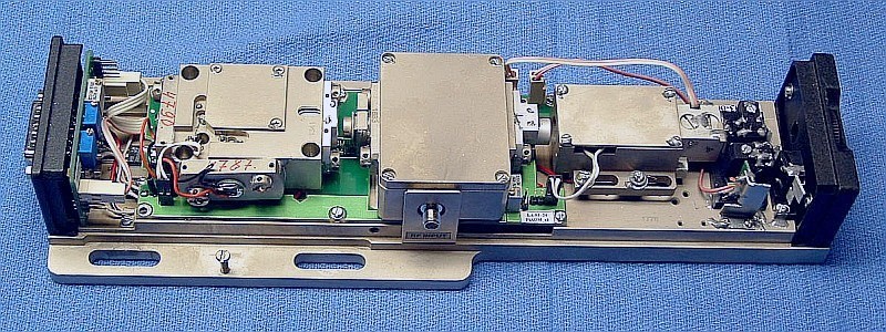

    uGreen 4301 Laser Head Construction
    This is a somewhat older version of the uGreen laser. But the likely later model 4501 is virtually identical. Instead of a short discrete cavity, it uses a Multi-Chip Assembly (MCA), a sandwich of a piece of vanadate and KTP with mirrors coated on the input and output surfaces. It to be optically contacted (edge glued). Thus, the actual laser is very simple consisting of the MCA glued to a copper heatsink plate.
    The laser head still consists of 3 very small modules mounted on an solid metal frame like the others, though the wiring is just done with wires. How quaint. :)
    Pleae refer to the photo in JDS Uniphase Model 4301 uGreen SLM Laser Head for parts identification. (The 4501 is essentially identical.)
    Note that although the same basic components are present in the 4601, 4611, 4711, and 4301 and 4501 laser heads, the connector pin assignments are totally different. Attempting to power the 4301 or 4501 on the HYB B with a 4601 cable will result in smoke (or at least a burning smell). There was apparently no damage but I never did find out what was burning!

    Tests of Several NG-10320-T04 Green (532 nm) Nanolasers
    These 6 units were acquired as a lot with no information on their condition. The NG-10320 is a green (532 nm) passively Q-switched DPSS laser with a specification of Pulse rate: 5-9 kHz, Pulse Duration: 3 µs. The meaning of the "T04" is unknown. There is nothing special inside as shown in: Inside view of JDS Uniphase NG-10320-T04 DPSS Laser Head. I believe the black aluminum block on the bottom is just that: A black aluminum heat sink with nothing inside.
    The pinout is compatible with the standard Nanolaser power supply and there is also a convenient SMB connector for the detected pulse via an internal photodiode. With a 50 ohm terminator, the pulse is fairly sharp and clean. Initially, I no longer had any of those power supplies but dug up my adapter cable to test them on the ILX LD3900 laser diode controller. Later tests and adjustments were meade using a PS-1401-150 power supply. Here are the data:
                                                             (1)
      ID  SN    Date   Th Res  I thresh  I op      F op     P avg       On PS-1401
       #1  845   7-00   5.284K  1.06 A  1.416 A  7.06 kHz  21.2 mW (2)  6.25 kHz
       #2  754   9-00   4.734K  1.09 A  1.320 A  7.00 kHz  21.0 mW (4)  6.5 kHz
       #3  932  12-00   4.949K  1.26    1.587    7.05 kHz  21.2 mW      I lim  (5)
       #4  544   7-00   6.842K  1.01 A  1.341 A  5.00 kHz  15.0 mW (3)  2.2 kHz (6)
       #5  892  10-00   4.536K  1.12 A  1.446 A  7.00 kHz  21.0 mW      6.5 kHz
       #6  704  10-00   5.096K  1.18 A  1.500 A  6.25 kHz  18.8 mW      6.5 kHz
    1. The average power in the table was estimated based on the spec'd pulse rate and pulse energy.
    2. Laser #1 power measured at 23-24 mW using a thermal power meter.
    3. Above around 5 kHz, pulse spacing and peak power became erratic for laser #4 It is possible that careful adjustment of temperature could improve this somewhat, but it is definitely not as stable as the others.
    4. Laser #2 runs at ~6 kHz on a Nanolaser controller. The measured average power after a 10 minute warmup was around 21 mW using a thermal pwoer meter.
    5. Threshold current above the 1.4 A maximum of the PS-1401.
    6. It's possible that the diode was replaced in this head as the adjustments do not behave normally and there is a piece of unshrunk heatshrink covering the diode tab lead.
    The ID #s are arbitrary. 7 kHz was the target F op, but only if I op was under 1.5-1.6 A. All of these meet the specification, though #4 is definitely less stable than the others.
    A fairly simple LD driver and TEC controller could be used with these, though the temperature resolution/stability does need to be quite good.

    Lightwave Electronics 110 IR Q-Switched DPSS Laser
    The LWE-110 is a diode pumped solid state laser with an active (RF) Q-switch. They have a compact laser head with a separate controller box. All the smarts are in the controller including the laser diode and TEC driver, and Q-switch driver. Newer versions (microprocessor-based controller and HD26 head connector) have a personality EEPROM in the laser head so it's not necessary to match a laser head to a specific controller. Older versions (round LIMO head connector) require a head personality module to be installed in the controller.
    There are versions of the LWE-110 laser head using Nd:YVO4 (1,064 or 1,342 nm), Nd:YAG (1,064 nm or 1,320 nm), and Nd:YLF (1,047 nm), and possibly others including 532 nm (frequency doubled). The maximum output power ranges from 50 mW to over 500 mW depending on model.
    The LWE-110 can be run from the front panel or RS232 (on the newer controller). On the first LWE-110 I tested (newer version), there was no response from the RS232 port, though wiring was confirmed to be correct - both pins 2 and 3 were active. But it came from an ESI laser trimming system and may have been modified. The terminal compatibility and protocol should be similar to that of the LWE-142, LWE-221, and other Lightwave lasers.
    On the newer controller, the front panel controls may be used to select CW, Free Run (Q-switched), Triggered (Q-switched), and a couple more obscure modes. There are also one or two other parameters that have subtle effects on behavior, but NOT pump power or current, or temperature. The laser always runs at maximum power unless a voltage is applied to the "Suppress Output" BNC. Then, it's possible to reduce the CW output power (but not increase it). The older controller has similar functions via knobs, as well as one for "Output Power", which is active in all modes and may just control the pump diode current.
    The Q-switch free run frequency can range from 1 Hz to 50 kHz or 100 kHz depending on specific model. And the typical average output power when running Q-switched tops out at 80 or 90 percent of the CW power.
    WARNING: There may be no delay from exiting Standby Mode to laser output. All these wavelengths are totally invisible and thus extra dangerous at the power levels available.
    As noted, the older version has no microprocessor with real knobs for major functions. The newer one is microprocessor controlled with a single line display and thumb-wheel. Photos of a LWE-110 with the analog controller can be found in the Laser Equipment Gallery (Version 5.10 or higher) under "Lightwave Electronics DPSS Lasers". It is believed that the laser head and specifications for both versions are generally similar.
    As can be seen in the photos of the laser head, the 1,047 nm LWE-110 uses a single SDL-style laser diode with several beam shaping lenses to pump a short linear cavity consisting of a trapezoidal Nd:YLF crystal with the HR mirror on its input face, AOM Q-switch, and similar trapezoidal optic with the OC mirror on its output face. It is believed that the trapezoidal shape was used so the facing surfaces could be cut at the Brewster angle with the Q-switch between them.
    LWE-110 Laser Head Pinout
    Here is the pinout for the version of the LWE-110 laser head using the HD26 connector:
              Internal   Laser Diode (1)
     HD26     Connector   Pin  Function   Function
       1         10        2   ??         Appears to be NC, gap in LD pins
       2          9        3   LD Case    Ground and Case TH
       3          8        4   LDA (+)    LD Anode
       4          7        5   LD TH      LD 10K Thermistor
       5          6        6   LD TH      LD 10K Thermistor
       6          5        7   LDC (-)    LD Cathode
       7          3        8   MPDA (+)   Monitor PD Anode (2)
       8          4        9   MPDC (-)   Monitor PD Cathode (2)

    Here are some photos of a dual-wavelength LWE-142:
    There are 5 trim-pots inside the LWE-142 laser head. The functions of four of these are known. See Internal Adjustments of LWE-142 Laser Head.
    It's not clear how these are modified by parameters stored in a serial EEPROM on the microprocessor PCB. Swappig this board seems to change the readout of some of these values, if not the actual values themselves.
    Inside the LWE-142 optics box
    The sealed optics box has the pump diode, NPRO for the fundamental (1,064 nm), the resonant doubler, and a bunch of mirrors/lenses to move the 1,064 nm and 532 nm beams around inside the box and correct for divergence, diameter, and asymmetry. In older versions of the LWE-142, most components are mounted on a ceramic substrate on little gold-plated islands using low temperature solder. (At least, I assume it's ceramic or something similar to have the required rigidity.) Some of the larger modules may be mounted with glue as there is no solder visible around their edges.
    Here are photos of the interior of the optics box. The first one is how it appears when the lid is removed. The second shows the NPRO once the magnet assembly is removed. This unit is actually a type 142-532-045DW laser manufactured in 1997. The DW indicates that both the 532 nm and 1064 nm beams are brought out of the box for experiments that are designed to use both f and 2f in measurements. The "-45" probably means that it was rated at 45 mW of 532 nm and around 20 mW of 1,064 nm. Being dual-wavelength, the complexity of the optics is somewhat higher than for the much more common single wavelength version.
    The initial beam path is from the pump diode through the GRIN lens to the NPRO input face. The fundamental 1,064 nm beam exits at approximately 90 degrees from the pump beam (up) and goes to the three optics at the upper left of the photo, which split off a small portion for the 1,064 nm photodiode ("Crystal Photo Mon"). One of the optics is a filter to block 808 nm pump light from the photodiode. The remainder is redirected to the right passing through the QWP and HWP polarization correction, and split again for the doubler and 1,064 nm output. The one optic that looks like a laser mirror with the purplish tinge is probably used to focus the 1,064 beam into the doubler. The green output from the doubler exits at approximately 90 degrees from the 1,064 nm input (going to the right). A small amount is split off for the "Green Pwr" photodiode. The functions of some of the other optics are still unclear, though most are probably baffles or beam stops.
    While the internal alignment of the monolithic NPRO and doubler cavities won't change, the relationship of the output of the NPRO to the input of the doubler is a rather long path - something like 8 inches! So, it would seem that even the slightest thermal change in the ceramic substrate could affect that alignment resulting in a change in coupling efficiency and output power. This may indeed be what I and others have seen with as these lasers warm up, even with what should be very adequate cooling. That long path was probably intentional to match the 1,064 nm beam to the doubler mode. The beam profile, angular alignment, and entrance position all must be quite precisely set. But shortening the optical distance between the NPRO and doubler could probably have been achieved with appropriate optics, thus reducing the laser's sensitivity to age, environment, and nearly everything else.
    The dual wavelength option adds some complexity to the beam handling optics but possibly not all that much. But it is quite rare and was discontinued due to lack of sales. Perhaps only 1 out of hundreds of these lasers will have it. But even with the extra output, there still seem to be way too many of those little random optics pieces!

    Organization of the LWE-142 Controller
    All of the control functions for the Model 142 (and other Lightwave NPRO lasers) are contained in the laser head with the only required input being DC power. While no detailed documentation is available for what's inside the laser head, the organization of the control electronics - or at least one possible organization - can be deduced from the laser's requirements and behavior. See Possible LWE-142 Green (532 nm) DPSS Laser Controller Organization. This would apply to both single and dual wavelength LWE-142s. Of course, there may be differences in the actual partitioning. For example, the various digital components may be inside a smaller number of standard ICs or a PLA. Or, both TEC drivers may simply be power amplifiers with the firmware doing most of the work. I have included a photodiode for the "Diode Photo Mon" as it's listed on the main "S" screen. However, the circuit appears to be missing on my laser and others I know of since the reading is usually 0.00 or might twitch from time-to-time.
    The controllers for IR-only Lightwave NPRO lasers like the Model 125/126 would be even simpler since there is no frequency doubler. So, the Doubler Temperature and Green Pwr circuits would be unnecessary. However, the Slow Tuning input would then need to go either into the Muxed A/D so the firmware can deal with it, or directly to the NPRO TEC Driver to be added in as a temperature offset.
