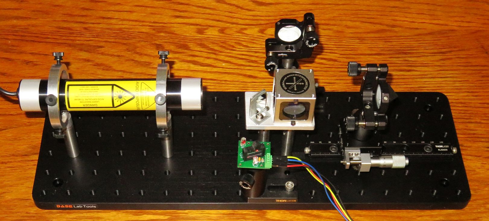

The photo below shows the Basic version configured for the LI. There are minor variations in the actual kits depending on version and whether they are the "Basic", "Deluxe", or "Deluxe+" versions, though this layout will work for all of them. Differences will be noted below. Where the total path length and PLD is small, no beam expander is needed for the laser as in the Basic version. This may result in a larger signal since the entire beam hits the detector. But the smaller beam makes it more sensitive to alignment.
Typical Linear Interferometer Setup with Quadrature Decoder and µMD0
While interferometers are employed in a wide array of applications, the general emphasis for these experiments relate to the use of interferometery in metrology - precision measuremens of physical characteristics like displacement, velocity, angle, straightness, and more. Therefore unlike numerous interferometer experiments that may be found via a Web search, the emphasis here is on the signals that the setup provides, not so much on the interference patterns. (Though nothing precludes the observation of these.
The experimental setups will enable various interferometer configuration to be easily implemented and then tested with one arm being on a micrometer linear stage and/or with some other device or material that can vary the path length precisely.
The light source is a Class II 633 nm Helium-Neon laser (HeNe for short) with an output power of between 0.4 and just over 1 mW. The basic detector is a biased photodiode connected to a dual channel digital oscilloscope. Variations and enhancements to these will be offered as options.

The photo shows a laser without a beam expander but the laser in the kit will either come with a beam expander already attached to convert the ~0.5 mm beam from the laser tube into a ~4 mm beam with low divergence, or the expander which can be attached and centered with 3 screws.
The raw beam is a bit trickier to align and to maintain alignment as the stage in Arm 2 is moved, but it is quite adequate for a small range of PLD. But where the PLD is large (e.g., for use as an earthquake sensor), the beam expander eases the alignment and is required so that the divergence of the beam doesn't affect the detector response (e.g., the fringe contrast). Since the beam expander is secured by 3 screws (see below) it can be removed to explore how the raw beam behaves. However, two cautions: (1) Do NOT remove the plastic bezel of the laser head as that will expose the high voltage connected to the laser tube and (2) careful lateral adjustment of the beam expander will be required when reattached to center the beam.
If using the beam expander, the posts/rings for the laser should probably be mounted one hole to the left of where they are in the photo to provide more clearance.
Once cured (give it 15 minutes to be safe), it attached to the front of the laesr head using three M2.5 capscrews, which may already be installed. If not, they will be in one of the hardware bags or with the beam expander or adapter ring. The holes in the adapter ring are large enough so that there is (hopefully) enough adjustment range to center the beam, which must be done "live" - with the laser powered. Thread the M2.5 screws in just snug and adjust the centering until the beam is nice and round - this can also be confirmed by looked at the scatter off the front lens of the beam expander and centering there. Then tighten the screws just enough so it won't move around but it is metal in plastic so overtightening may strip the threads.
As a point of interest (or trivia), these parts cost something like $4,000 if purchased new. Fortunately for us, eBay is much less expensive. :-)
This assembly attaches to an aluminum "PBS Mount Adapter Plate" which itself secured to the breadboard with optical posts and spacers.

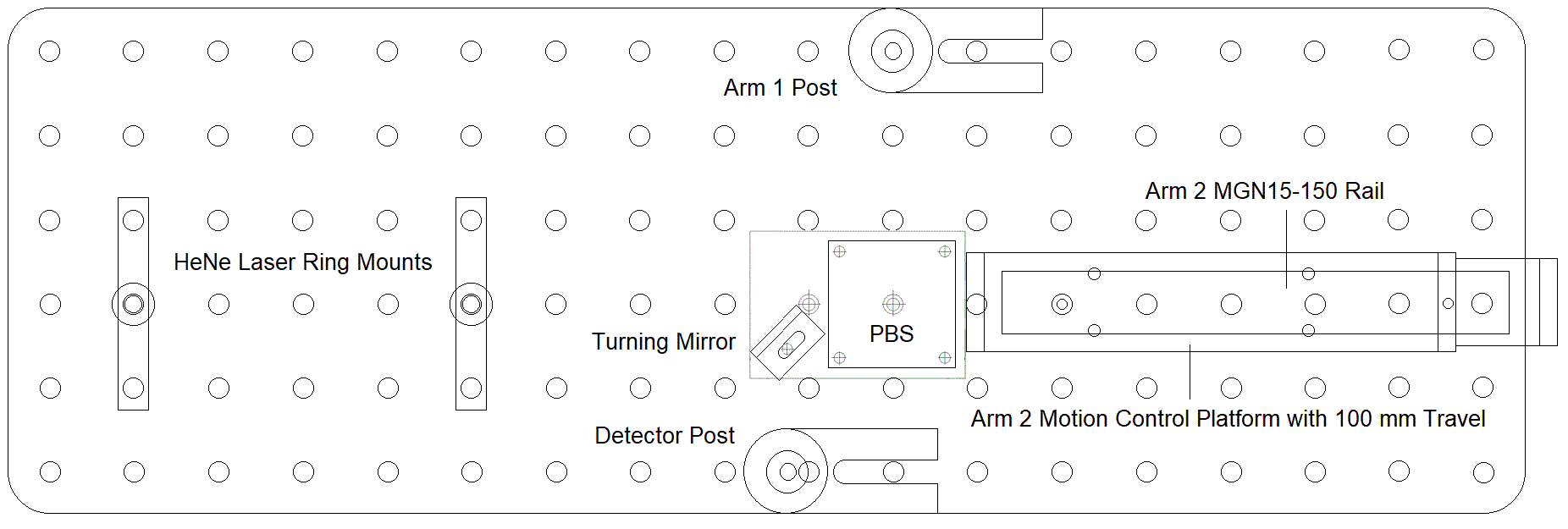

Here is an annotated photo of the Deluxe version configured for the HSPMI:
The Deluxe+ version would be similar except for the larger breadboard and longer rail; The Basic version does not include the beam expander, mounted CC, QWPs, or planar mirrors.
It is assumed that nothing has been mounted, but depending on the previous use, some of these steps have already been completed. Refer to the layout diagrams, above, parts locations that are known to work.
Parts attached with fasteners should be snug but don't overtighten.
It is also assumed that the laser is linearly polarized. Slight changes are required if it is random polarized.
If the laser head has a beam expander, or it is anticipated that one will be added later, it is recommended that the posts be mounts 1 hole to the left of where the are in the photo.
Note: To assure that there are ample threads engaged in both parts here and in subsequent steps with set-screws, the set-screw should be installed approximately half-way into the baseplate or mounting plate and then a thin tool or even the edge of a metal plate or stiff cardboard can be used to keep the set-screw from turning as the post or post holder is threaded onto it before tightening.
Doing this accurately is critical to the ease with which the subsequent alignnment can be performed since not all mounts have sufficient degrees of freedom to accomodate an arbitrary beam location and direction. Fabricating an "alignment aid" out of carboard may be useful. This would have a hole at the optimal height offest 1/4" toward one side from a mark at the bottom.
And for those new to interferometers, to reiterate, the optimal alignment will also be where the signal instability is maximized. ;-) Almost ANYTHING will affect it from touching the apparatus or table on which it is on, to just walking across the floor. The wavelength of light is really really small. ;-) To put this in some perspective, a full cycle of the signal with the Linear Interfemeter is a change in PLD of 316.4 µm (1/2 wavelength of 632.8 nm or 1/3,160th of a mm). That's about 1/158th the diameter of an average human hair (~50 µm) or 1/22th the diameter of a human red blood cell (7 µm). Street traffic will be detectable, as will drafts from the A/C, changes in temperature, and siesmic events. Some of these effects can be further explored using parts in these kits.

Photos of each of the three versions with typical interferometers are
shown below. The first is the Basic version with the 6x18" the breadboard,
configured with Linear Interferometer and quad decoder PCB attached to the
SG-µMD0 PCB:
The next one is the Deluxe version configured for the High Stability Plane Mirror Interferometer. The laser includes a beam expander but it is otherwise configured the same way.
The next is the Deluxe+ "Stretch" version on the 8x24" breadboard.
Replicating it should be straightforward
The 8x18" optical breadboard for V1.0 and V1.5 is custom with the dimensions selected to be convenient for the projects while being able to easily ship Worldwide. The 6x18" and 8x24" breadboards for V2.0 and V2.1 are standard. If machining one, fewer than half the standard holes are enough based on all reasonable mounting locations, but that's only worth it if you're paying by the hole. ;-)
Most other standard opto-mechanical parts are from Thorlabs. The major exceptions are the HP/Agilent PBS cube, QWPs, and mounted CCs (via eBay). But low cost substitutes for those are in the works.
