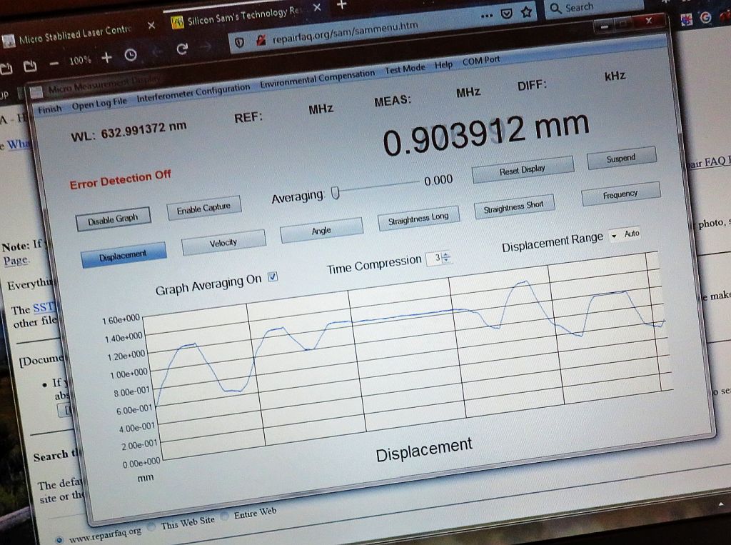

An experimental setup is presented which allows for several types of
interferometers to be easily implemented without requiring any special
tools or test equipment. The behavior of various interferometer
configurations will be explored as well as how the characteristics of
the laser impact performance. Various enhancements are also described for
both the laser and detector, as well as extensions to actual
measurements like displacement (change in position) down to nm precision.
The set of parts may be easily duplicated and/or modified for specific
interests.

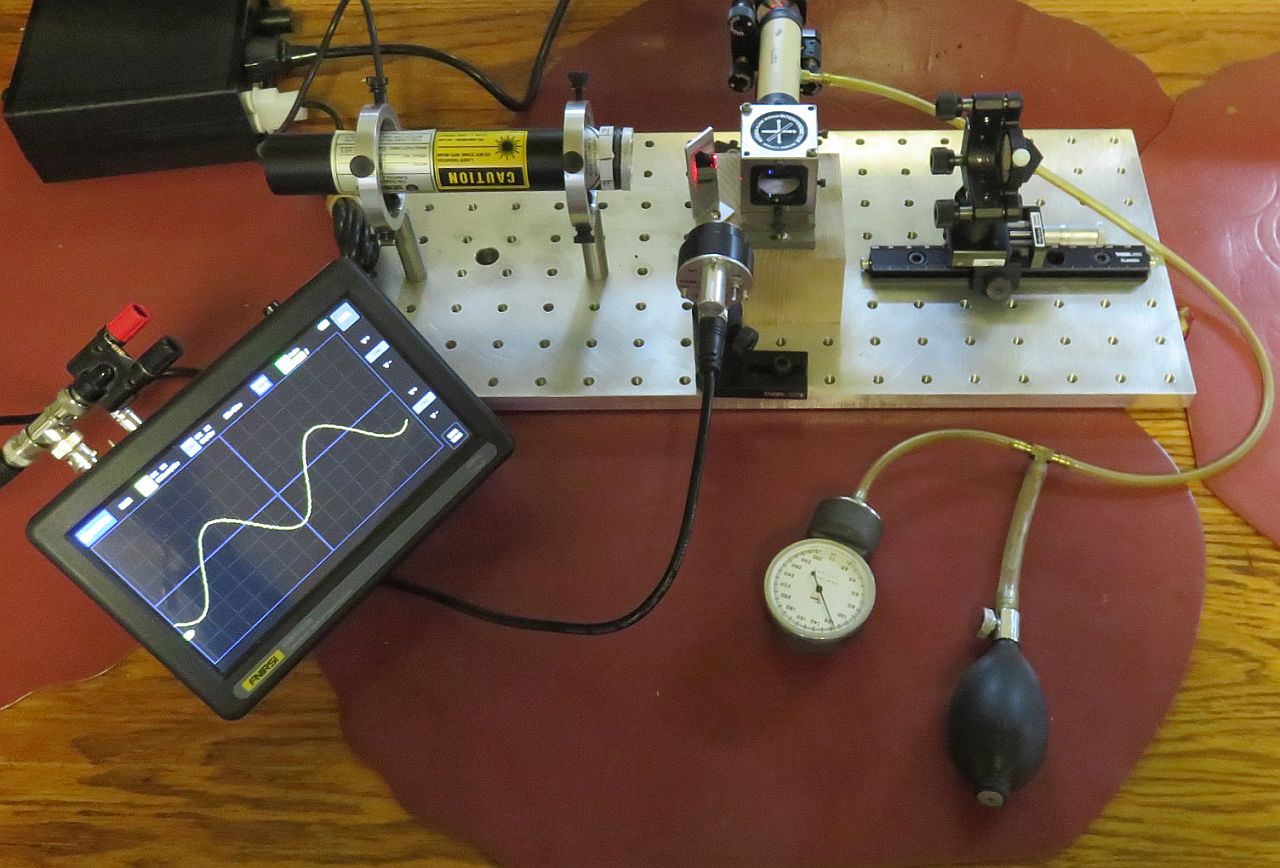

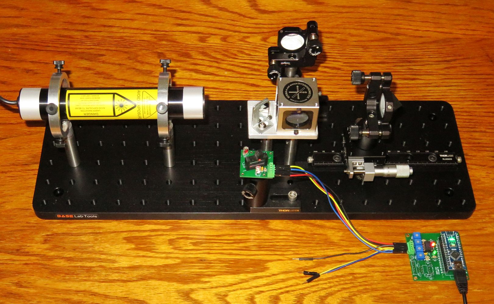

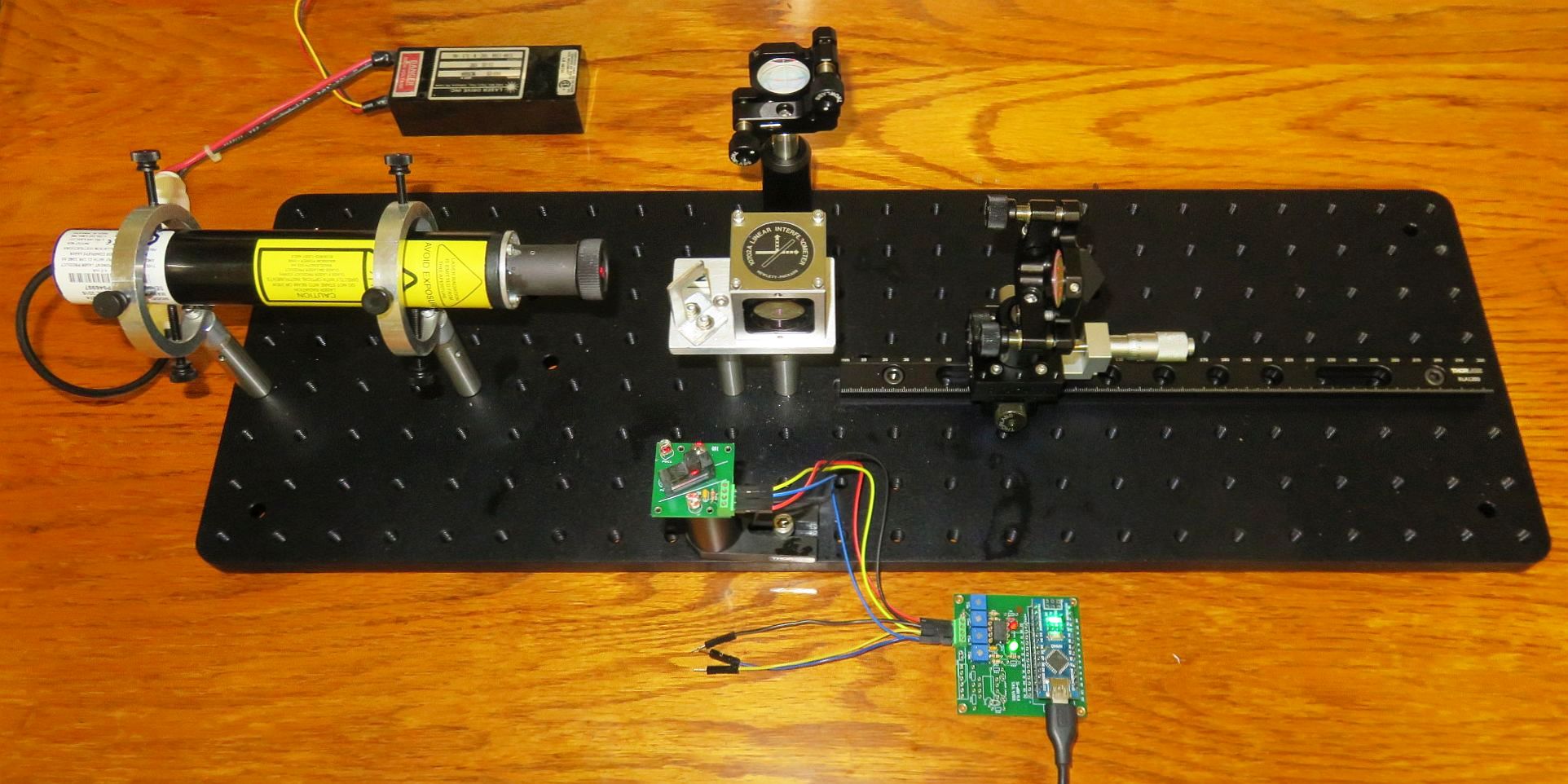

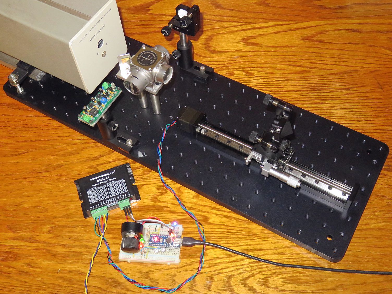

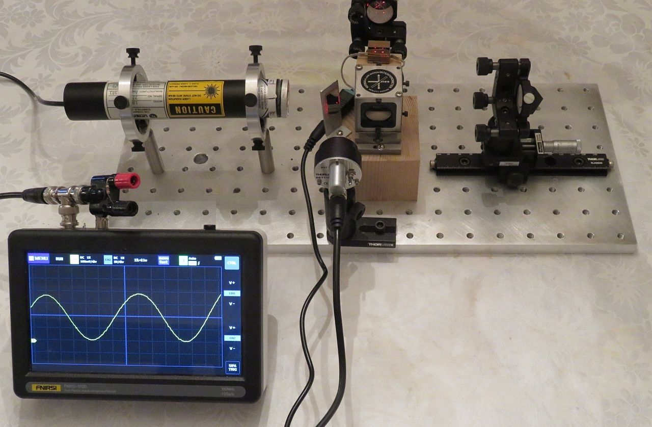

The photo below shows the Basic version configured for the LI. There are minor variations in the actual kits depending on version and whether they are the "Basic", "Deluxe", or "Deluxe+" versions, though this layout will work for all of them. Differences will be noted below. Where the total path length and PLD is small, no beam expander is needed for the laser as in the Basic version. This may result in a larger signal since the entire beam hits the detector. But the smaller beam makes it more sensitive to alignment.
Typical Linear Interferometer Setup with Quadrature Decoder and µMD0
While interferometers are employed in a wide array of applications, the general emphasis for these experiments relate to the use of interferometery in metrology - precision measuremens of physical characteristics like displacement, velocity, angle, straightness, and more. Therefore unlike numerous interferometer experiments that may be found via a Web search, the emphasis here is on the signals that the setup provides, not so much on the interference patterns. (Though nothing precludes the observation of these.
The experimental setups will enable various interferometer configuration to be easily implemented and then tested with one arm being on a micrometer linear stage and/or with some other device or material that can vary the path length precisely.
The light source is a Class II 633 nm Helium-Neon laser (HeNe for short) with an output power of between 0.4 and just over 1 mW. The basic detector is a biased photodiode connected to a dual channel digital oscilloscope. Variations and enhancements to these will be offered as options.

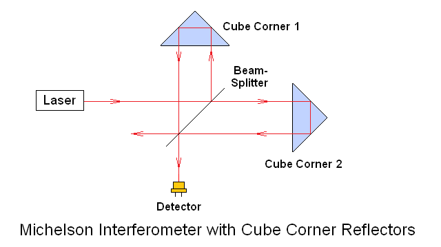

In short, a light beam is split into two parts which are bounced off of a pair of reflectors and recombined at a detector. Any change in the relative path lengths of the two "arms" formed by the reflectors results in a phase shift between the waves in the two beams resulting in constructive or destructive interference, which can be measured and converted to displacement (change in position) down to nanometer precision. All other types of measurements made by these systems are based on opto-mechanical configurations designed such that changes in the measured variable are detectable by what is in essense a Michelson interferometer.
Where the Path Length Difference (PLD) between the two arms is small, the requirements for the laser are not very stringent. In fact, for very small PLDs, an LED or even a totally incoherent source like an incandescent lamp may be substituted for the laser. However, to be useful for the PLDs necessary for most applications (millimeters to 10s of meters or more), the light source must be a laser. And not just any laser, but one that has a narrow "linewidth". While the popular concept of a laser is of a light source that is monochromatic (single color or wavelength), in reality most lasers do not even come close. It takes careful design and implementation to achieve that. For these metrology applications using the so-called "homodyne" interferometer, the laser should ideally produce an output that is a single optical frequency with a linewidth approaching zero. In practice, it isn't that narrow but can still result in a linewidth of much less than 1 MHz, resulting in a usable PLD of 100s of meters. This is usually a low power stabilized HeNe laser. However, for PLDs of a few inches, a common (much less expensive) unstabilized HeNe laser will be adequate. Within this range, all the modes will be sufficiently correlated and the fringe contrast/signal amplitude will be acceptable.

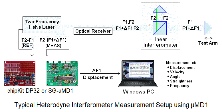

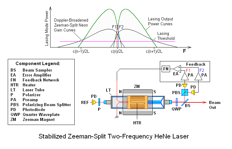

For the heterodyne interferometer, instead of a single optical frequency, there are two spaced by up to 20 MHz. The usable PLD is determined by this "split" frequency and is thus still very large. The split frequency only limits the maximum slew rate of the remote reflector. More on this later.

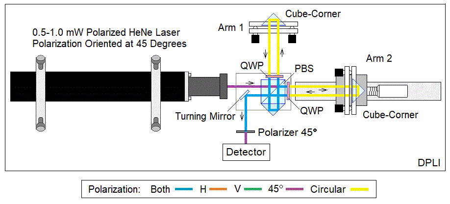

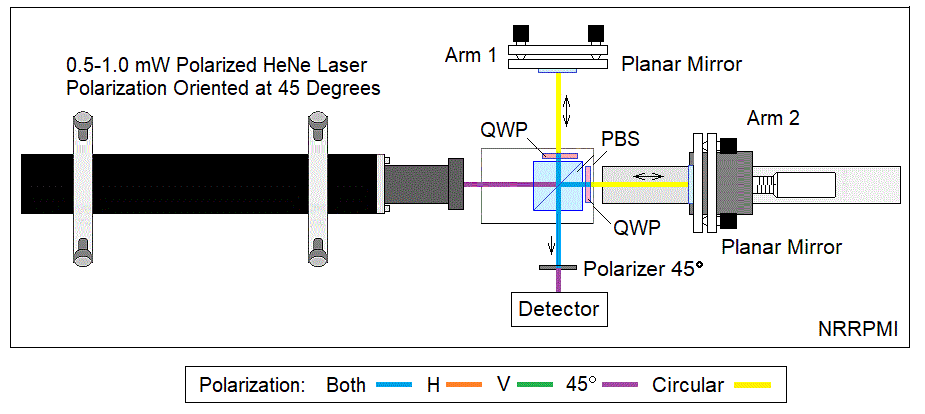

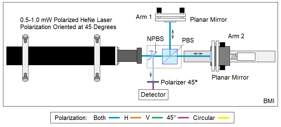

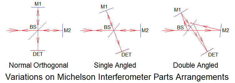

The diagrams below show some variations on the angles of the Beam-Splitter (BS) and Mirrors (M1, M2).
The first one is essentially the same as the diagram, above. The "Single Angled" one does nothing to prevent back-reflections. And while the "Double Angled" version does eliminate back-reflections, the two beams are angled at the detector which means their relative phase will vary across the detector. That is undesirable for our experiments in at least two ways: First, it will mean that the detector won't see a clean fringe signal. In fact there may be little or no signal depending on how the fringes average across its face. Second, alignment will change as either mirror is moved making testing with respect to PLD very tricky. But can you suggest an application where it may be useful?

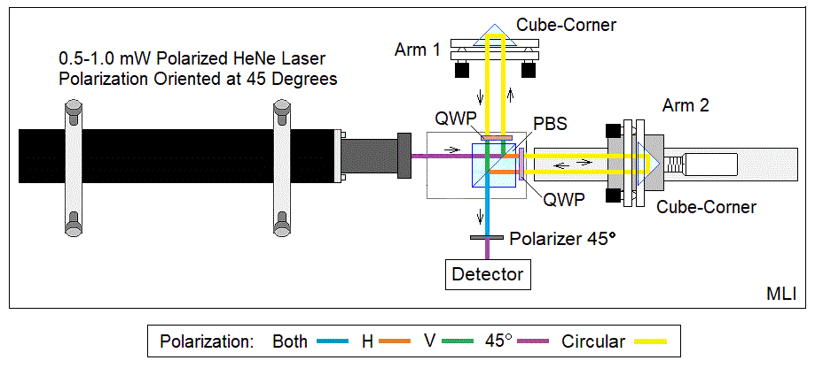

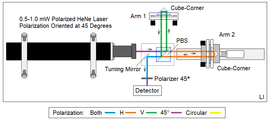

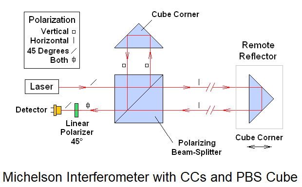

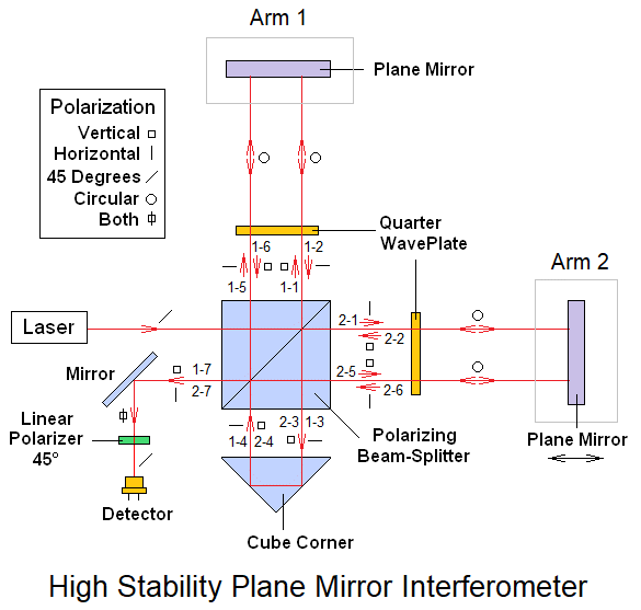

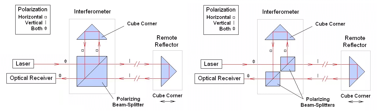

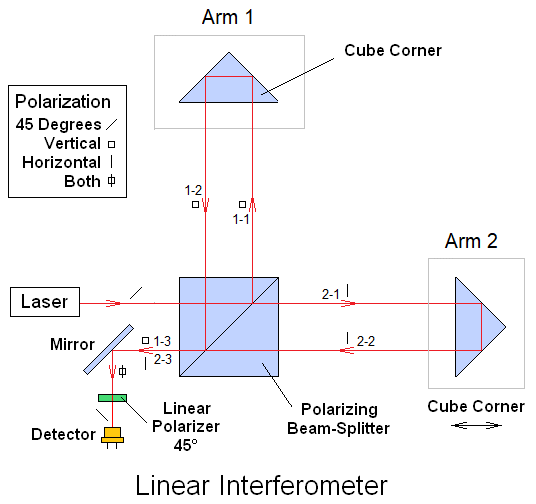

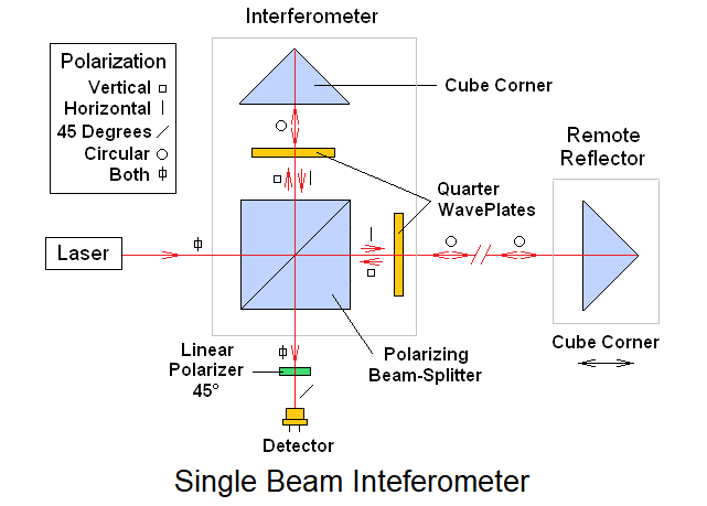

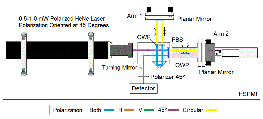

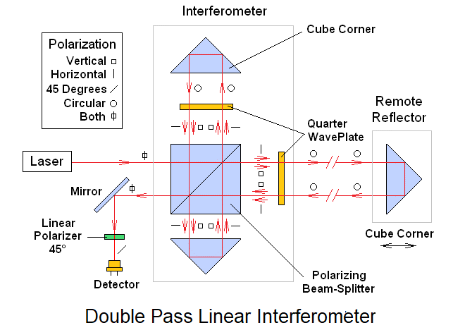

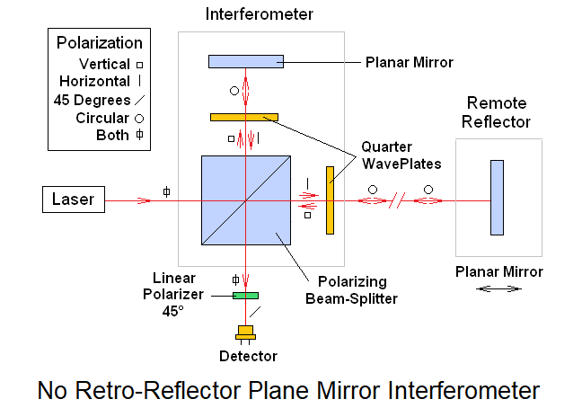

The first enhancement of the Michelson interferometer is to add a means of separating the outgoing and return beams so that there is vitrually no optical power returned to the laser. The simplest way to do this is to replace the mirrors with Retro-Reflectors (RRs), typically cube-corner (trihedral) prisms, which have the property of returning the beam directly back parallel with the outgoing beam, but which may have an offset. In this way, virtually none of the reflected light ends up back at the laser. The use of the RRs also greatly reduces the sensitivity to alignment as any change in their angle is converted to a small change in the distance between the outgoing and return beams, but they remain parallel.

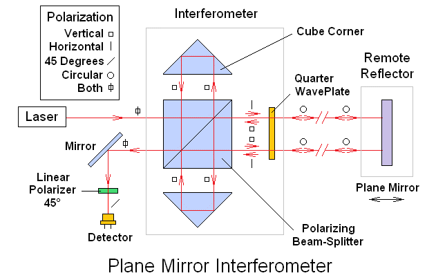

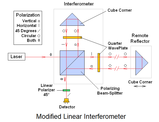

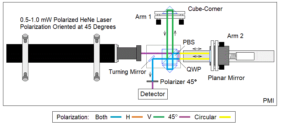

All of the practical interferometer configurations include at least one cube corner retro-reflector.
The beams reflected to the two arms of the interferometer then have orthogonal polarization which effectively makes them independent until they are combined at the detectors.

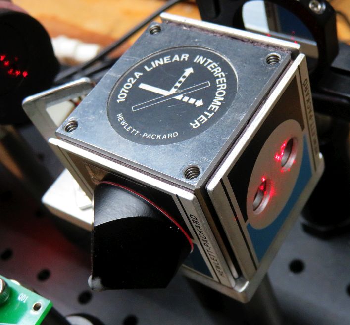

The result is then one of the most widely used configurations - the Linear Interferometer (LI), which was the first one used by HP in their original 5500A laser interferometer displacement measuring system. (As an aside, I do NOT know where that name "Linear Interferometer" comes from except perhaps that the inital configuration was in-line with the laser and thus "linear".) In practice, Arm 1 is used as the reference and is made as short as possible with the Cube Corner (CC) attached directly to the PBS cube. Both arms can move where differential measurements are required.
With the use of the PBS, the maximum amount of the laser optical power is available - virtually nothing exits out the unused side of the beam-splitter as it would in the original Michelson setup, above. However, at least half the power is lost in the detection scheme that is typically used so it would end up being similar. In principle, this wasted power can be diverted to a second detector. Their difference will then have twice the amplitude and the signal-to-noise ratio will nearly double (but with opposite phase). This is rarely, if ever, done though. But for the more complex multi-pass interferometer configurations described later as well as for use with two frequency lasers, the use of the PBS is essential to avoid incurring very large losses, or for the schemes to work at all.
As noted for the heterodyne interferometer - probably the most popular type used for high performance metrology applications and the topic of this kit - the laser actually produces a pair of optical frequencies that are othogonally polarized. They are typically separated by 100s of kHz to 10s of MHz called the "split" or "REF" or reference frequency. Most commonly the split frequency is in the small number of MHz range. For the HP/Agilent 5517 laser in this kit, it has been adjusted to be between 1.5 and 2.0 MHz. F1 is the lower optical frequency and is the horizontally polarized component; F2 is the higher optical frequency and is the vertically polarized component. As long as the difference frequency between F1 and F2 is reasonably stable, the specific value only impacts the maximum slew rate possible for the moving mirror or cube corner. It has no effect on the resolution. Think of the split frequency as a carrier that can be conveniently manipulated by AC electronic circuits. So just as with radio, the carrier does not carry information but makes it convenient to process that information. There are also several other advantages including reduced affects of signal amplitude and less sensitivity to interferometer alignment. Everything with respect to the interferometer optics and configurations is similar except that instead of the phase change between the two (essentially base-band) polarized components derived from the laser, it is the phase change between the REF signal (F2-F1) and a "MEAS" signal (F2-F1+ΔF1) with ΔF1 being a result of the Doppler shift from the moving reflector.
The maximum PLD is virtually unlimited for the two frequency laser with usable PLDs of 10s or even 100s of meters or more - impacted more by issues of beam divergence and collimation than the stability of the laser itself. However, since it is the PLD that is being measured, you can't purge it from your brain, sorry. ;-)
When used in a displacement measuring system with a 633 nm HeNe laser, 1X represents a full cycle resolution of 1/2 wavelength or ~316 nm; 2X of ~158 nm, and 4X of ~79 nm. For a homodyne system with a Quad-A-B deterctor, there are 4 counts per cycle so that gets multiplied by up to 4. For a heterodyne system using µMD2, there are 2 counts per cycle so that gets multiplied by up to 2. The very commonly used PMI or HSPMI will then have a heterodyne resolution of ~79 nm and interpolation techniques can extend it down to under 1 nm. However, if the signals are noisy or asymmetric, the benefits may not be achievable.

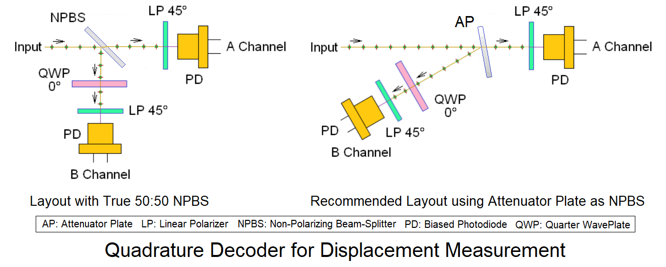

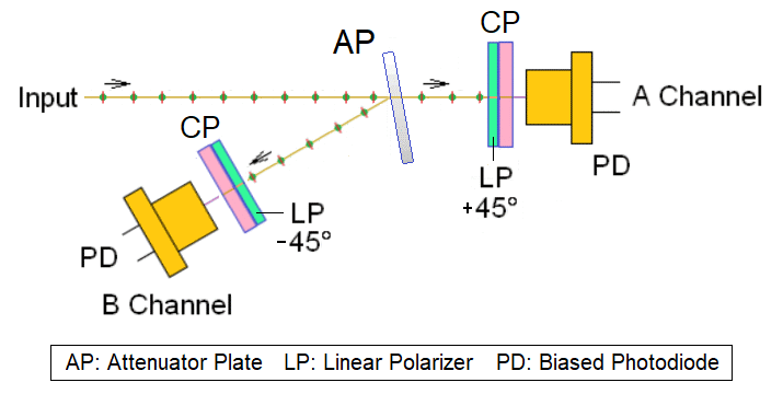

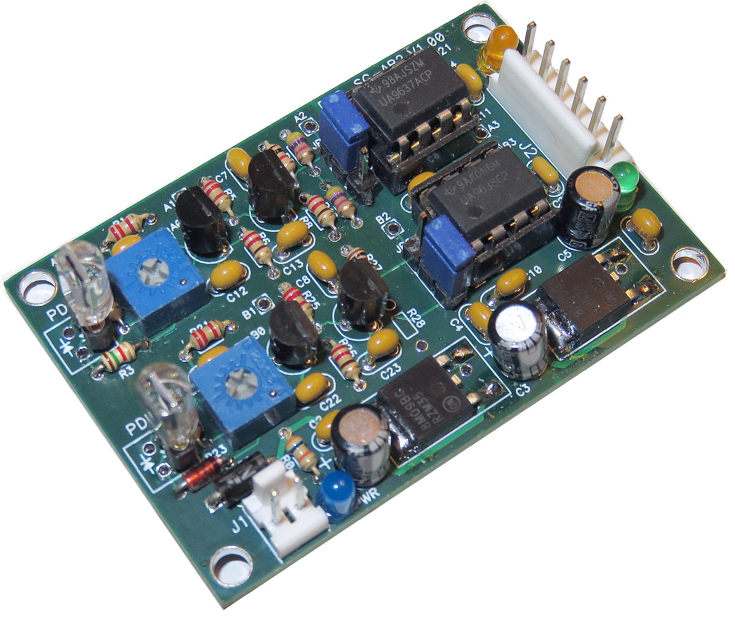

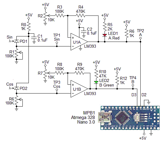

The purpose of the Quad-A-B Preamp (henceforth referred to as QAB2 or simply AB2) is to provide a simple solution that accepts photodiode inputs and generates differential RS422 A and B signals that can be input to µMD0, µMD1, µMD2, or another compatible displacement measuring system.
QAB2 is on a 1.6 inch by 2.25 inch PCB and runs on 12 to 15 VDC. (The PCB itself is called SG-AB2.) The optical input is a beam up to ~3 mm in diameter (using the default photodiode) with an optical power from <25 µW to >1 mW. QAB2 has >3 MHz bandwidth (full cycle) which is more than adequate for systems using the kit lasers as well as for many real applications. With a Linear Interferometer which has a full cycle of ~316 nm, the slew rate can be greater than 1 meter per second, which is a fairly nutty velocity. ;-). And it is expected that the bandwidth limit can be extended with trivial changes to only a few part values. This is left as an exercise for the student. ;-)
Although shown with photodiodes plugged into the PCB, in actual use, they would probably be on the detector PCB with short twisted wire cables to connect them to the SG-AB2 PCB.
Parts to construct AB2 will eventually be included as part of the homodyne setups. More information on AB2 including complete "Heathkit™-style" assembly instructions may be found at Quad-A-B Preamp 2 (QAB2) Assembly and Operation Manual.
The other configurations will have a few additional or substitute parts and small variations in the horizonatal position of the laser and placement of the detector but are otherwise similar. Therefore the LI setup will be described in more detail.

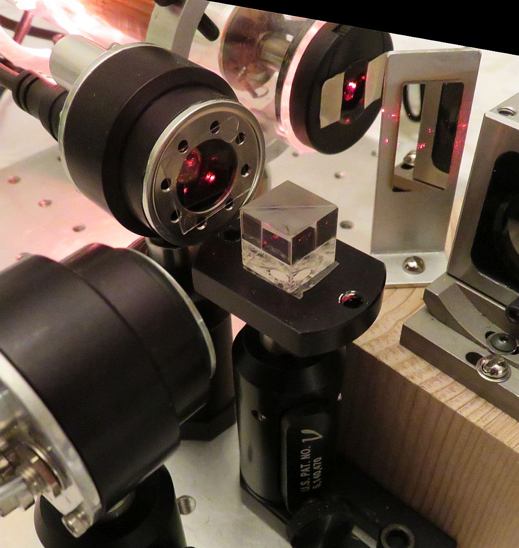

This assembly attaches to an aluminum "PBS Mount Adapter Plate" which itself secured to the breadboard with optical posts and spacers.
For some of the other interferometer configurations, these will be replaced either with 1" planar mirrors installed in the KM100s, or with a thinner mirror glued to a loudspeaker or PZT. (More on these later.)

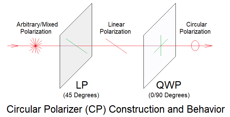

The CP type can be used for most purposes in place of an LP. Specifically here for placing in front of the detector and/or photodiodes. And if using a random polarized HeNe laser, the CP can be used to force it to be linearly polarized with the circular polarized output sent to the PBSC, which works fine. That's why some kits may not have an LP at all. But where an LP is present, it will probably be larger since the LP is used for most experiments. Only a very small piece of CP is required for the Quadrature Detector. For everything else, the LP is simpler to deal with since which side is the input doesn't matter.
Do NOT remove the protective film until ready to use. Also note that the CP sheet has a weak adhesive on the QWP surface and it will attract dust and debris (including grubby fingerprints!) Cleaning can be done with isopropyl alcohol but the adhesive will still be there when it evaporates.
Only small pieces of these are required for any given purpose so they can be cut as desired. Four or 9 equal pieces of each is probably a decent choice. Use masking tape to stick them whever they need to be stuck to. ;-)

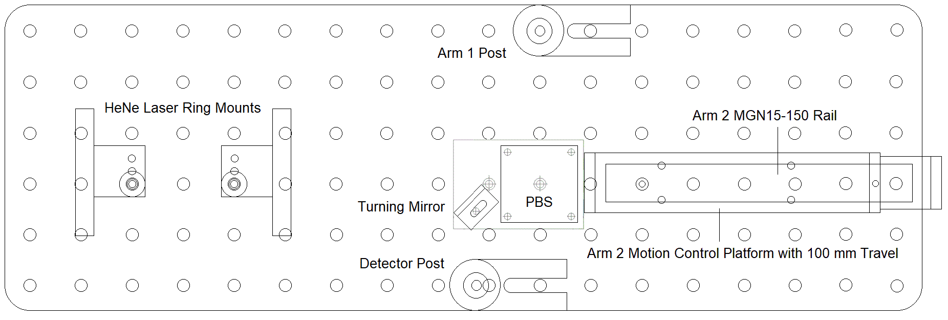

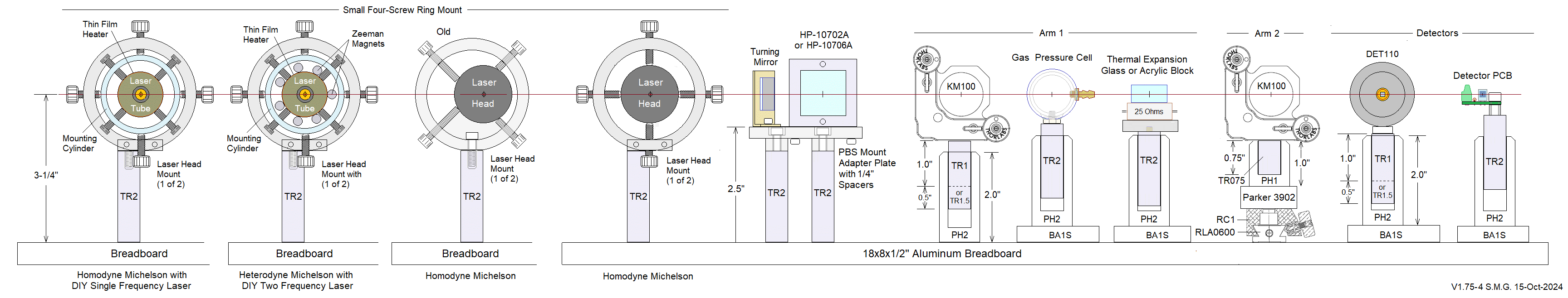

The 4-screw ring mounts have been modified so that the thumbscrew motion is along the X and Y axes (instead of at ±45 degrees). And the offset of the rings forward and back can be set to -0.25", 0", or +0.25" so that the thumbscrew tips contact the laser head cylinder near the center for all common adjustment settings. Info on the old style ring mounts is included here only for backward compatibility should any kits still be floating around that use them; New ones will all have the, uh, new style ring mounts. ;-)

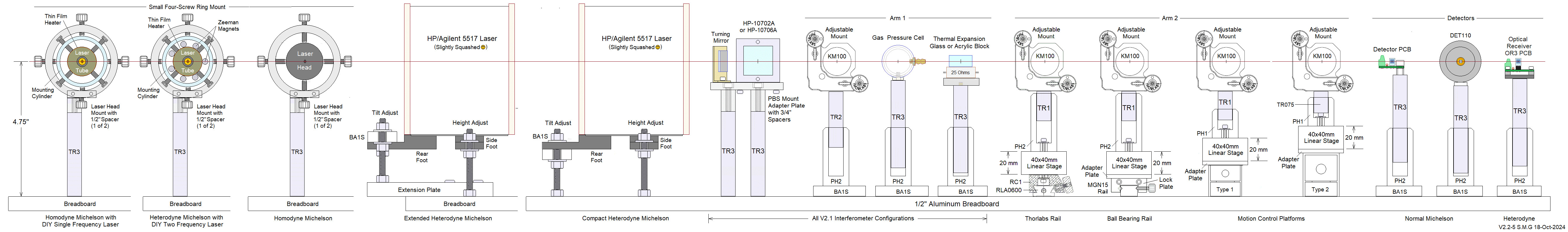

And this diagram applies to all V1.75 setups. 3-1/4" places the laser in the center of the PBS vertically:
Required Optical Components and their Suggested
Heights - V1.75
Note that the primary differences between these are in the size of the posts and postholders as V1.75 does not need to accomodate the additional height of the optional motion control components. Similarly, everything in V2.1 can be reduced in height by around 1" if there is no desire to accomodate them. V1.75 also assumes the use of the Parker 3902 stage which has a thickness of 1/2". To use the typical generic stage requires that everything be raised by a bit over 1/4". This isn't rocket science, you'll figure it out. ;-)
The heights of any Retro-Reflectors (RRs) in the setup will be what most affect the beam height. This is true of the Linear Interferometer (LI). Where there is an RR attached to the PBS cube like the Plane Mirror Interferometer (PMI), the alignment of the laser will need to be used. However, there is a wide tolerance and enough degrees of freedom so in the end, it should not really be much of a problem to set it up.

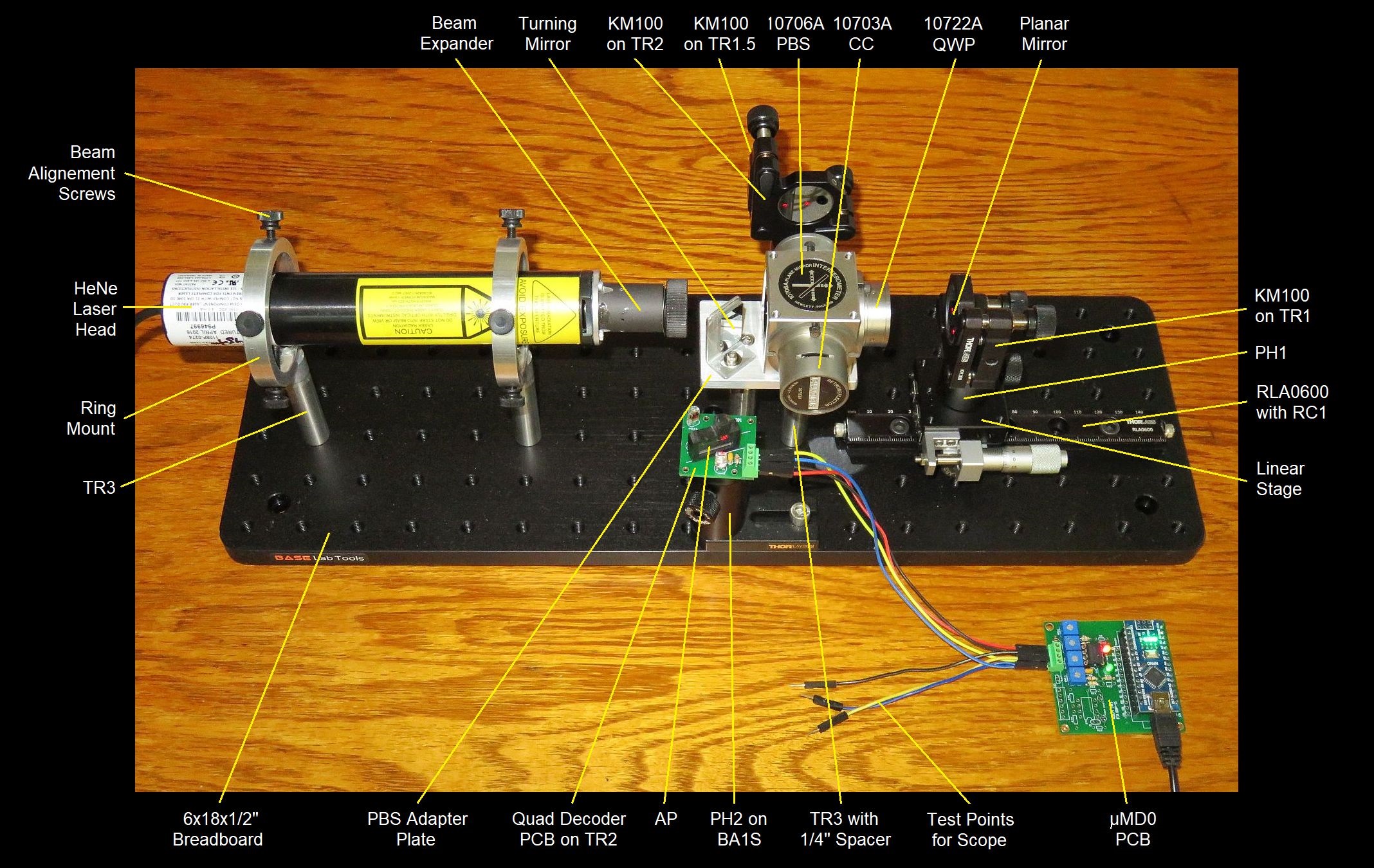

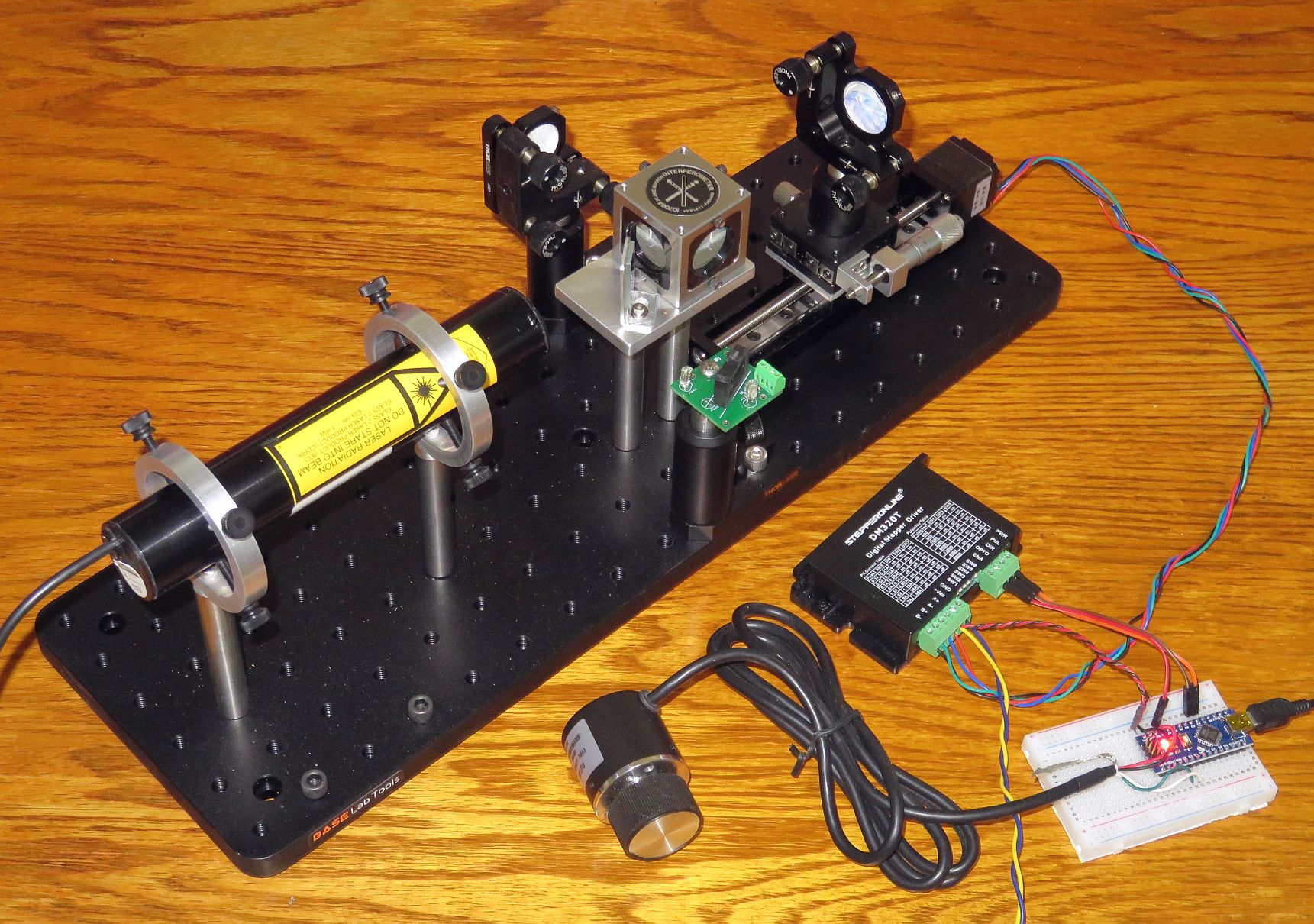

Here is an annotated photo of the Deluxe version configured for the HSPMI:
And if you have a sharp eye, you will notice that this is actually not exactly a V2.1 or V1.75 setup but should be close enough for government work. Live with it. ;-)
The Deluxe+ version would be similar except for the larger breadboard and longer rail; The Basic version does not include the beam expander, mounted CC, QWPs, or planar mirrors.

Please refer to the appropriate Heights diagram. Clicking on it will open a new window, or print it out for reference.
If the laser head has a beam expander, or it is anticipated that one will be added later, it is recommended that the posts be mounted 1 hole to the left of where the are in the photo.
Note: To assure that there are ample threads engaged in both parts here and in subsequent steps with a post attached directly to the breadboardd or mounting plate, the set-screw should be installed approximately half-way and then a thin tool or the edge of a piece of stiff cardboard can be used to keep the set-screw from turning as the post or post holder is threaded onto it before tightening.
Doing this accurately is critical to the ease with which the subsequent alignnment can be performed since not all mounts have sufficient degrees of freedom to accomodate an arbitrary beam location and direction. Fabricating an "alignment aid" out of carboard may be useful. This would have a hole at the optimal height offest 1/4" toward one side from a mark at the bottom.
The laser beam should pass through the PBSC centered vertically and 1/4 inch toward the back. It should be at the same location relative to the breadboard at the far end. If not, fine tune alignment. :) Getting this dialed in precisely will greatly simplifiy alignment later.
Secure the platform on the breadboard using four 4-40 1/2" cap-head screws if the holes are tapped, or 4-40 3/4" screws and nuts if not. Take care to assure that it is aligned.

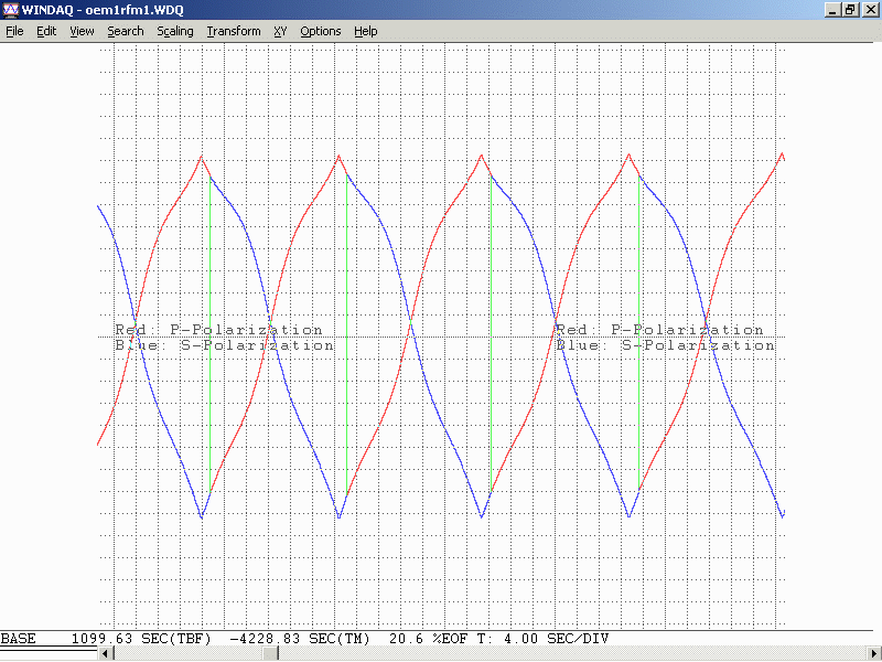

And for those new to interferometers, to reiterate, the optimal alignment will also be where the signal instability is maximized. ;-) Almost ANYTHING will affect it from touching the apparatus or table on which it is on, to just walking across the floor. The wavelength of light is really really small. ;-) To put this in some perspective, a full cycle of the signal with the Linear Interfemeter is a change in PLD of 316.4 µm (1/2 wavelength of 632.8 nm or 1/3,160th of a mm). That's about 1/158th the diameter of an average human hair (~50 µm) or 1/22th the diameter of a human red blood cell (7 µm). Street traffic will be detectable, as will drafts from the A/C, changes in temperature, and siesmic events. Some of these effects can be further explored using parts in these kits.

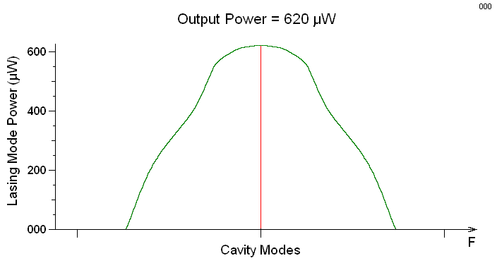

The tests above were done with the PLD near 0. What happens otherwise? If the laser operated with a Single Longidudinal Mode (SLM), the PLD would not matter up to a very large number in the 100s of meters or more. (Such lasers are also called "single frequency".) However, the laser used here is NOT SLM but has 1 or 2 modes depending on its cavity length, which changes due to thermal expansion during warmup as the modes sweep through the neon gain curve. (There is much more on this in the section: Linear polarized versus random polarized laser.)

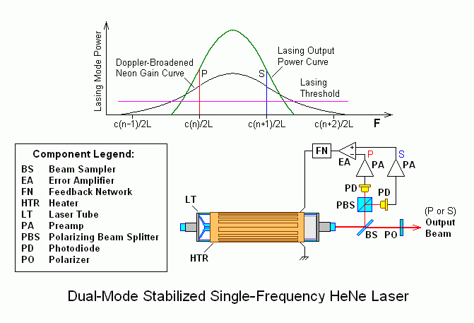

For the first of the following tests, the lasing modes must all have the same polarization. And the (single pass) Linear Interferometer should be used.
For all these tests, it will be better to shut off the laser for a few minutes before starting. Then when it is turned on, the mode sweep due to cavity expansion will be fastest.
The cavity length of the tube in the 1107 and 1108 lasers is around 137.6 mm or 5.417 inches. One half of this is 68.8 mm or 2.7085 inches.

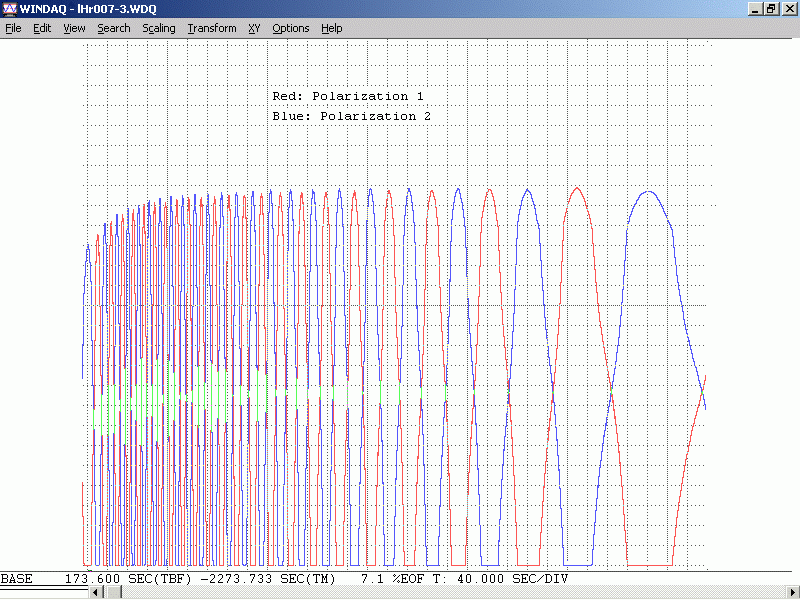

Now explain the behevior in each case. And what is special about a PLDs of zero and half the cavity length?
How might these results differ if the HSPMI were used instead of the LI?
If your laser is random polarized, it is possible to perform the following additional tests with the CP removed from the front of the laser:
Explain your results with respect to the longitudinal mode behavior.
What would happen if the PLD could be extended to more than the cavity length of the laser as would be possible with the 12 inch rail in the Deluxe+ kit?
All of these tests can also be done with the other interferometer configurations. Predict how the results would change, if at all. What about the HRPMI?
Normally, the Arm 1 mirror would be mounted along with the QWP on the PBSC as the reference since absolute PLD doesn't matter with the single frequency or two frequency lasers used in metrology applications. But as with the LI, we need the PLD to be close to zero or ohter specific value for experiments using a multi-longitudinal mode laser. (The "other specific value" would normally be a small integer multiple of the laser's internal cavity length. Why?)

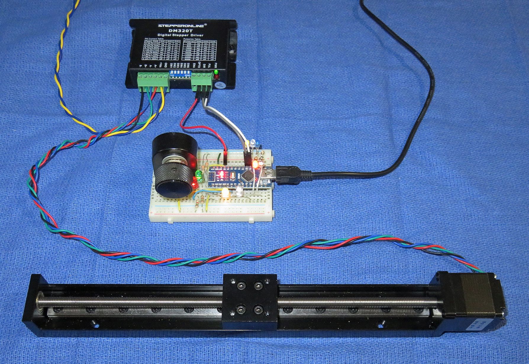

The setup below was used for the initial implementation and is similar to what will be included in the kit, (currently an option). This rail with a travel of 200 mm would fit easily fully on the "Extended" version of the interferometer. In fact, rails with a 250 mm travel would also fit and they may be available in the future. For the shorter setups, a rail with a travel of 100 mm would be used. Putting the motor on the left enables a micrometer stage with the knob on the end to be used without hitting the motor housing, which is at a greater height than the platform. However, to minimize the PLD for the homodyne setups, the motor should be on the right using a micrometer stage with side-mounted knob. For Heterodyne, the absolute PLD doesn't make any difference so there's no real need for the reflector to be able to move as close as possible to the interferometer.
Holes will need to be drilled or drilled and tapped on the breadboard to mate with the Metric hole spacing of the rail. BA-type hold-down clamps or even industrial strength double sticky tape would also work, if a bit clunky.
To mount the micrometer stage on the stepper platform, an adapter plate is needed unless one is willing to simply use glue. It's the same one used with the ball bearing rail, so that can be transferred if available. 5-Minute Epoxy would be satisfactory, and could be removed if necessary. (If installed on a V2.0 setup, the optical centerline increases by 1/2 inch so some parts change, mostly Thorlabs posts and spacers.)
The Atmega 328P Nano runs the firmware in the link, below. This is for testing only or if all that's desired is a manually-controlled motorized stage. ;-) It has no error checking so twiddling the knob faster than the motor can move so it just whines is very easy, and there are no limit switches so the flaform can smack into the end plates. But as can be seen, there are many extraneous useless LEDs. ;-) The DM320T controller is set for 400 pulses/mm and the lowest motor current of 0.3 A. Higher current will increase the maximum speed to some extent, but don't go above a sustained current of more than 0.6 A. CAUTION: I you decide to play with a rig like this, make sure the DC to the DM320T is clean and comes on quickly. Else the DM320T may get into a funky state which among other things can send lots of current through the motor, as well as not respond to drive pulses. At least, that's what appeared to have happened on more than one occasion when ramping up the input voltage manually. A 12 VDC wall adapter solved that. I don't know if the red Fault LED on the DM320T being off is sufficient to guarantee correct operation.
Test of 200 mm Travel MCP (left), on Extended Heterodyne Setup (Left-Center), Test of 100 mm Travel MCP (Right-Center), and on Basic Homodyne Setup (Right)
The photos show samples of the 100 and 200 mm travel MCPs along with typical installation on the optical breadboards. The electronic Solderless BreadBoard (SBB) with the Nano driving the 200 mm versions is my original rig for testing the quad decoder sketch; the one with the 100 mm versions is all that's needed and is what will be included in the kit. Feel free to add decorative LEDs. ;-) And yes, if you look closely, the tip of the micrometer is not touching the bracket in one of the pics. That's because the stage can be locked in place and wasn't unlocked for the photo. ;-)
The hardware is the easy part and a mock-up has been constructed as shown above. For V2.1, the motion control platform can be substituted for either the Thorlabs or ball bearing rail with virtually no changes to anything else. But for V2.0, it will not quite be a drop-in as the heights have increased by 1/2 inch. So some opto-mechanical components will need to change - mostly Thorlabs posts and spacers, but there would be negligible additional cost involved.
The software to make this educational and useful is the challenge.
An Arduino sketch for an initial version that simply enables the platform to move based on Quad-A-B encoder signals - NOT from the interferometer! - can be found at:
The SG-µMD0, SG-µMD1, or SG-µMD2 PCBs can have firmware added for motor control in addition to their other duties. Or another microcomputer could be used.
Suggestions for actual challenging applications (and coding volunteers) are welcome. :( :-)
Mechanical installation
Secure the platform on the breadboard using four 6-32 1/2" cap-head screws if the holes are tapped, or 6-32 3/4" screws and nuts if not. Take care to assure that it is aligned.
Electrical installation

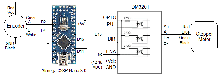

Please refer to the connection diagram below.
Typical Connection Diagram for Motion Control Platform Testing
(To reverse direction, do only ONE of the following: Swap A and B, Mov DIR from D16 to D14, swap A+ and A-, swap B+ and B-.)
There could be others, so confirm with a multimeter. The coil resistance should be no more than a few ohms. Connect them to the A+/A- and B+/B- terminals of the DM320T. As a practical matter, it doesn't much matter which motor winding goes to A or B, or even the polarity as long as they aren't cross-connected (which should not damage anything but the motor won't move). Direction of motion is reversed by swapping any single pair of wires going to a specific winding. The DM320T connector blocks may be removed by grasping them and pulling straight ou if that is more convenient to secure the connections.
Here are the required connections. Referring to the sample sketch, there are other pins that may be used to monitor up/down pulses and PWM signals to drive various flavored LEDs for your own amusement. ;-)
Arduino Pin Nano Pin Name Function
D2 5 A Encoder input
D3 6 B Encoder input
D14 19 DIR-R Direction reverse to DM320T*
D15 20 Pul Motor drive pulse (low) to DM320T
D16 21 DIR-F Direction forward to DM320T*
GND 29 GND Ground/common for optical encoder+
5V 27 +5V +5 VDC for DM320T OPTO and optical encoder
VIN 30 VIN +7 to +12 VDC input power (optional)
* Only one of the Direction signals should go to the DM320T. They are complements of one-another. So if the platform moves the wrong way, use the other one.
+ Since the control signals to the DM320T are opto-isolated, the DM320T GND does not need to connect to the Arduino or encoder GND.

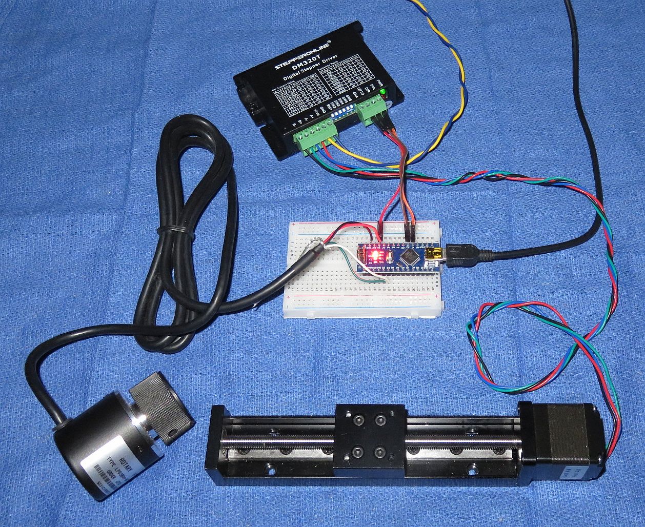

The encoder can also be used to drive µMD0 or µMD2 with Homodyne firmware. For that, pullups will need to be added to the A and B signals and a reference voltage will be required on the A- and B- inputs at about 1/2 the signal swing.
When power is applied to the DM320T, the green LED should come on but NOT the red one. If it does, check connections and that power is clean and being applied quickly (not ramping up). The motor should not get more than slightly warm even after being on for a while at the 0.3 or 0.5 A current setting. The motor may make a hissing noise when stationary due to the DM320T's drive. I assume it is some sort of dither to overcome stiction (or something). It is not known yet how much the resulting vibrations will be seen by the interferometer. That may be an interesting thing to quantify. Ears and interferometers are very sensitive. ;-)
The typical rotary encoder included in the kits has a resolution of 400-600 cycles per 360 degree rotation. So turning the shaft should get the platform moving at a reasonable clip and it is easily possible to exceed the pulse rate where the motor responds. In that case, the motor will stall and whine with the platform remaining stationary. This is a mechanical limitation, not the Nano firmware. The lead screw has a small pitch (1 mm) which is desirable to maximize resolution for interferometer testing. But it also means the motor has to exert itself to produce fast movement. At the DP320T's coarsest Pulse/rev setting, the maximum platform speed is about 1 cm/second corresponding to 6,000 steps/second, or an encoder rotation rate of 2.5 revs/second. (6,000 steps/second / (600 cycles/rev * 4 pulses/cycle). If the DM320T DIP switch Pulse/rev setting is increased, the rate of movement will decrease proportionally and the maximum (input) pulse rate before the motor stalls will increase proportionally. Mounting a massive knob or wheel (not included) on the encoder would enable the friction and imbalance of the shaft to be measured by the interferometer. ;-)

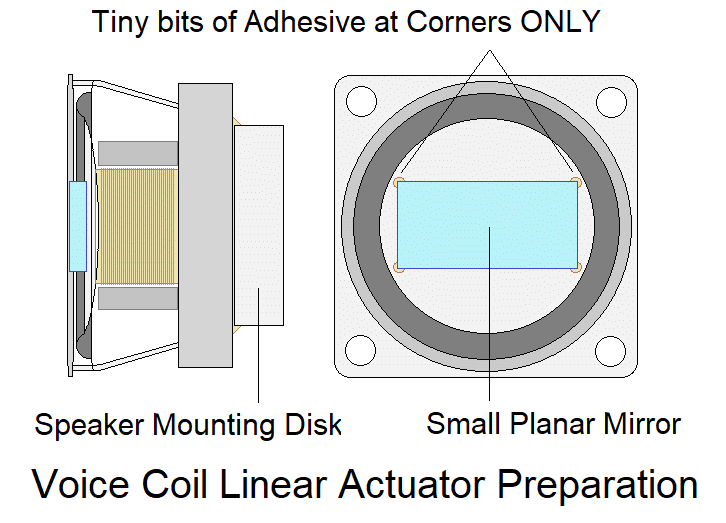

The mini loudspeaker 4 ohm woofer can move its cone a couple of mm with 1.5 V at 0.375 A. But for these tests, it only needs to move a few µm.
One of the interferometer configurations using planar mirrors must be used for this since it's not practical to attach a cube corner to the loudspeaker. The HSPMI is recommended.
To use it:
For seeing how its movement will affect the interferometer, the loudspeaker can be driven with a 1.5 V battery (not included) and series resistor. Even with a fairly high resistor value like 10K ohms, the mirror will move decent amount, probably much more than one fringe cycle. Or it can be driven through a resistor via the 10K ohm potentiometer and 10K ohm series resistor from a 9 V battery or 12 VDC power supply. One of these should be included in the kits.

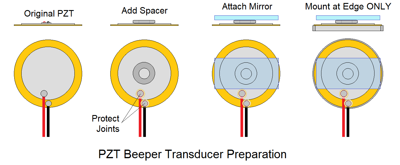

The PZT beeper element in the kit is 27 mm in diameter with an active area of around 20 mm in diameter. It is what's called a "drum head" PZT because the surface moves in and out at its center when a voltage is applied. It can move a few hundred nm with 15 V at essentially no current - it has some capacitance but an infinite resistance, which for slow movement is all that matters. Up to around 100 V can be safely applied to move several µm.
As with the loudspeaker, one of the interferometer configurations using planar mirrors must be used for this since it's not practical to attach a cube corner to the PZT. The HSPMI is recommended.

The Gas Cell Compensator (GCC) consists of a ~2" length of 1" OD Acrylic tube, a pair of planar windows sealed to the ends, the pressure bulb and gauge for a blood pressure cuff (sphygmomanometer), and some simple plumbing. It can mount on a Thorlabs post and post holder using a BA1S hold-down.
GCC Assembly:
The Acrylic tube will already be cut to length and drilled and tapped for the 10/32 hose barb and 8-32 set-screw to attach it to a Thorlabs post. The ends will have been ground to be close enough for government work. :) They don't need to be perfectly perpendicular to the tube or parallel to each-other. Nor do they need be polished - the rough cut surface is better for gluing. Only that they can seal to the windows.
The windows are 1-1/8" in diameter and made of either glass or Acrylic. The Acrylic will have paper protective brown paper on both sides.
Avoid getting any Epoxy inside the tube, especially on the windows, as much of their area may need to be unobstructed depending on the type of interferometer and/or whether the laser has a beam expander.
If it gets messed up before curing, the Epoxy can be careully wiped off and then the glass and/or Acrylic can be cleaned with alcohol (but nothing stronger!). After curing, a single edge razor blade can be used to remove Epoxy, then cleaned with alcohol. Take care to avoid scratching the window(s).

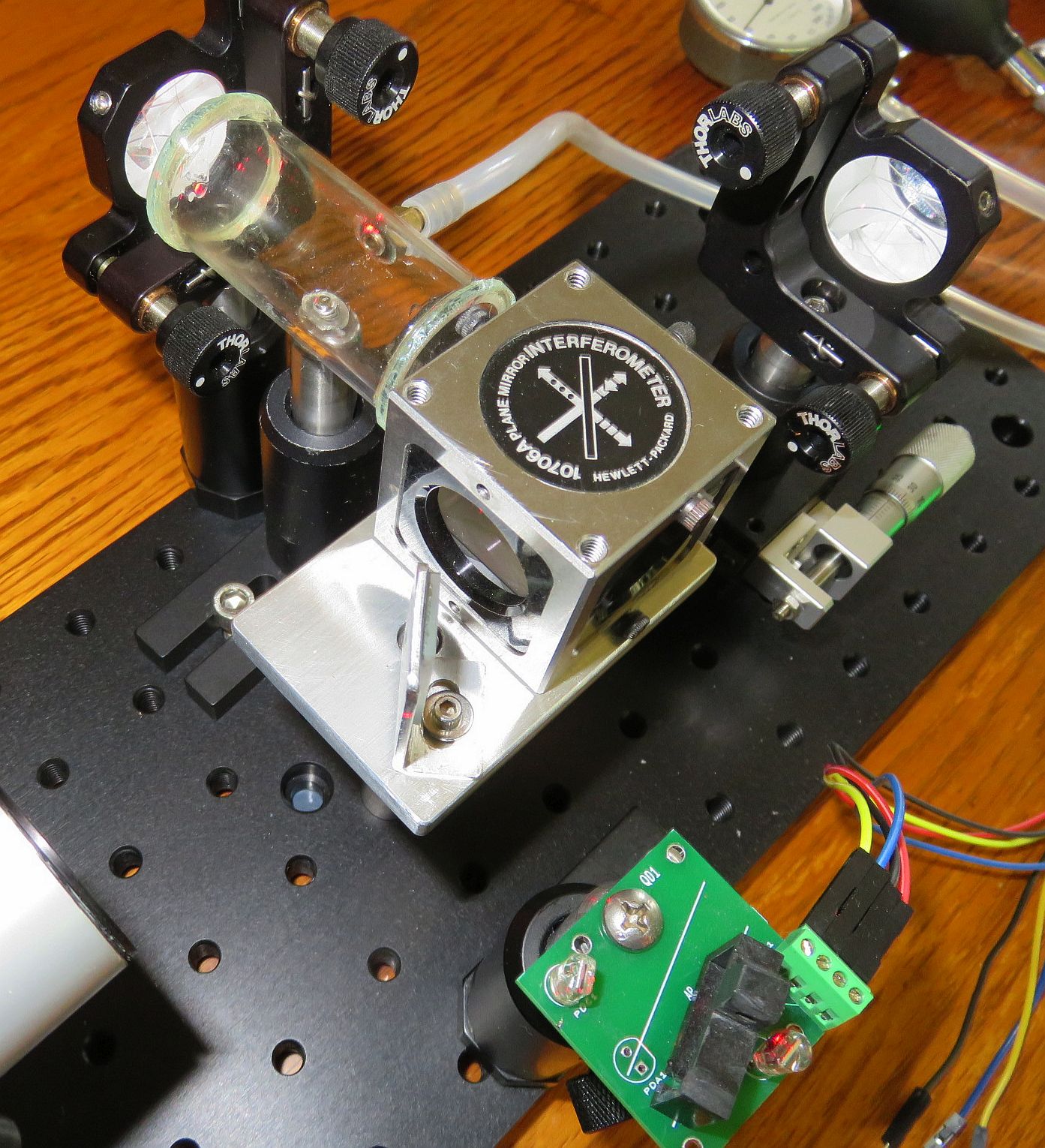

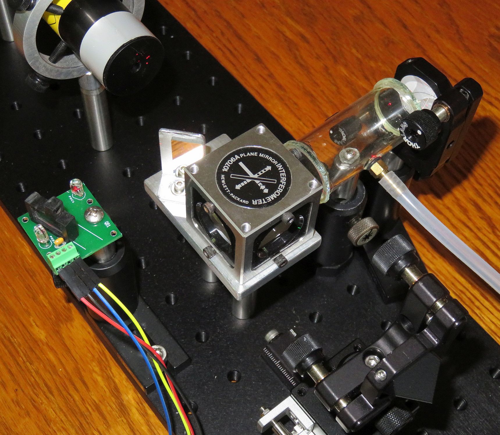

The photos show the Basic homodyne version with the GCC installed in Arm 1 of the interferometer. The mirror mount post holder is moved further out to make room for it. The arrengement is identical for the heterodyne setups except for the substitution of the laser and optical receiver.
For more details on the setup to view the signal, refer to the section: Monitoring the PLD.
This photo shows the complete setup with the prototype of the GCC and a scope trace of the photodetector out showing the GCC loosing presure some of its pressure over 20 seconds or so.
Closeup of GCC Assembly using a Piece of PVC Pipe (left), Overall Setup Showing the Fringe Signal as the Pressure Declines
Note: If doing this using one of the plane mirror interferometers, the Arm 1 mirror mount may need to face away from the PBSC (with the mirror installed backwards) as with the CCs in the LI to provide enough clearance for the GCC. Then adjust the Arm 2 mirror position so the PLD is 0.
The blood pressure gauge reads up to 300 mm/Hg (almost 6 psi), but there should be no need to go anywhere near the extreme hypertension region for these tests! :) 100 mm/Hg will be more than enough.
The gas cell can be mounted in either arm of the interferometer, though using Arm 1 is probably better as it has nothing else. It can be positioned so that either one or both beams (where present) pass through it. (How will this change the calculations?) Avoid aligning the gas cell so that the windows are perfectly perpendicular to the beam paths - angle it slightly so the reflections from the surfaces of the windows do not coincide with the main beams.
The Arm 1 and Arm 2 path lengths do not need to be the same so that at least is simpler than for the homodyne setup with unstabilized laser.
Fine tune the alignment of the interferometer to maximize signal amplitude. Close the bleeder valve and slowly pump up the bulb while watching the scope display and pressure gauge. The index of refraction, n, will be approximately equal to 1 + P * k. By measuring the number of cycles and partial cycles as the pressure is changed, it is possible to calculate k. Check it against a value found in a search. Why might it not be the same? Knowing k, an arbitrary pressure can be measured with the interferometer.
Based on the NIST Refractive Index of Air Calculator using Ciddor Equation, the index of refraction of air at 1 atm (760 mm/Hg), 20°C, and 50%RH, is 1.000271372. As an example, at a pressure above 1 atm of 100 mm/Hg, it is 1.00030715. What is the value of "k"? Over the 3 inches (76.2 mm) inside the GCC, the change in path length is approximately 2.73 µm or 4.31 full wavelengths at 633 nm. You can complete the calculations. ;-) Perform the test with 100 mm/Hg and your favorite interferometer configuration. Explain your results. What are the possible sources of error? Hint: What effect will reflections from the parallel surfaces of the windows have on transmission?

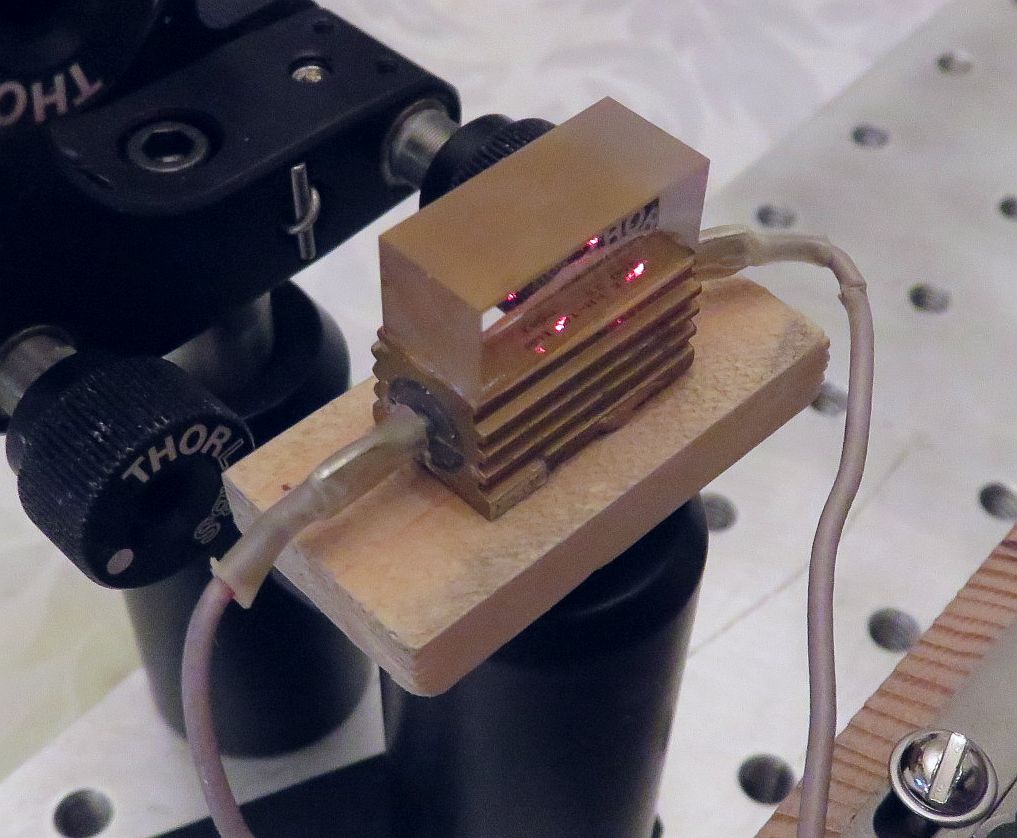

Thermal Assembly Assembly:
The 12 VDC power pack is used to do the heating. DO NOT use a 9 V battery, it won't last very long. The power into the resistor(s) is 12*12/R - 5.76 watts for the 25 ohm resistor.
The Coefficient of Thermal Expansion (CTE) for optical glass is around 8x10-6/°C. (It varies slightly depending on the specific type, which is not known for the compensator block.) That means a 1 °C change in temperature will result in its length changing by 8 ppm (parts per million or 0.000008 x its length). Assume that the index of refraction of optical glass, ng, is approximately 1.5. (Again not precisely known .) Calculate the expected number of full cycles from the detector for a 10 °C change in block temperature. Don't forget that it's the net change in PLD that matters.
Monitor the signal using your choice of method as the block heats or cools and use the results above to estimate the temperature of the glass block based on its length. Without actually knowing the temperature of the block throughout its volume, and knowing it actual CTE and ng. it is not possible to be precise. That's OK.
The effect will not be as dramatic as with the GCC, above, but with care, should be easily detectable.
CAUTION: Do NOT leave the resistors plugged into the power pack continuously for too long as bad things may happen.
What else may be impacting the PLD change besides the block itself? For example, is there any detectable response to the heating if the block is rotated and/or offset so it just misses both beams?

For these experiments where one of the arms is of considerable length, the 6 mm beam (up to around 5 meters) or 9 mm beam (up to at least 10 meters) will need to be used. A narrower beam would expand too much to be useful. But don't get carried away putting the reflector 25 meters away. Remote alignment will be a large challenge at the very least.
The best configuration to start with is The LI, but with the genuine HP 10703A CC as the remote reflector and one of the generic CCs attached to the interferometer PBSC for the reference. The 10703A will almost certainly provide better parallelism for the outgoing and return beams than the generic CC. This isn't as important for the short beam paths of the reference.
Start with perhaps 0.5 meter. Then extend it gradually, tweeking alignment at each step.
The remote reflector should preferably be mounted on a separate structure, not the same table as the rest of the setup. Another table or wall, for example. Or even suspended by springs or wires. Either arm can be extended but using Arm 2 with the linear stage may be simpler for mounting to a slab of wood or aluminum.
This rig will be very sensitive regardless of the type of interferometer so anything more complex than the LI may not be justified. Those using a planar mirror as the remote reflector will be more challenging to align because of the mirror rather than CC and also that they are double pass. But if you insist, the PMI should be an acceptable "upgrade" but make sure the 10703A CC is used for the measurement beam. There probably isn't much point to constructing the HSPMI - and alignment will be trickier. Stability is going to be dominated by external factors, but feel free to go there. ;-)
The use of µMD0 or µMD2 to actually measure displacement would be best as the data could also be captured and (with some simple formatting in Excel) then be formatted like a seismograph. But just watching the signals on the scope should provide some valuable insight into what's going on. Not only vibrations, but temperature changes and even air convection should be detectable.
Variations on the basic interferometers can be used to sense tilt (angle), lateral movement (straightness), deviation from right angle (squareness), and others. See Optics for Interferometers Using Two-Frequency Lasers. The same optics can be used with single frequency lasers.

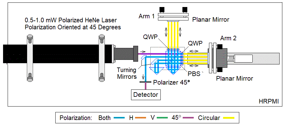

The HRPMI is essentially an HSPMI in which instead of the return beam going to the detector, it is reflected back into the interferometer, but offset in position by an additional cube corner and traverses all of the optics a second time. So instead of 2 passes, it becomes 4 passes, and the losses will more than double reducing the signal level significantly. In principle, this could be extended to 6 or more passes using a similar approach, but as you will undoubtedly see if you're crazy enough to attempt to implement the HRPMI, it's already tough enough to align.
The HRPMI setup requires some additional optics (another turning mirror and adjustable mount for an unmounted cube corner). The laser may also need to be positioned further to the left to make space. The only way to really test it without a measurement display would be with one of the methods of fine tuning path length - loudspeaker, PZT, air pressure, tmperature, etc. The micrometer stage will simply not have fine enough control to reliably detect a difference between X1 or X4. Thus the setup is shown with the loudspeaker.

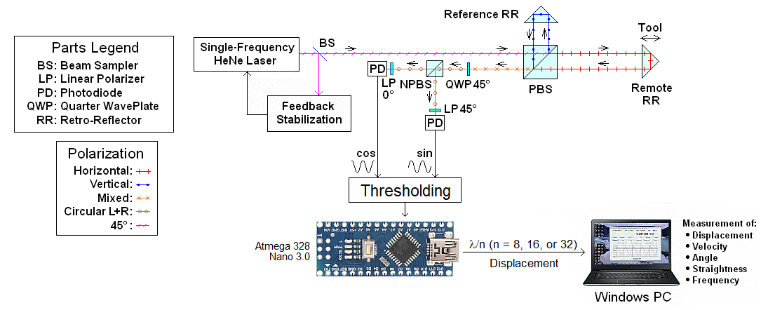

The output from an interferometer using a single frequency or two frequency laser may be processed to yield displacement information in digital form.
In their simplest form, the measurement electronics for a homodyne system is just a quadrature decoder circuit driving an up-down counter; for the heterodyne system it is a pair of accumulators and a subtractor. The interferometer optics are identical. In practice, the electronics is considerably more complex, in part to provide sub-wavelength interpolation and extend the range down to nm resolution. And yes, kits are available for these as well.
However, a basic implementation of a homodyne interferometer displacement measurement system for demonstration purposes can be done with a $3 microprocessor board and a few inexpensive parts as shown below. Where the path length difference is limited to be less than a few cm, a multi-longitudinal mode (not strictly single frequency) laser like the one in these kits may be used.

An interferometer with angled paths for the two interfering beams produces fringes similar to the pattern of an optical encoder so a quad detector could be built with offset photodiodes. However, more commonly, the 90 degree phase shift is done optically using a single combined beam as shown below. If thresholded and converted to digital form, the result would be a Quad-A-B format.
This shows variations on one of several common implementations for a Quad-Sin-Cos decoder that provides Sine and Cosine outputs for use in a displacement measuring system. This is among the simplest. In most instances, the photodiodes would be reverse biased to provide a linear response. It may be possible to get away without that for initial testing but it will probably be needed if doing anything useful with the outputs. In addition, a third "Intensity" channel is almost always included to accommodate variations in detected power due to the laser aging, changes in alignment, and contamination over time. The Intensity channel can be implemented electronically or optically with a non-polarizing beam-splitter at the input and additional photodiode.
The output signals from these will be close to sinusoidal with a relative phase close to plus or minus 90 degrees depending on the. direction of motion of the remote reflector or ring laser gyro.
The purpose of the angled arrangement is to minimize the difference between the amplitudes of the two polarizations. Otherwise, with 45 degrees being close to the Brewster angle (around 57 degrees), one will be much larger than the other. Even so-called 50:50 beam-splitters may be subject to this, so using the angled arrangement for either one may be beneficial. The parts for the version using the Attenuator Plate (AP) are what are in the kit, which simplifies construction. Using the AP also permits the relative amplitudes of the Channel A and B signals to be changed somewhat without electronic adjustments.

For the sinusoids, capturing a decent photo while twiddling the micrometer screw is quite challenging. ;-) But the conclusions are clear: This simple Quad decoder does its job well with a phase shift of ±90 degrees. If the Arm 2 mirror or retro-reflector were on an electronically controlled positioner like a loudspeaker voice coil or linear motor driven with a ramp, the waveforms would be textbook quality. ;-) But with only a small stretch of the imagination, it can be seen that the screenshots agree with the expected behavior based on the diagrams, above.
The prototype on a prototyping board was then constructed and tested to confirm similar behavior, and then the simple PCB was made so that mounting of the photodiodes and other electrical components would be simplified. There is nothing to really secure the AP/BS but that could be done with double-sided tape.
The Lissajous display on the right was done at a later time under more controlled conditions using a loudspeaker voice coil driven by a triangle wave from a function generator! Using a High Stability Plane Mirror Interferometer, each 360 degree rotation represents a displacement change of 158 nm.

In the photo, above, one piece of CP sheet is stuck directly to the channel 1. PD. The other piece of CP sheet is simply propped in front of the channel 2 PD with the sticky side facing out. Long term, that side should be protected with some 5 Minute Epoxy or a microscope cover slip. The AP is just sitting on the SB. Dabs of 5 Minute Epoxy, wire loops, or other means can be used to secure them more permanently. If using wire loops, take care not to short out anything that shouldn't be connected. ;)
There can be a number of reasons for this offest. What might they be? Hint: Think polarization.

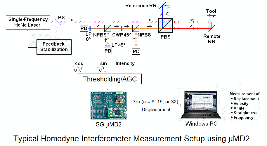

For the purposes of these interferometer kits, µMD0 consists of three parts:
The general organization of a typical system is shown below (though the one implemented in this kit differs in some subtle details):

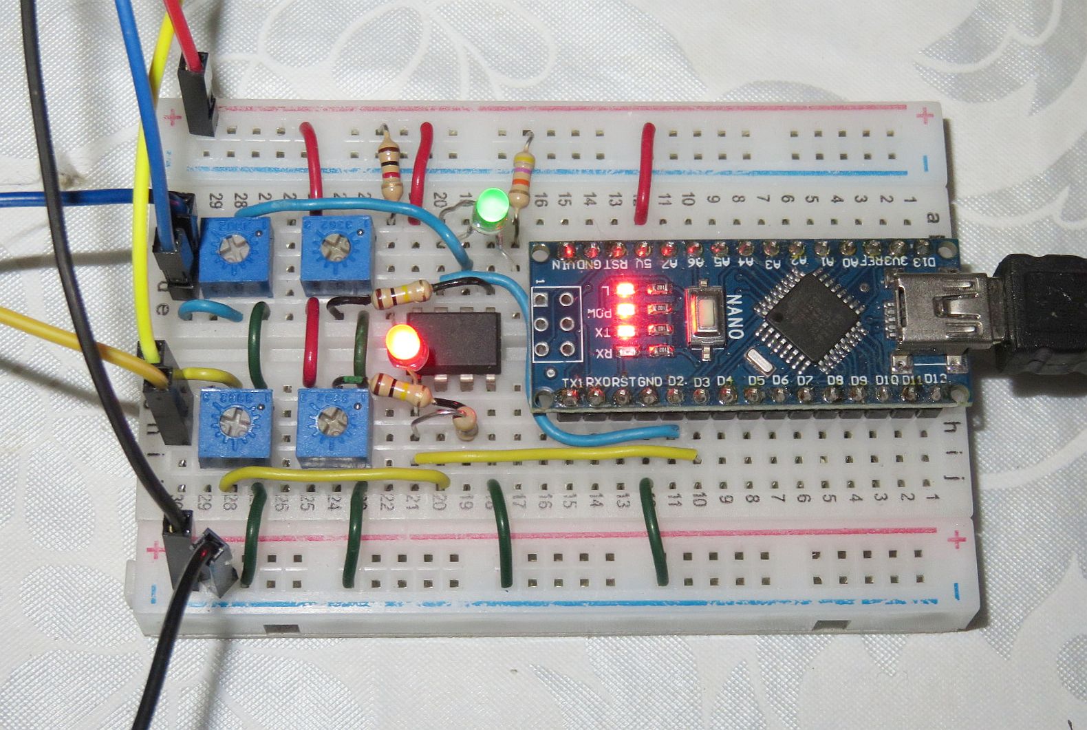

To convert the analog sin and cos signals to something for a low cost microprocessor with adequate performance requires a simple interface which provides gain and threshold adjustments. (While it has analog inputs, their conversion rate is way too slow.)
Referring to the schematic, the trim-pots on the left are the load resistors for the quadrature detector. The 100K value should be satisfactory to resultin a signal of a few volts p-p using a laser with an output power of around 1 mW and no beam expander. (The expanded beam may slightly exceeds the dimensions of the photodiodes so the sensitivity will be reduced.) For a lower power laser or a laser with a beam expander, larger values may be required. Or for finer control, fixed resistors can be added in series with the trim-pots. The trim-pots on the right adjust the comparator threshold for the Sin and Cos signals from the Quad decoder, with the feedback resistors providing some hysteresis. The Atmega 328P Nano 3.0 board runs firmware that is compatible with the µMD GUI. Of course, no high tech system would be complete without indicator lights, so LEDs are added to monitor the A and B inputs. ;-)
The minimal implementation is shown below along with a shot of the laptop screen while twiddling the linear stage micrometer:
µMD0 and Interface Schematic (left), Impementation on Solderless Breadboard (Middle), µMD GUI Display while changing Displacemet (right)
A schematic with slightly more detail like pin numbers may be found at: µMD0 Sin-Cos Analog and RS422 Digital Interfaces.
A simple assembled PCB for quad decoder is included. Blank PCBs are available for the µMD0 and interface, but should not be required for a student project. ;-)
The ptototype setup is shown below, but with the dual Thorlabs DET110 detectors and interface without gain adjustments, sorry. ;-)
Overall Setup showing Interferometer, Scope, µMD0 with Interface, and µMD GUI Display

This diagram shows the modified setup for the LI:
Standard and Low Cost Linear Interferometer
Both the 1/2" PBS cubes and 1" CCs are readily available on eBay and elsewhere. (The 1" CCs can be the same type as those used in Arms 1 and 2 for the LI and DPLI.) Creative mounting will be required - perhaps that's a good use for the lonely 3-D printer you own. ;-) The tricky part is aligning the two PBSs so their reflections are perfectly parallel. The difficulty of this task should not be underestimated, especially since the inexpensive PBS cubes are, well, not always quite cubical. ;( ;-) Thus it cannot be done by aligning physical surfaces - it would have to be done in both axes using some sort of optical jig and a laser beam or beams, or in the actual interferometer setup with the Arms 1 and 2 reflectors positioned much farther away than they will ever be in use. My initial attempt attaching the PBSCs to a metal plate using double-sticky tape failed miserably. While the beams could be easily superimposed at the detectors, they were not sufficiently parallel to produce an interference signal. This is normally fascilitated by the CC(s) assuring parellelism of the outgoing and return beams, and the common planar reflective surface of the PBS for them. The overall beam pointing alignment may need to be within 0.01 mR or even better depending on the PLD and type of interferometer.
For interferometers requiring QWPs like the PMI and HSPMI, HP 10722As may show up on eBay at reasonable prices. As an alternative, I have a limited number of 1/2" optical grade mica QwPs which have been tested to work well. These are very fragile so they would need to be attached directly to the PBSs with index-matching cement (5 minute Epoxy may also be suitable), to a plate with holes for the beams, or to plastic or metal washers. Two of these would be required to substitute for each 10722A.
As partial confirmation, a test was done replacing the CC and 10722As of the HSPMI (but using a 10702A PBS since I don't yet have a generic 1" PBBS). The CC and QWPs were glued to HP alignment plates that attach to the PBSC with magnetic strips as can be seen below:
HSPMI using 10702A PBSC with a Generic CC and Generic QWPs
It does work. However, as expected, the signal amplitude is down by more than 65%. This is probably mostly due to the 16 traversals of the uncoated surfaces of the QWPs, followed by 4 traversals of the uncoated surfaces of the CC and 6 reflections from their internal silver-coated surfaces. But there are likely also contributions from not quite accurate 45 degree QWP orientation and less than perfect QWP 90 degree retardation. But the QWPs are mostly responsible for the decrease in signal level, so AR-coated QWPs would help a lot. It's *only* 8 passes but through 16 surfaces.
The HSPMI is the most complex of the common interferometers; The LI is trivial in comparison with only a single CC. While tests have not been performed with a generic CC attached to the PBSC in an LI, it is expected that the only effect would be a reduction in signal amplitude of around 9 percent due to the slightly lower efficiency of the generic CC of around 0.86 compared to 0.90 for each pass compared to one from HP.
Next up: Using a non-HP PBSC, though I do not expect there to be any significant difference in performance, at least for the small PLDs of this setup. Stay tuned.
The analog with the signal is that it can be high or low. But since the laser is still lasing and with no polarizer in front of the detector, the detected signal is more or less constant. So when the signal is low (or the spot is dark), where is the missing power? I'll save you some of your brain cycles and state that with the LP film, it's lost in the plastic and actually increases its temperature a miniscule amount.
But what about a Polarizing Beam-Splitter (PBS) like the large one that is the heart of this setup? They have negligible losses and it would be simple in principle to use one in place of the LP film. To do that, either the PBSC would need to be rotated 45 degrees or the polarization of the beam would need to be rotated 45 degrees so that the PBS can generate the two polarized outputs. Rotating the polarization of the beam can be done with a Half WavePlate, but there is none in the kit, believe it or not. ;-) However, it can be simulated using two pieces of LP film and the Attenuator Plate (AP) as a Non-Polarizing Beam-Splitter (NPBS). This isn't quite identical because there will still be losses in the LPs, but if oriented at ±45 degrees, the effect will be the same.
This uses the same CP as the quad decoder but for these experiments, the QWP portion is totally irrelevant and the QWP (sticky) side goes toward the photodiodes for both.
It should be pretty obvious what is going to happen, but seeing it is not quite the same as theory. ;-)
But many other parameters can be measured using interferometry including angle, straightness, and flatness. The layouts for these are not particularly complex but would require creativity in mounting and some optics and mechanical parts not included in the standard kits. See the information at Optics for Interferometers Using Two-Frequency Lasers.
With an SF laser and the Quadrature Detector, the signal output from any of these interferometer configurations will provide complete displacement information that can be used with a measurement display or for closed-loop control. Systems using SF lasers are called homodyne interferometers.
SF HeNe lasers are available for order of $5,000 from a few laser companies (though this number has been dwindling). But fortunately, it is possible to construct one from readily available parts for less than 1/20th as much. The laser tube can be identical to the one used in the JDSU 1107 or 1108 random polarized HeNe laser head that comes with some of these interferometer kits. Adding a heater to control cavity length along with a simple controller using discrete analog components or an Arduino turns it into an SLM laser with performance similar to that of the high priced ones. The laser tube could mount on the same 4-screw rings as the normal head cylinder, but inside its own cylinder along with a thin film heater, similar to what is shown in the photo below under "Future Options" and in the "Setting the Heights" section above. Some basic optics and a small PCB for stabilization would then be added. It's really that simple!

One use of an LP in this interferometer is to combine the two orthogonally polarized components from the PBSC at 45 degrees so they line up and can interfere at the detector.

QWPs are used in several of the interferometers. Their optical axes are always at ±45 degrees. (The handedness of the circular polarization will be swapped but that doesn't matter here - they are unmarked and can be mounted either way.) Thus when light polarized at 0 or 90 degrees passes through the QWP, it is converted to circular polarization. When that is reflected from a CC or plane mirror, the handedness flips and when it passes back through the QWP, the polarization axis is rotated 90 degrees. This allows the PBSC to redirect it resulting in the various beam paths required by the interferometers.
Some specific applications:

Although the experiments are described with a linear polarized HeNe laser, it is possible to use a random polarized laser instead if one is more readily available. However, its output will need to be converted to linear polarization in a very specific way with a linear polarizer to behave the same. But a random polarized laser can also demonstrate some interesting interferometer behavior not available with a linear polarized laser.
And note that this only applies to red HeNes, not even other color HeNes, let alone most other lasers. Murphy must have taken a day off when the HeNe laser was invented because these attributes end up being quite useful - in fact fundamentally important - for many applications.
A laser tube with these characteristics would be considered "well behaved". if the longitudinal modes move smoothly through the neon gain curve without abrupt changes in amplitude and not all are like this. :( :) A "flipper" will have "polarization switching" whereby at some point or points during mode sweep, the two sets of longitudinal modes will swap their polarization axes, usually instantly. For some truly nasty tubes, this will happen continuously, somewhat well, at random. Flippers are often not suitable for an interferometer because in the region of the flip, there may be excessive optical noise, possibly due to even the smallest amount of back-reflection, which will show up as large oscillations in the fringe signal. (While that in itself may be interesting, it will also be confusing.)
For an academic challenge, a random polarized flipper is probably the most interesting type of tube to study. But a good understanding of what's going on is necessary to not to go insane attempting to decipher the behavior.
The next most interesting tube would be one that is random polarized and well behaved. One or two of the kits put together to date includes that type of laser. A random polarized flipper can be provided in place of or in addition to the linear polarized or random polarized well behaved tube if interested. :-)
There are three versions of the V2.1 Homodyne setups, though customization is possible.
The Basic version really has enough for an introduction to interferometry and can be upgraded to the Deluxe version by adding the appropriate parts from me or elsewhere.
Other changes compared to V1.0 and V1.5 include:
However, for the die-hard, a few DET110s are available at a lower cost than the current version of a biased photodiode from Thorlabs.
Photos of each of the three versions with typical interferometers are
shown below. The first is the Basic version with the 6x18" the breadboard,
configured with Linear Interferometer and quad decoder PCB attached to the
SG-µMD0 PCB:
The next one is the Deluxe version configured for the High Stability Plane Mirror Interferometer. The laser includes a beam expander but it is otherwise configured the same way.
The next is the Deluxe+ "Stretch" version on the 8x24" breadboard.
Replicating it should be straightforward
The 8x18" optical breadboard for V1.0 and V1.5 is custom with the dimensions selected to be convenient for the projects while being able to easily ship Worldwide. The 6x18" and 8x24" breadboards for V2.0 and V2.1 are standard. If machining one, fewer than half the standard holes are enough based on all reasonable mounting locations, but that's only worth it if you're paying by the hole. ;-)
Most other standard opto-mechanical parts are from Thorlabs. The major exceptions are the HP/Agilent PBS cube, QWPs, and mounted CCs (via eBay). But low cost substitutes for those are in the works.
The JDSU 1107P and 1108P, or similar laser heads from Melles Griot/Pacific Lasertec like the 05-LHR/P-211 are ideal for these experiments. The criteria include being linearly polarized, eye-safe output power, and physical size. Optics companies like Edmunds, Newport, and Thorlabs have suitable lasers (though most are made by JDSU and PLT), but eBay is often a good source at a fraction of the cost. The laser could also be a bare tube safely enclosed, though the preferred linearly polarized variety is not that common at the low power of 0.5 to 1 mW. Random polarized heads and tubes can be used (and actually add some interesting areas to study) if certain criteria are met, primarily that they are not "flippers". See section: Linear Polarized versus Random Polarized HeNe Laser.

Motion Control Platform (Option):
1x Mini-stepper driven platform, 100 mm, 150 mm or 200 mm travel, with
4x 4-40 1/2" cap head screws or 4x 4-40 3/4" cap-head screws
and nuts to secure it to the breadboard. Each of these will nearly
entirely fit on the breadboard for the Compact, Mid-Size,
and Extended Versions, respectively. The hole pattern may differ
for the Type 1 and Type 2 MCPs.
1x MCP adapter plate (if not already present with the generic stage, they
are the same.
1x STEPPERONLINE DM320T micro-step stepper motor controller.
1x Atmega 328P Nano 3.0 microcomputer board with solderless breadboard.
1x Optical high resolution rotary encoder to move the platform via
the Nano at least for testing.

Gas Cell Compensator (Air Pressure and Temperature):
1x 1" OD, 7/8" ID, 2" L Acrylic tube.
2x 1-1/8" D glass or Acrylic window.
1x 10-32 to hose barb adapter.
1x 8-32 3/8" or 1/2" set-screw.
1x Blood pressure bulb with valve.
1x Blood pressure gauge.
1x 3-3.5 mm (or 1/8") ID Rubbor tubing to connect.
1x Hose barb "T" for 3 to 4 mm tubing.
