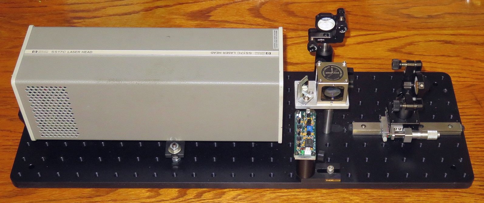

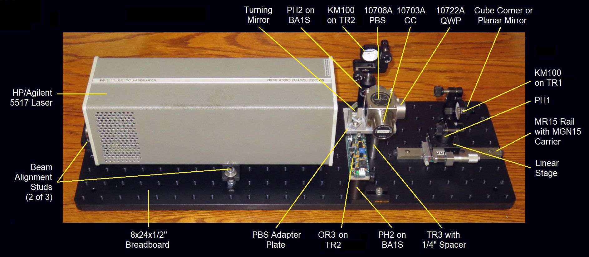

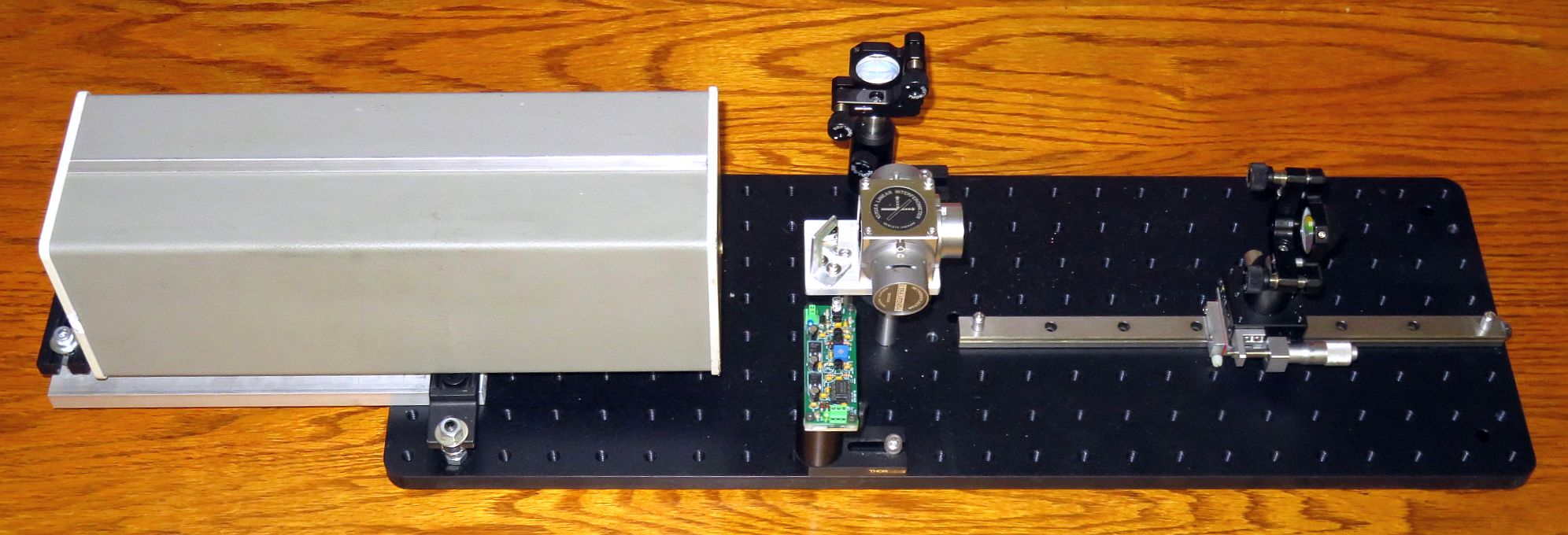

The photo below shows two typical configations of the Compact and Extended Heterodyne setups.
Typical Compact and Extended Heterodyne Setups with Ball Bearing Rails and OR3

Currently, there are three minor variations that differ only in the location of the laser and the length of the ball bearing rail for Arm 2. The "Compact" version places the laser entirely on the breadboard and is more convenient for transport. Its main limitation is that the ball bearing rail is limited to 150 mm so it fits on the breadboard. The "Mid-Size" and "Extended" versions moves the laser to the left with an extension bar to support the back of the laser and uses a 200 or 300 mm rail. Versions include a Motion Control Platform (MCP) in place of the ball bearing rail for Arm 2. In principle, a closed-loop positioning system could be implemented using the interferometer and µMD2 for feedback, though the required additional hardware and software is expected to be developed by advanced project students. ;-) There is also a more major variation permitting a 400 mm rail or 300 mm MCP to be installed even on the Compact version, though without detailed assembly instructions. Stay tuned.

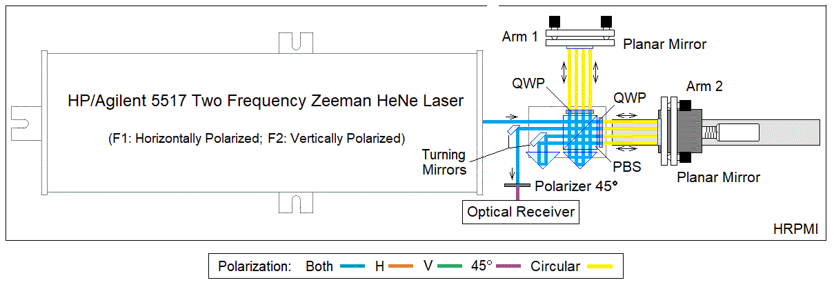

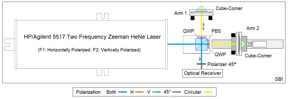

REF (F2, vertical) and MEAS (F1+ΔF1, horizontal) are passed through a linear polarizer at 45 degrees to a back-biased photodiode. The optical receivers provided with this kit add circuitry to boost the signal and then convert to the RS422 signal format required by µMD2. See Optical Receiver 3 (OR3) - Assembly and Operation Manual. These are provided in kit form with Heathkit™-style assembly instructions so construction is not overly painful. ;-)

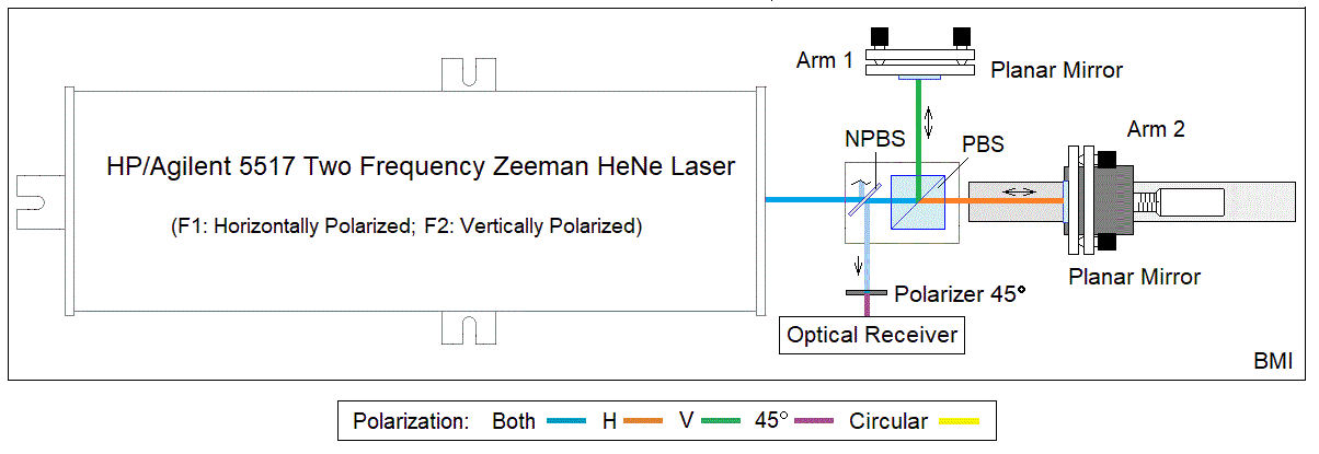

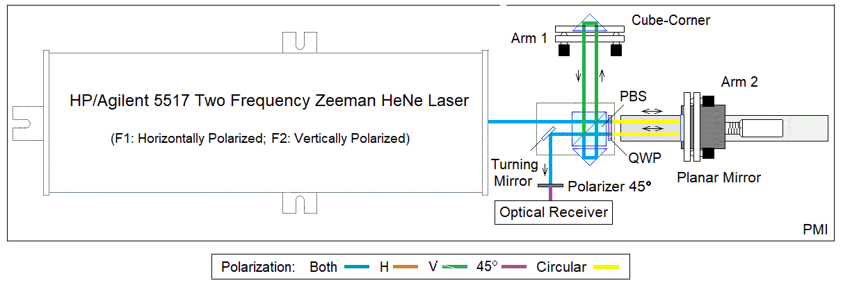

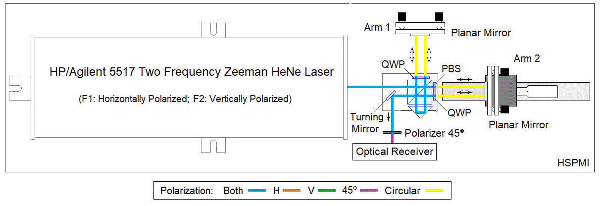

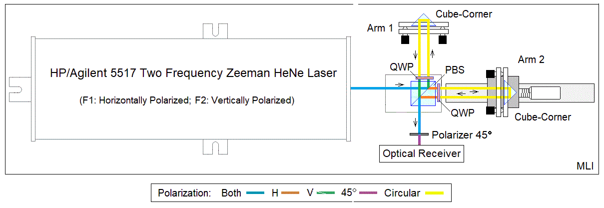

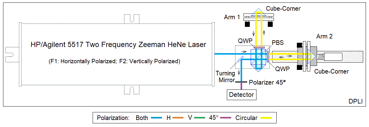

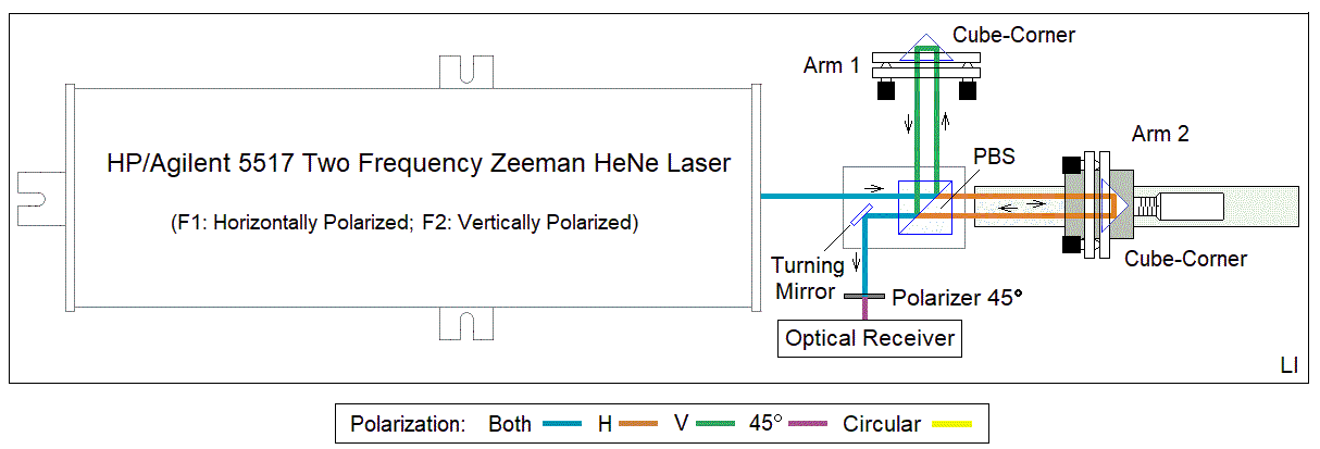

The graphic above show the specific example of a Linear Interferometer (LI) for displacement (change in position) measurements, with velocity calculated as the rate of change of position. By substituting different interferometer configurations, higher resolution displacement as well as angle, straightness, and other physical variables can be measured.

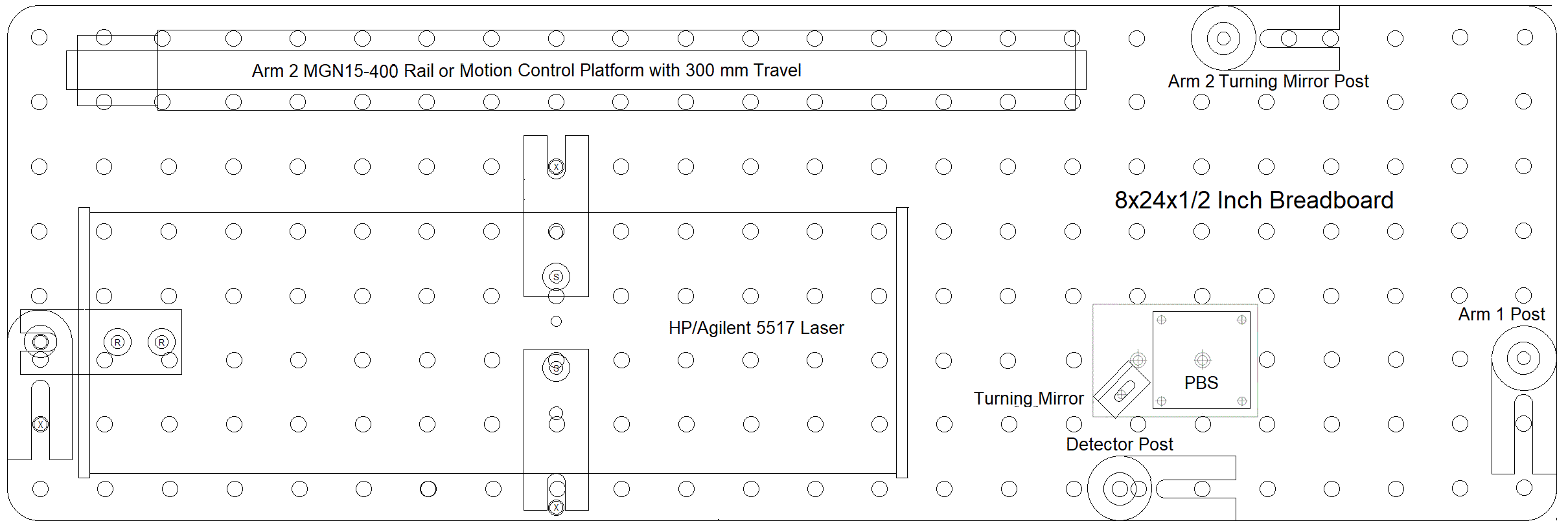

The only difference between the Compact, Mid-Size, and Extended versions is mounting of the back of the laser. For the Compact version, the stud is attached the breadboard; for the others, the stud is attached to the xtension Plate.
If there is no desire to include any of the motion control options, the height of everything can be reduced by around 1".
The heights of any Retro-Reflectors (RRs) in the setup will be what most affect the beam height. This is true of the Linear Interferometer (LI). Where there is an RR attached to the PBS cube like the Plane Mirror Interferometer (PMI), the alignment of the laser will need to be used. However, there is a wide tolerance and enough degrees of freedom so in the end, it should not really be much of a problem to set it up.

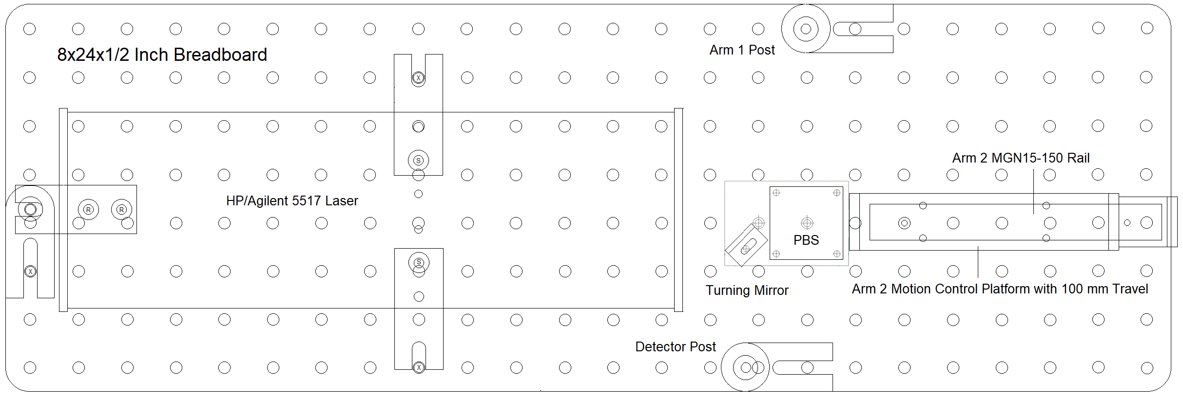

Here is an annotated photo of a typical setup configured for the DPLI:

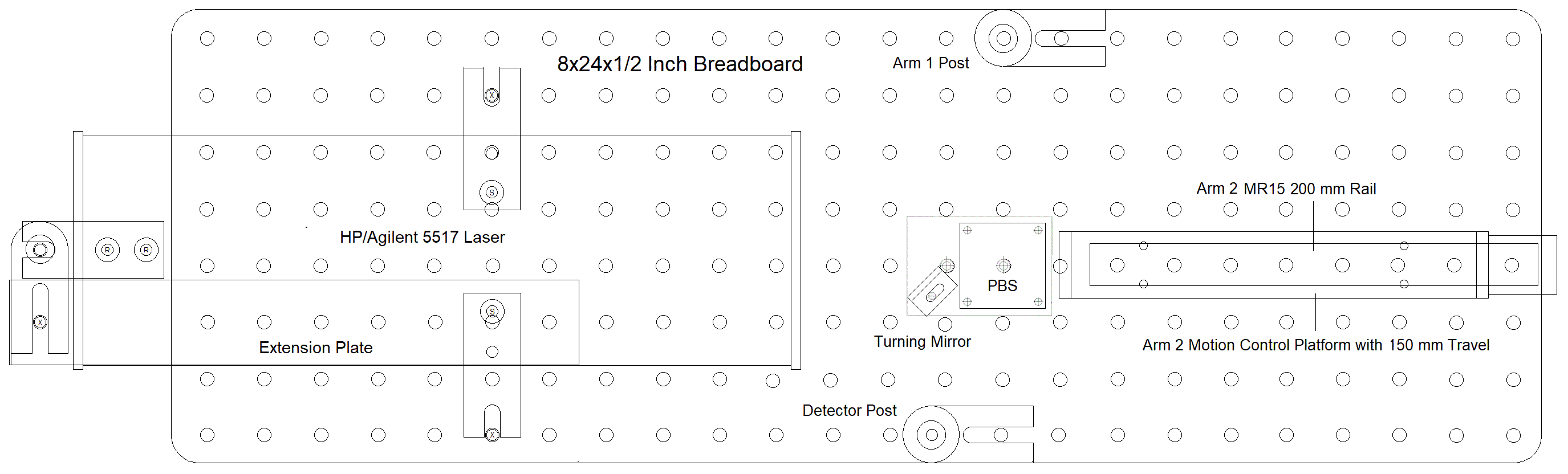

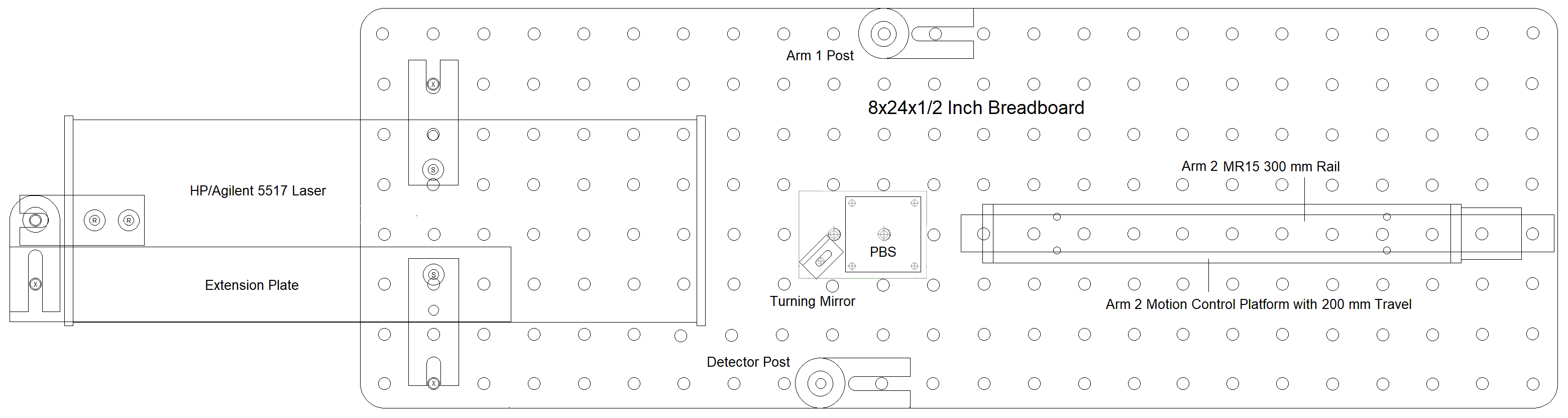

Please refer to the appropriate layout diagrams below.
An noted above, the only real difference between first these setups is in the mounting of the laser and the length of the ball bearing rail (or motion control platform). The Compact Version is most easily transported while the Extended Version provides the maximum range of movement of the Arm 2 reflector. The Mid-Size Version represents a nice compromise.
The one on the right supports an extra length 400 mm ball bearing rail or 300 mm motion control platform. Assembly is basically similar but detailed instructions are not provided, sorry. ;-) And it may be necessary to trim one of the BA1Ss used to mount the laser to provide clearance for the mount on the rail.

The setup below was used for the initial implementation and is similar to what will be included in the kit, (currently an option). This rail with a travel of 200 mm would fit easily fully on the "Extended" version of the interferometer. In fact, rails with a 250 mm travel would also fit and they may be available in the future. For the shorter setups, a rail with a travel of 100 mm would be used. Putting the motor on the left enables a micrometer stage with the knob on the end to be used without hitting the motor housing, which is at a greater height than the platform. However, to minimize the PLD for the homodyne setups, the motor should be on the right using a micrometer stage with side-mounted knob. For Heterodyne, the absolute PLD doesn't make any difference so there's no real need for the reflector to be able to move as close as possible to the interferometer.
Holes will need to be drilled or drilled and tapped on the breadboard to mate with the Metric hole spacing of the rail. BA-type hold-down clamps or even industrial strength double sticky tape would also work, if a bit clunky.
To mount the micrometer stage on the stepper platform, an adapter plate is needed unless one is willing to simply use glue. It's the same one used with the ball bearing rail, so that can be transferred if available. 5-Minute Epoxy would be satisfactory, and could be removed if necessary. (If installed on a V2.0 setup, the optical centerline increases by 1/2 inch so some parts change, mostly Thorlabs posts and spacers.)
The Atmega 328P Nano runs the firmware in the link, below. This is for testing only or if all that's desired is a manually-controlled motorized stage. ;-) It has no error checking so twiddling the knob faster than the motor can move so it just whines is very easy, and there are no limit switches so the flaform can smack into the end plates. But as can be seen, there are many extraneous useless LEDs. ;-) The DM320T controller is set for 400 pulses/mm and the lowest motor current of 0.3 A. Higher current will increase the maximum speed to some extent, but don't go above a sustained current of more than 0.6 A. CAUTION: I you decide to play with a rig like this, make sure the DC to the DM320T is clean and comes on quickly. Else the DM320T may get into a funky state which among other things can send lots of current through the motor, as well as not respond to drive pulses. At least, that's what appeared to have happened on more than one occasion when ramping up the input voltage manually. A 12 VDC wall adapter solved that. I don't know if the red Fault LED on the DM320T being off is sufficient to guarantee correct operation.
Test of 200 mm Travel MCP (left), on Extended Heterodyne Setup (Left-Center), Test of 100 mm Travel MCP (Right-Center), and on Basic Homodyne Setup (Right)
The photos show samples of the 100 and 200 mm travel MCPs along with typical installation on the optical breadboards. The electronic Solderless BreadBoard (SBB) with the Nano driving the 200 mm versions is my original rig for testing the quad decoder sketch; the one with the 100 mm versions is all that's needed and is what will be included in the kit. Feel free to add decorative LEDs. ;-) And yes, if you look closely, the tip of the micrometer is not touching the bracket in one of the pics. That's because the stage can be locked in place and wasn't unlocked for the photo. ;-)
The hardware is the easy part and a mock-up has been constructed as shown above. For V2.1, the motion control platform can be substituted for either the Thorlabs or ball bearing rail with virtually no changes to anything else. But for V2.0, it will not quite be a drop-in as the heights have increased by 1/2 inch. So some opto-mechanical components will need to change - mostly Thorlabs posts and spacers, but there would be negligible additional cost involved.

The HRPMI is essentially an HSPMI in which instead of the return beam going to the detector, it is reflected back into the interferometer, but offset in position by an additional cube corner and traverses all of the optics a second time. So instead of 2 passes, it becomes 4 passes, and the losses will more than double reducing the signal level significantly. In principle, this could be extended to 6 or more passes using a similar approach, but as you will undoubtedly see if you're crazy enough to attempt to implement the HRPMI, it's already tough enough to align.
The HRPMI setup requires some additional optics (another turning mirror and adjustable mount for an unmounted cube corner). The laser may also need to be positioned further to the left to make space. The only way to really test it without a measurement display would be with one of the methods of fine tuning path length - loudspeaker, PZT, air pressure, tmperature, etc. The micrometer stage will simply not have fine enough control to reliably detect a difference between X1 or X4. Thus the setup is shown with the loudspeaker.
Here are two possibilities:
This diagram shows the modified setup for the LI:
Standard and Low Cost Linear Interferometer
Both the 1/2" PBS cubes and 1" CCs are readily available on eBay and elsewhere. (The 1" CCs can be the same type as those used in Arms 1 and 2 for the LI and DPLI.) Creative mounting will be required - perhaps that's a good use for the lonely 3-D printer you own. ;-) The tricky part is aligning the two PBSs so their reflections are perfectly parallel. The difficulty of this task should not be underestimated, especially since the inexpensive PBS cubes are, well, not always quite cubical. ;( ;-) Thus it cannot be done by aligning physical surfaces - it would have to be done in both axes using some sort of optical jig and a laser beam or beams, or in the actual interferometer setup with the Arms 1 and 2 reflectors positioned much farther away than they will ever be in use. My initial attempt attaching the PBSCs to a metal plate using double-sticky tape failed miserably. While the beams could be easily superimposed at the detectors, they were not sufficiently parallel to produce an interference signal. This is normally fascilitated by the CC(s) assuring parellelism of the outgoing and return beams, and the common planar reflective surface of the PBS for them. The overall beam pointing alignment may need to be within 0.01 mR or even better depending on the PLD and type of interferometer.

The HSPMI is the most complex of the common interferometers; The LI is trivial in comparison with only a single CC. While tests have not been performed with a generic CC attached to the PBSC in an LI, it is expected that the only effect would be a reduction in signal amplitude of around 9 percent due to the slightly lower efficiency of the generic CC of around 0.86 compared to 0.90 for each pass compared to one from HP.

Heterodyne V2.1 includes parts so that it can be configured as either the Compact or Extended configuration.
The only option for Heterodyne is the Motion Control Platform (MCP) in place of the MR15 ball bearing rail with MGN15-C carriage block.
