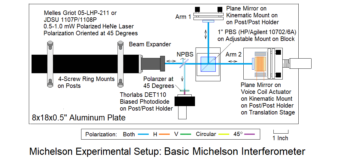

In short, a light beam is split into two parts which are bounced off of a pair of reflectors and recombined at a detector. Any change in the relative path lengths of the two "arms" formed by the reflectors results in a phase shift between the waves in the two beams resulting in constructive or destructive interference, which can be measured and converted to displacement (change in position) down to nanometer precision. All other types of measurements made by these systems are based on opto-mechanical configurations designed such that changes in the measured variable are detectable by what is in essense a Michelson interferometer.
Where the Path Length Difference (PLD) between the two arms is small, the requirements for the laser are not very stringent. In fact, for very small PLDs, an LED or even a totally incoherent source like an incandescent lamp may be substituted for the laser. However, to be useful for the PLDs necessary for most applications (millimeters to 10s of meters), the light source must be a laser. And not just any laser, but one that has a narrow "linewidth". While the popular concept of a laser is of a light source that is monochromatic (single color or wavelength), in reality most lasers do not even come close. It takes careful design and implementation to achieve that. For these metrology applications the laser should ideally produce an output that is a single optical frequency with a linewidth approaching zero. In practice, it isn't that narrow but can result in a linewidth of much less than 1 MHz, resulting in a usable PLD of 100s of meters. This is usually a low power stabilized HeNe laser. However, for PLDs of a few inches, a common (much less expensive) unstabilized HeNe laser will be adequate. Within this range, all the modes will be sufficiently correlated and the fringe contrast/signal amplitude will be acceptable.
Engrave PLD on your brain. It will be used throughout this manual. :)
Near the end of this manual is an experimental setup similar to the original Michelson Interferometer configuration adapted for the PBSC. So you can see these various issues for yourself.

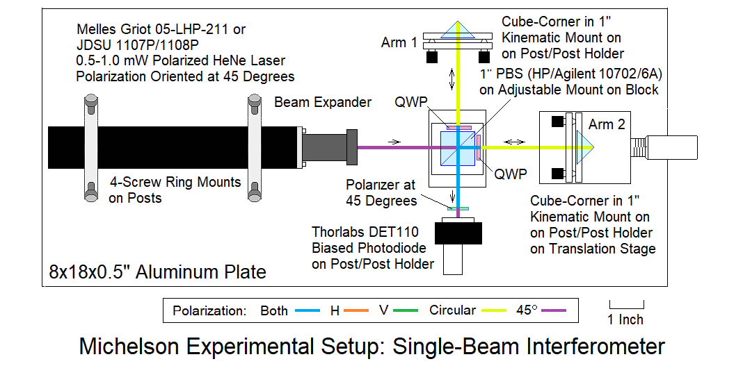

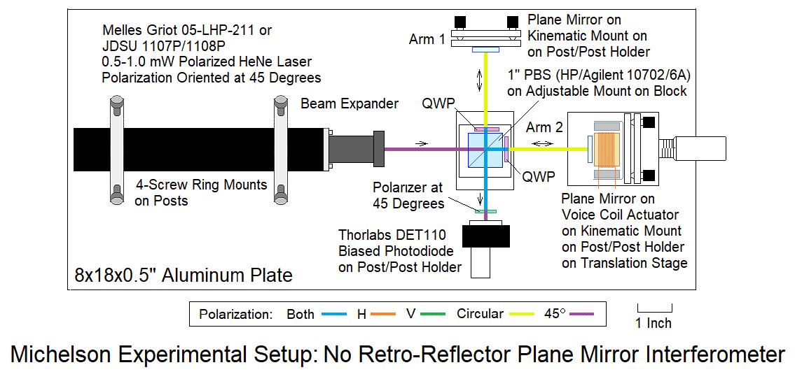

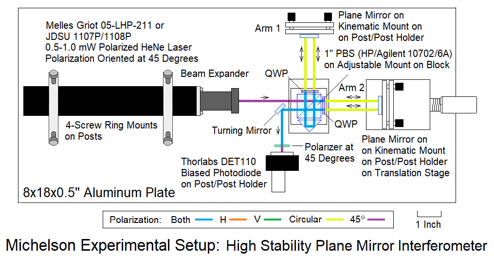

The diagrams below show some variations on the angles of the Beam-Splitter (BS) and Mirrors (M1, M2).
The first one is essentially the same as the diagram, above. The "Single Angled" one does nothing to prevent back-reflections. And while the "Double Angled" version does eliminate back-reflections, the two beams are angled at the detector which means their relative phase will vary across the detector. That is undesirable for our experiments in at least two ways: First, it will mean that the detector won't see a clean fringe signal. In fact there may be little or no signal depending on how the fringes average across its face. Second, alignment will change as either mirror is moved making testing with respect to PLD very tricky. But can you suggest an application where it may be useful?

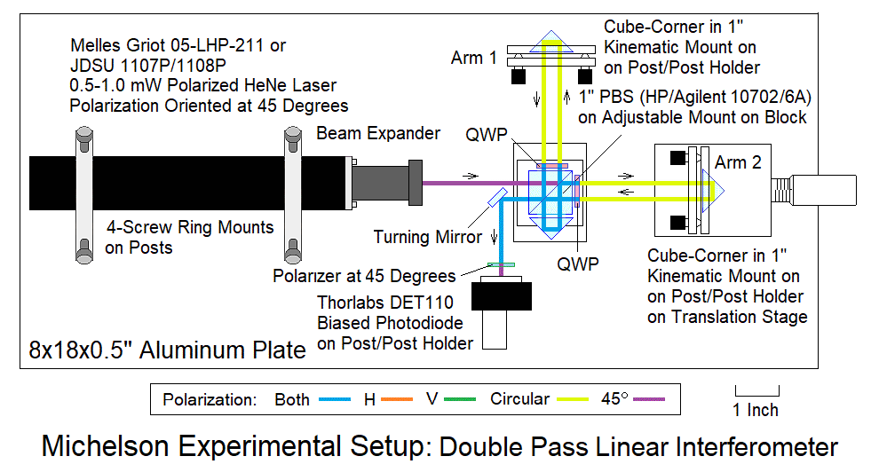

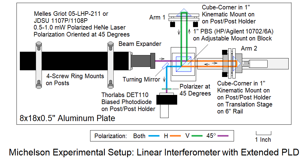

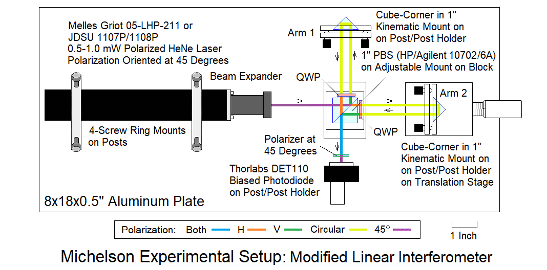

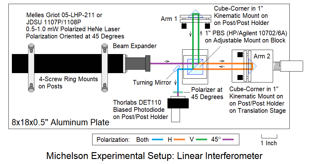

All of the practical interferometer configurations include at least one cube corner retro-reflector.
The beams reflected to the two arms of the interferometer then have orthogonal polarization which effectively makes them independent until they are combined at the detectors.
The result is then one of the most widely used configurations - the Linear Interferometer (LI), which was the first one used by HP in their original 5500A laser interferometer displacement measuring system. (As an aside, I do NOT know where that name "Linear Interferometer" comes from except perhaps that the inital configuration was in-line with the laser and thus "linear".) In practice, Arm 1 is used as the reference and is made as short as possible with the Cube Corner (CC) attached directly to the PBS cube. Both arms can move where differential measurements are required.
With the use of the PBS, the maximum amount of the laser optical power is available - virtually nothing exits out the unused side of the beam-splitter as it would in the original Michelson setup, above. However, at least half the power is lost in the detection scheme that is typically used so it would end up being similar. In principle, this wasted power can be diverted to a second detector. Their difference will then have twice the amplitude and the signal-to-noise ratio will nearly double (but opposite phase). This is rarely, if ever, done though. But for the more complex interferometer configurations described later as well as for use with two frequency lasers, the use of the PBS is essential to avoid incurring very large losses, or for the schemes to work at all.
However, since the laser used in these experimental setups are not single frequency, the PLD between Arm 1 and Arm 2 should be minimized for the initial setup. The effects of larger PFDs may be explored once "first signal" is achieved. Alternatively, a single mode laser can be built. Much more on all this below.
When used in a displacement measuring system with a 633 nm HeNe laser, 1X represents a full cycle resolution of 1/2 wavelength or ~316 nm; 2X of ~158 nm, and 4X of ~79 nm. For a homodyne system with a Quad-A-B deterctor, there are 4 counts per cycle so that gets multiplied by 4. The very commonly used PMI will have a resolution of 40 nm and interpolation techniques can extend it down to under 1 nm.

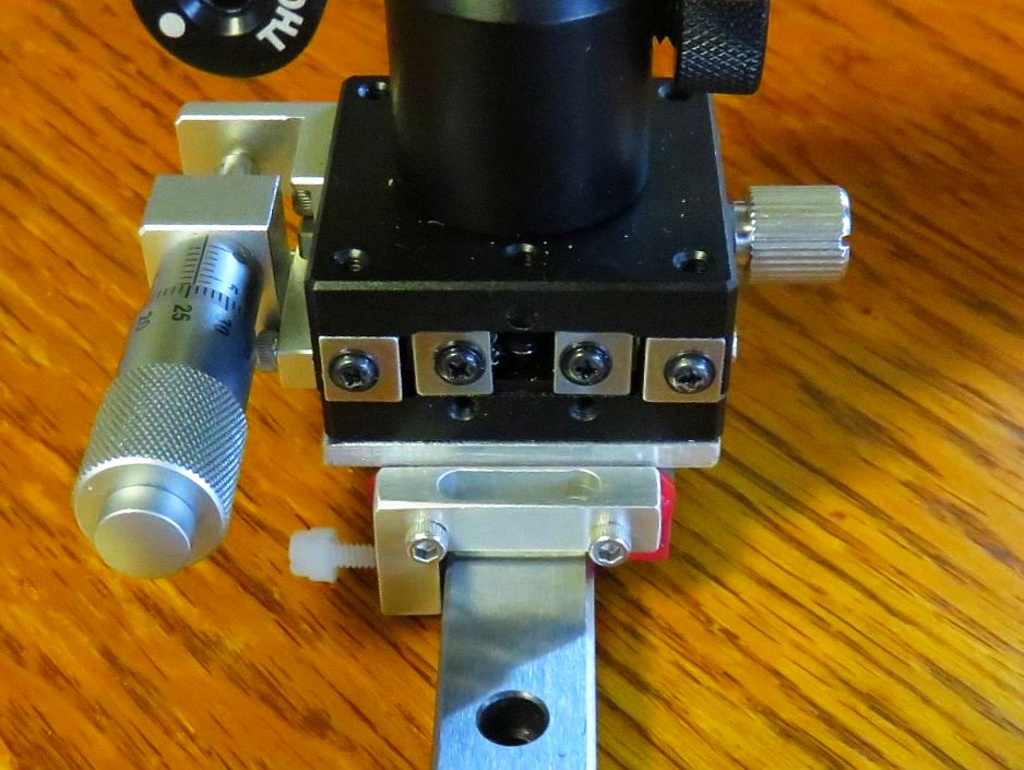

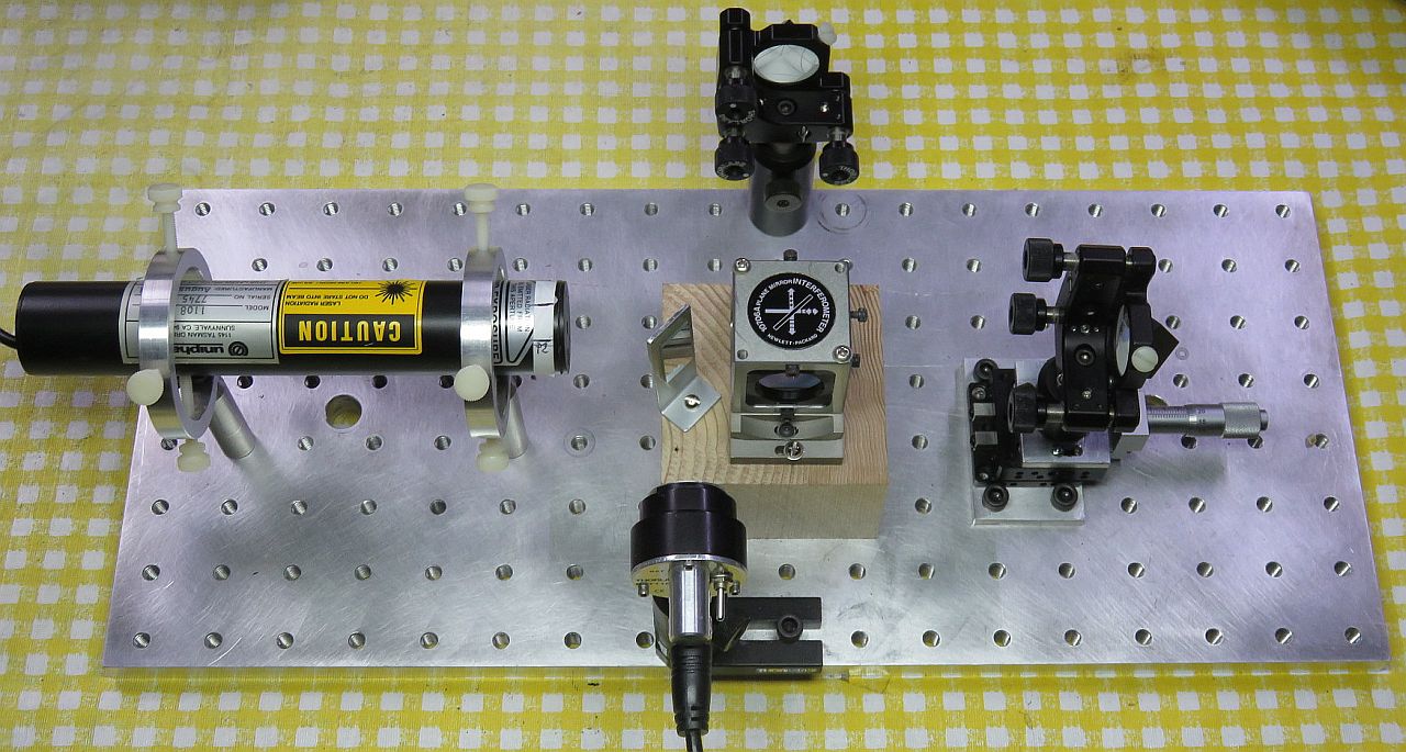

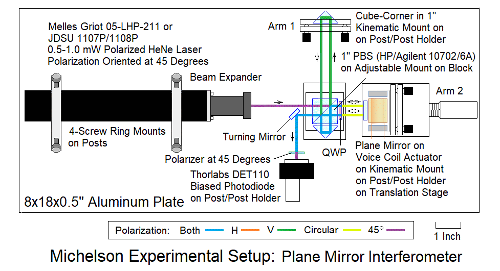

The photo below shows the actual setup used for initial testing. There are minor variations in the actual kits depending on version and whether they are the "Basic" or "Deluxe" versions. These will be noted below. Where the total path length and PLD is small, no beam expander is needed for the laser, which may result in a larger signal since the entire beam hits the detector.
MIPM Linear Interferometer Assembly with Thorlabs Detector

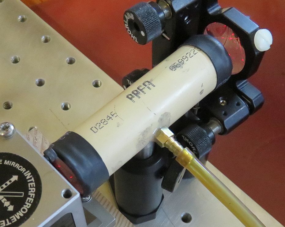

The photo shows a laser without a beam expander but the laser in the kit will either come with a beam expander already attached to convert the ~0.5 mm beam from the laser tube into a ~4 mm beam with low divergence, or the expander which can be attached and centered with 3 screws.
The raw beam is is a bit trickier to align and to maintain alignment as the stage in Arm 2 is moved, but it is quite adequate for a small range of PLD. But where the PLD is large (e.g., for use as an earthquake sensor), the beam expander eases the alignment and is required so that the divergence of the beam doesn't affect the detector response (e.g., the fringe contrast). Since the beam expander is secured by 3 screws (see below) it can be removed to explore how the raw beam behaves. However, two cautions: (1) Do NOT remove the plastic bezel of the laser head as that will expose the high voltage connected to the laser tube and (2) careful lateral adjustment of the beam expander will be required when reattached to center the beam.
If using the beam expander, the posts/rings for the laser should probably be mounted one hole to the left of where they are in the photo to provide more clearance.
Once cured (give it 15 minutes to be safe), it attached to the front of the laesr head using three M2.5 capscrews, which may already be installed. If not, they will be in one of the hardware bags or with the beam expander or adapter ring. The holes in the adapter ring are large enough so that there is (hopefully) enough adjustment range to center the beam, which must be done "live" - with the laser powered. Thread the M2.5 screws in just snug and adjust the centering until the beam is nice and round - this can also be confirmed by looked at the scatter off the front lens of the beam expander and centering there. Then tighten the screws just enough so it won't move around but it is metal in plastic so overtightening may strip the threads.
As a point of interest (or trivia), these parts cost something like $4,000 if purchased new. Fortunately for us, eBay is much less expensive. :-)
This assembly is either on a slightly adjustable metal mount (as in the photo) that gets attached to a precision machined wood block, or attaches directly to a precision machined wood block with pedestal. They are functional equivalent since the adjustment capability of the metla mount is redundant.

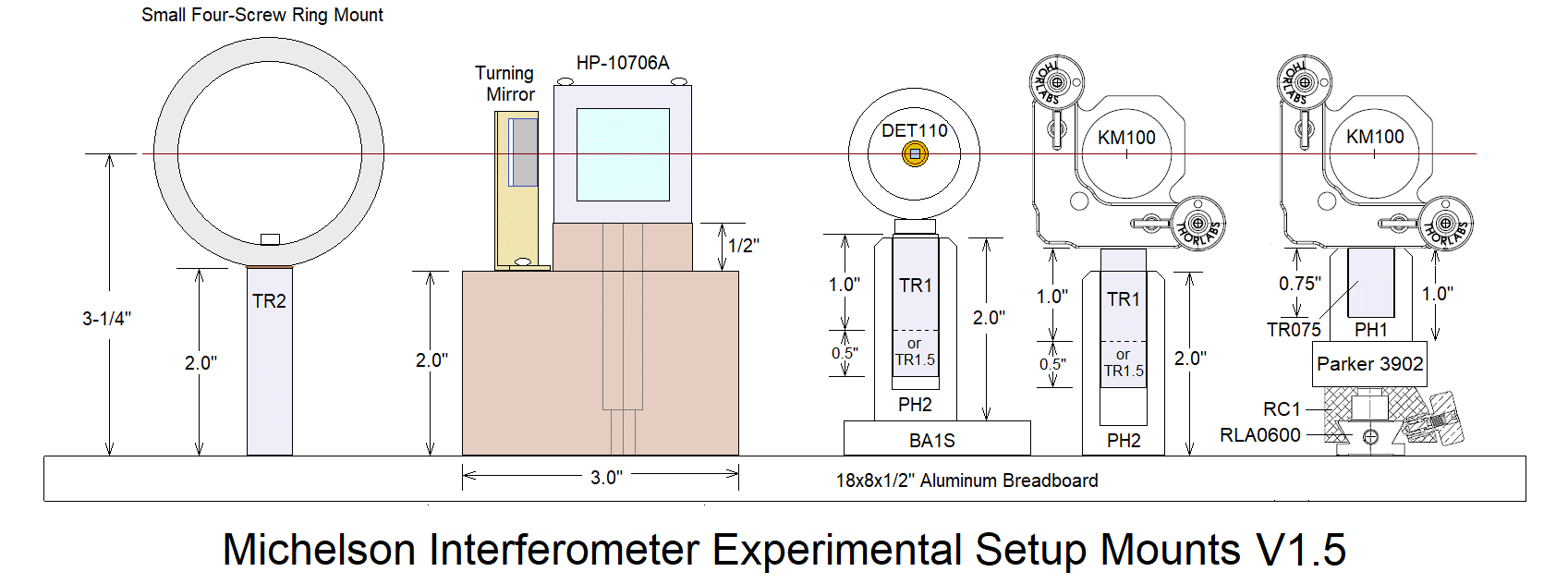

Clicking on this diagram will open a high resolution version in the other window or tab. The heights of any retro-reflectors in the setup will be what really determines the beam height. For most configurations, the critical RR will be the one installed on the PBSC since its height is not adjustable. So everything will be aligned to that.

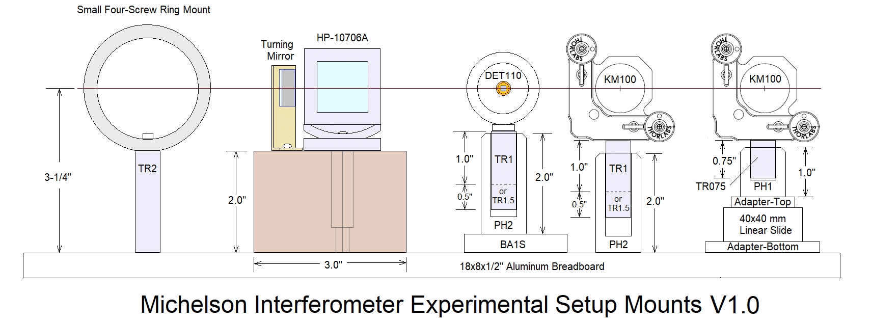

It is assumed that nothing has been mounted, but depending on the previous use, some of these steps have already been completed.
Parts attached with fasterners should be snug but don't overtighten.
It is also assumed that the laser is linearly polarized. Slight changes are required if it is random polarized.
There are minor differences in the assembly procedure depending on the version of the kit (V1.0 or V1.5); specifically the mounting of the PBS and whether Arm 2 uses a rail. These will be address below. The use of a detector other than the Thorlabs DET110 or equivalent will be dealt with separately. There will be a separate procedure for V2.0 (coming soon).
If the laser head has a beam expander, or it is anticipated that one will be added later, it is recommended that the posts be mounts 1 hole to the left of where the are in the photo.
Note: To assure that there are ample threads engaged in both parts here and in subsequent steps with set-screws, the set-screw should be installed approximately half-way into the baseplate or mounting plate and then a thin tool or even the edge of a metal plate or stiff cardboard can be used to keep the set-screw from turning as the post or post holder is threaded onto it before tightening.
Doing this accurately is critical to the ease with which the subsequent alignnment can be performed since not all mounts have sufficient degrees of freedom to accomodate an arbitrary beam location and direction. Fabricating an "alignment plate" out of carboard may be useful. This would have a hole at the optimal height offest 1/4" toward one side from a mark at the bottom.
Attach the mounted PBSC to the wood block using two 3/4" wood screws. Center them in the slots with the PBSC aligned with the X-Y axes. The diagonal of the PBSC should be facing front-left to back-right with the "In" arrow pointing left-to-right. If it cannot be mounted this way, rotate the PBSC 90 degrees on its mount.

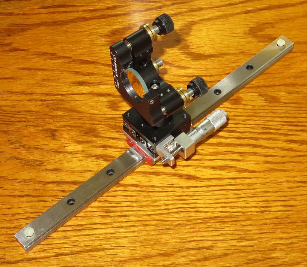

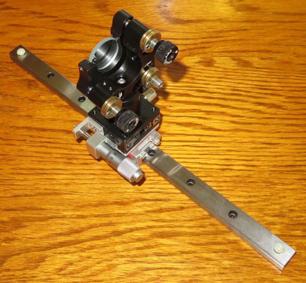

The first part of the procedure differs slightly for the original version with the linear stage and adapter plates, and the upgraded version with the six inch Thorlabe rail:
Orignal version with linear stage and adapter plates:
Version with rail:
CAUTION: Make sure the tip of the screw does NOT contact the fixed part of the linear stage. If it does, an addition washer may need to be added. Or the screw can be shortened slightly with a metal file or grinding wheel.
Common to both:
With the rail setup, this may occur a slight distance below the lowest possible height of the mirror mount. In that case, raise the laser and Arm 1 mount by approximatley double that distance. It should be less than 0.1" and will be well within the height adjustment range of the laser and the clear aperture of the PBSC. If you'd prefer to raise the laser mounting rings in the interest of purity :), add a few washers between the rings and posts.

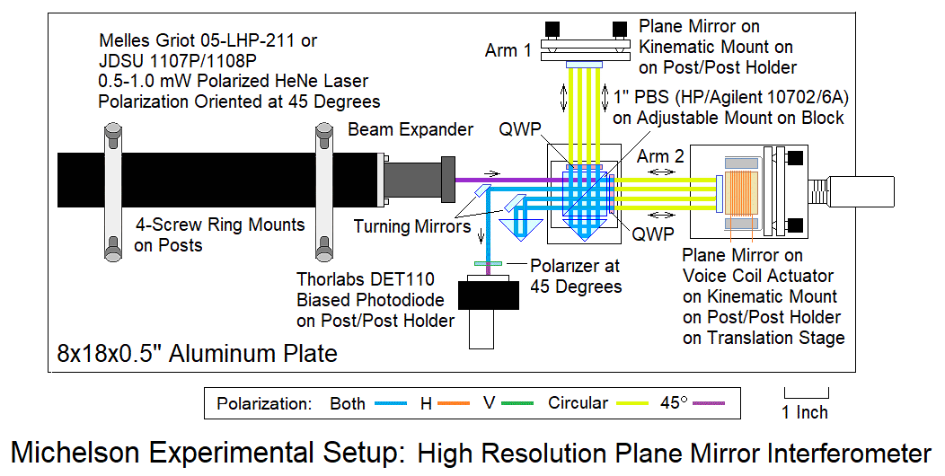

Normally, the Arm 1 mirror would be mounted along with the QWP on the PBSC as the reference since absolute PLD doesn't matter with the single frequency or two frequency lasers used in metrology applications. But as with the LI, we need the PLD to be close to zero or ohter specific value for experiments using a multi-longitudinal mode laser. (The "other specific value" would normally be a small integer multiple of the laser's internal cavity length. Why?)
The mini loudspeaker 4 ohm woofer can move its cone a couple of mm with 1.5 V at 0.375 A. But for these tests, it only needs to move a few µm.
One of the interferometer configurations using planar mirrors must be used for this since it's not practical to attach a cube corner to the loudspeaker. The HSPMI is recommended.
To use it:
For seeing how its movement will affect the interferometer, the loudspeaker can be driven with a 1.5 V battery (not included) and series resistor. Even with a fairly high resistor value like 10K ohms, the mirror will move decent amount, probably much more than one fringe cycle. Or it can be driven through a resistor via the 10K ohm potentiometer and 10K ohm series resistor from a 9 V battery or 12 VDC power supply.
+ o--------+
Battery / 10K
or Power 10K \<---/\/\---> +
Supply /
\ Loudspeaker
- o--------+-----------> -
Calculate the sensitivity of movement in nm with respect to loudspeaker voice coil current.
DO NOT connect the loudspeaker directly to the 12 VDC power supply or 9 V battery as they both may be damaged or destroyed. No more than 1.5 V should ever be applied to the speaker. This can be done using a series resistor between it and the power supply or battery or with the potentiometer and series resistor as shown above. Only a very small current will be needed to move the mirror enough to be readily detected and it won't be visible by eye.
An electronic function generator with simple buffer amplifier and current limiting resistor can also be used to drive the loudspeaker over a larger range as long as the voltage to the loudspeaker doesn't exceed around 1.5 V. With a triangle wave and µMD0, it should be possible to demonstrate the linearity (or non-linearity) of the loudspeaker cone with respect to voltage.
The loudspeaker will also be sensitive as a microphone so monitoring the detector output on the scope should result in a fairly sensitive response to voice and music, though the frequency response will be terrible due to the large mass of the mirror. Input that to the line input of a stereo system and listen to it on headphones. Why? The quality will be terrible but it will demonstrate possibly the most complex way of going from acoustic sound to electronic sound. ;-)

The Gas Cell Compensator (GCC) consists of a ~2 inch length of 1" inch OD Acrylic tube, a pair of planar windows sealed to the ends, the pressure bulb and gauge for a blood pressure cuff (sphygmomanometer), and some simple plumbing. It can mount on a Thorlabs post and post holder using a BA1S hold-down.
GCC Assembly:
The Acrylic tube will already be cut to length and drilled and tapped for the 10/32 hose barb and 8-32 set-screw to attach it to a Thorlabs post. The ends will have been ground to be close enough for government work. :) They don't need to be perfectly perpendicular to the tube or parallel to each-other. Nor do they need be polished - the rough cut surface is better for gluing. Only that they can seal to the windows.
The windows are 1-1/8 inch in diameter and made of either glass or Acrylic. The Acrylic will have paper protective brown paper on both sides.
Avoid getting any Epoxy inside the tube, especially on the windows, as much of their area may need to be unobstructed depending on the type of interferometer and/or whether the laser has a beam expander.
If it gets messed up before curing, the Epoxy can be careully wiped off and then the glass and/or Acrylic can be cleaned with alcohol (but nothing stronger!). After curing, a single edge razor blade can be used to remove Epoxy, then cleaned with alcohol. Take care to avoid scratching the window(s).
The photo on the left shows the prototype using a 3/4" OD PVC tube installed in Arm 1 of the interferometer. The ends are covered with pieces of heat shrink to hide the ugly cut microscope slide windows. Yours will be (1) shorter, (2) made of 1" OD clear Acrylic (Plexiglas) instead of PVC, (3) use circular windows, and (4) hopefully nicer looking when completed. ;-)
The photo on the right shows the complete setup (with the extended PLD rail option) and a scope trace with showing the GCC loosing presure some of its pressure over 20 seconds or so.
Closeup of GCC Assembly using a Piece of PVC Pipe (left), Overall Setup Showing the Fringe Signal as the Pressure Declines

The HRPMI is essentially an HSPMI in which instead of the return beam going to the detector, it is reflected back into the interferometer, but offset in position by an additional cube corner, so it traverses all of the optics a second time. So instead of 2 passes, it becomes 4 passes. In principle, this could be extended to 6 or more passes using a similar approach, but as you will undoubtedly see if you're crazy enough to attempt to implement the HRPMI, that will be tough enough to align.
The HRPMI setup requires some additional optics (another turning mirror and adjustable mount for an unmounted cube corner). The only way to really test it without a measurement display would be with one of the methods of fine tuning path length - loudspeaker, PZT, air pressure, tmperature, etc. The micrometer stage will simply not have fine enough control to reliably detect a difference between X1 or X4. Thus the setup is shown with the loudspeaker.

V1.5 uses a Thorlabs rail and carrier with the Parker linear stage shown in the lower right. The only other change (which is independent of this) is to add a pedestal to the Wood Block which eliminate the HP mount for the PBS cube since it served no purpose and added cost.
Future versions of this kit will probably include a rail as the default, though the exact details may differ.
The Alternative Rail Project:
Using the Thorlabs RLA rail with RC carrier is dirt simple since it is designed for use with optical components and that is what V2.0 will use initially. But One issue with these is that the carrier and rail are both aluminum and with metal-metal contact, it doesn't really move silky smooth. A low tech solution of some was might improve the situation, but as an alternative, a ball bearing linear rail is being considered. It will use an MGN15C carriage block with either a 150 or 300 mm rail. The Far East versions of these should have adequate precision for what is required here. A prototype using a 300 mm rail is shown below:
Prototype of Arm 2 using MGN15C Ball Bearing Linear Rail: Front View (left), Back View (center), Closeup of Locking Bracket (Right)
It has a Newport U100A adjustable mount with a planar mirror and Thorlabs knobs :) on a generic micrometer stage. The end holes of the 300 mm rail line up nearly perfectly with breadboard holes. Those in the 150 mm rail do not align, so a 6-32 tapped hole must be added to the breadboard for one end. Screws in the end holes poking up will serve as the end-stops as a default. Adding a stop to the ends of the rail or on the breadboard would achieve almost an additional inch of travel though. They could just be a small plate glued there. The locking bracket can be installed at either end of the carriage which may be convenient depending on whether the micrometer is end or side adjusted. The thumbscrew can be set for any level of resistance, always with silky-smooth movement. ;-) A steel machinists' scale glued to the breadboard will work at least as well as the graduations on the Thorlabs rail. The hand-rubbed urethaned oak plank is not included. ;-) Stay tuned.
For either the Thorlabs or MGN15C, all but the very slowest movement will overwhelm the simple quad-A-B interface to µMD0 and it will lose count. So they are intended for convenience in coarsely locating the Arm 2 reflector. But if a proper transimpedance preamp is added, tracking should be maintained over the full range with careful enough alignment.

The only things here now are more comprehensive mounting height diagrams, and photos of the two versions.
